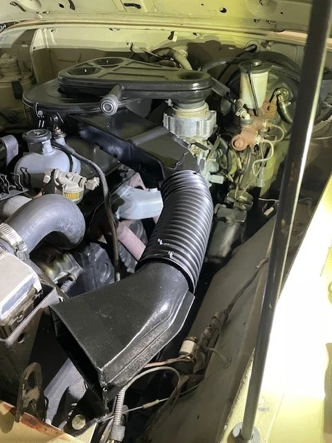

Rebuild of Trusty
Installed the air intake horn and hose.
