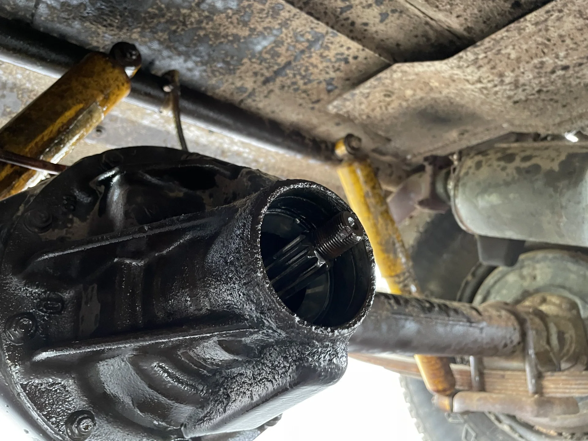

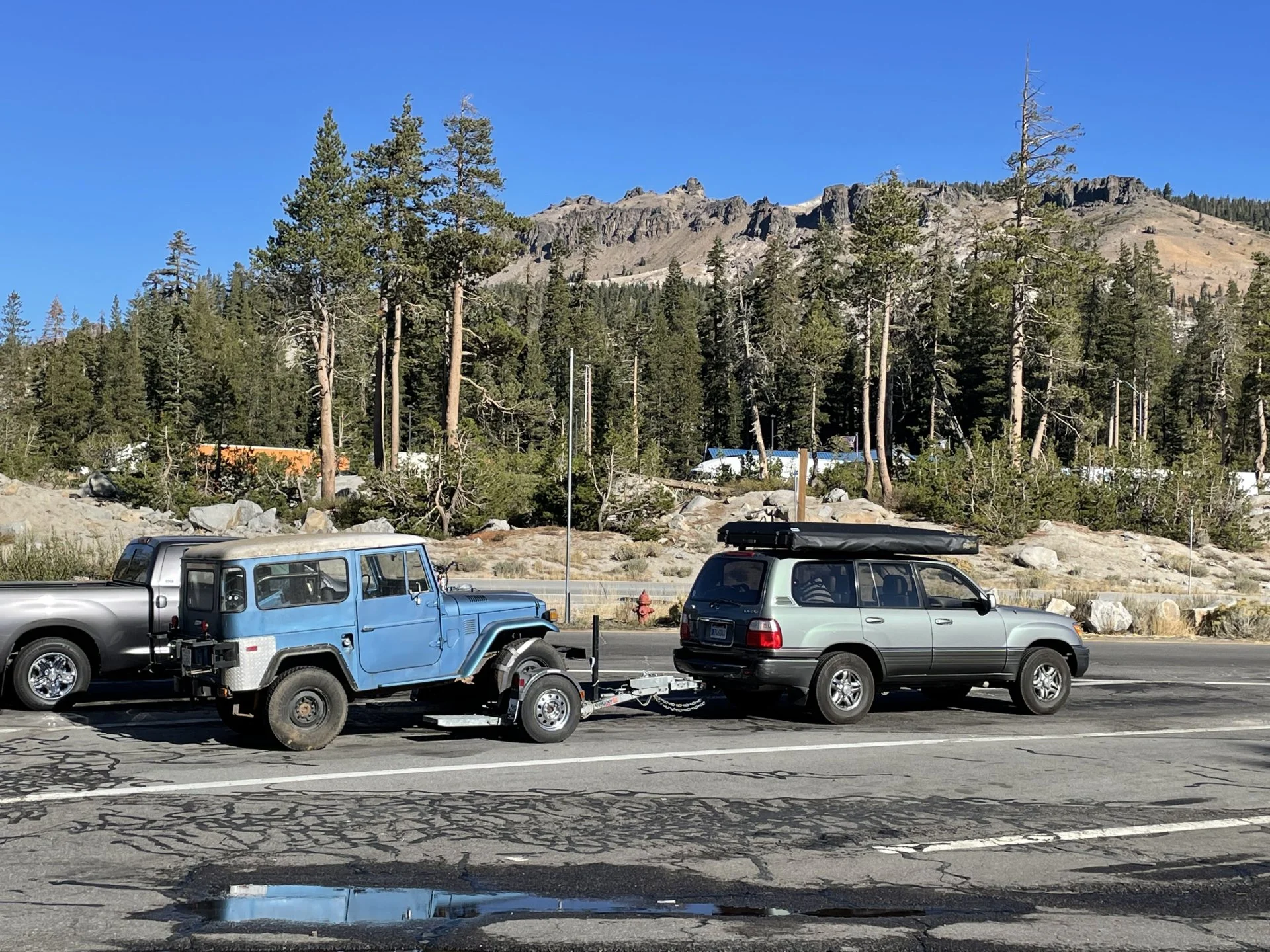

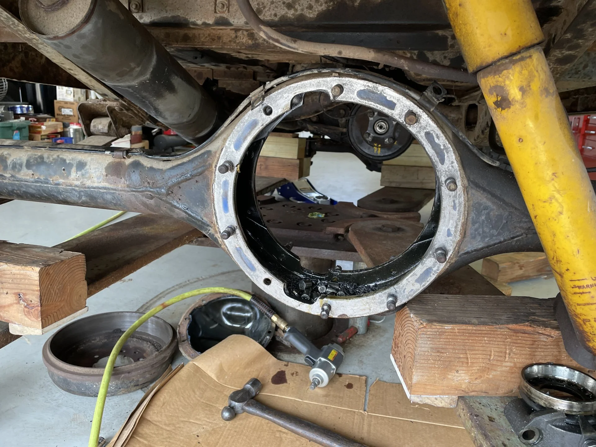

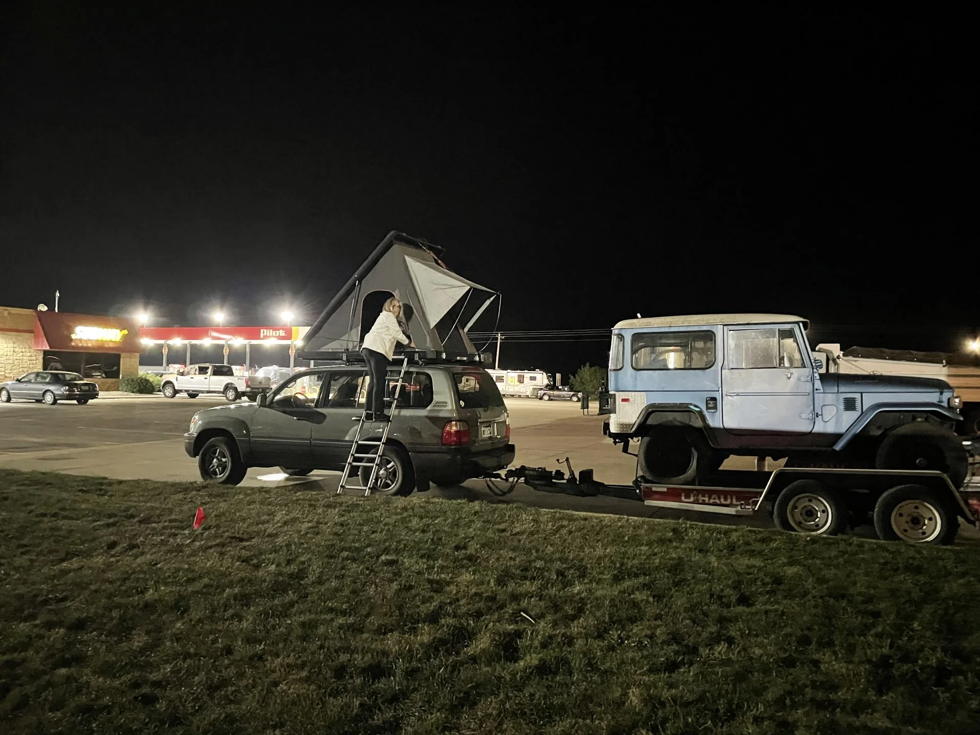

I towed it from NorCal to West Lafayette, OH to leave with a retired mechanic friend for a while. Destroyed the rear third member in the process (I'm in the market for one now; yes, driveshaft was removed and diff was full of gear oil). The tow dolly was a fine choice... until it wasn't!
Donner Summit, CA

Lost the joint flange and bearing somewhere along I-80 outside Lincoln, NE.
A Pilot truck stop somewhere in Iowa. Not the ideal loading of the LC on the trailer, but it would only move in reverse; diff would lock up and not roll forward.

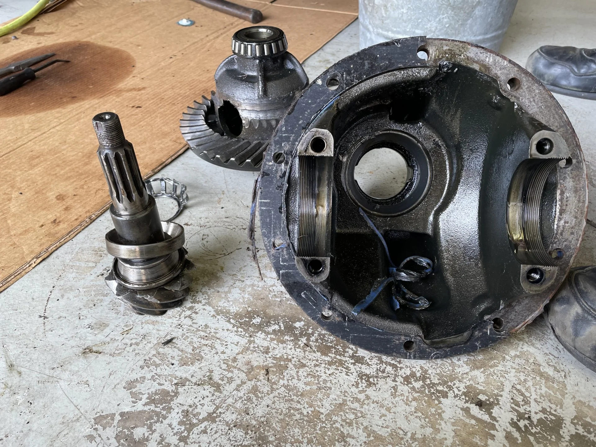

Arrived at friend's place in W. Lafayette, OH. After trying other things, greased the ramp and dragged it's stubborn a*# off the trailer. He hasn't worked on LCs, but lifetime of work and hobby working on helicopters (fleet maintenance), busses, muscle cars, motorcycles.
He dove right into it...

Our main take away is, for a vehicle that has been sitting for a while, and not actually knowing the service history of that rear end, I should have put it on a full trailer for a trip of this magnitude even though the rear end seemed competent. I was overly optimistic and got extremely lucky that we got safely to the side of the highway without further incident. For future reference I would only tow a vehicle on a dolly or by flat tow any significant distance if I know the service history of all the pertinent internals. Kind of embarrassing to write that out and read it back, as that should be a no-brainer.

If all I had available was a dolly I would be OK with towing it backwards as long as the front hubs were 'free'.
