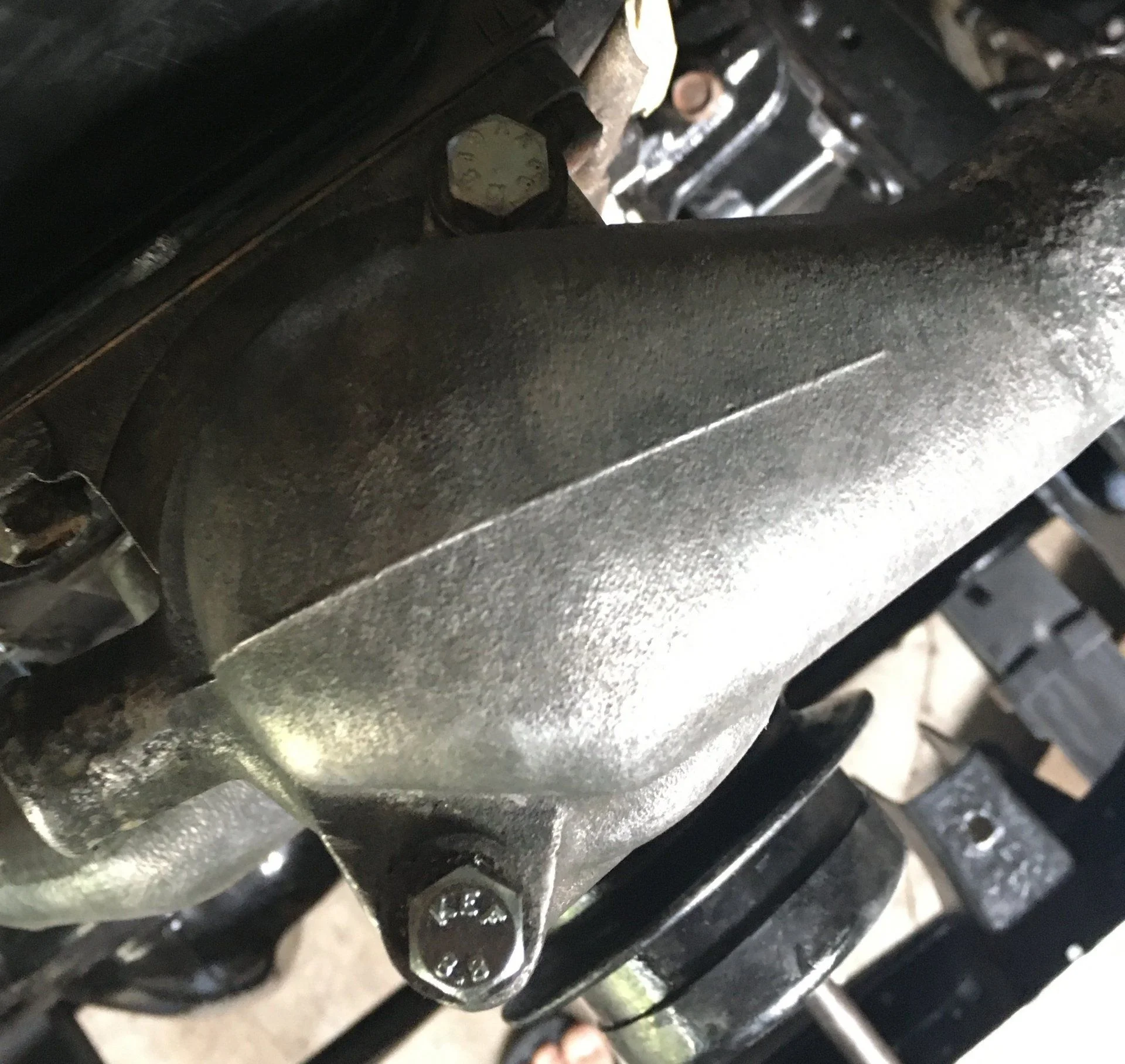

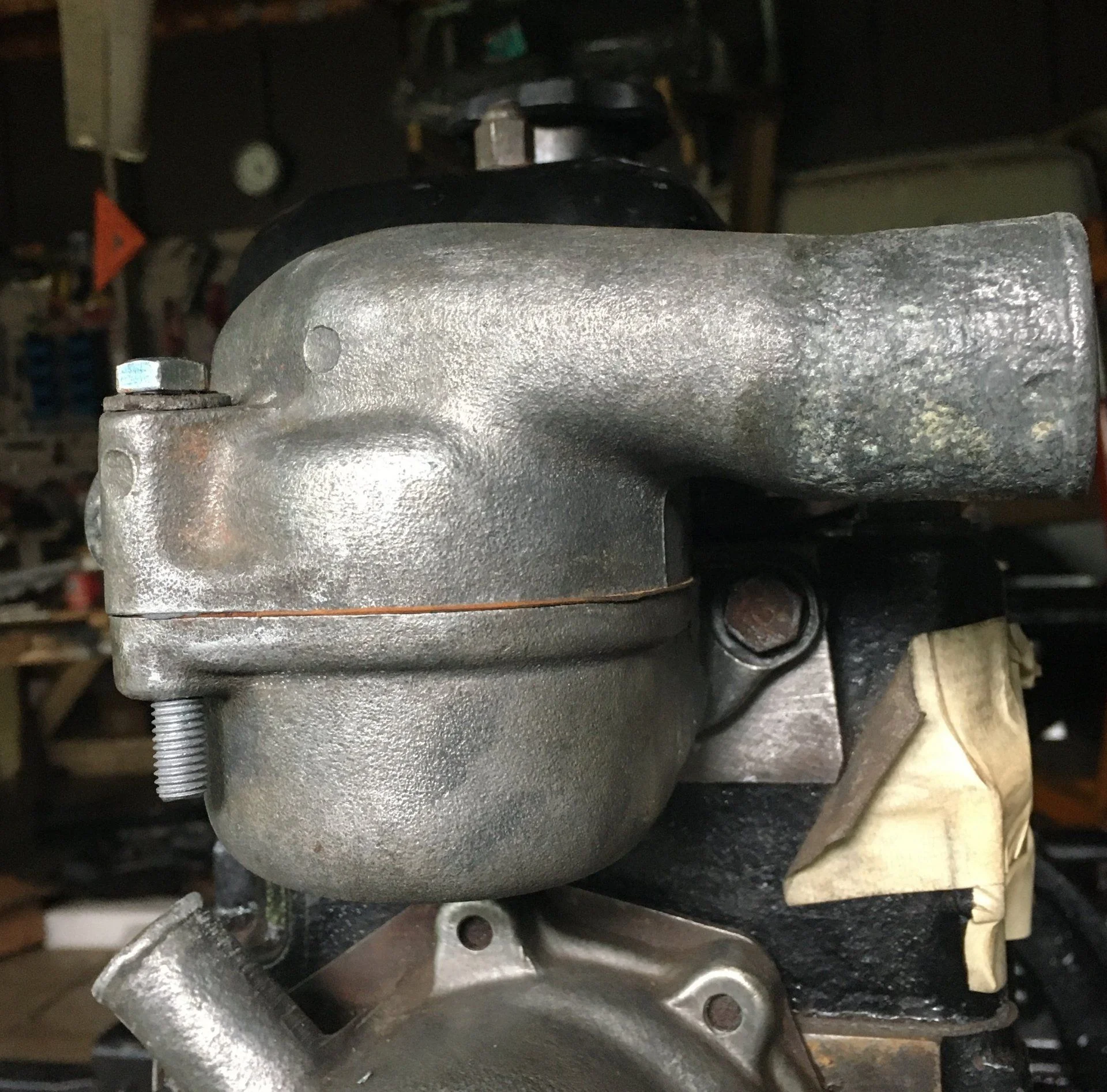

Broke a thermostat housing bolt off while attempting to change the thermostat
Welcome to my world.Broke a thermostat housing bolt off while attempting to change the thermostat![]()
Drill it out and try not to break the ezout off in the bolt. you may have to chase the threads with a tap after you get it out.Did you have success extracting the broken bolt or did you replace the housing?
I use copper anti-seize on the bolts, helps prevent the corrosion issues with dissimilar metals - steel bolt and aluminum housing.Drill it out and try not to break the ezout off in the bolt. you may have to chase the threads with a tap after you get it out.
I have to drill one bolt out.. and planing to put it on long bolt and nut
but actualy able to threads with a tap..
Same for me...I hate hate hate drilling bolts.
Same for me...
...there is always alternative... for some extra xxx $.. buy a new parts..![]()

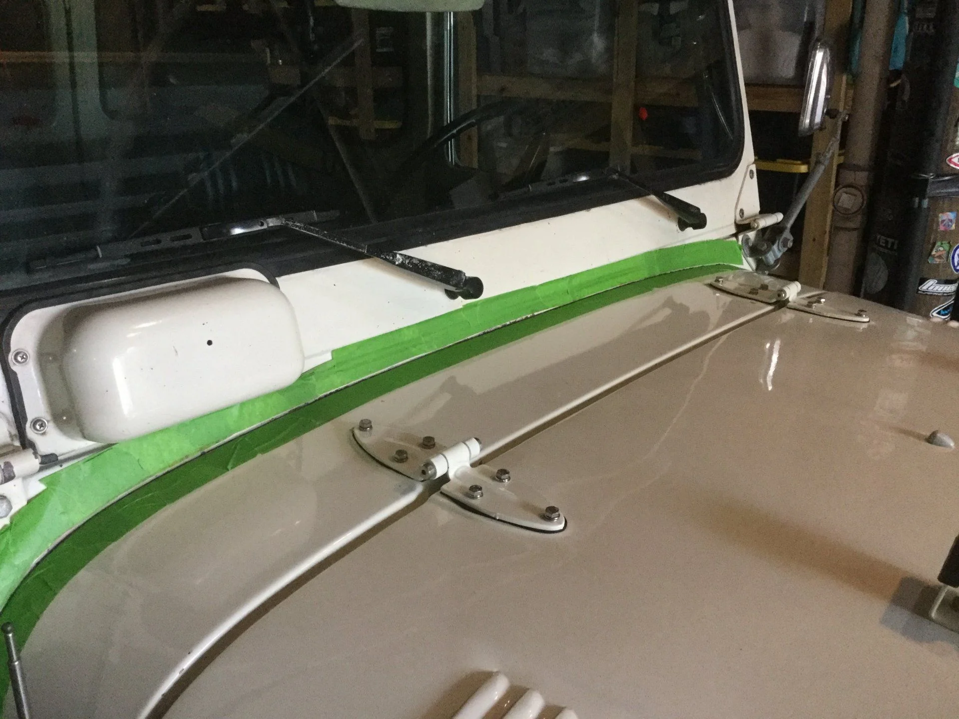

What type of rust converter was it? Check the label - some converters still require a topcoat to seal in the converted metal and prevent future rust. If needed I would spray something in there before the seam sealer.Like some of you I found water in the floorboard after a rainstorm. I could see some cracks in the cowl seam. I scraped the old stuff out. Taped her up. Used a fine tip brush to get some rust converter into the seam.
Any suggestions on weather or not I should do anything else before I install the new seam sealer ?
