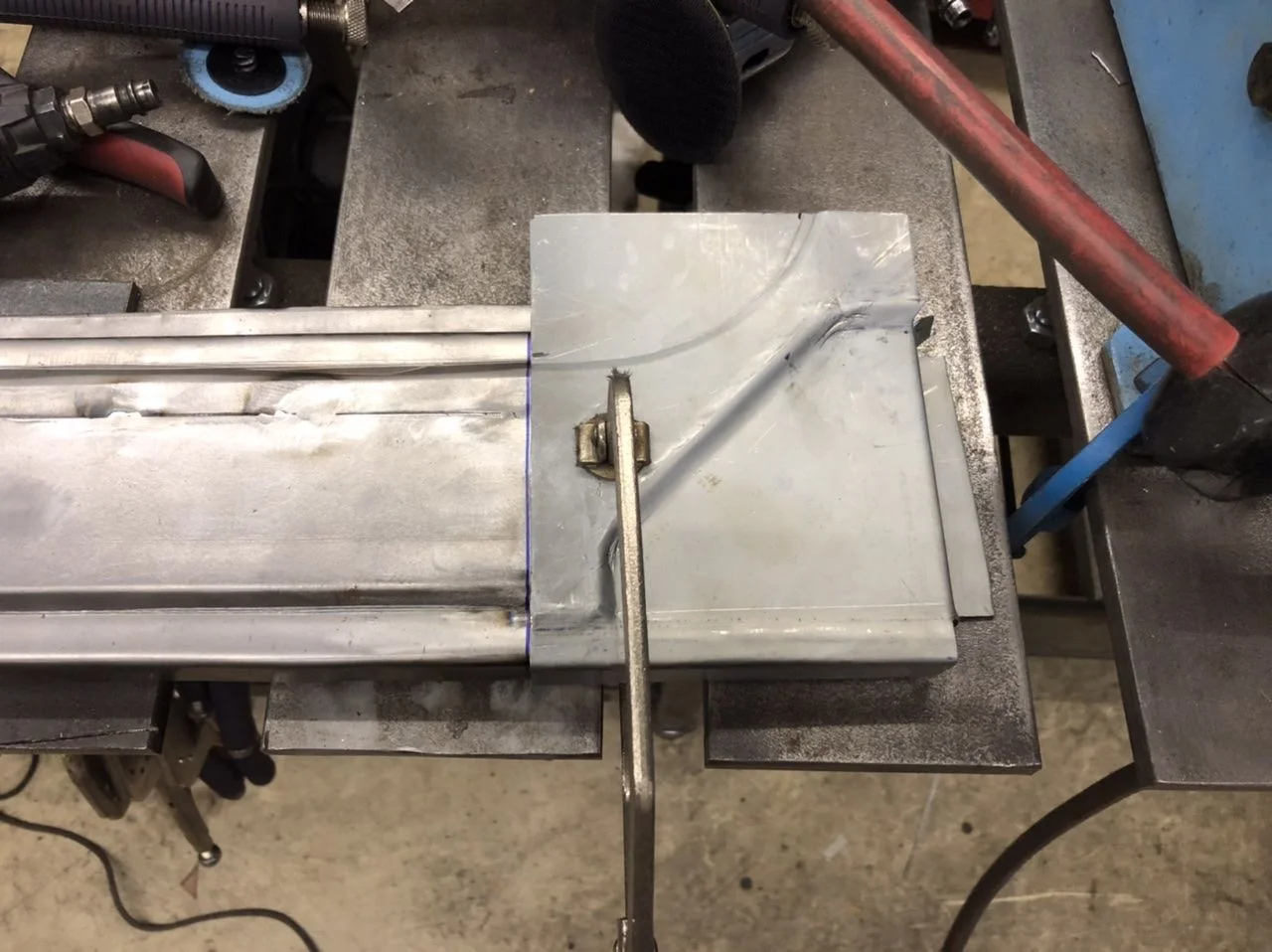

@Krenie ....used loctite rust dissolver then primed then applied seam sealer.
Out of town now but will post up photos of finished product later

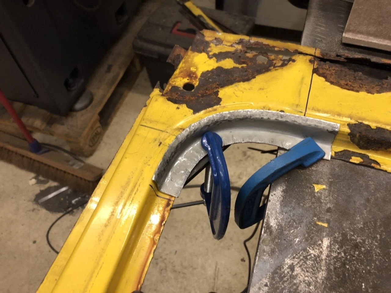

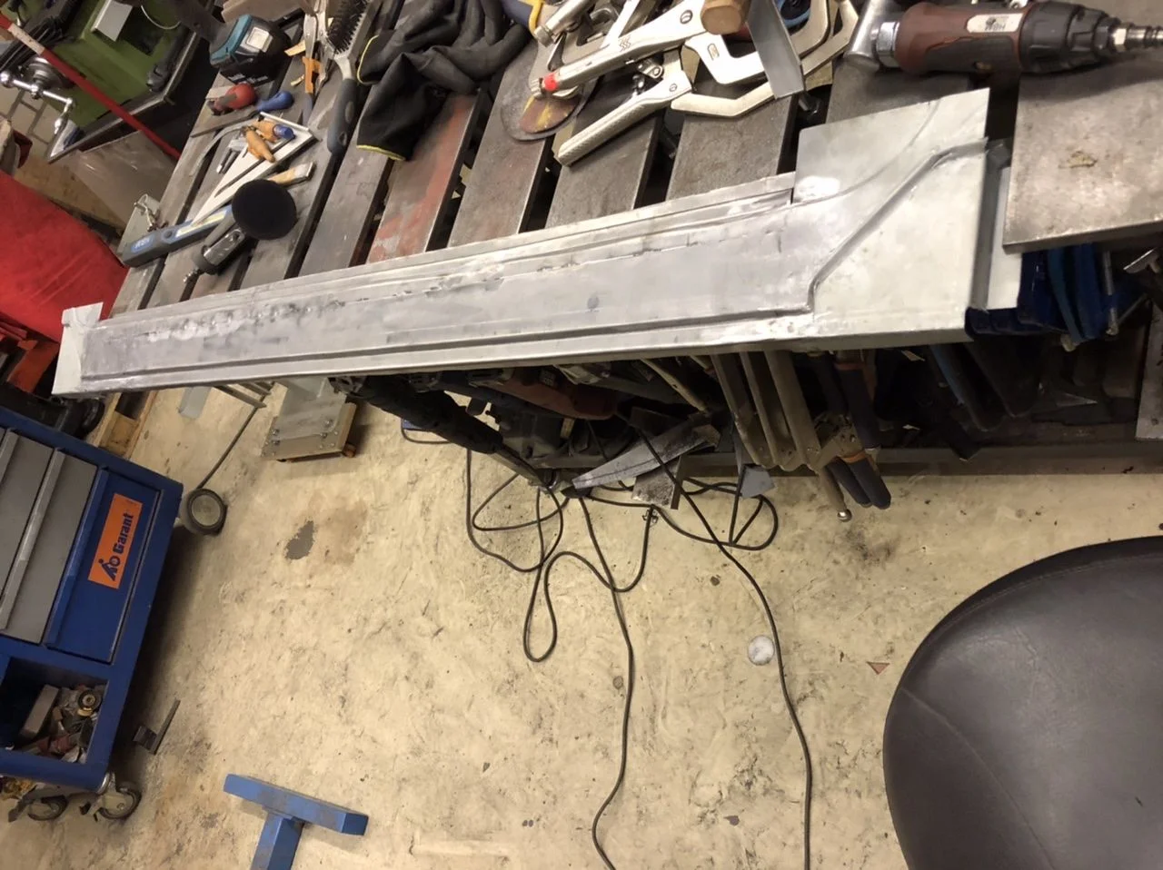

More work done on the window frame.
I wish I knew how to make stuff to this level. I desperately want to rebuild my rotted out hard top sides but the curves and flanges freak me out.

It is not that difficult as it looks but you have to take them apart like I did the wind screen frame.
Start with one and small bits, weld slow and planish your welds before you continue every time.
you always have the other side to look at and measure on.
Yeah my biggest concern is (especially separating the sheet metal) that it will go back together warped as hell and nothing will line up right.
Its not that difficult. If you use a spot weld drill you will have good reference points to put it back together.
like I wrote, slow welding and planishing after each weld.
