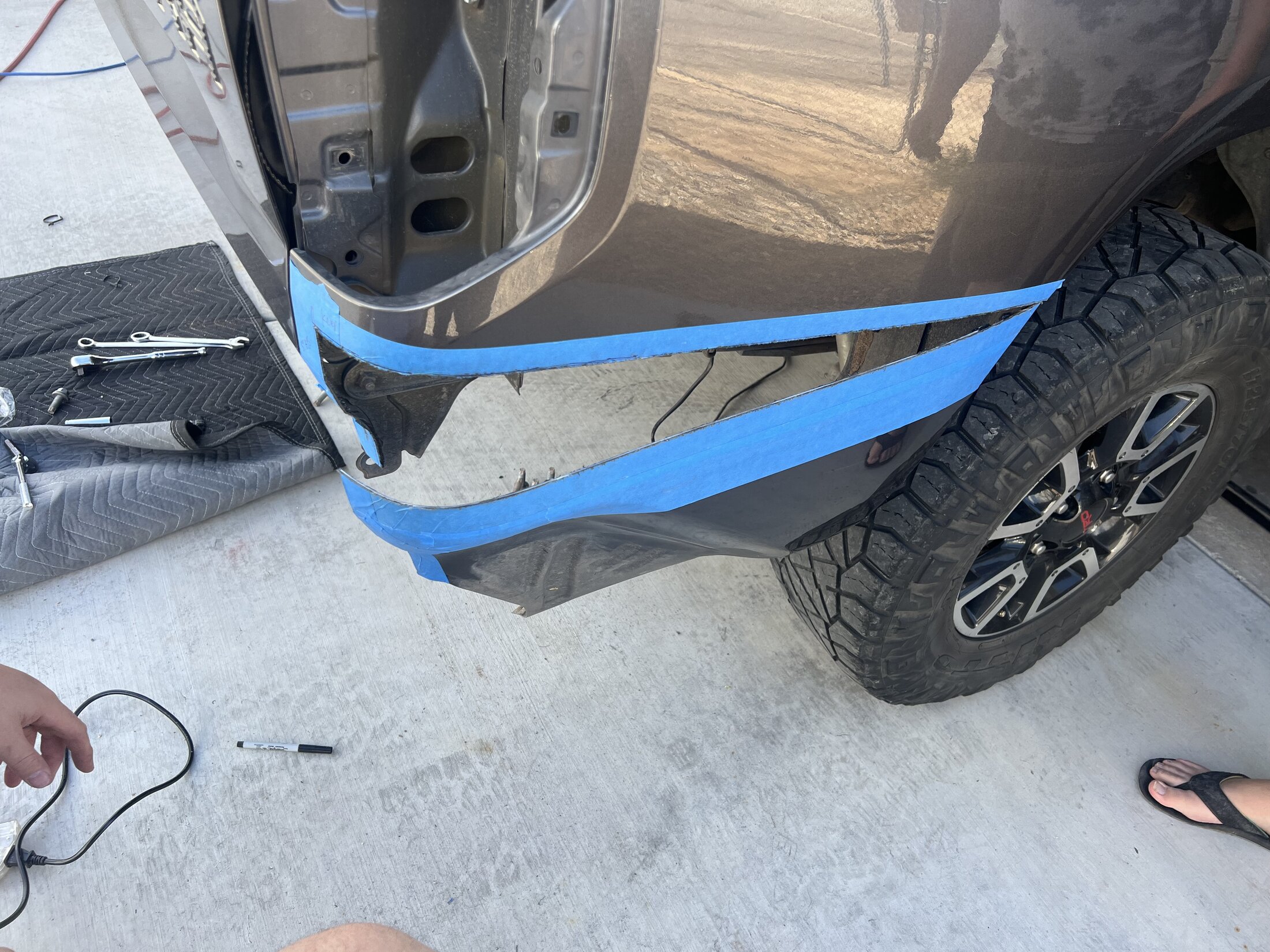

That’s how it always starts, just a few minor alterations….
12 months later...
"A little bit of tasteful armor couldn't hurt...."
Replace bashed up running boards with sliders, really have to do something about the wheels and tires, and a roof rack too. Just looking at skid plates and winches…and for me I hate the fact that Slee is just fifteen minutes south. But think of all the money you save if you install it yourself!
12 months later...
Next thing you know -
Pretty sure it's PT206-60200-02

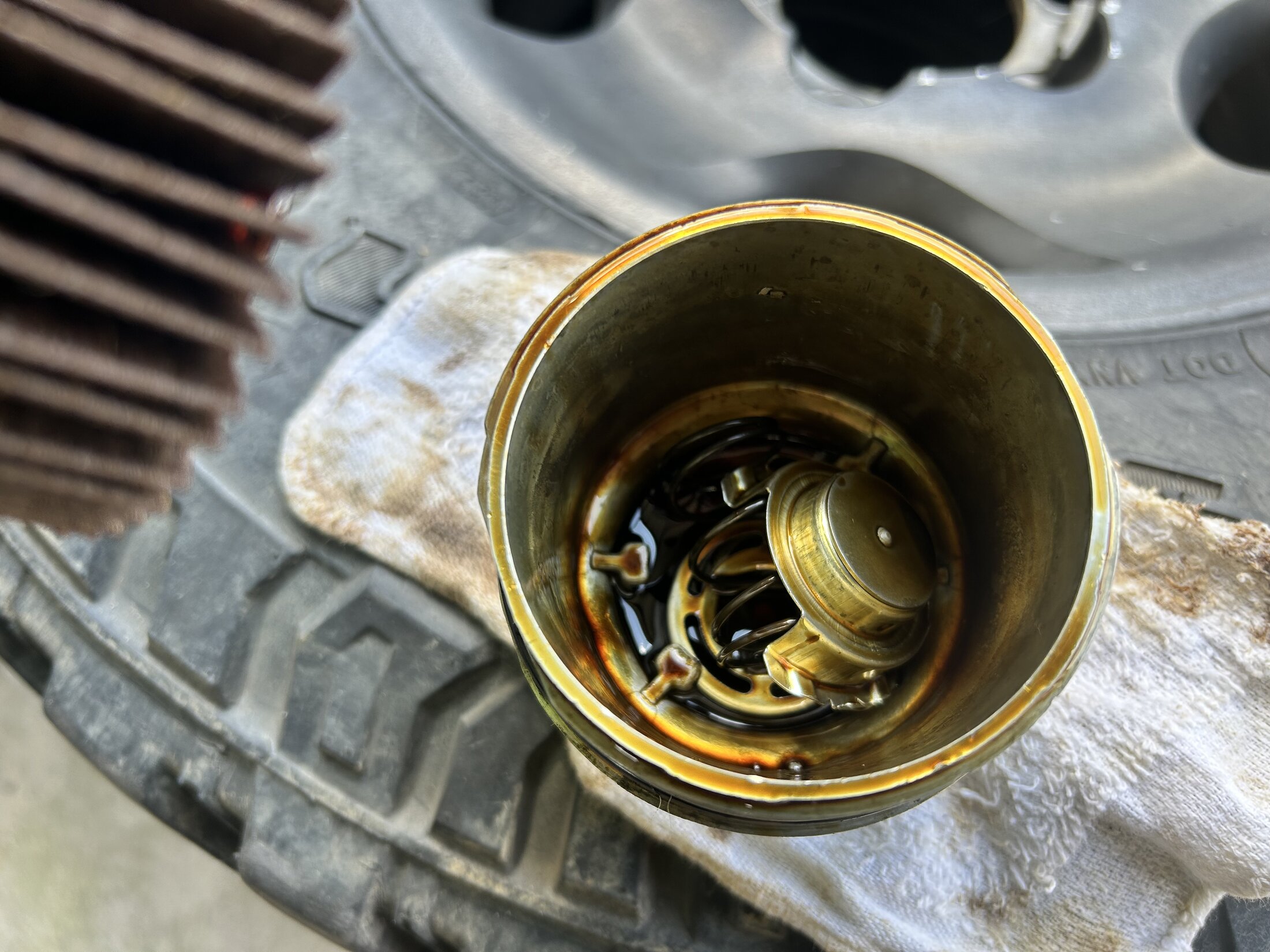

It’s missing the screen that keeps the filter from collapsing in case that’s not obvious
So basically been bypassing most filter media. How long has it been since the last change?
This 200 and the platform in general is all new to me. Been rocking a 1fz 80 for last 20 years and just picked this one up 6 mos ago but it’s seen very little driving. Under 2k since purchase
No clue on last oil change date or mileage.
Not aware of a screen. (Edit-Is that the missing perforated stem?) or would it be on top or bottom? My assumption was the spring and “valve plates” were loose and not enagaged in position when it was last assemble reducing available height leading to crushing the filter element when installed.
I’d like to get the proper housing on order and any other needed parts n pieces.
