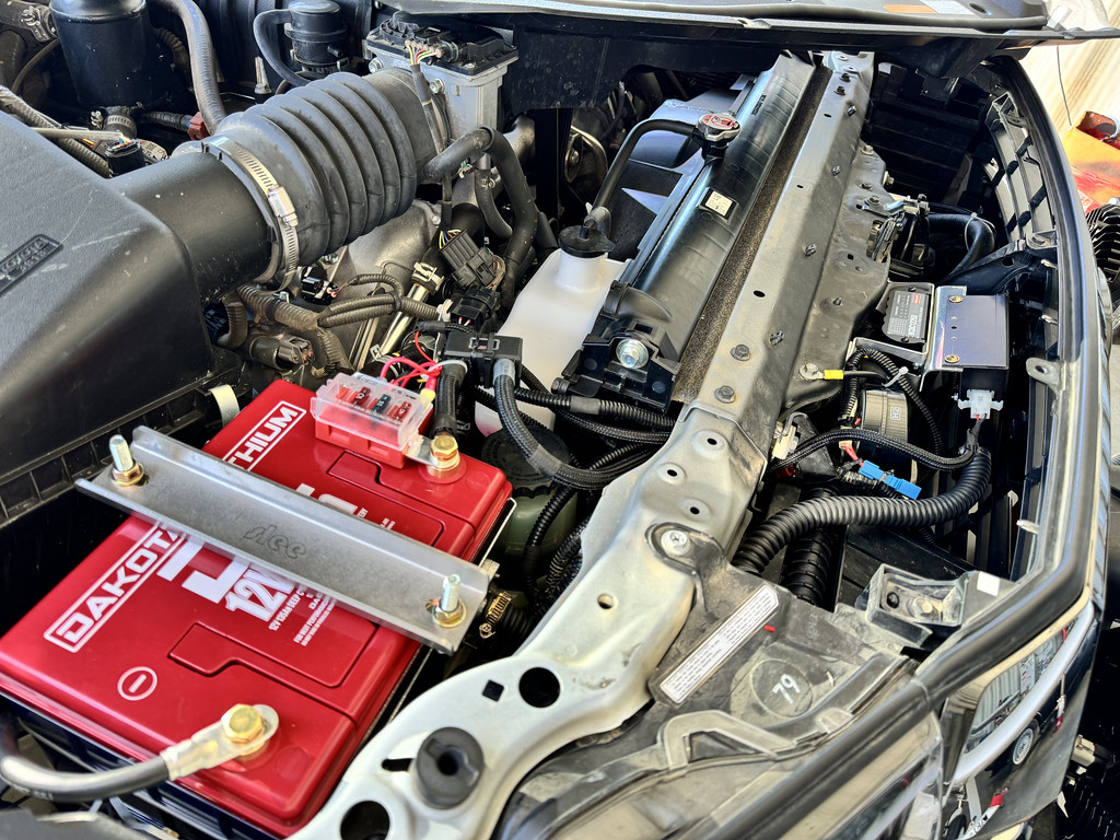

I’m going to try to find a way to duct some cooler air from a high pressure area back to the battery.
Side note- on the Harrop supercharger conversion the IAT sensor is relocated below the intercooler core in the supercharger manifold.
Agreed most of the underhood heat is shed from the radiator while running, and then I suspect the engine block/exhaust/cat will allow significant heat rise once a hot car is stopped.

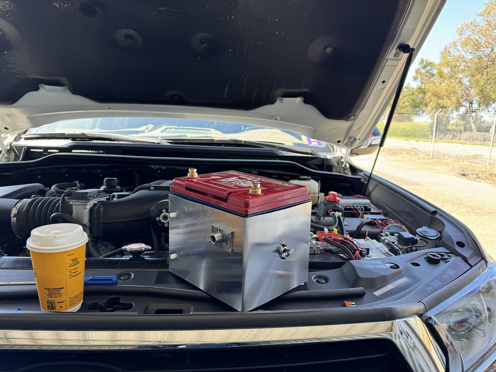

That's why I'm thinking active cooling which can run until ambient temps around the battery fall below 30 C. I'm thinking a fan and thermostat is not a lot of complexity....I already have the fan and duct material, just need to fabricate a simple shroud.
Test assembly.
The shroud covers the battery on three sides and is held off the battery by two rows of 3/8” foam to allow venting. A thermo switch (40 C on/30 C off) switches the ground side of the avionics blower which is mounted to the front of the Redarc DCDC mount with a bracket I made.
Blower draws 0.3 amps and is powered by the house battery.
