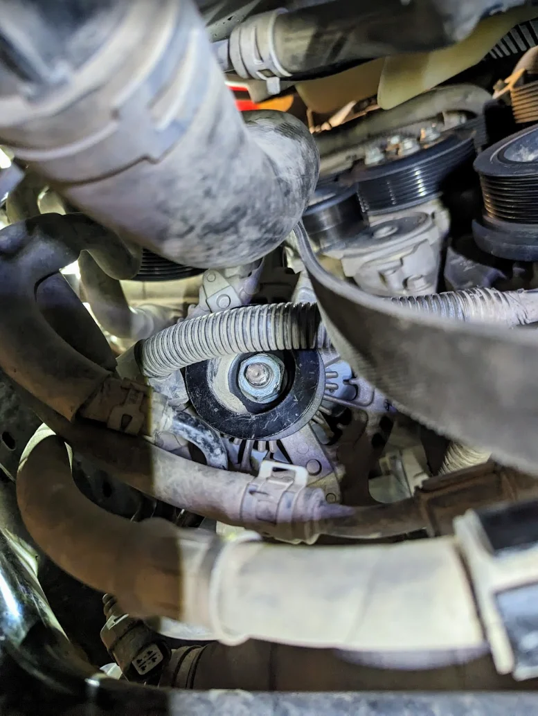

This little bugger of an alternator pulley sure put up a fight. You win this round.
Practically redid an alternator replacement job just to upgrade with an overdrive pulley.

Yeah but you can now go around saying you're the ONLY one West of the Mississippi that has a 2 in. alternator pulley. :)

Yeah what sucks is with a body lift and radiator drop bracket, you cannot drop alternator out like normal, the 1/4” spacer just eats up the gap!
Interesting. Fortunately I didn't need to drop the alternator out fully. Just needed to unmount and get it in a position I hit the pulley nut with an impact gun.
The body lift did help to open up wheel well access nicely so I'll take that as a small win.
I made the mistake of originally trying to follow the FSM when swapping mine and totally jacked the lower transmission line into the radiator… then out the wheel well it went, after a ton of cursing. And then I got to install a new radiator….
If I'm doing the body lift install would it be "easier" to swap out the alternator? I have a new alternator from the Toyota sales and planning to do body lift.
I think so. Access from the side of wheel well is mucho better.
I think it's pretty straightforward to drop the alternator through the bottom. If you unbolt the sway bar from the chassis rails and just let it hang. And unbolt all the clamps and stiffeners for the power steering lines. Helps access to reach bolts and squeeze the alternator through.

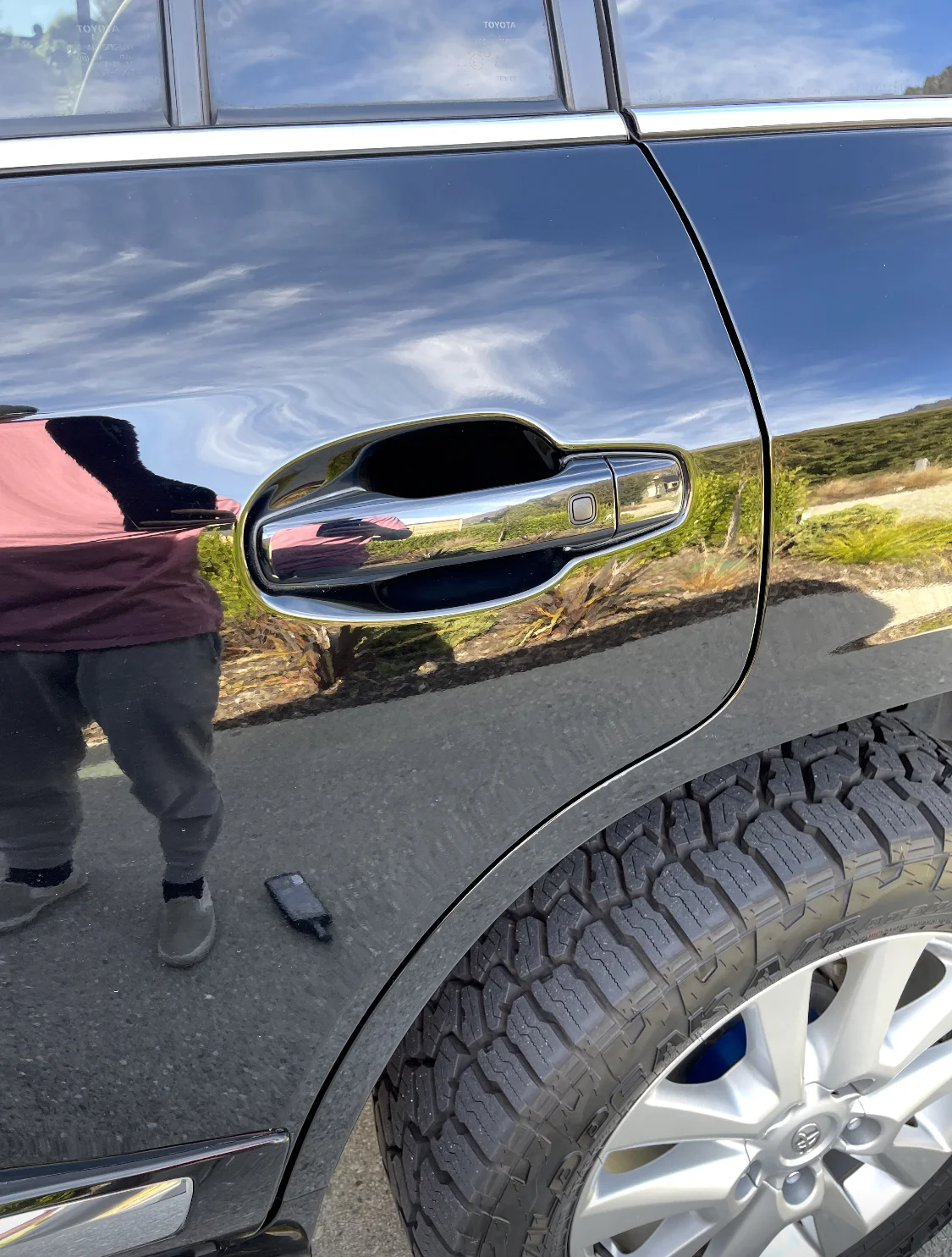

Also swapped over a couple of my black wrapped chrome handles to black oem handles I got second hand. Sadly it’s not 202 black so in direct sunlight you see quite a bit of bluish flake. I’ve still got to paint one that is in grey with 202 black so depending on how that turns out may respray those ones.

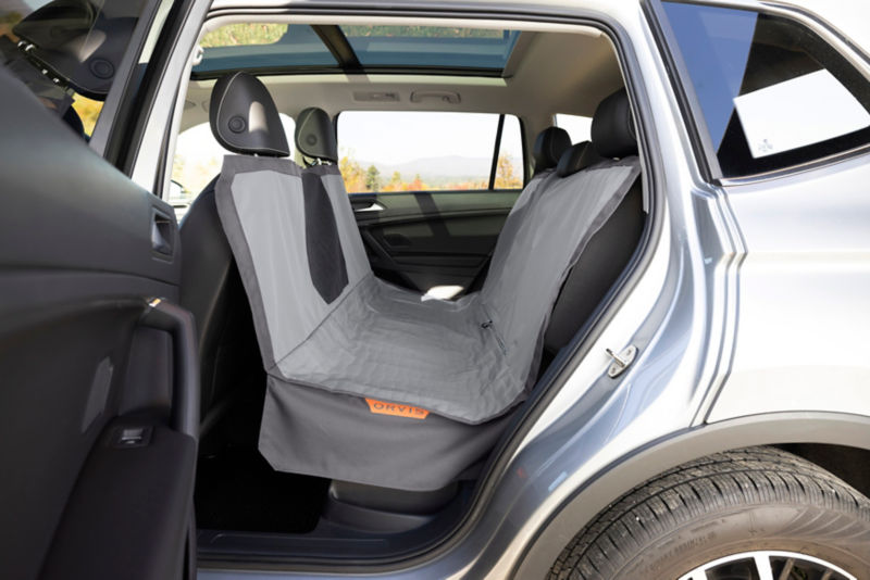

For what it’s worth, I don’t have your making-things skills so purchased the Kurgo dog bridge and love it.
And I cover it with a dog hammock:
Not as pretty as your work, obviously, but it works.
