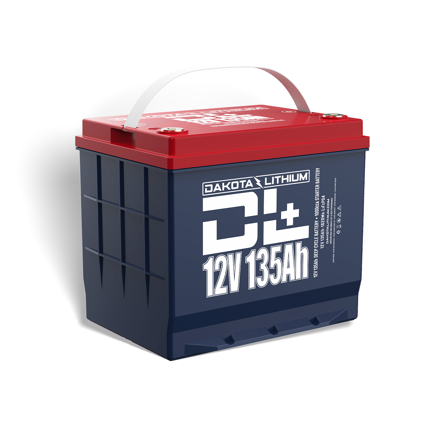

Honestly probably less risk than leaving a laptop in the back of the car on a sunny day. Various specs on the Dakota website if you want to check it out.
That said…I own 2 EVs and neither ever sleep in my garage…though I sometimes daily a DeLorean which is probably peak death by fire risk.
OPERATING TEMPERATURE
Ideal for rugged & harsh environments. Much better than SLA or other lithium batteries. -20°F min, +150°F max optimal operating temps (battery performs well down to -20°F). Internal even-heat technology allows for charging below 32°F. BMS high temp cut off at 167°F / 75°C.
Dakota Lithium batteries are 100% safe & reliable. Our signature chemistry, Lithium Iron Phosphate (LiFePO4), does not contain rare earth elements (like Cobalt) or heavy metals, is non-toxic, including no lead or acid, is non-corrosive, does not off gas, requires no watering or maintenance, can be placed in any orientation, and unlike other lithium batteries will not explode or catch fire. In addition, each Dakota Lithium battery is protected from over heating, over charging, and short circuiting, by a battery management system (BMS) microchip that also extends the lifespan and is contained in a rugged, waterproof case (although enough water can conduct electricity between the terminals, so don't submerse the battery). For best performance & reliability we recommend using a LiFePO4 charger.
Interesting. Didn't realize that the 135A was different that the other Dakota's. That it has passive/automatic heating that only comes on when charging and below 32F is a really nice feature. With the heated Battleborn I run in the Ram there is a manual switch, so you have to leave it on shore power to keep the heat on if you want it to accept a charge. Thanks for that info.

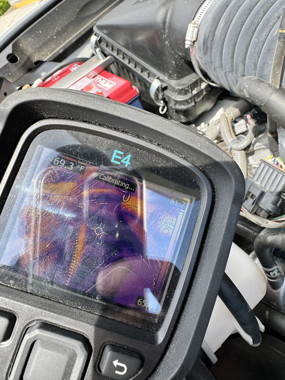

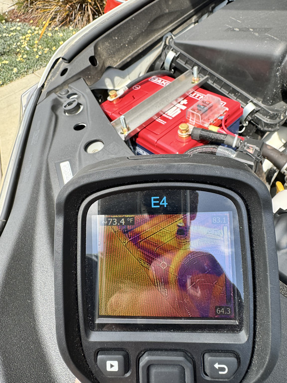

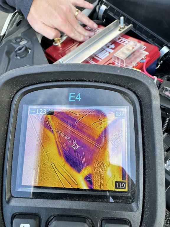

OAT 68F, sunny pavement temp 89F. Here is the starting battery surface temp:

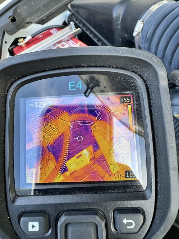

After a 4 mile/20 minute drive through town:

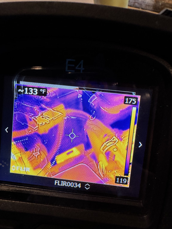

After the reverse trip- might be approaching an equilibrium point.
Love how you have a FLIR handy.

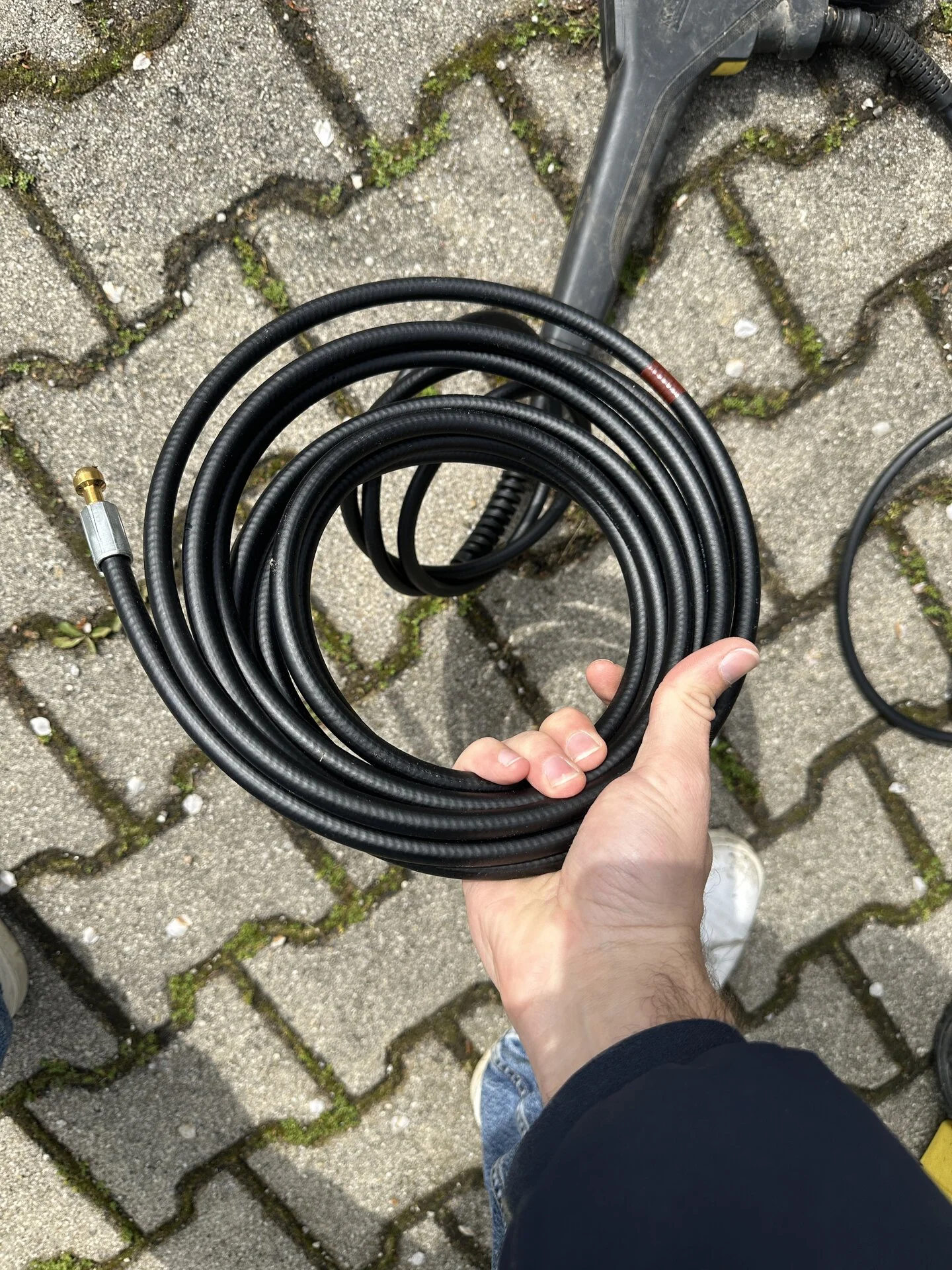

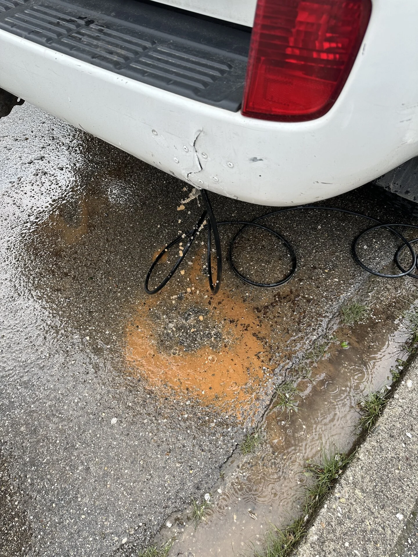

Today I got my hose for the pressure washer so I was able to clean out my frame since it had already like an inch of sand, stones and not too little rust in it.
The orange sand is pure Sahara sand 😄
As Tek mentioned, at speed and 68F is much different than uphill 3mph at 100F, a/c on.

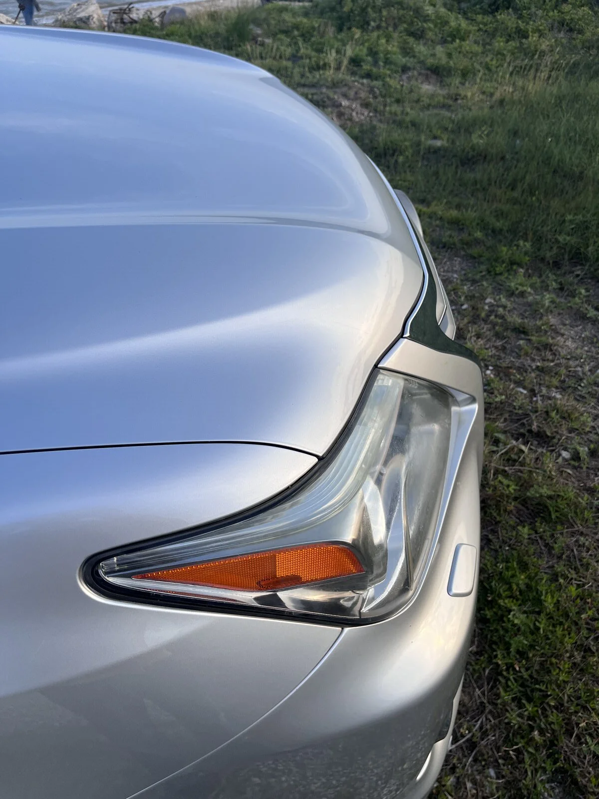

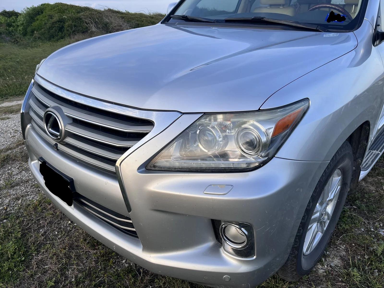

Removed the 10-yr old PPF from our used 2013 LX. Incredible transformation and shockingly was only around 6 hours of work. More details on the process with photos on this post.
Before:
After:
Can you explain what you're doing here? i've heard of washing the frame by connecting a hose or something, is that what's going on? I just spend a while with a pressure washer but wonder if i'm missing a critical area and one day find i need to make a "is this too much rust" post.... i get a lot of beach sand laced with salt.
