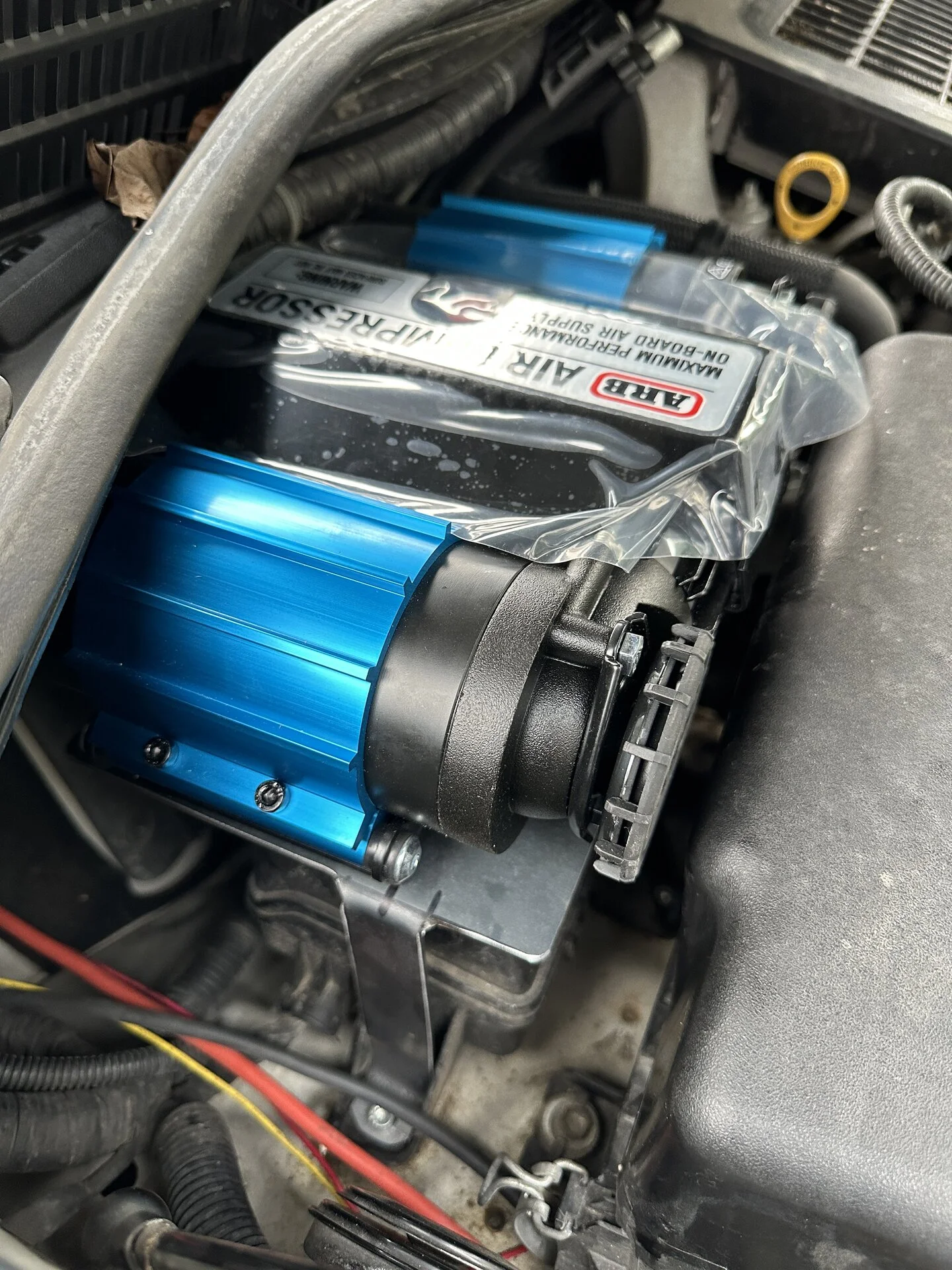

Since i got an brand new ARB double compressor for cheap on ebay (250€…) I had to think about a place to mount. I didn’t wanted to have to pull long cables so it had to be the engine bay behind the airbox since my 200 is a diesel. After some research there are only companies in overseas who produce mounting plates an this absolute overpriced in my opinion (incl the problem that most US companies who do offroad stuff are not willing or simply too stupid to send overseas while this is never a problem from any other parts of the world…) bc with shipping and import taxes I’ll end in the high 300s or at least low 400s for some bit of metal.
So I made the decision to build my own plate 😅
Got a plate with a dimension of 500x500mm and did a little bit of cutting and bending. After an hour I was happy with the result and sprayed a bit of paint.
Now I have to wait for the manifold after I found out it is needed for the double compressor (a shame ARB only put the most most most basic stuff into this oackage) and the I can mount everything. 👍

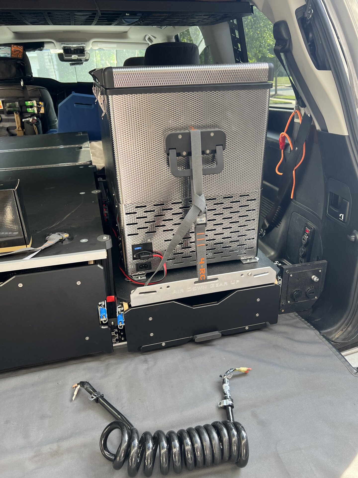

Finally replaced the power cable to my slide out fridge. Been wanting to do this for ages.
Replaced this bulky coiled cable with ARB cable guide.
Wasn’t sure which way to mount. A few options. Ended up attaching a bracket to ADGU frame and screwed end of the cable guide to it.
I have Anderson power connections from main and aux batteries for flexibility.
A photo with it pushed back in and latched. ARB bracket is mounted to fridge slide out. Guide connected to bracket.
@Kyle Bell @suprarx7nut I’m loving the ADGU drawers and kitchen slide out!

Can I see a photo from the tailgate end with the fridge extended and another partially retracted? I need to do this with my ADGU system with homemade slide and NL fridge.
Thanks!
