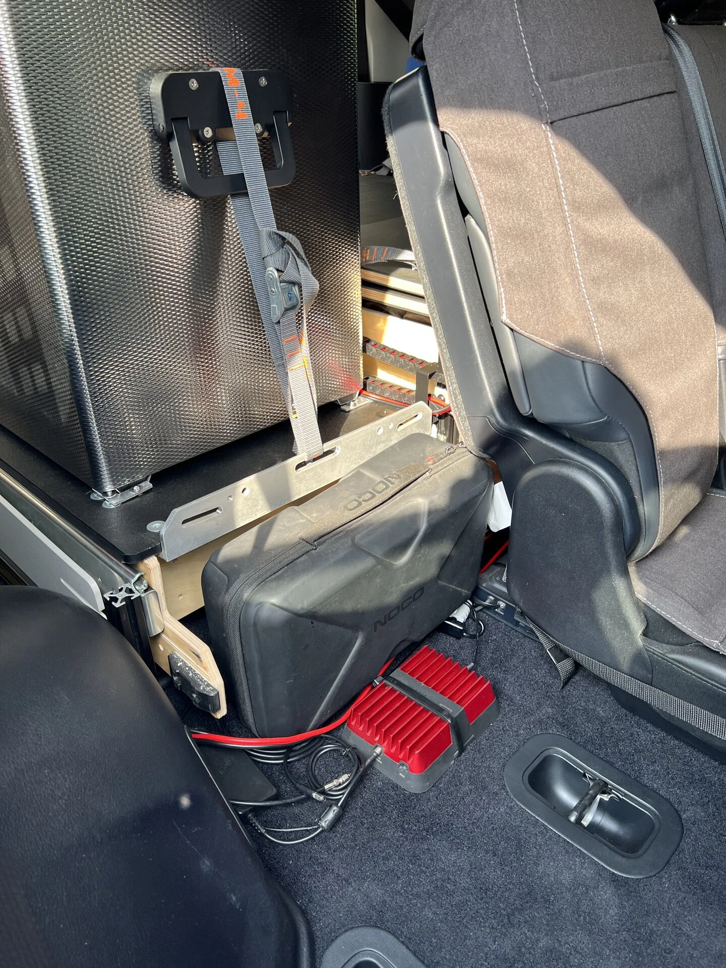

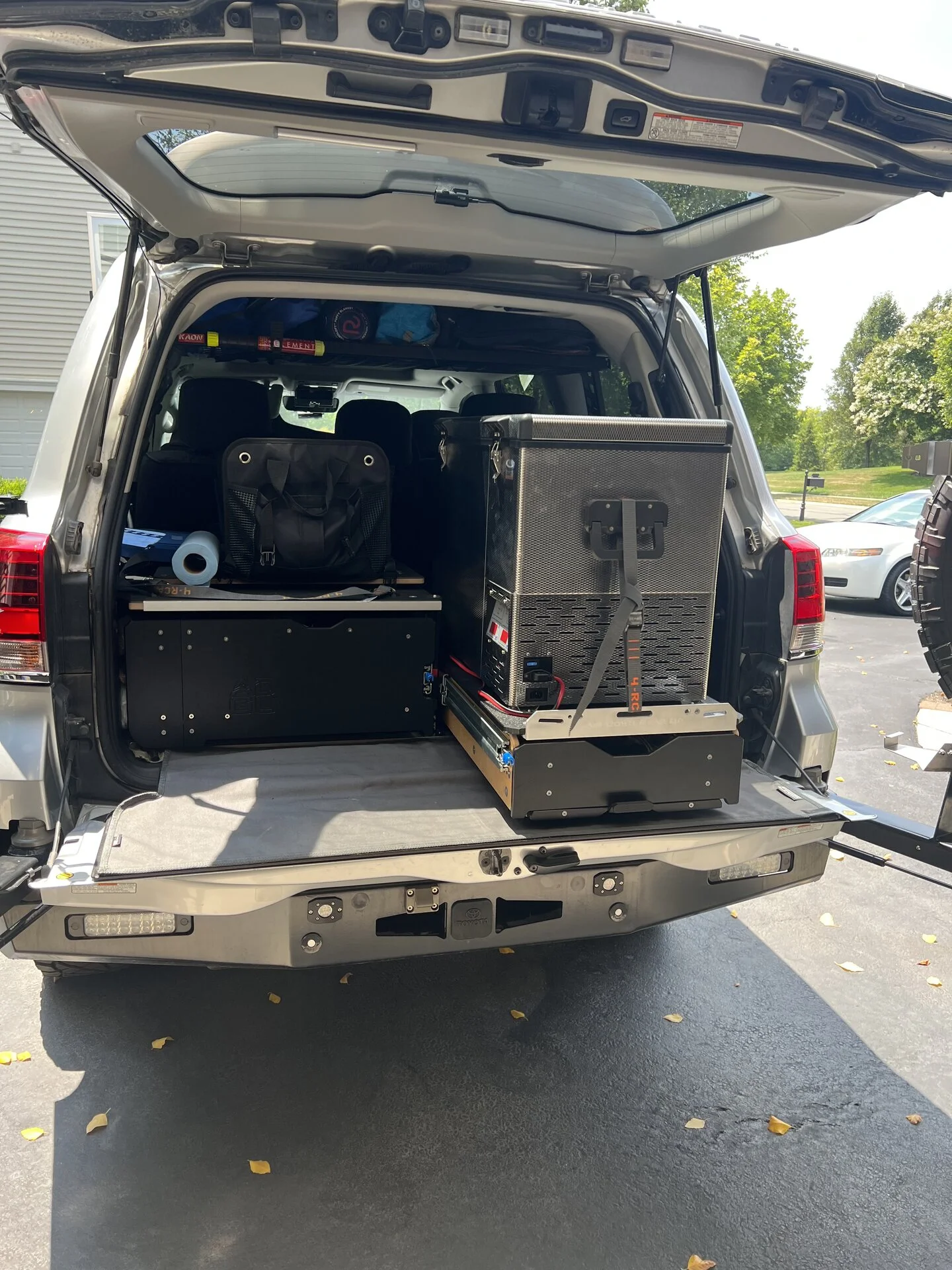

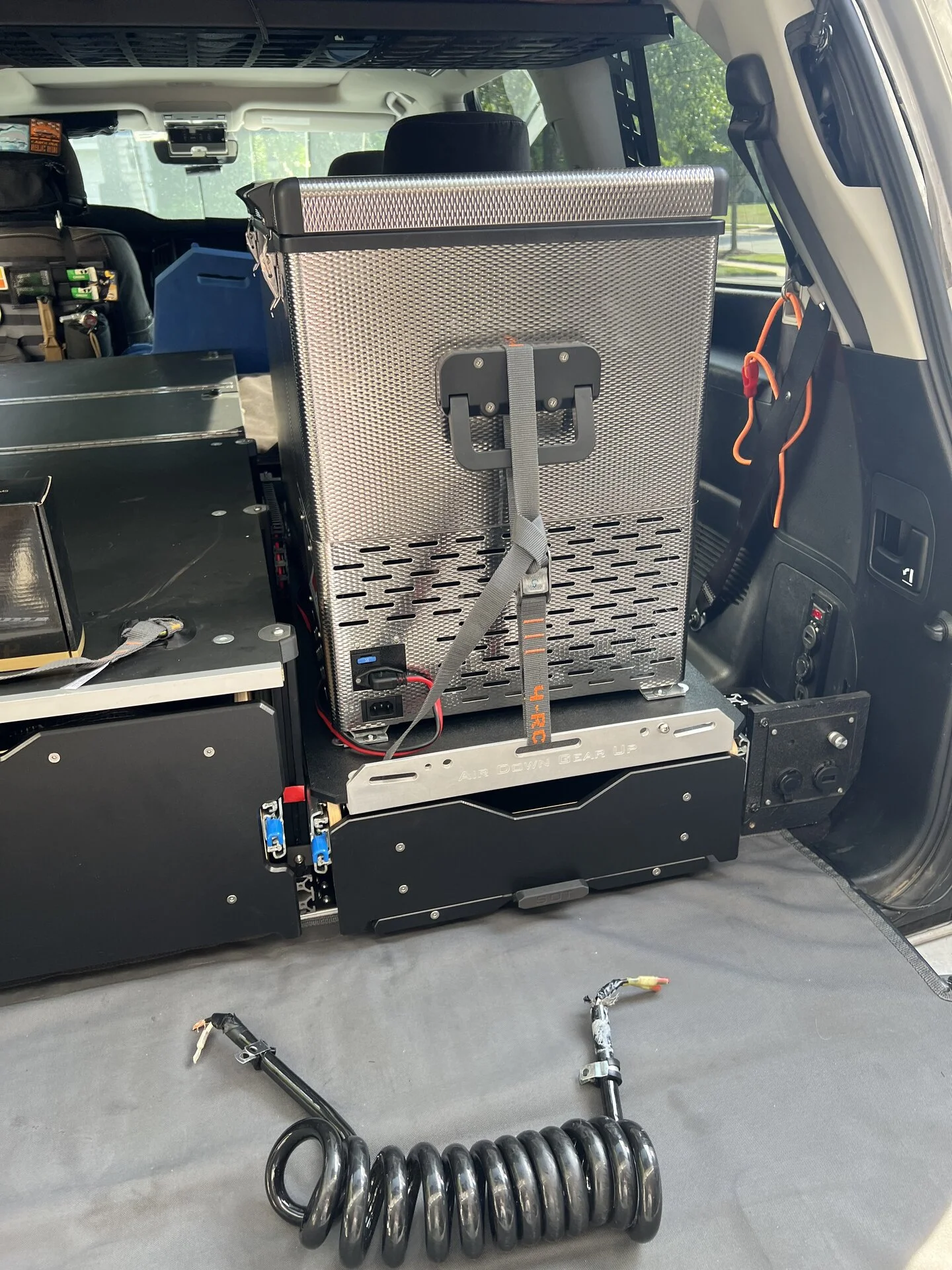

Finally replaced the power cable to my slide out fridge. Been wanting to do this for ages.

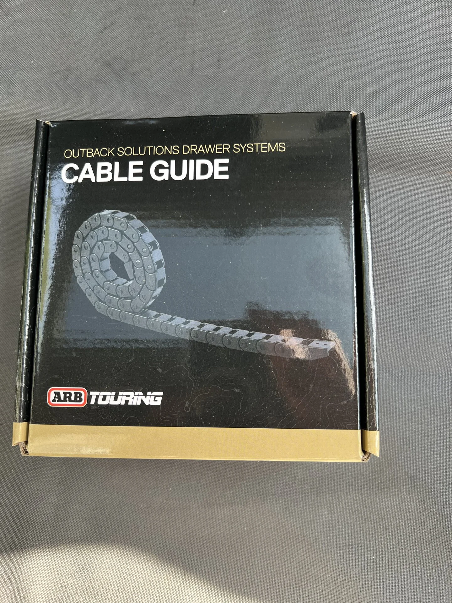

Replaced this bulky coiled cable with ARB cable guide.
Wasn’t sure which way to mount. A few options. Ended up attaching a bracket to ADGU frame and screwed end of the cable guide to it.
I have Anderson power connections from main and aux batteries for flexibility.
A photo with it pushed back in and latched. ARB bracket is mounted to fridge slide out. Guide connected to bracket.

Nicely done! That's definitely the way to run wires for fridge mounts.
For others reading, there's nothing special to the "ARB cable guide," it looks like a standard Cable Drag Chain, of which there are a million cheaper options on Amazon.
Thank you. So the guide lays along the top of the first fixed section of the slide, but beyond that, the power cord is loose? No problem with it getting caught when retracting? I’m not sure I see how this is better than the coiled cord.
For reference, with the NL fridge on the Tembo Tusk slide in my old 4Runner, I used a bungee cord under the fridge to keep the power cord snug.
There is no loose cable, that’s what the guide is for. It sits on top of the slide out, left hand side. Lower than the ADGU drawer to the left of it.
I originally had the coiled cable to the right of the fridge. It was a stiff cable. During trips, gear loaded to the right of the fridge would often interfere with that cable when pulling fridge out to access with gear still in truck. One of the pics shows bungee cords that I used to hold gear preventing it from falling into the right hand side of the fridge slide out.

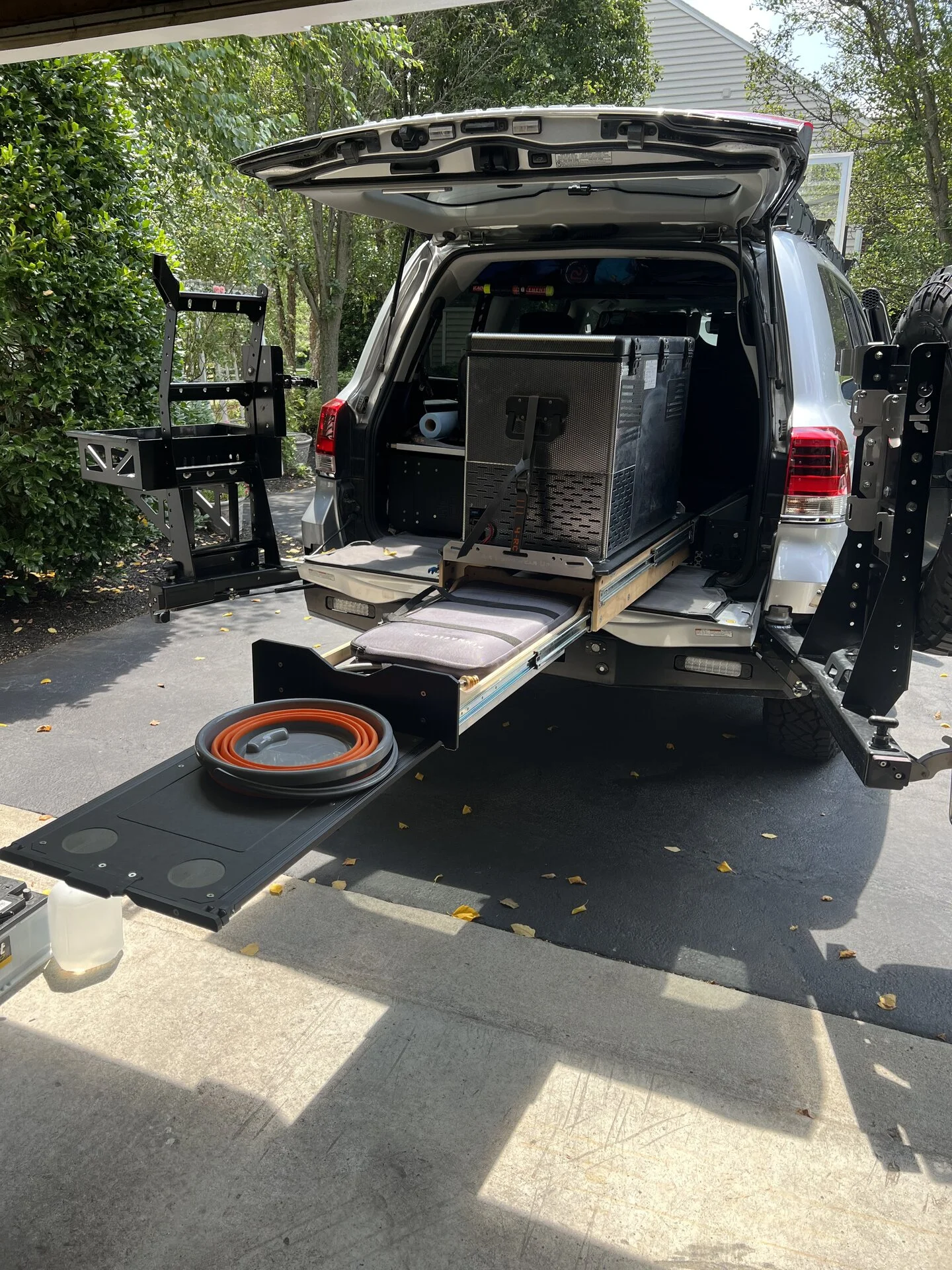

Video in operation

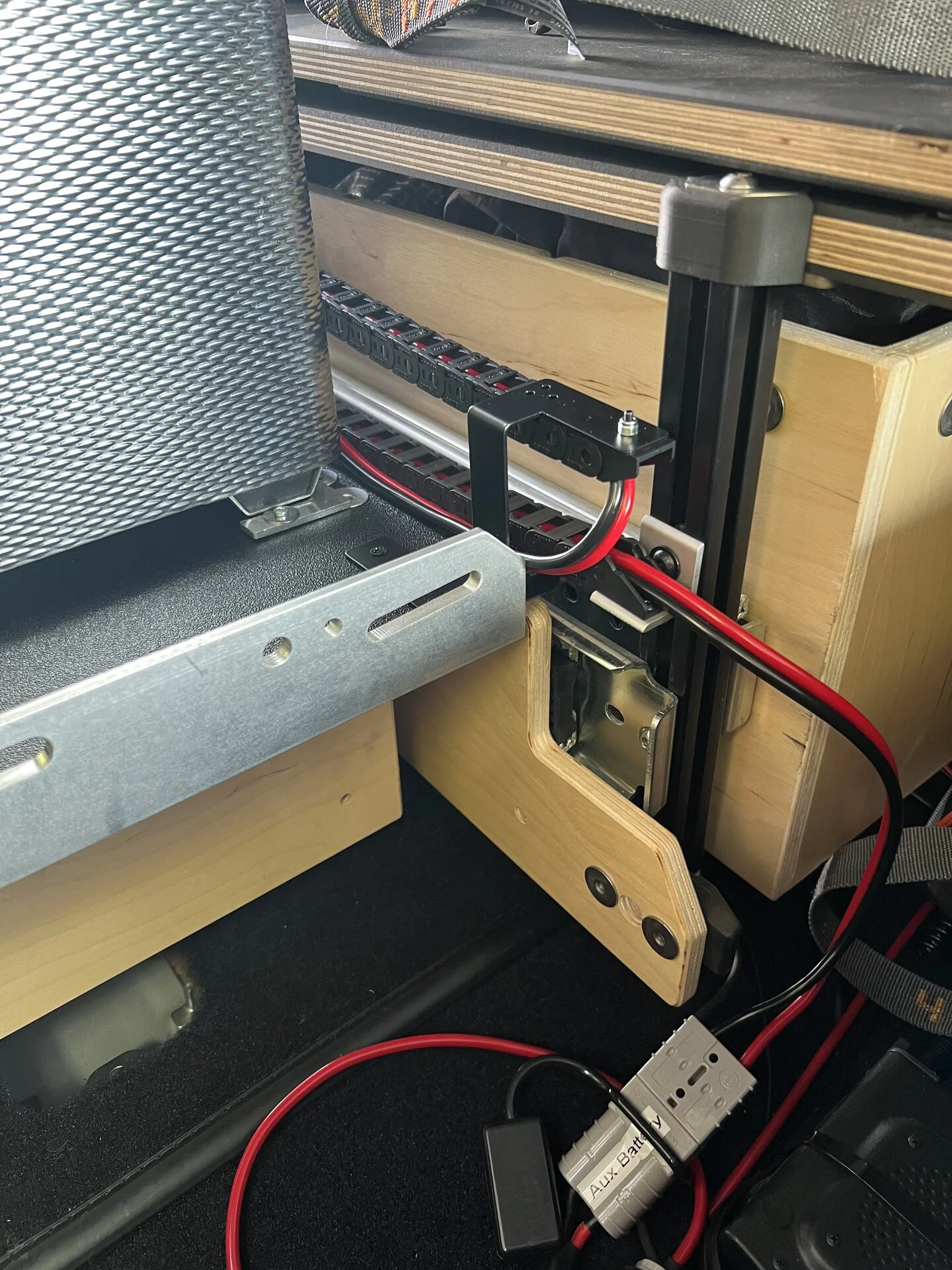

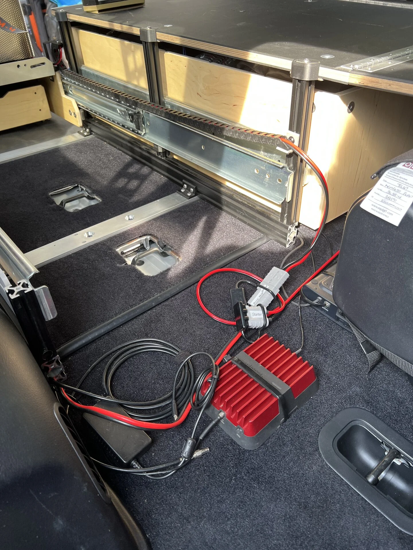

Another pic until then.
Note: the wire coming out of the top bracket is fixed, it goes to the power input of fridge. Below that is a fixed bracket, with wire coming out to Anderson connector. The cable does not move inside the cable guide.

Video in operation
Ahhh! Now all is clear. Thank you so much forsaking the time to help me understand what's happening there. That will be perfect for my similar setup.

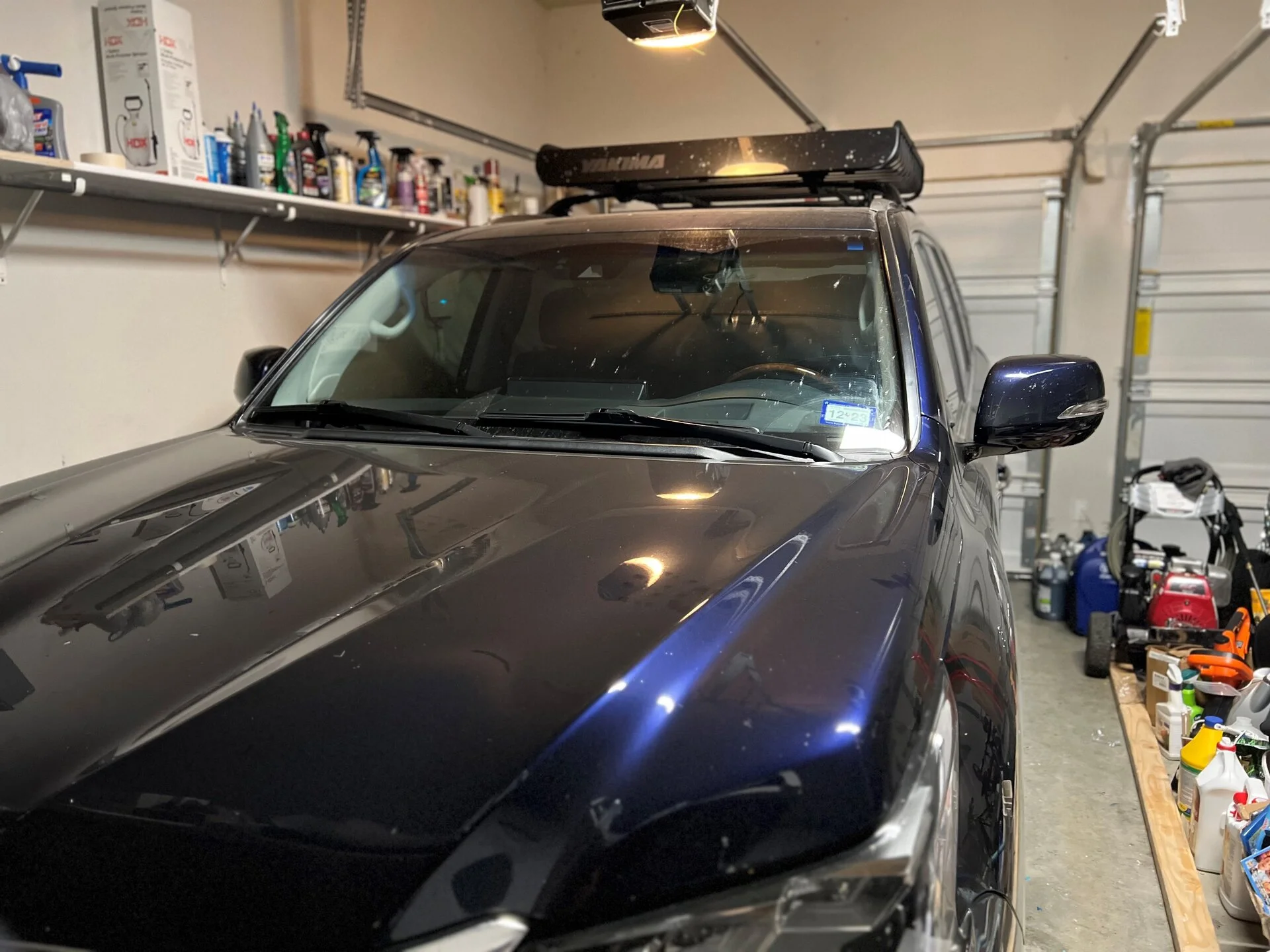

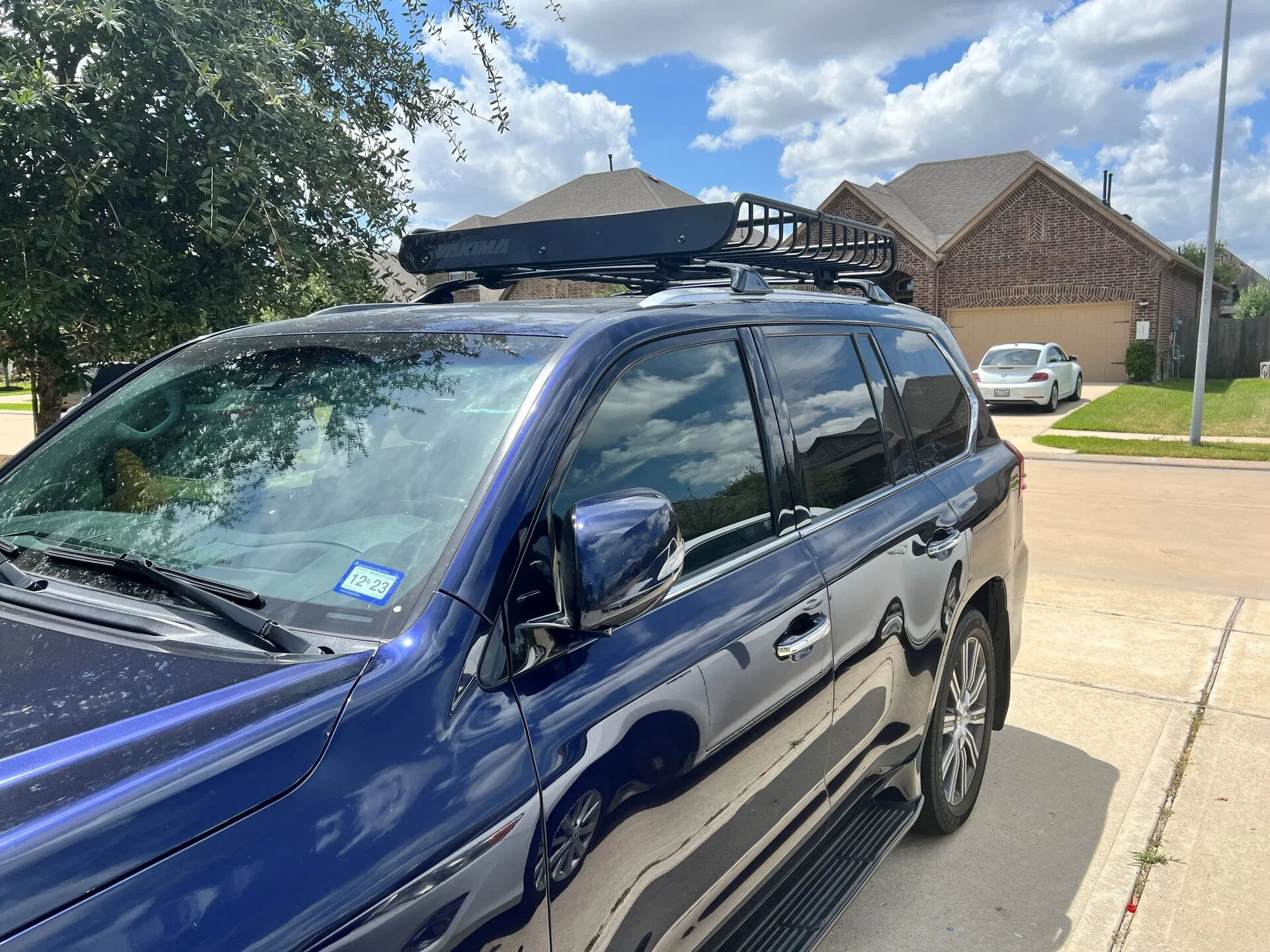

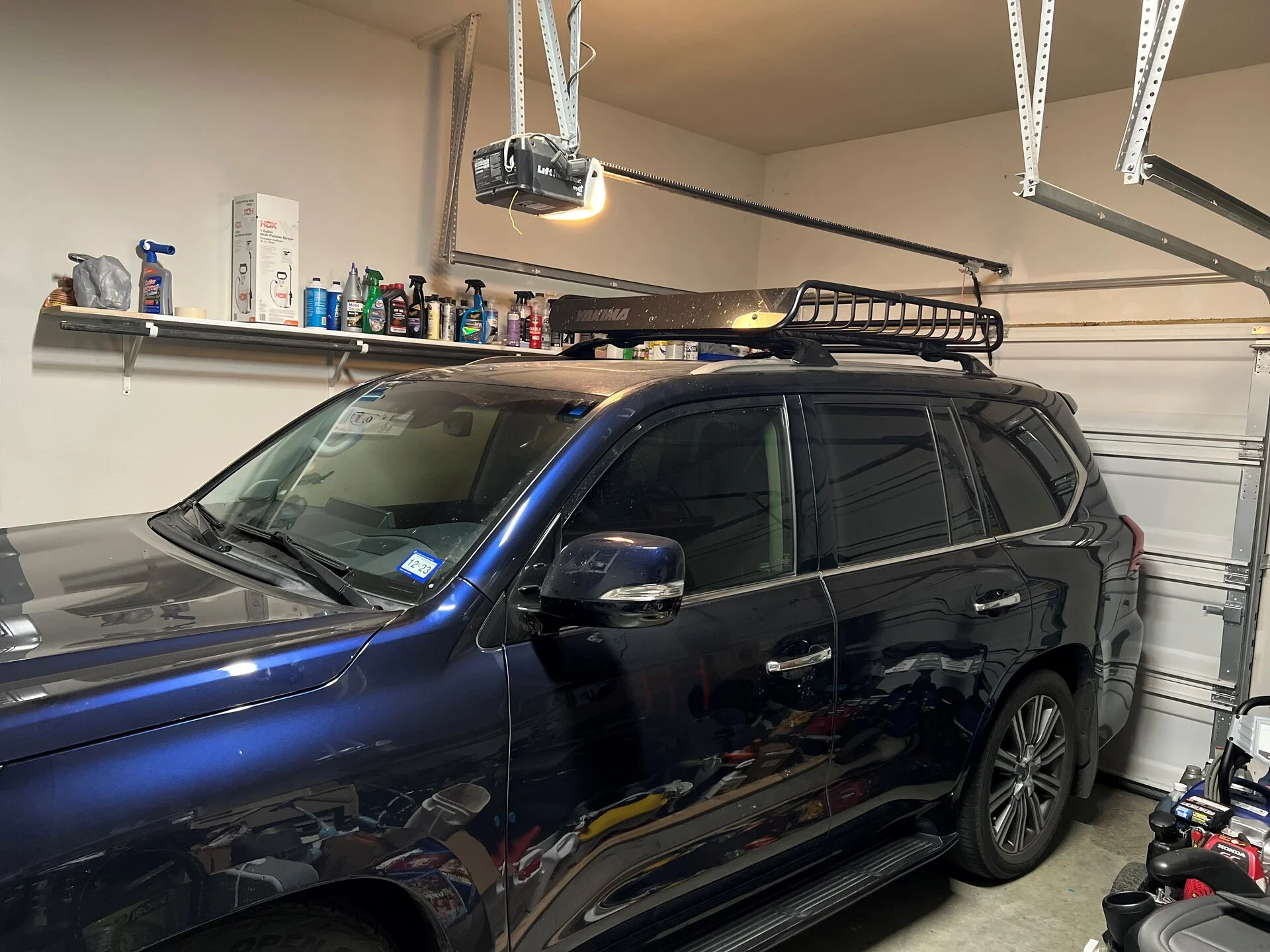

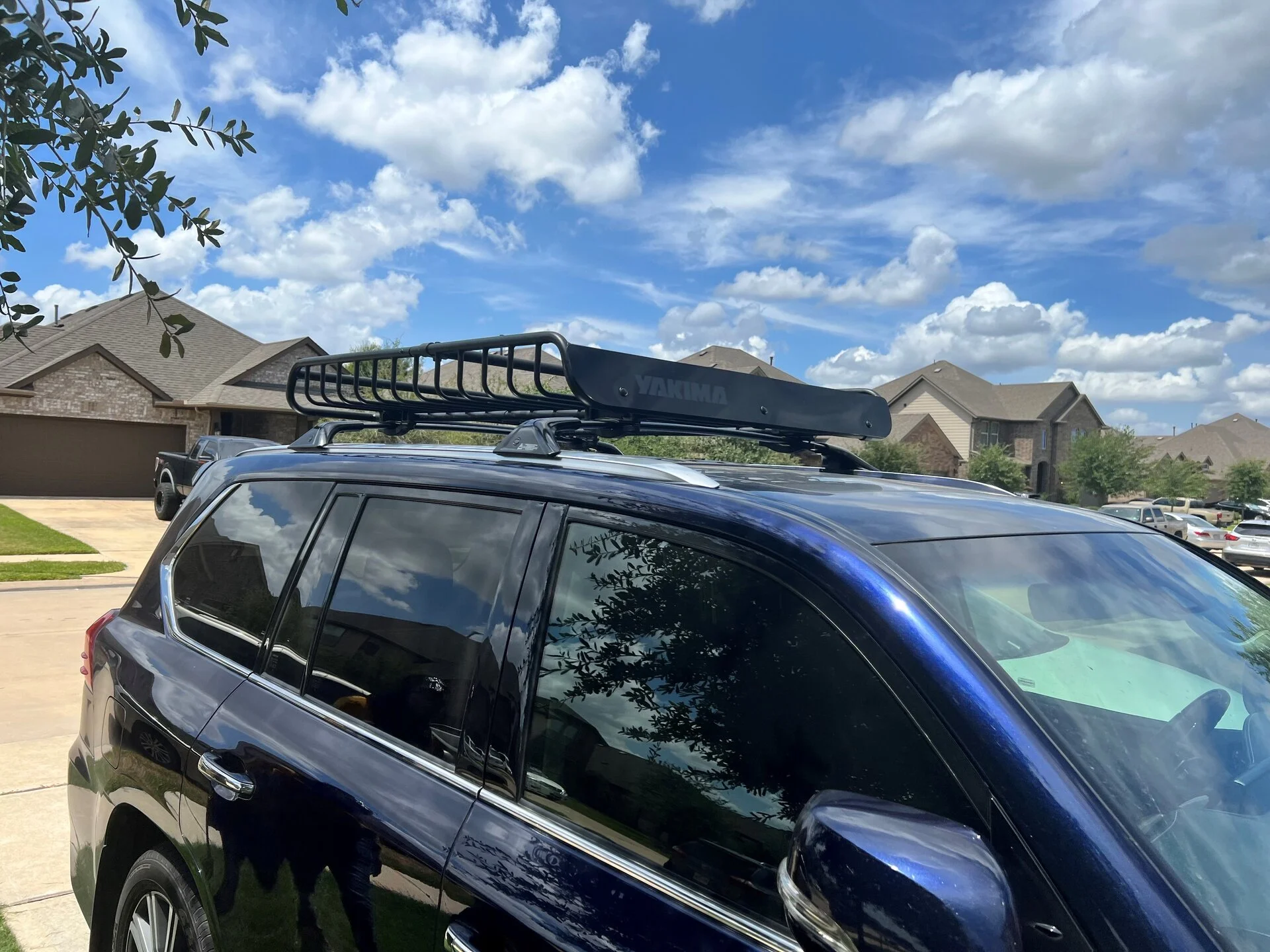

Picked this Heritage roof rack from a fellow mudder here. Thanks for the donation @MCtree
Installed using OEM roof rails and OEM cross bars, did not want to mess with dropping the headliner. The Lexus OEM cross bars distance is little bit off from the Yakima tabs, so the footing are about 1-1/2 to 2 inches off from center of cross bars but still fit very snug and solid.

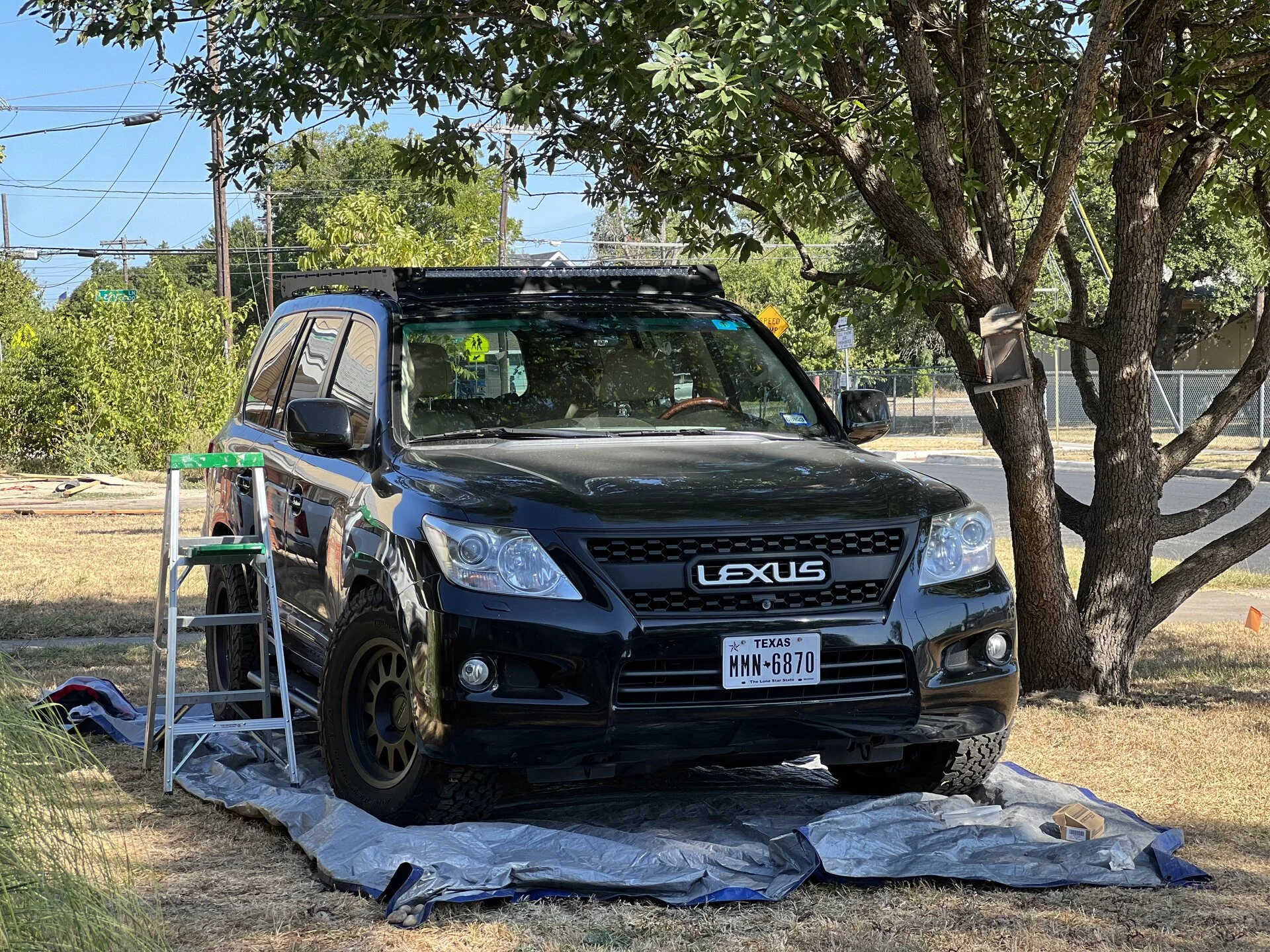

digging that front grill. what is your wheel tire setup?
Thanks man! The wheels are Method MR704, I'm pretty sure it's a zero offset, which means they will stick out about 2" more than stock. The Tires are K02's @ LT275 /70 R18. I bought them all from Discount Tire and they hooked me up (slightly) with a discount. Getting home was an adventure as they were rubbing like hell. I had to pull off the mud flaps and bang back the flap mount a bit. Then watched some videos on how to bend back fender liners with a heat gun. No rubbing now!
Note that grill, I'm not 100% into it, I would rather get my stock grill painted or wrapped black except for the logo, but the shops I talked to don't want to paint on chrome (or chrome plastic whatever) or wrap a grill. So I've been trying to find other options.
Just fit into the garage too ;) sweet blue color.
Barely cleared with suspension in low, phew. Yes love the color, matching gx and lx same color.

I've seen some guys plasti-dip their grill and it looks pretty good. Would probably have to be touched up every couple years for rock chips. But cheap and non-permanent.
Sounds like you need to find better shops. Ed Martin Toyota wraps a bunch of grilles as part of their builds they do.
Ed Martin Toyota also paints them. Etching process as well. It's more $$$
