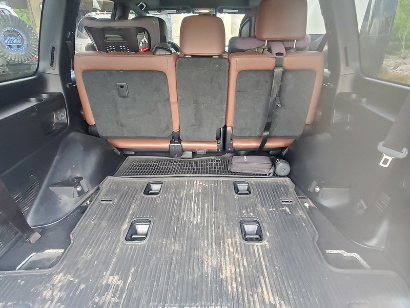

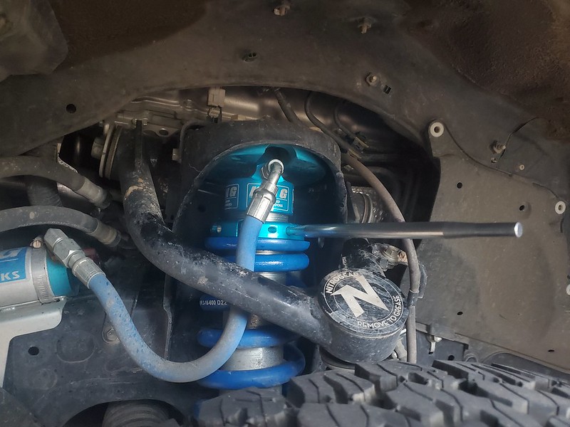

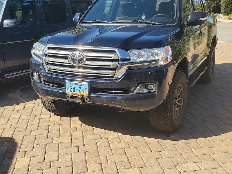

SDHQ hidden winch install. Decided to try a Badlands Apex 1200. For under $600 with synthetic rope, I don't think you can go wrong. Install almost looks factory. Then third row removal. Still need to order the Heritage cargo mat. Also tweaked the preload on the front Kings to offset the weight of the winch. Going in for an alignment tomorrow. Big thank you to @bloc for finding a random Toyota part (1KZ turbo manifold bolt) that works really well for getting the adjustment collar past the reservoir hose, using a hammer and punch. Took all of 15 minutes per side to do 6 turns each.

Been debating on the hidden winch mount for a while now. Did you do an in cab control? Where did you mount the solenoid box?

This was actually an easy install that took all of an afternoon. I kept the solenoid box on the winch. It fits just fine after some minimal trimming. The SDHQ mount does come with a relocation bracket, but I don't see any advantage to relocating the box. I am able to get the wired controller into the box without any issues. Access to the lever to engage/disengage the clutch is not bad either. While in cab controls are pretty slick, I run 4 winches on various Landcruisers and use wired controllers on them all. Winching is not something I try to do on a regular basis, and it takes me all of a minute to plug in a controller. The Badlands Apex has a wireless feature too.
Hey! I agree with you and ran this winch for a long time and had many successful, reliable recoveries. However you can go wrong in one specific way:
The duty cycle on this winch is 45 seconds with a 15(!) minute cool down. I over extended mine and not only did it cook the solenoid (which is easy to replace) but it burnt the drive unit out (hard to replace). I replaced with a Warn EVO.

That is good to know! Just looked at the specs and yes....05% duty cycle. I may add a 500A fuse or breaker to help slightly protect it when pulling at close to its max rating.
And use my snatch block more.

Yes good call. I still recommend this winch FWIW. Great option if you are patient with it.

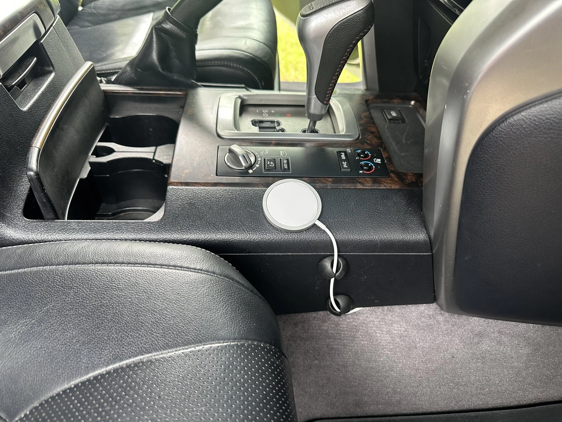

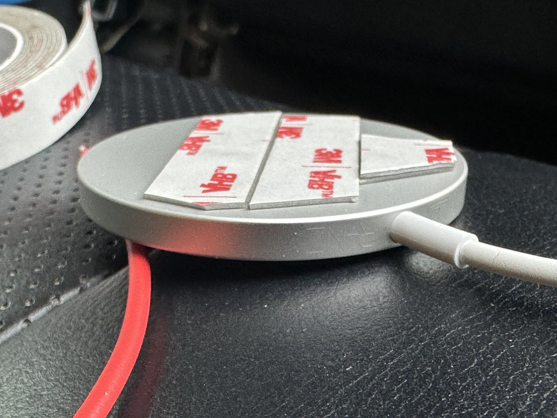

Wired up a MagSafe puck to get my phone out of the cup holder and preserve the lightning port. Worked very well over a 6k mile trip to PNW.

Nice, magnetic mounts are great. What did you tap? 12v or USB?
I always wondered how to do this but given the charging circuitry is in the puck, I think you can just give it DC and ground on 2 of the usb pins?

I tapped the back of the lower cigarette lighter, wired to a 12v cigarette lighter socket tucked into a pocket under the HVAC ducting, then taped a high power Belkin USBC charger in there. I first tried a 12v to USBC power supply on amazon but it apparently didn't have the power to run the magsafe puck. It would charge on lightning cable just fine (though I don't know how fast), but the magsafe showed no charging.
I'm not familiar enough with whether the 12v leg of USBC needs to be "clean" or whatever.. or if it actually uses the 5V leg instead? The above was more hardware and cost but I know everything will play nice.
