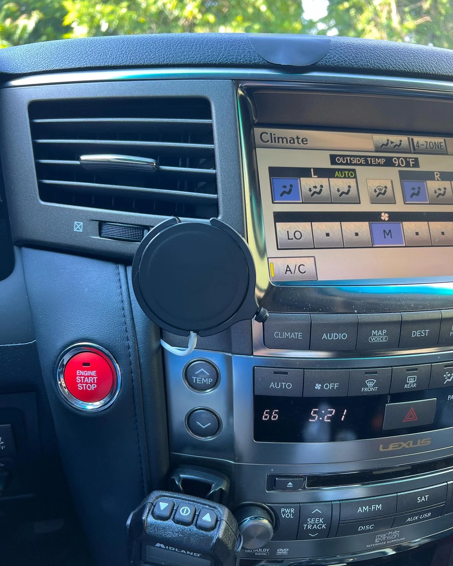

I tapped the back of the lower cigarette lighter, wired to a 12v cigarette lighter socket tucked into a pocket under the HVAC ducting, then taped a high power Belkin USBC charger in there. I first tried a 12v to USBC power supply on amazon but it apparently didn't have the power to run the magsafe puck. It would charge on lightning cable just fine (though I don't know how fast), but the magsafe showed no charging.
I'm not familiar enough with whether the 12v leg of USBC needs to be "clean" or whatever.. or if it actually uses the 5V leg instead? The above was more hardware and cost but I know everything will play nice.

Honestly, that route is way better / safer / correct.
The charging circuit will negotiate voltage and power with the brick, and not a lot of stuff will charge above 5V that I know of.
Those specs lie in the USB-C PD standards. Not what iPhone uses, or whatever magsafe does...
So wheres a lightning cable will "pull" 5V up to 2 amps I believe (10W) standard, it can also negotiate from 12-24W as well.
iPhones still do not support ultra fast charge though beyond that. Nor do they come with a charger lol.
USB-C PD devices can go up to a 100W. The USB-C iphone and magsafe cables, I believe have the chip in the tail end of the cable at the plug.
You'll notice those are usually larger/longer and may even have an LED indicator on non apple stuff.
Thats where It might get interesting, giving that cable 12v might be possible, but where it fails is that USB controller requires host communications and handshake.

The single USBC adapter I got from Belkin states 20W which I felt was enough given my needs. I believe magsafe gives up some raw efficiency/speed for convenience. Belkin does make a USBC/USBA adapter that states 37W but I'm unsure whether it can provide all of that on just the USBC side..

Wired up a MagSafe puck to get my phone out of the cup holder and preserve the lightning port. Worked very well over a 6k mile trip to PNW.

Another option with the oem magsafe is the pro clip USA holder. It's served me well.

I’m confused. That’s not the proclip mount, or at least not one they currently sell. Their design attaches to the top and the bottom of the vent.
It’s just the holder for the MagSafe charger, it’s not vehicle specific. You can attach it to one of their mounts or wherever you like.

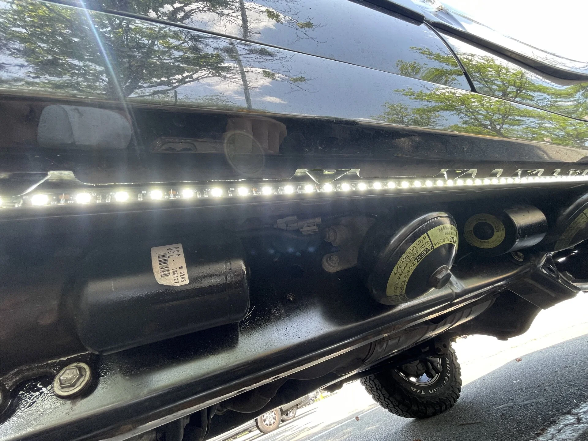

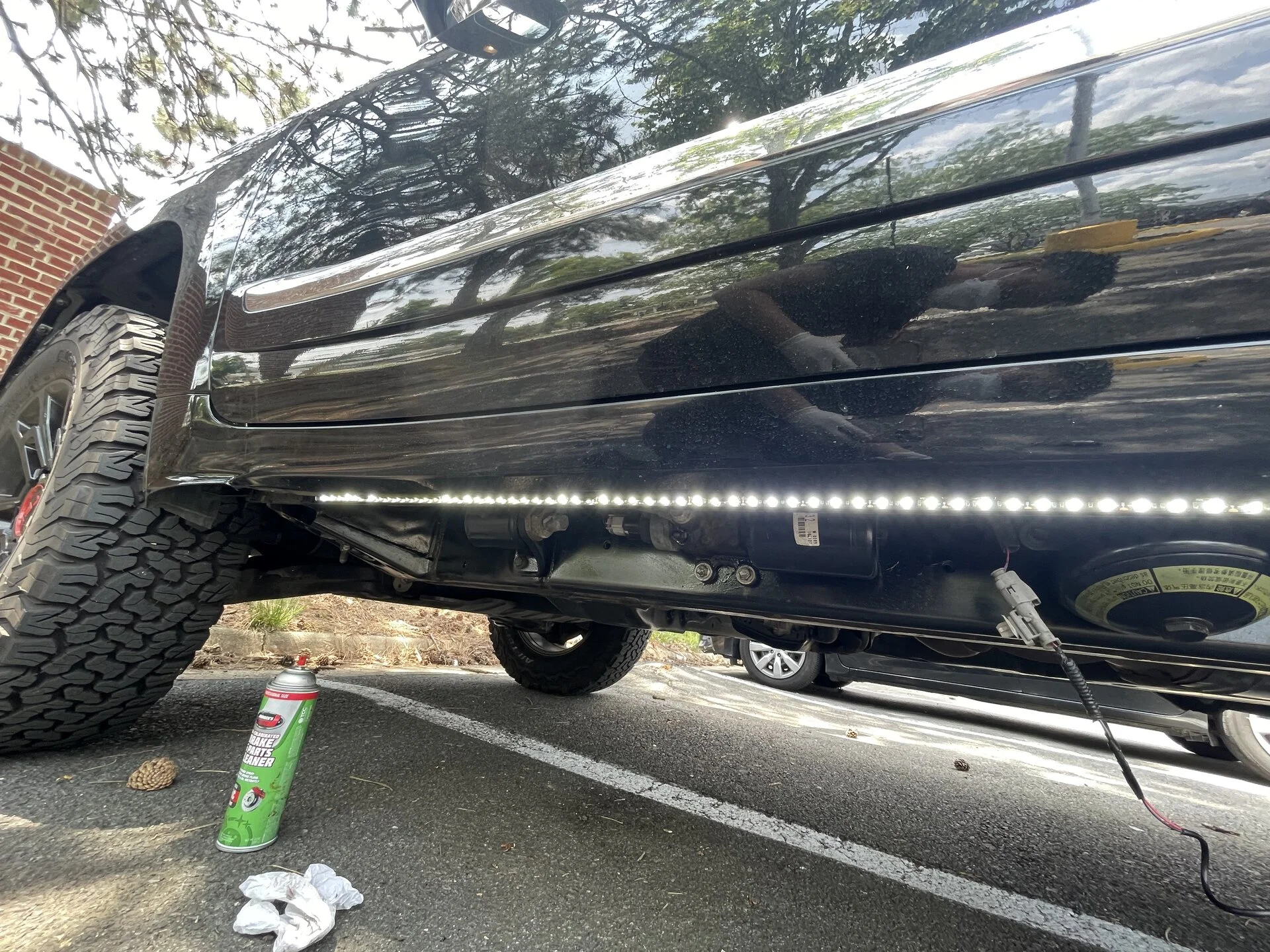

Removed runningboards and added a strip of LED light, it’s dimmable and is 60” long. Sliders should be here today then I can slap them on. The wetness you see is Fluid film, nothing is leaking, We're headed to OBX this weekend for some beach driving so i want to protect it from the salt first

awesome. I have sliders coming tomorrow and was thinking about something like this. Did you reuse the factory connector and if so, how? Where'd you get the lights?

Yes, cut off the factory connector from your runningboard and splice the wires into the LED strip lights and plug it up. These are the lights i used

Got pics of the connection?
The top pic with the wire hanging down is the connection, simply splice the wires and tape them up with electrical tape and plug it in.

I think my confusion would be around the connector you're splicing onto the new LED light wired. that would have to come from the existing running board lights, right?
