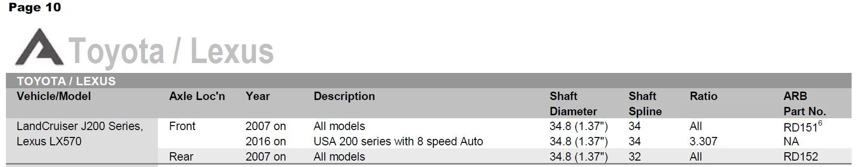

What locker is available for the 2016+ on the front?
I was thinking of going with ARB lockers and part number RD151 (front) and RD152 rear however the ARB documentation says
"2016 on USA 200 series with 8 speed Auto 34.8 (1.37")=shaft diameter; 34=spline 3.307=ratio NA=availability" meaning the 2016+ USA version has a gear ratio of 3.307 in the front diff and there is no ARB front locker vailable for it? .. If I am reading that right?
I think it means the "RD152" can be used for the rear and nothing from ARB is available for the 2016+ Front .. is that correct?
Looks like this:
