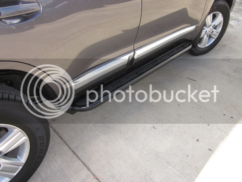

My sliders arrived on Thursday, so I’m sure you all know I was chomping at the bit for the weekend to come. Well. I’m not going to say this was an easy install, at some points it was really frustrating, but I will say that I volunteered myself into quite a bit more work than I think Slee intended (what can I say, I’m an overachiever :D)…

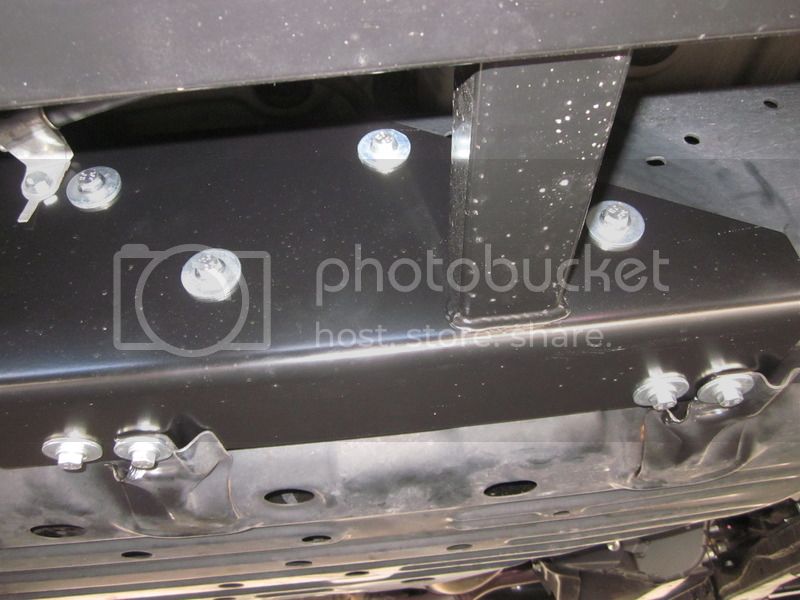

Here’s what I did different than the instructions:
· The sliders come with 16 riv-nuts, but since there are plenty more holes in the frame and sliders than that, I proceeded to use every possible mounting hole. In all, I believe I installed 26 riv-nuts! Since there’s pretty much no way to get a drill into many of the upper holes, I enlarged the existing frame holes with a right angle die grinder.

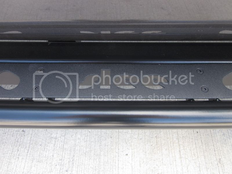

· The sliders are supplied with silver screws to mount the footboard to the tubular frame and I’m not really into that look so I ordered some black stainless screws instead. I feel as if it’s a huge improvement.
· Replaced many of the factory bolts with my own bolts as opposed to using up the ones provided. This left me with more matching bolts for the riv-nuts.
