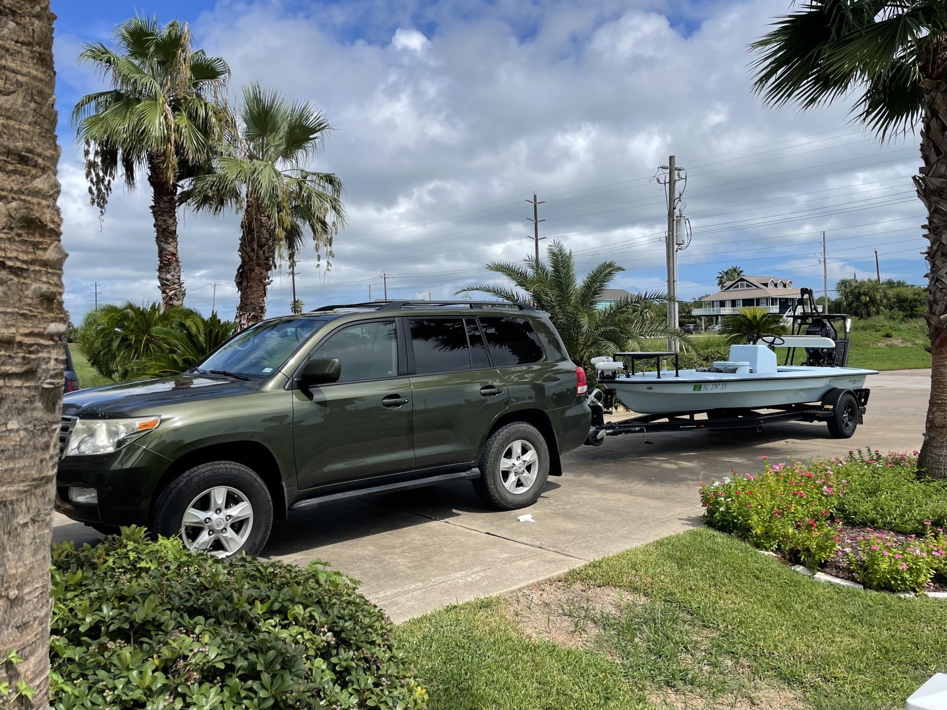

Hooked the new fly rig up and hauled it to the coast, of course barely noticed it was back there.
Nice boat! Had the pleasure of fishing out of one in Florida last time I was there.
Picked it up to replace my HB Waterman and I’ll say it is definitely an upgrade, it’s virtually silent on the pole.

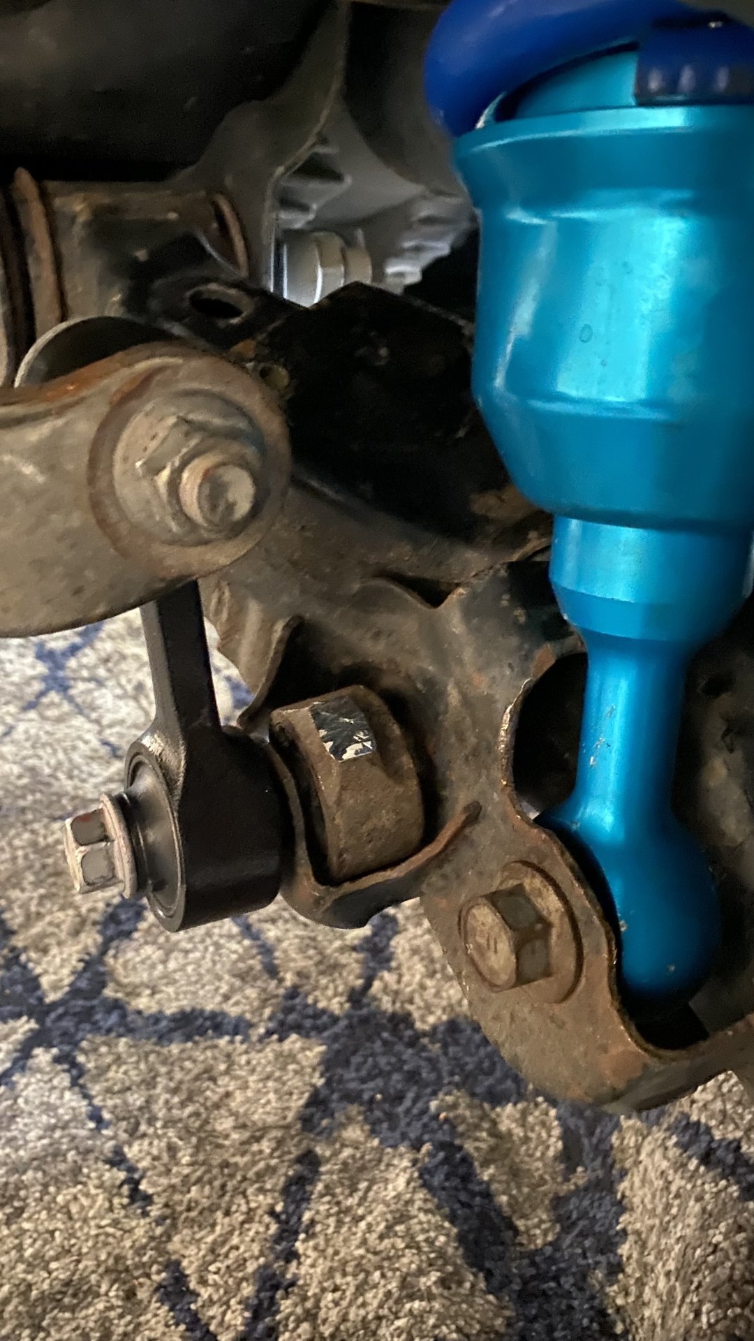

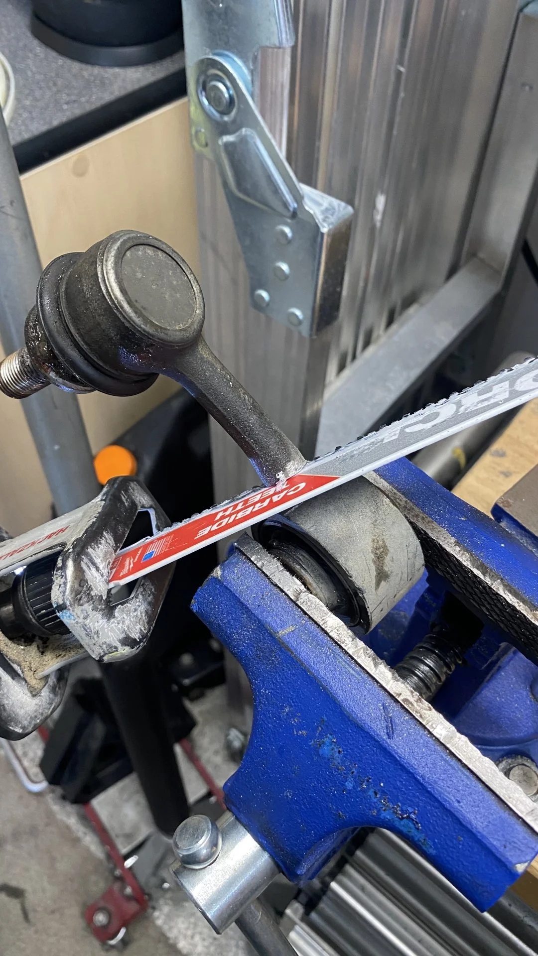

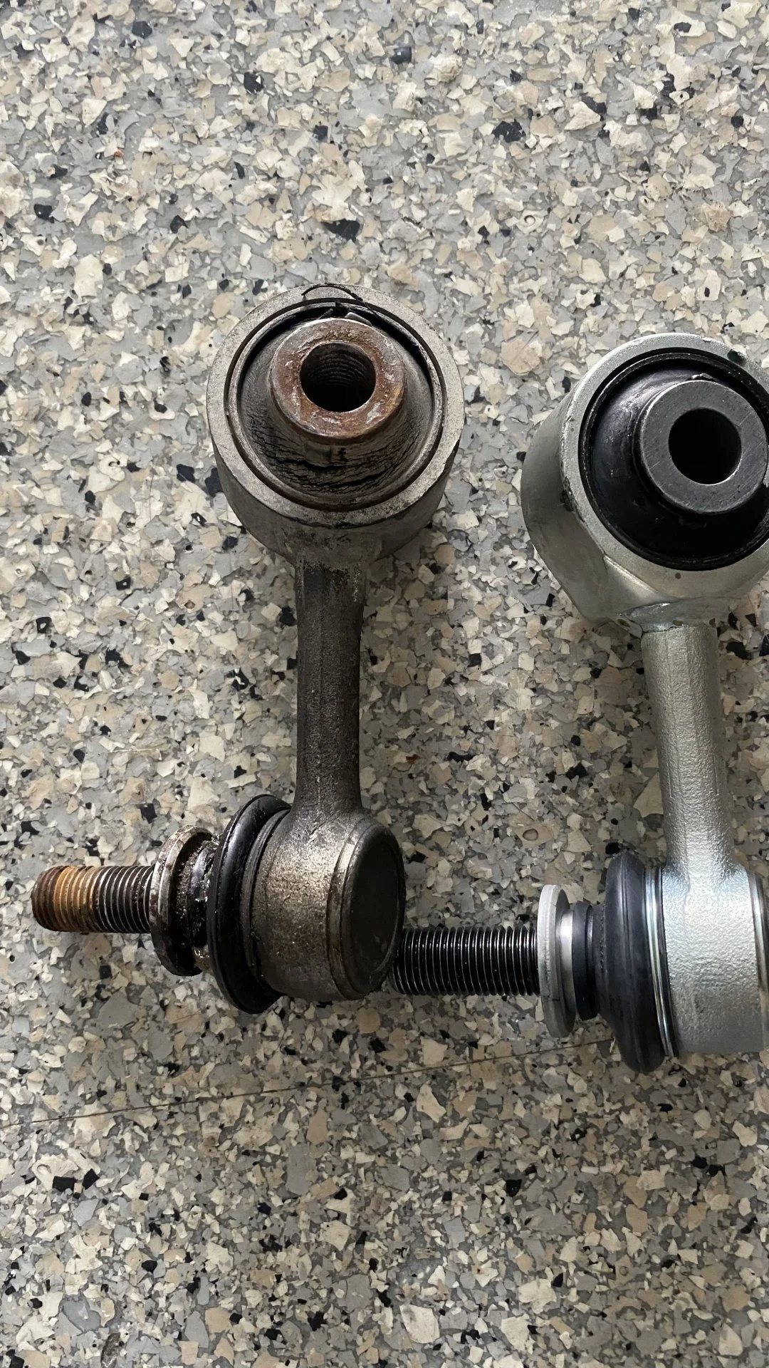

Installed new oem front sway bar links since my original ones were toast from running a kdss relocation kit to clear my 35's. I also used @linuxgod method of conserving my new sway bar links by mounting them outside the bracket. He gave me a tip to use my old front diff bolts which I did have laying around. I also cut my old sway bar links and used them for the spacers needed. Time to take a test drive to see if this handles like it's on rails!?!?

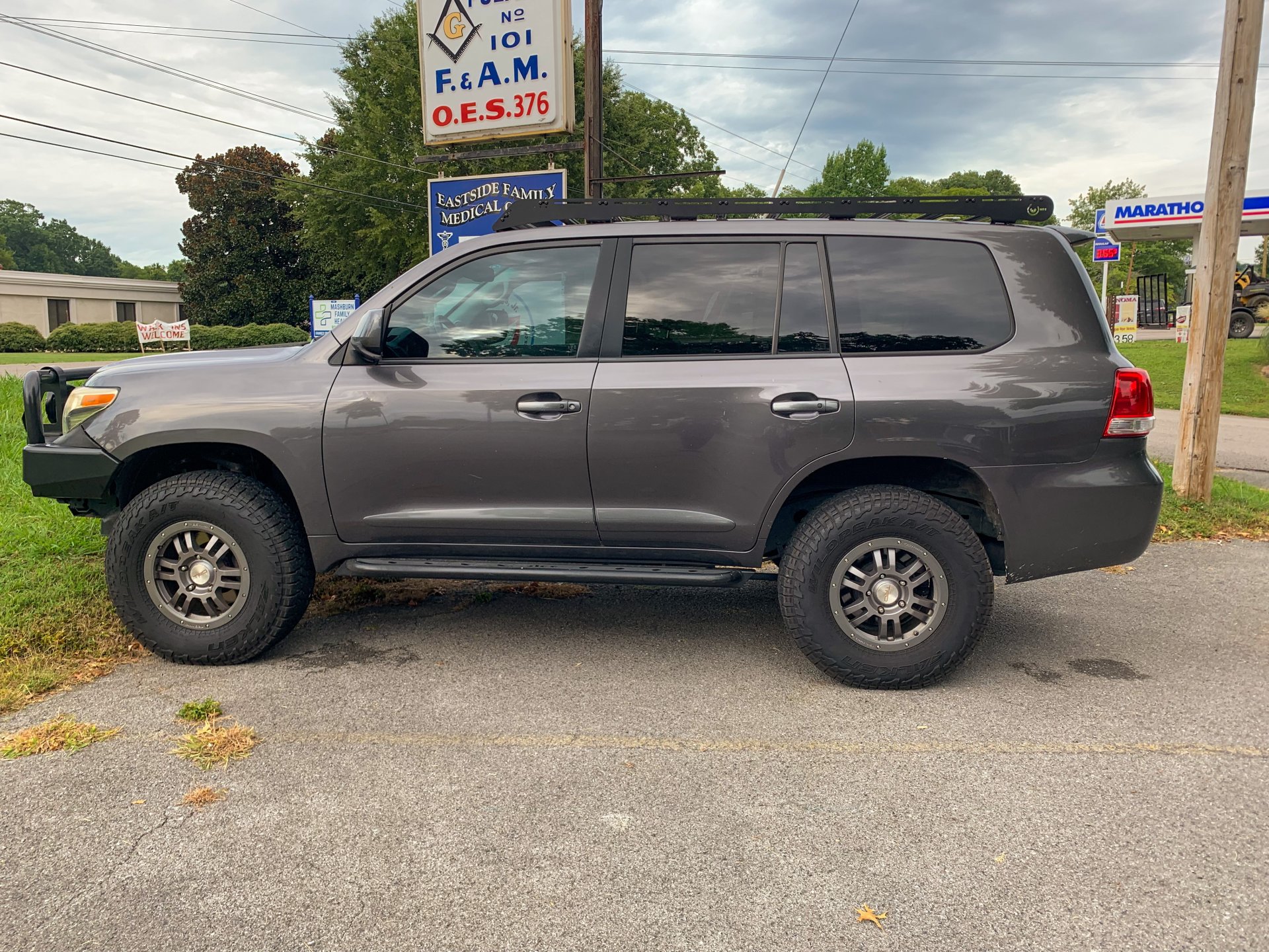

Finally disconnected AHC suspension module that makes my LX570 identify more as an LC200. Installed Old Man EMu about 6 weeks ago, and finally removed all the AHC hardware.

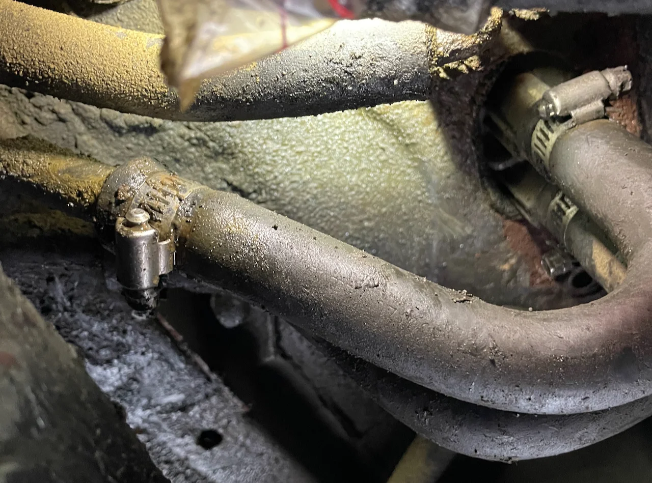

Rear heater core started leaking where the rubber pipes mate to the metal. Changed clamps, OEM were rusted and one was starting to leak.

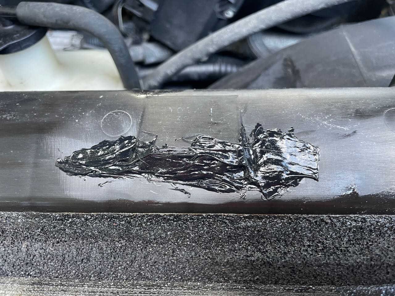

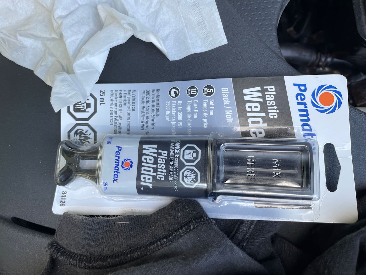

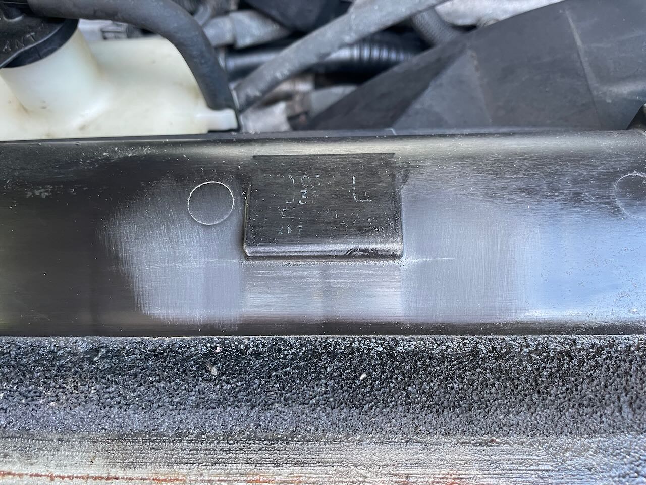

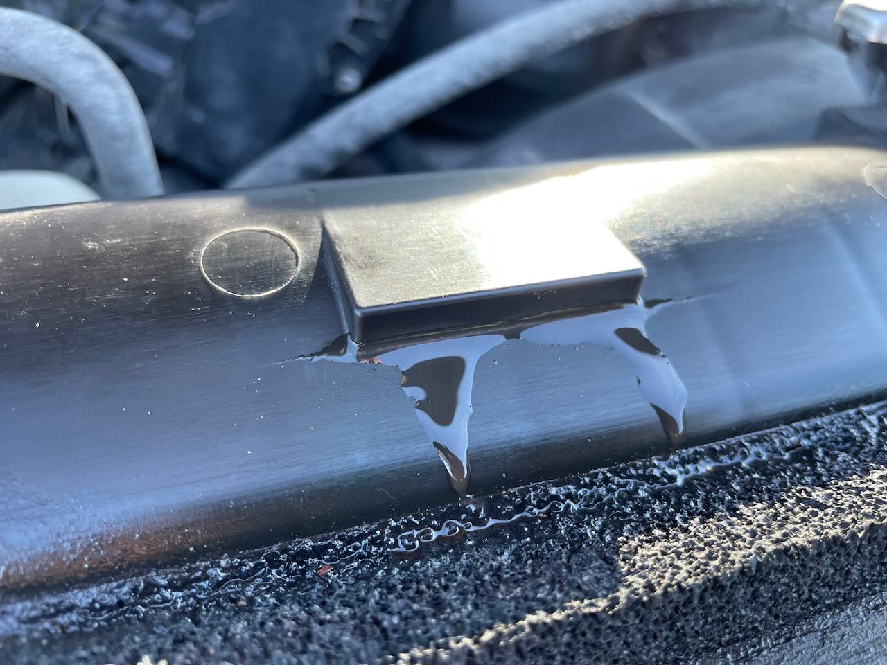

Ordered new radiator, and patched current one with plastic epoxy in the meantime. Wondering what else I should change at the same time. water pump I guess?

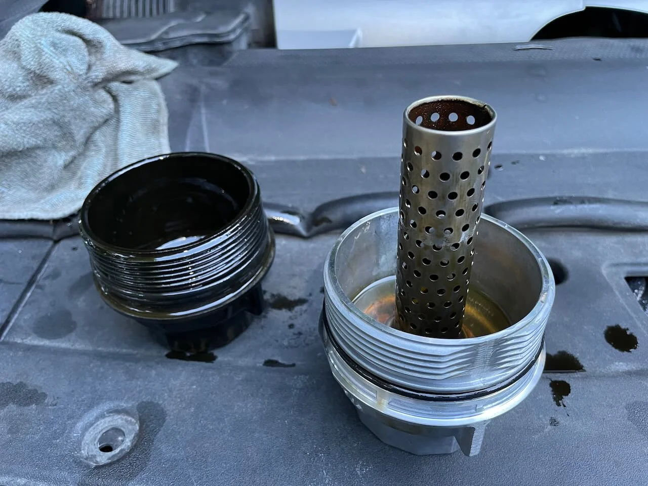

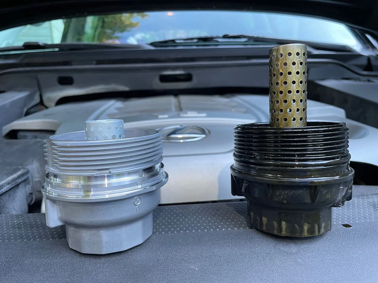

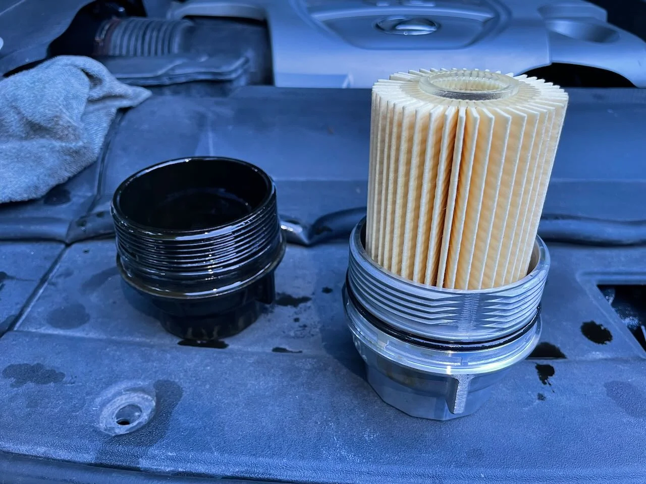

Changed plastic oil filter cover for aluminum one, and changed oil.
