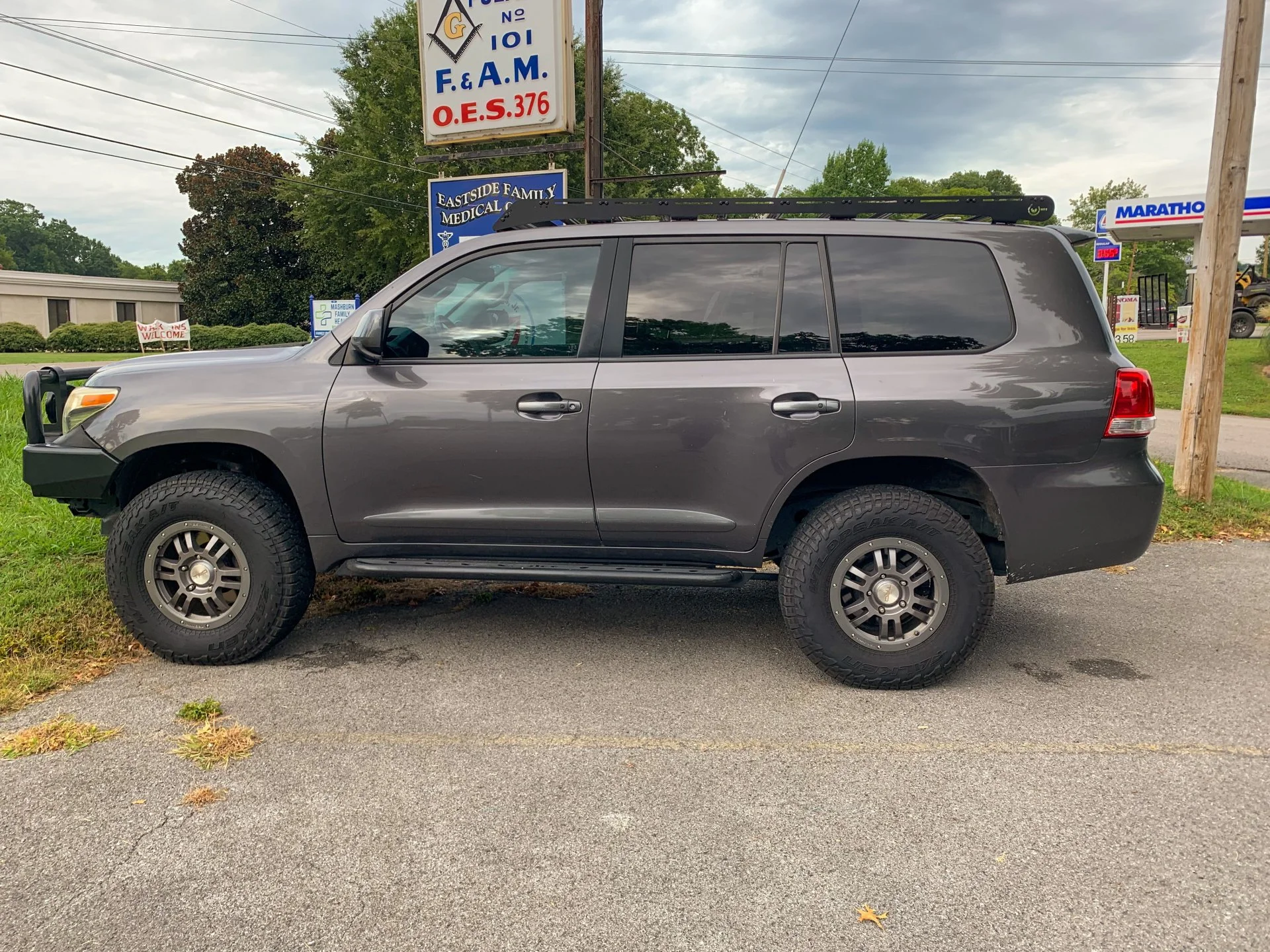

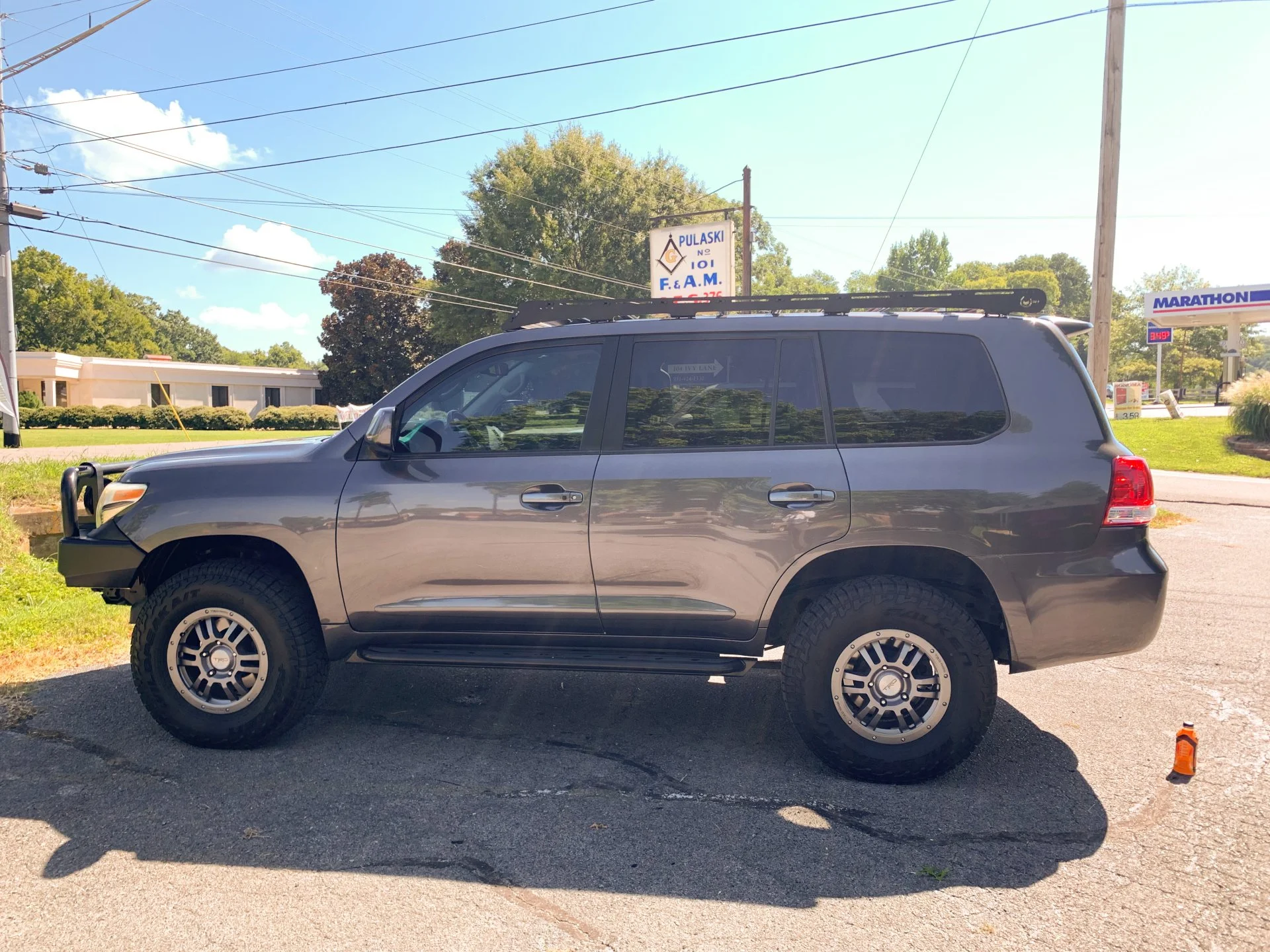

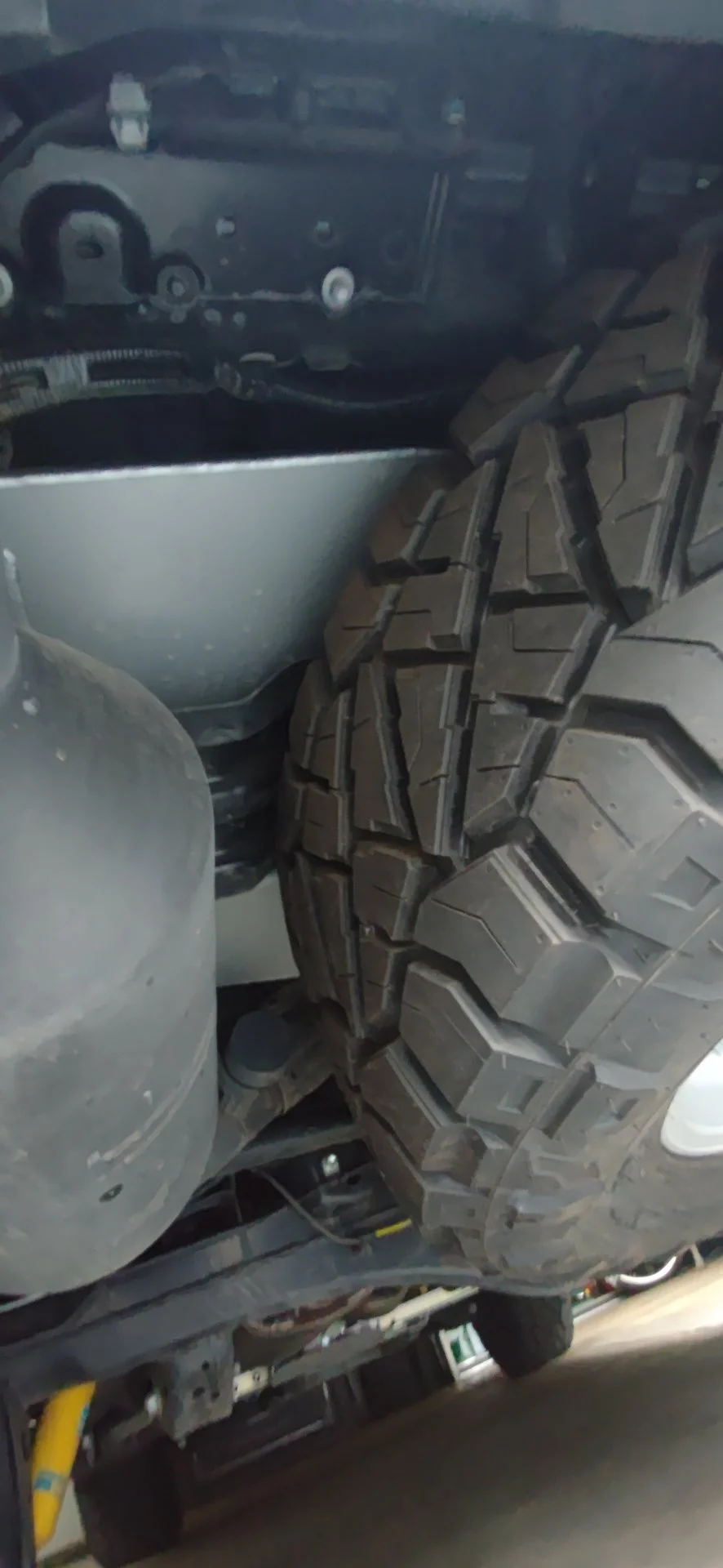

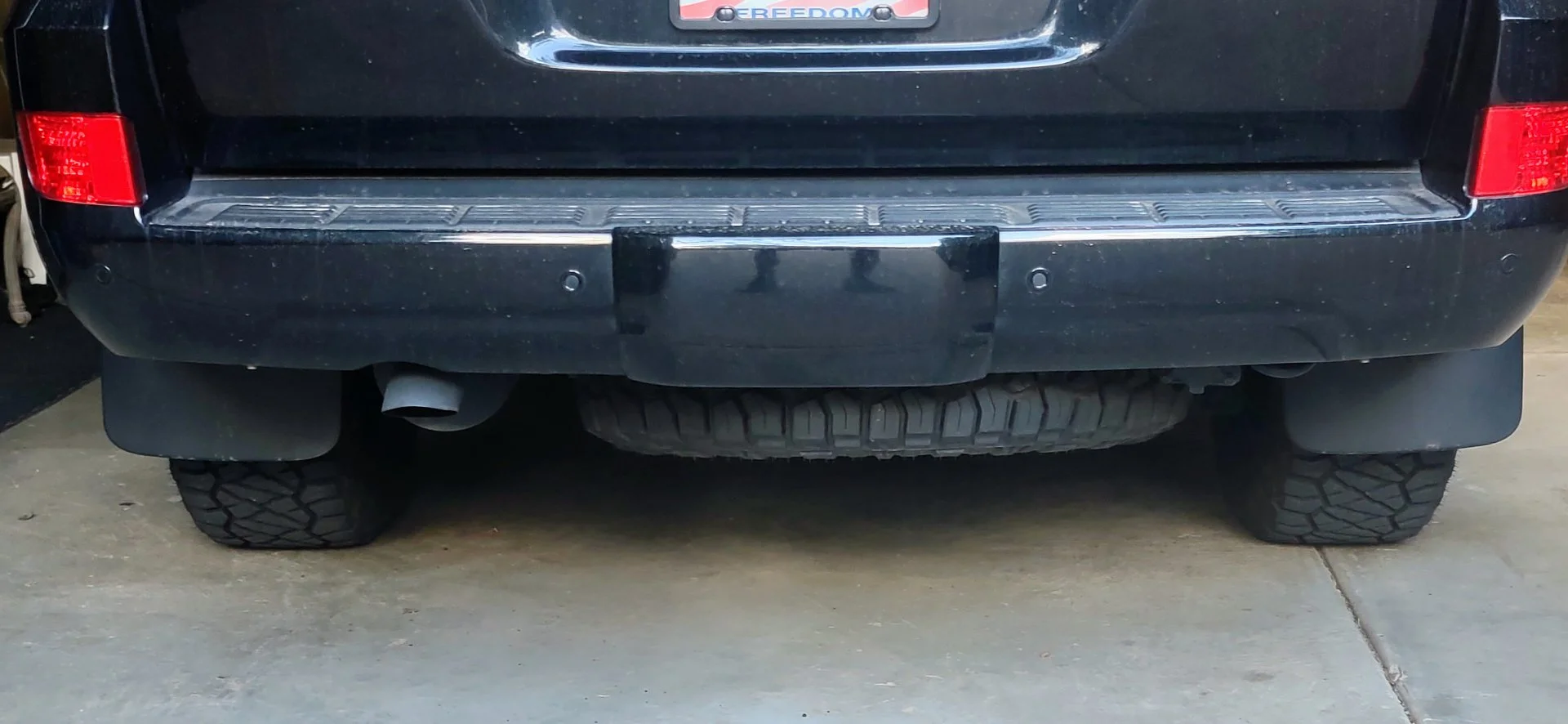

I had Cruiser Outfitters order and install a 12.5G LRA tank for my 2020 HE. They installed it yesterday and I made the 500 mile drive back to Flagstaff today. The pump is very quiet from inside the car and it took less than 20 minutes to transfer 10+ gallons. Quite happy with the installation and auxiliary tank. Ollie there does all of the LRA installs and thoroughly explained the installation and how best to operate it.
They provided an upgraded Precision fuel pump, upgraded hoses and clamps as part of the install package. I knew the 285x65x 18 spare would hang lower then the original setup, I measured 11" at rear and 8" inbound from my level concrete slab. It is no longer on the centerline of the bumper. That's because of the muffler it appears. Benefits outweigh the lower off center spare tire. I'm probably the only one who will ever notice those conditions

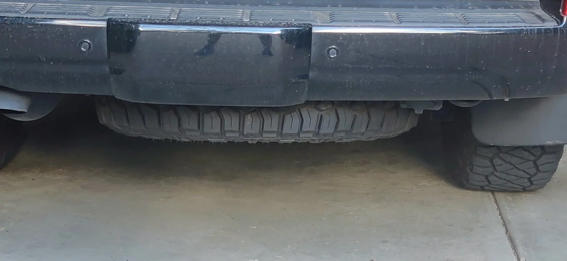

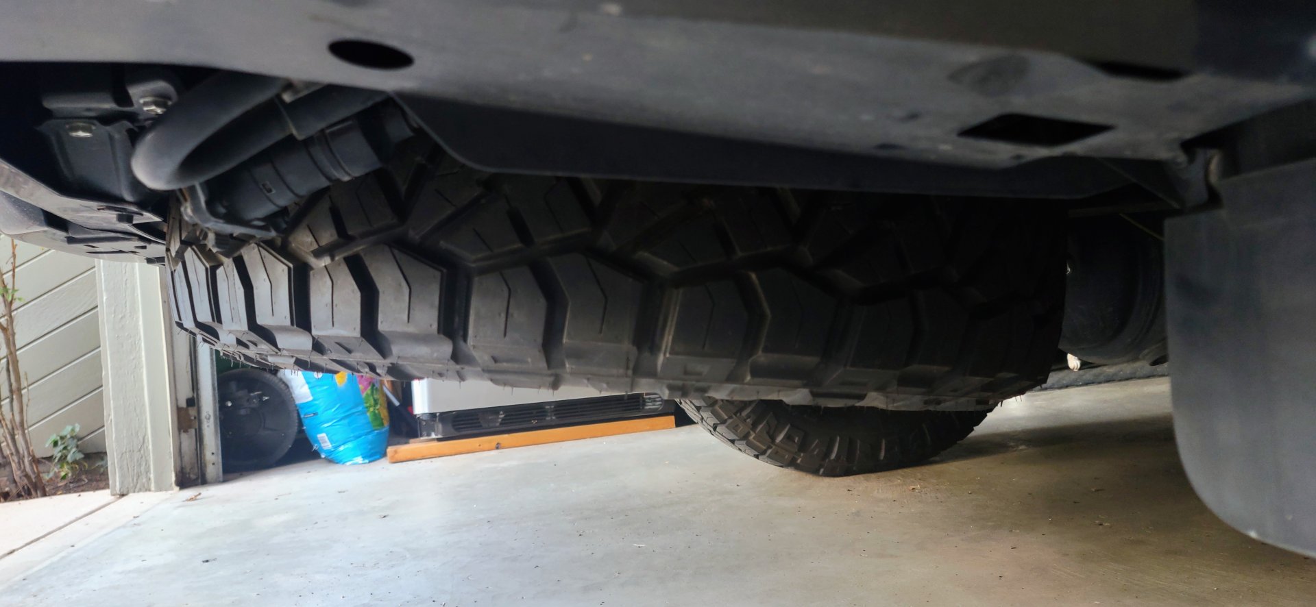

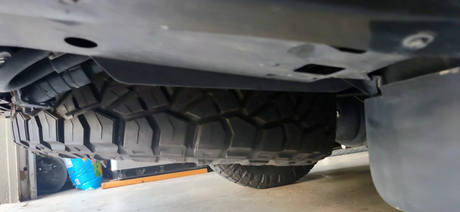

I am not sure that the spare is centered without the 12.5 Aux tank.
Is there an automatic shut off that prevents inadvertently over filling the main tank? I could see me forgetting the pump was on.
Yes, it stops when tank is empty. From what I unders
You're correct. I was mistaken. I guess I never paid that much attention until they installed the tank. Thanks for the clarification.

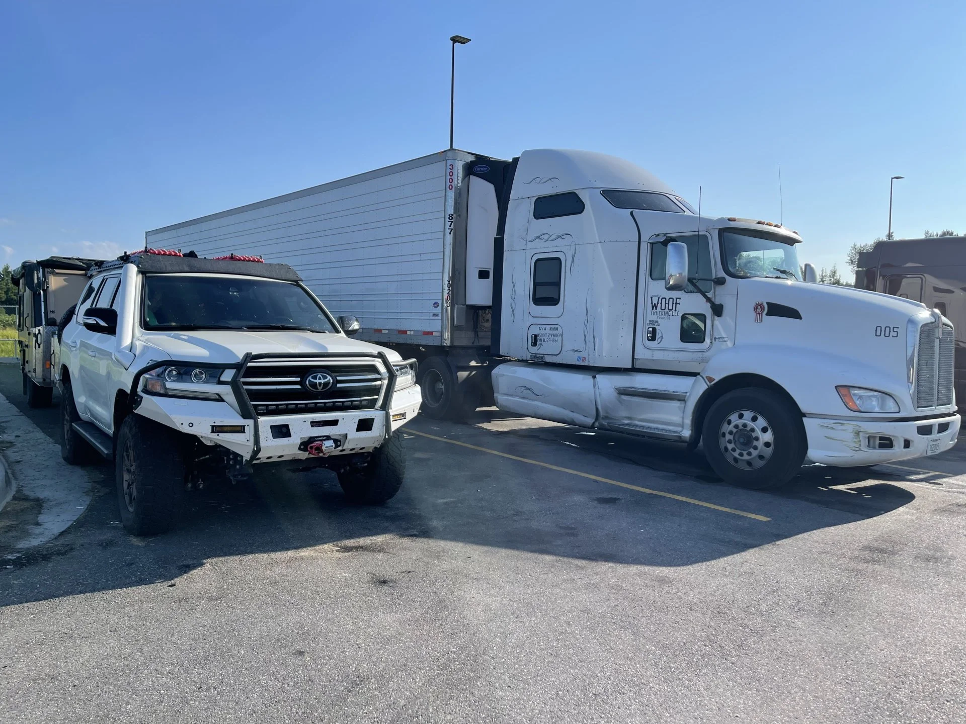

We spent the night with the big boys… we earned enough road cred after clocking 1020 miles in one day, Clayton, NM to Hamilton, AL. If only we could get gas pumps that don’t have purchase limits of $100-$175.

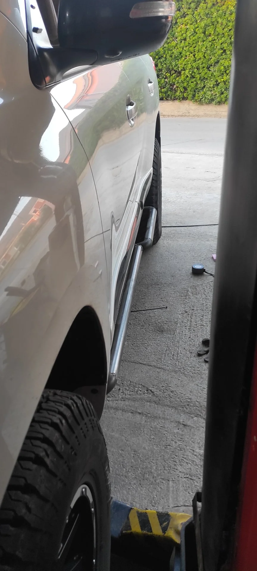

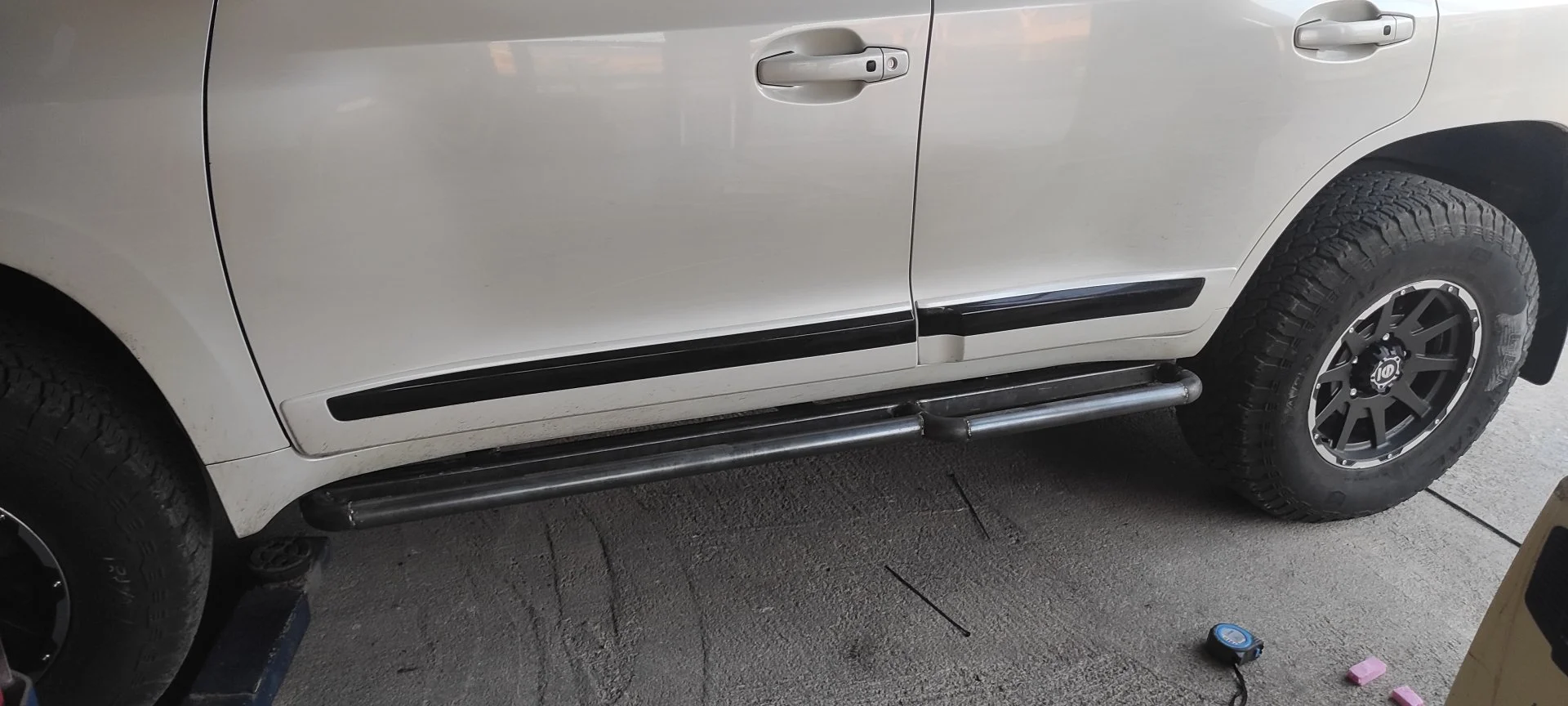

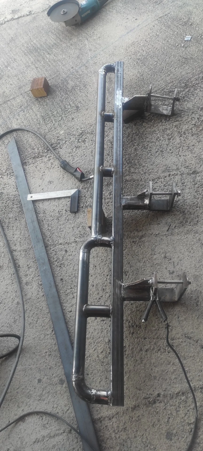

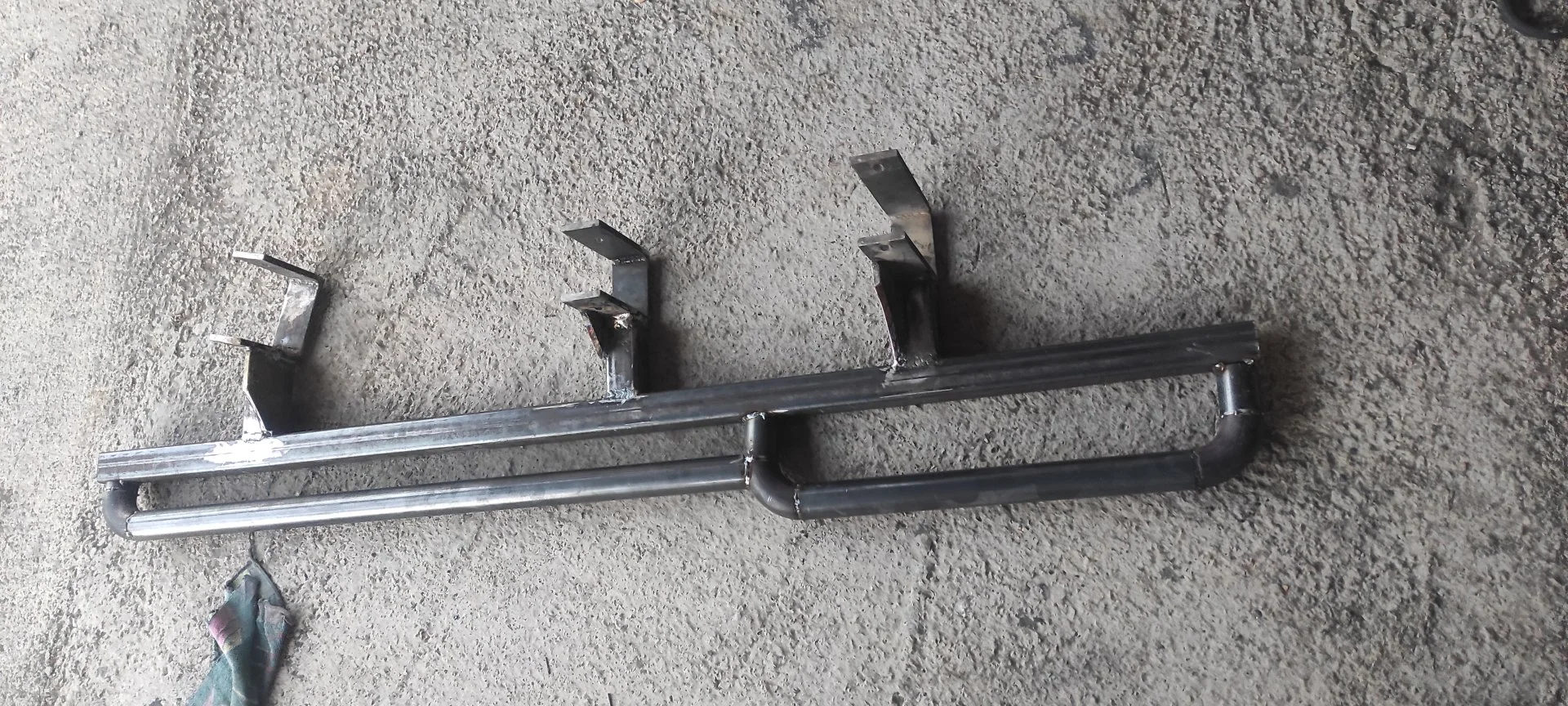

One side is done. Next step is sandblasting and painting. Brackets are 60x10 mm , square tube is 50x50x4 mm and tube is 48.3 x 3 mm thickness
What about a smoother transition to the bumpout? I can imagine you getting hung up at that spot if you use the slider to pivot around rocks.

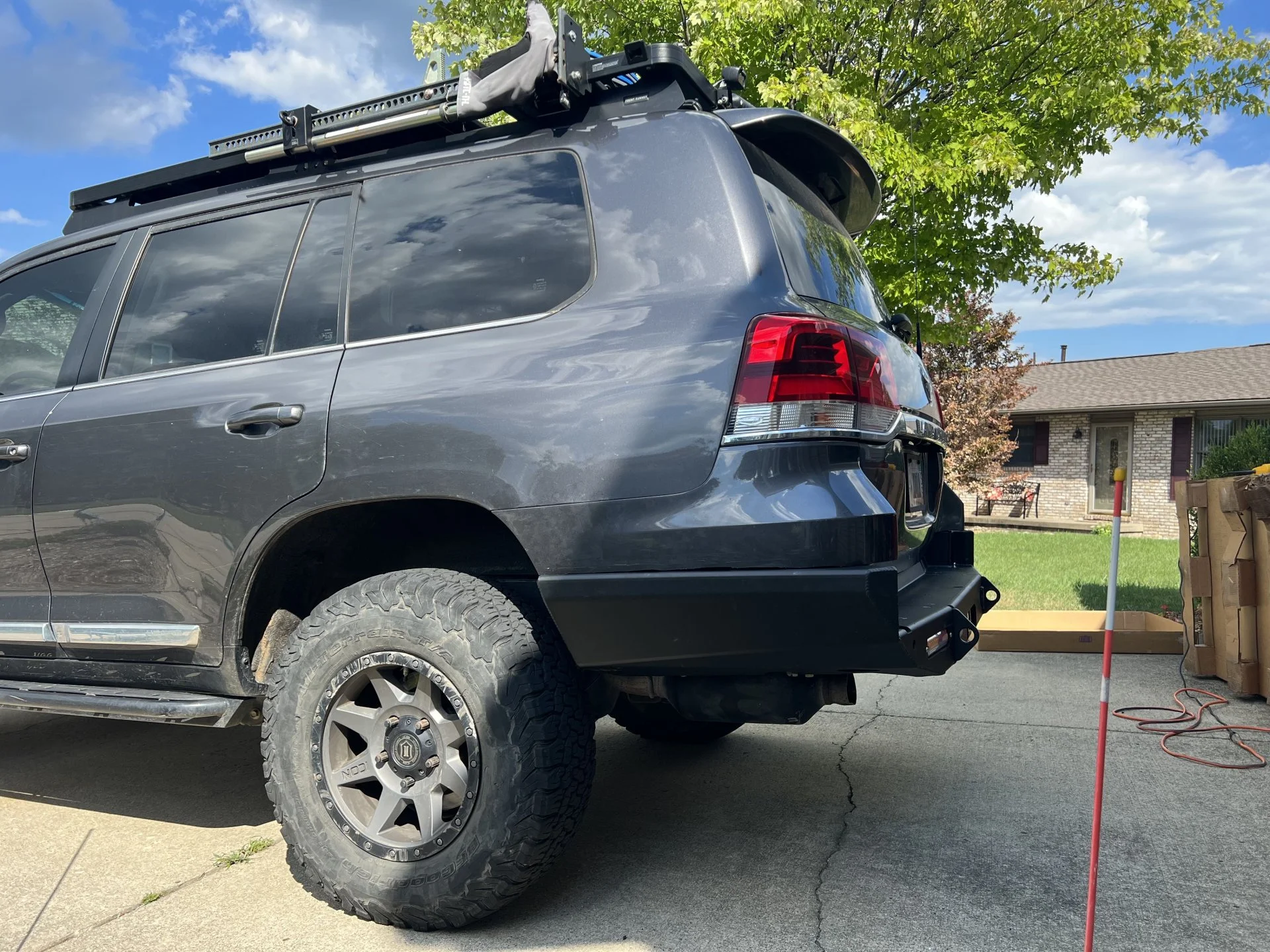

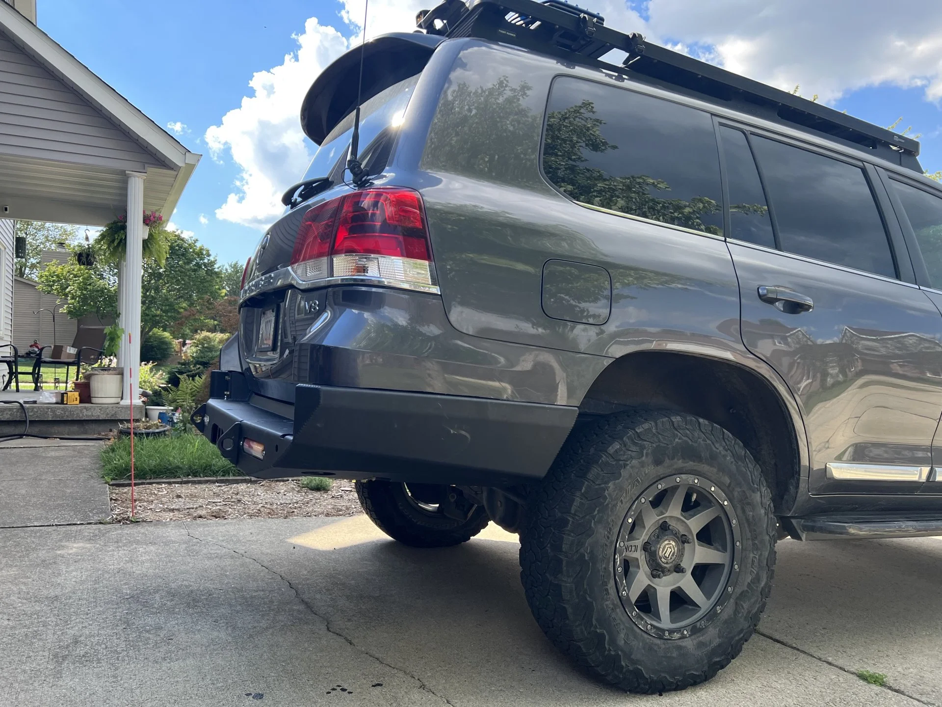

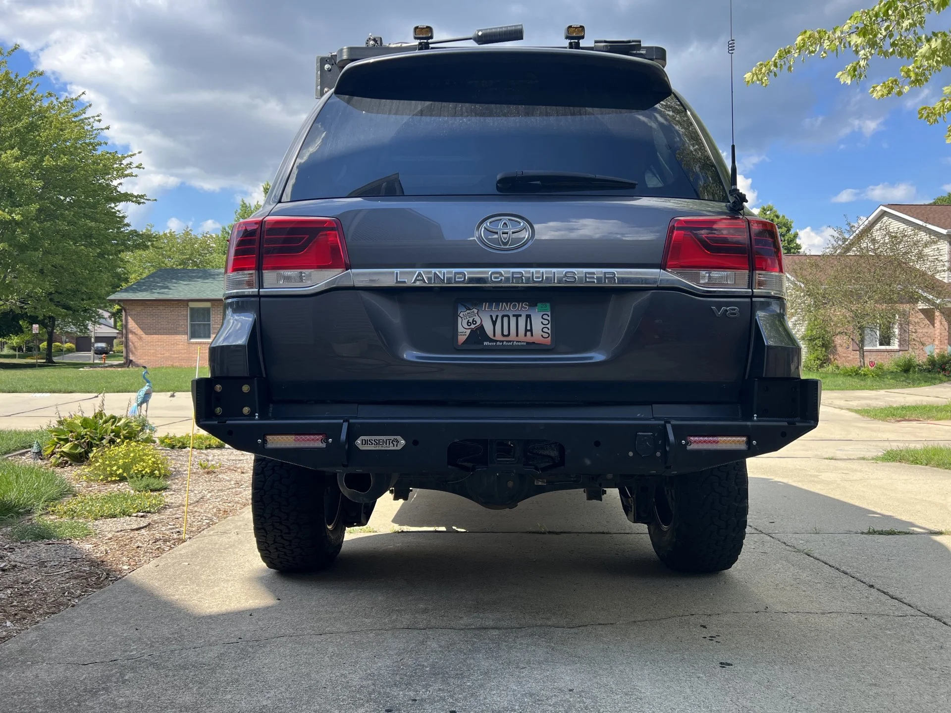

I have made a good start in the install of the Dissent rear bumper on my 200. I still need to make the final cut on the plastic, install the swing outs and finish up the wiring for the light and the relocation on the camera.

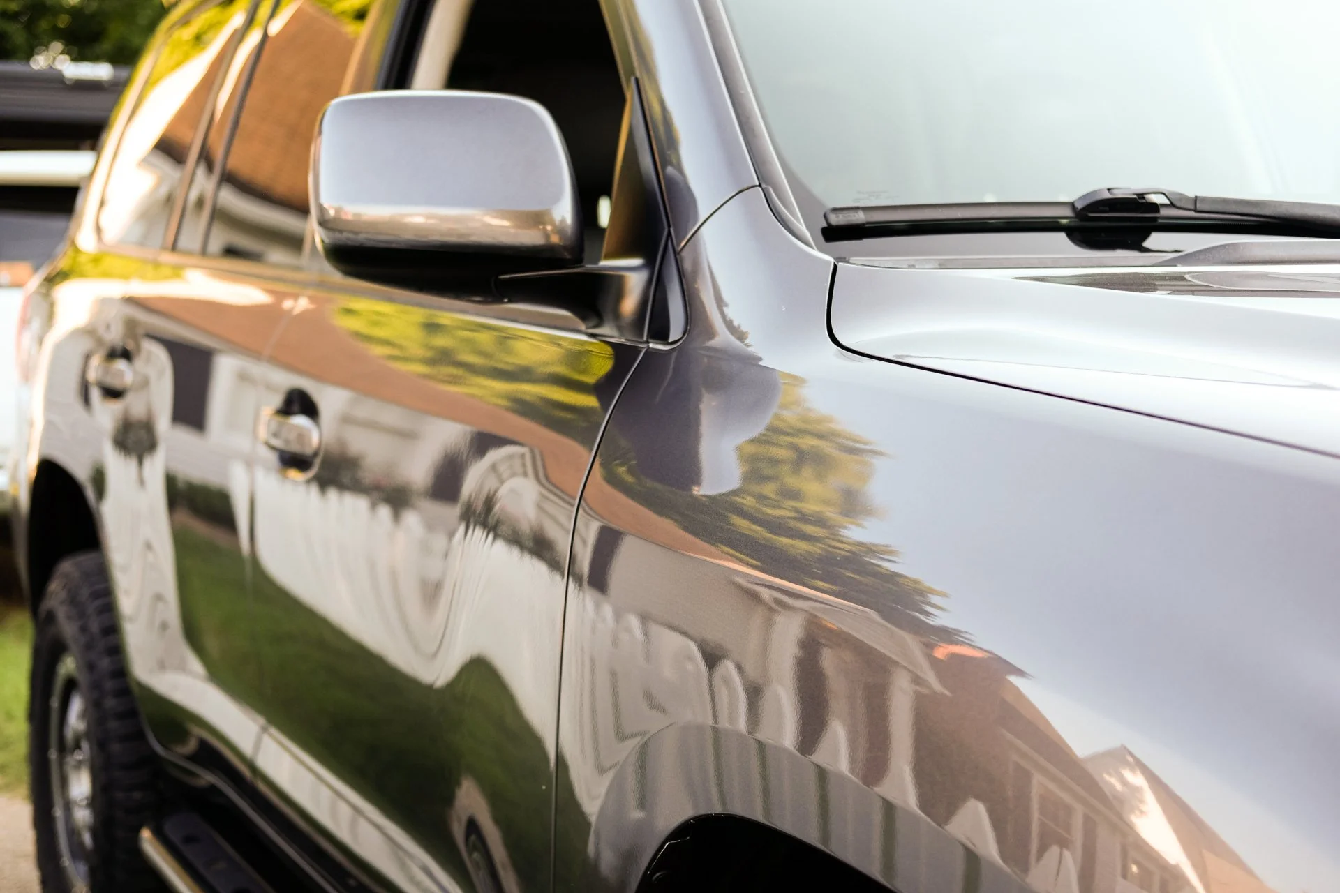

Got a two-step paint correction and ceramic coating done. Couldn't believe how well it polished up.
Nice! I did the same after LCDC. What have you done to your 200 Series this week? - https://forum.ih8mud.com/threads/what-have-you-done-to-your-200-series-this-week.818471/post-14551403
I was/still am amazed how good it turned out. They got pin strips out that were years old that I couldn’t. We’ll see how ceramic vs. trees goes here in a few weeks. I’m setting my expectations low as far as reducing pin strips but maybe they will buff out easier.
