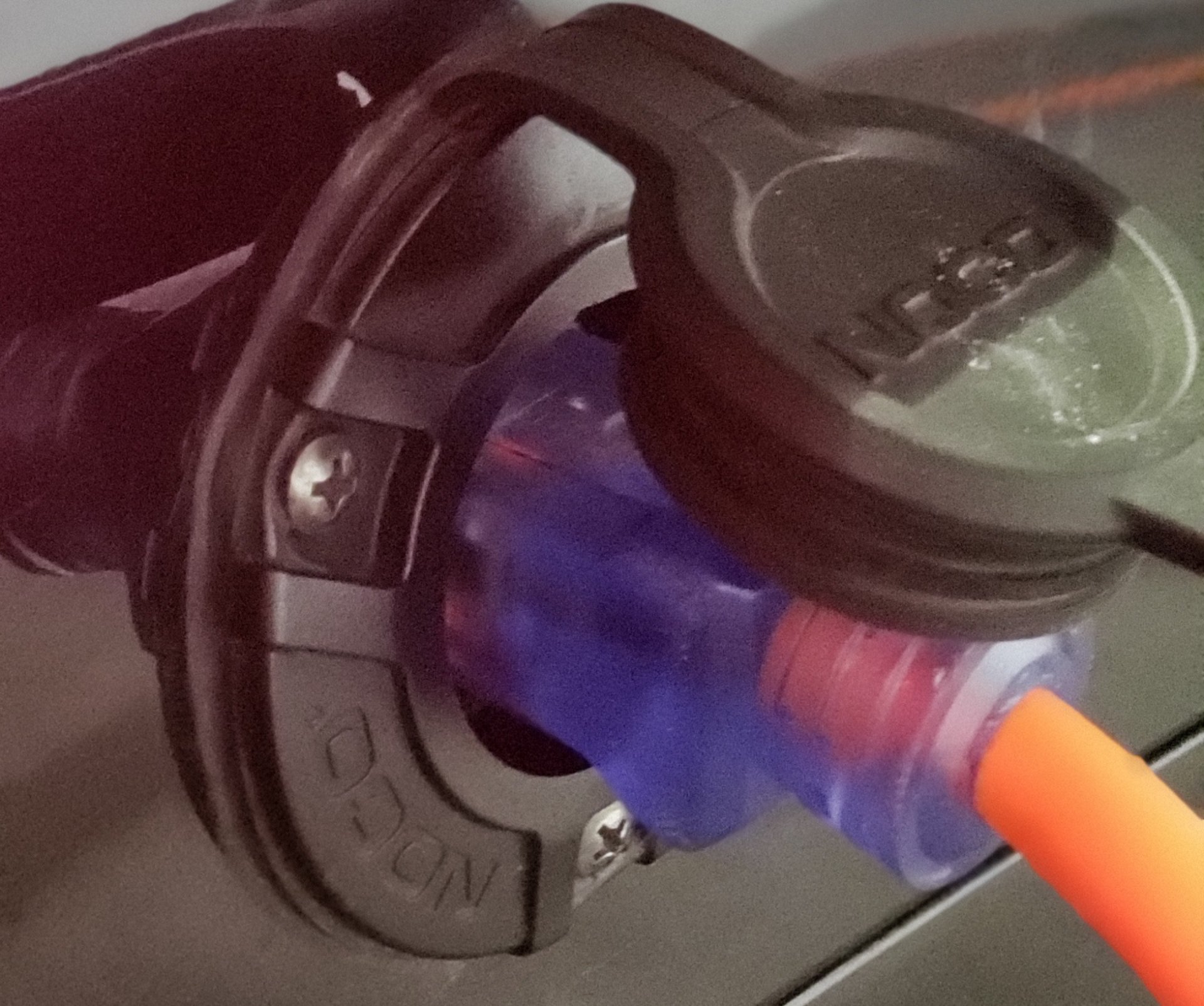

Gave my portable Yeti 1500x a little more of the convenience usually associated with a permanent secondary battery install by adding a charging source switch. I have been using the single high-power-port input on the Yeti for both alternator charging and AC adapter charging. Until today, I would have to unplug one HPP cable to plug in the other every time I switched sources. Now I just turn a knob.
Some minor cosmetic finishing left to do, but already this is a huge improvement for me, as the charging cable switch-over was often a multiple-times-per-day hassle. I never found the Yeti high-power port connector pleasant or easy to use.
The switch was hard to find. It's a DPDT on-off-on switch from Blue Sea. The listed specs are for AC only, but Blue Sea confirmed with their supplier that the ratings were fine for DC as well.
The only remaining hassle is plugging and unplugging the AC power cord, but I made that easy some time ago.
Very very nice! Very neat and compact.

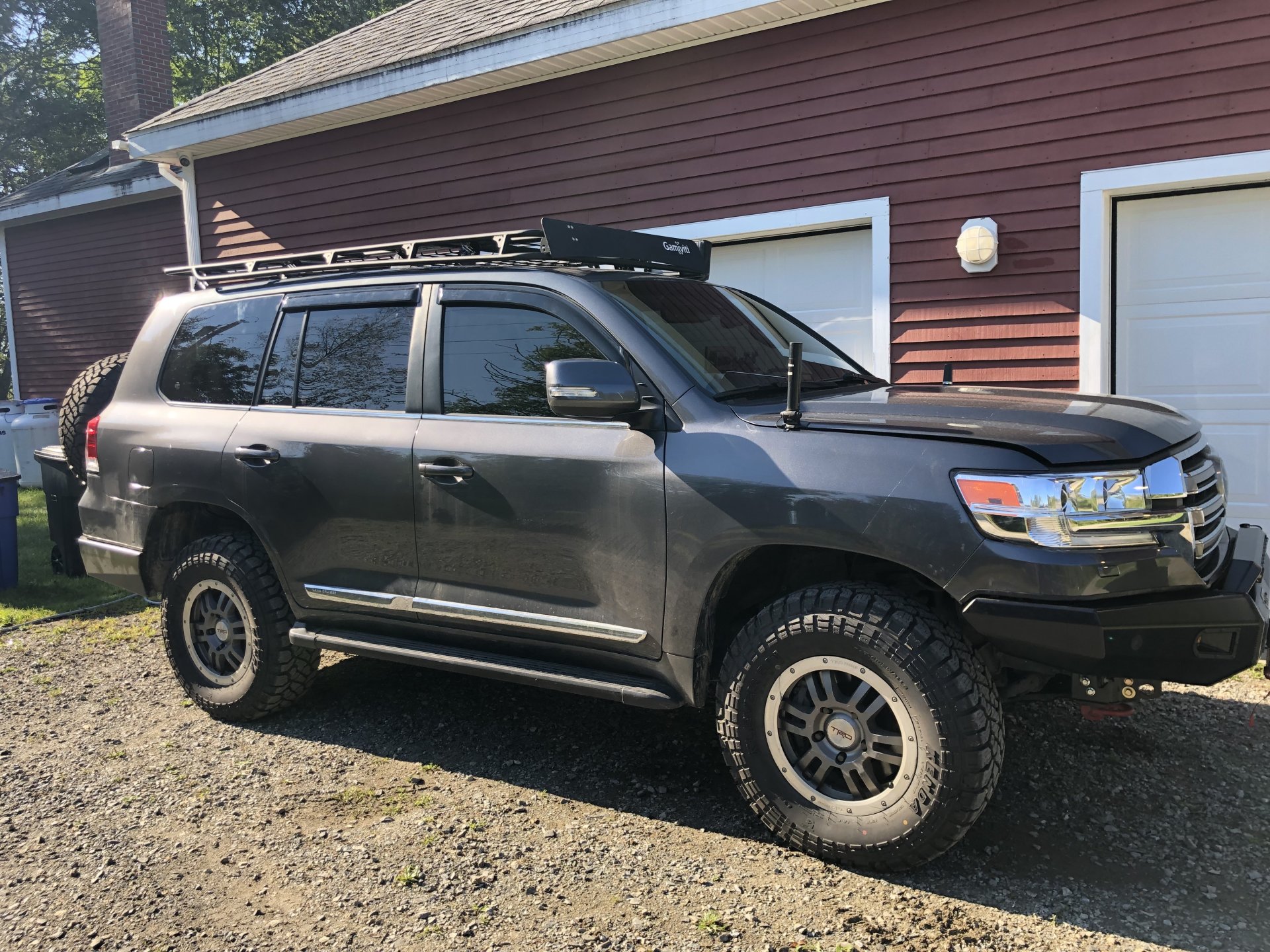

Added a few goodies:
Slee front bumper with Baja Designs S2 Pro amber fogs and Baja Designs - S8, 20" Light Bar (White LED with Amber DRL)
Come up Winch with Factor 55 hook
ODYSSEY ODX-AGM31R battery
Slee main battery upgrade tray
Slee battery terminals
Gamiviti expedition roof rack
OVS Awning
