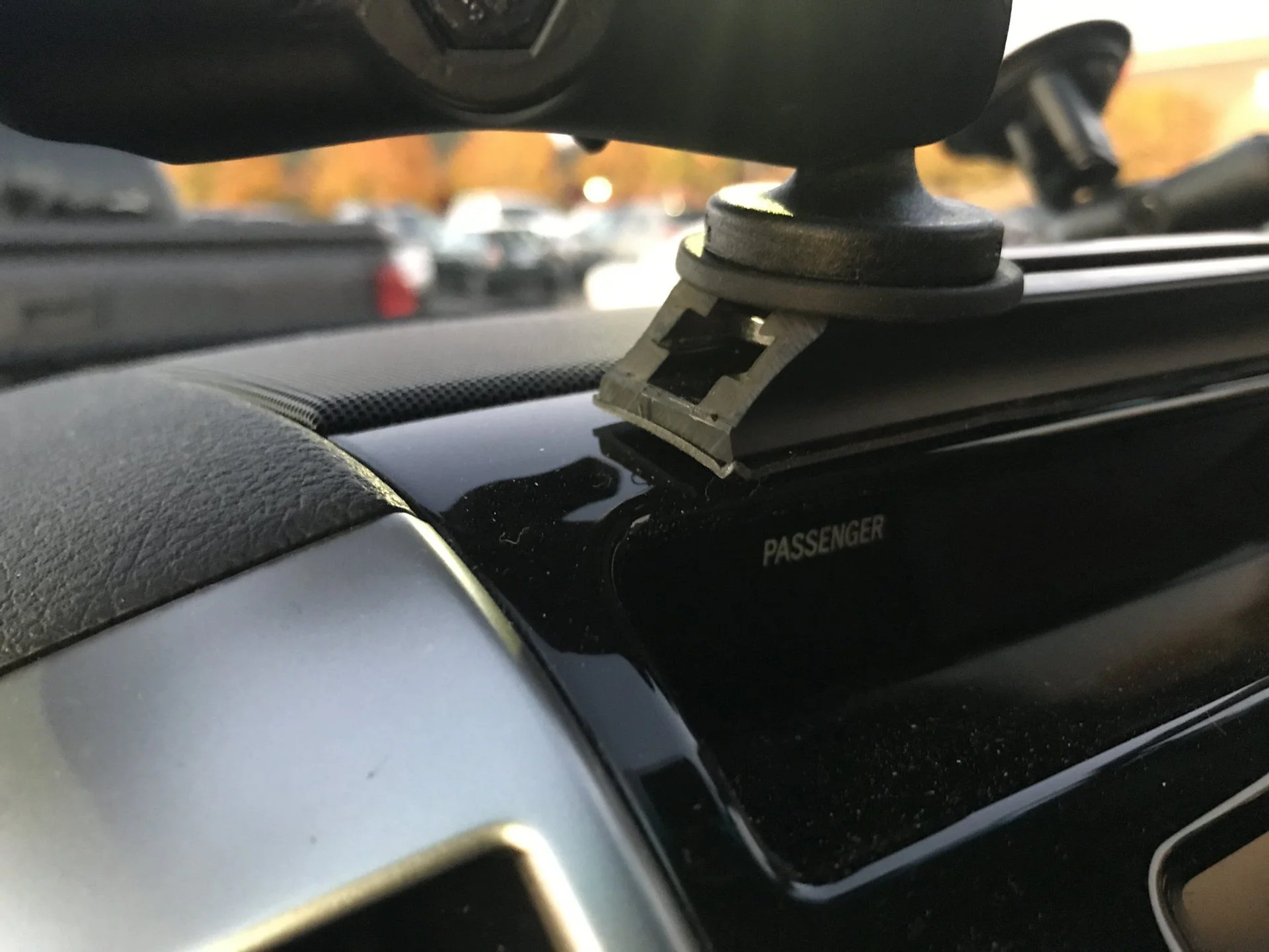

Nice. Do you have a link to that combo?
Currently, I extend a long RAM mount all the way over from my driver-side grab-handle...which works and requires no drilling, but isn’t ideal for centering on the dash.
Sure!
8" End Loading composite with 3M VHB tape.
Before install, take a heat gun and slightly bend the track. The top of the dash has a very slight curve to it and you don't want the ends to spring up. Also, take some IPA and wipe down both track and dash to ensure good adhesion.
Shop RAM® Tough-Track™ End Loading Composite | RAM® Mounts
