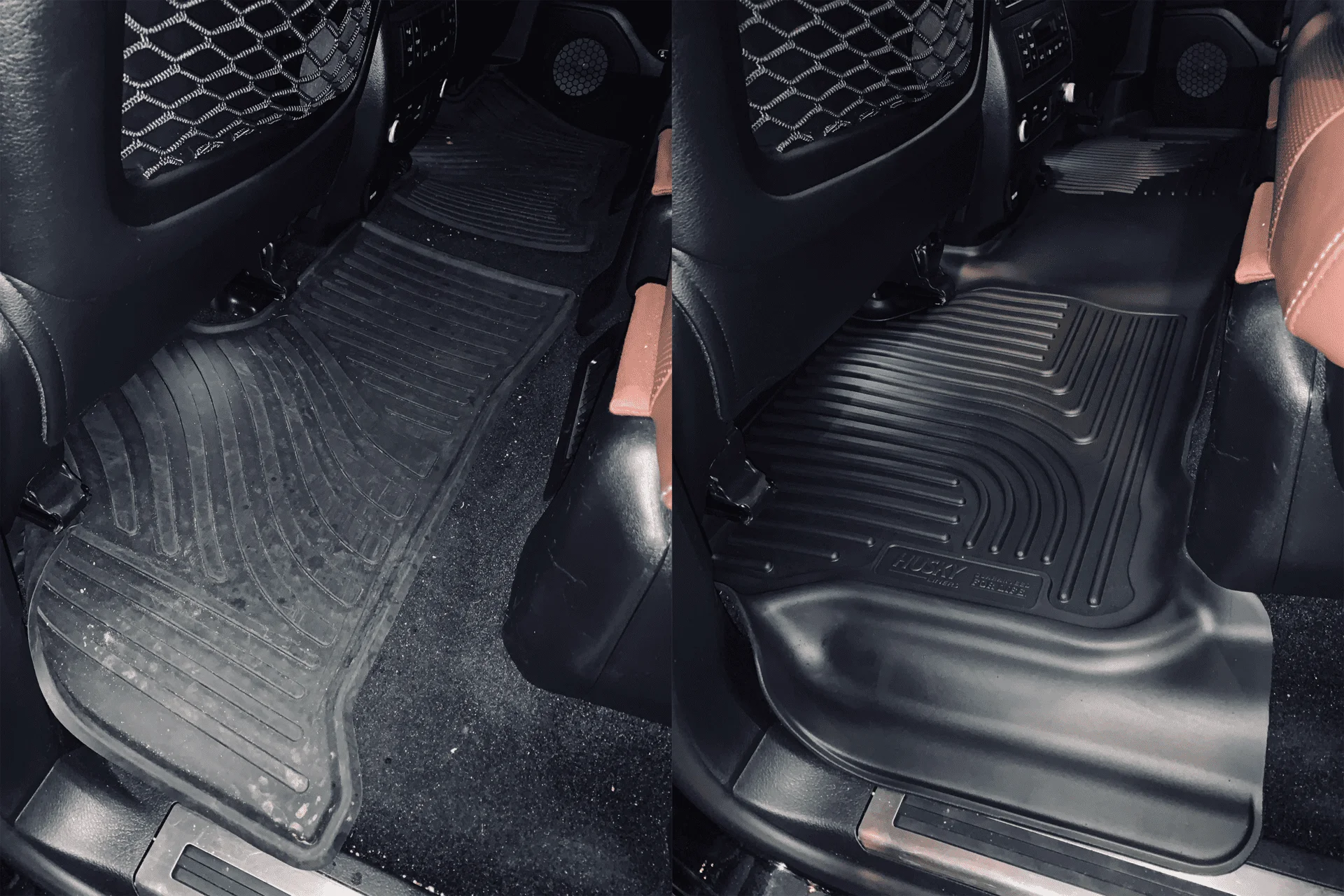

Husky Weatherbeater floor liners (20% off at Home Depot^) installed! Definitely worth replacing my beat up OEM all-weather mats.Just ordered a set of Husky Weatherbeater Floor Liners. They're on a 20% off sale at Home Depot right now if anyone is interested (also for other cars). $86 for the fronts, and $86 for the 2nd row when added to cart. Unfortunately the cargo area liner isn't on sale, but I'm okay with that since the OEM all weather rubber mats are very grippy and don't let things slide around in the back.

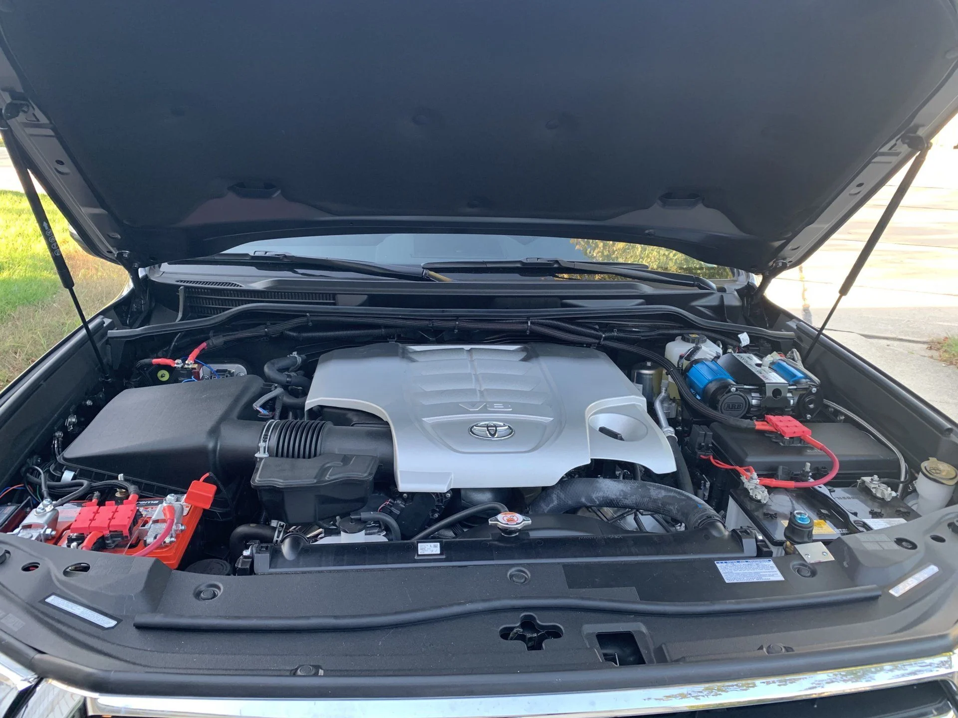

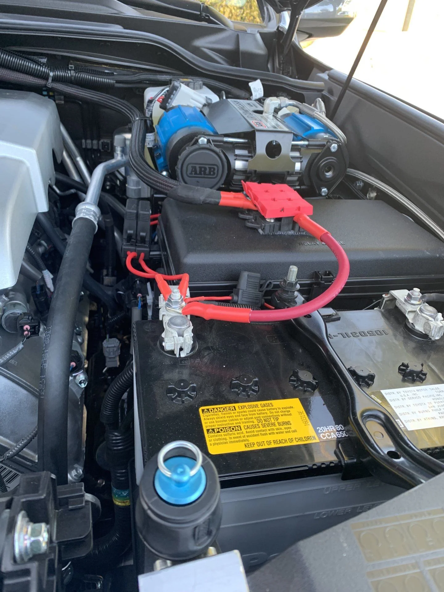

Nice! Are you satisfied with that next to the seat Ram mount?In the past week or so, I have installed a Redarc BCDC 1225D with SBI12 battery isolator and Odyssey Extreme battery in the Slee second battery tray, ARB dual air compressor and the ARB Linx control system. The only thing I still need to do is install a remote air intake for the compressor because of interference with the fuse box cover and the momentary switch to link the two batteries for jumpstarting the main from the aux battery.
