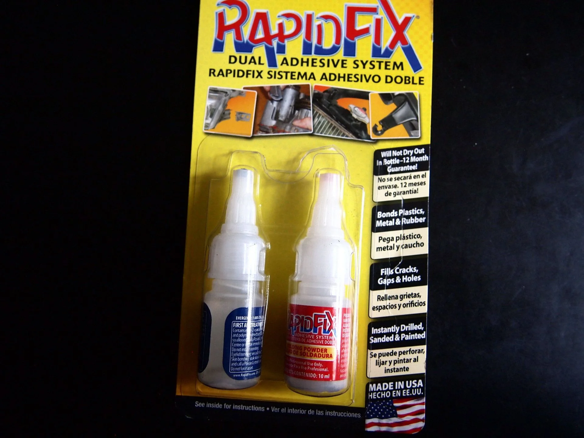

I tried a glue recently on my GF MDX bumper support, that seemed good. I was able to file into shape instantly. The mfg claims better than typical super glue and baking soda combo (google that, some use bone dust).
I just use the glue, to glue parts together once I had them clean. Then came back over seam with powder and glue, filed and installed.

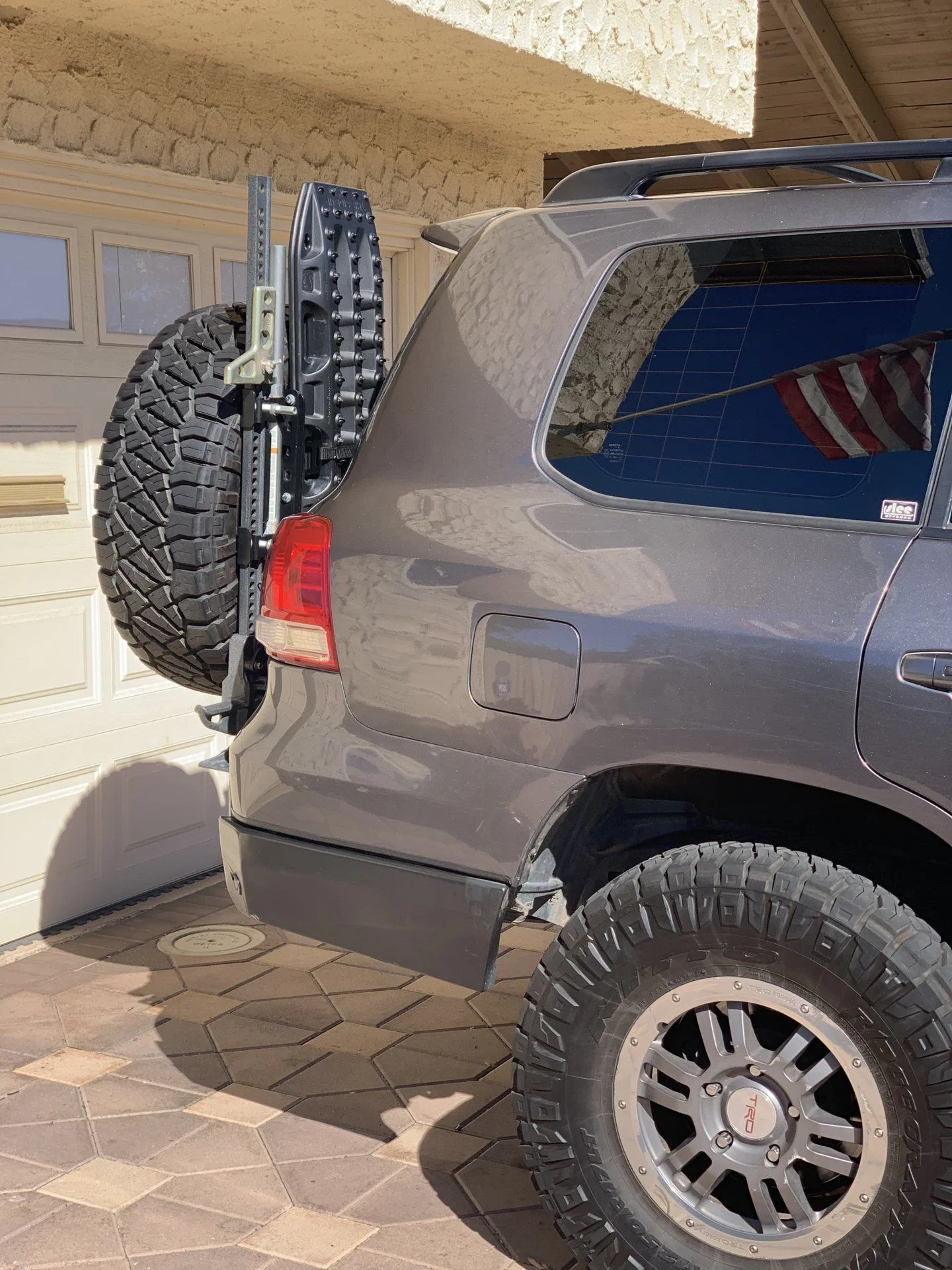

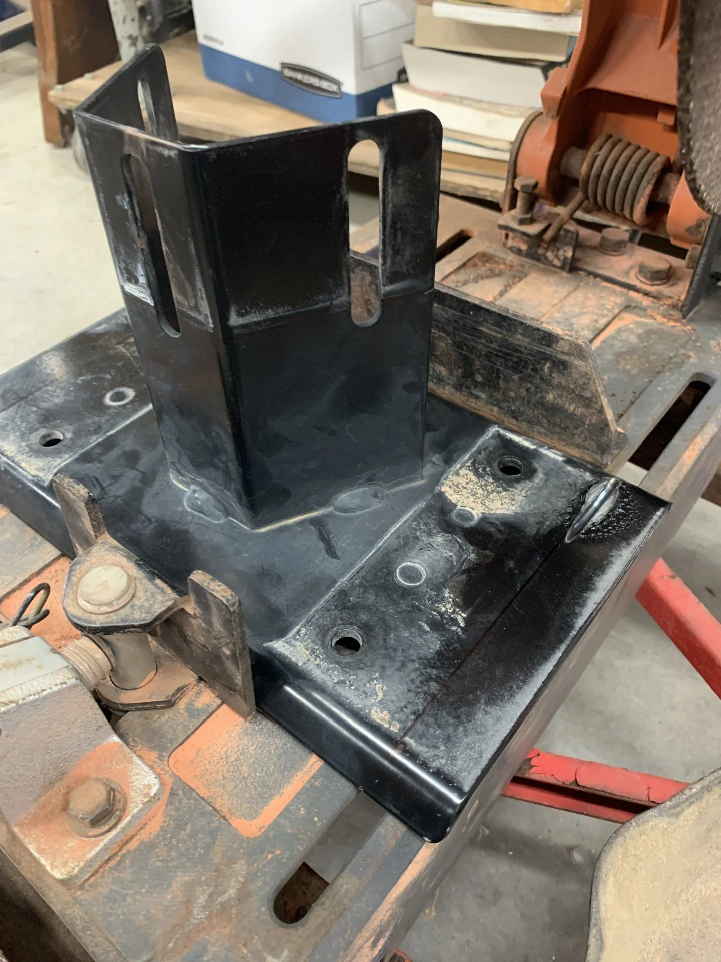

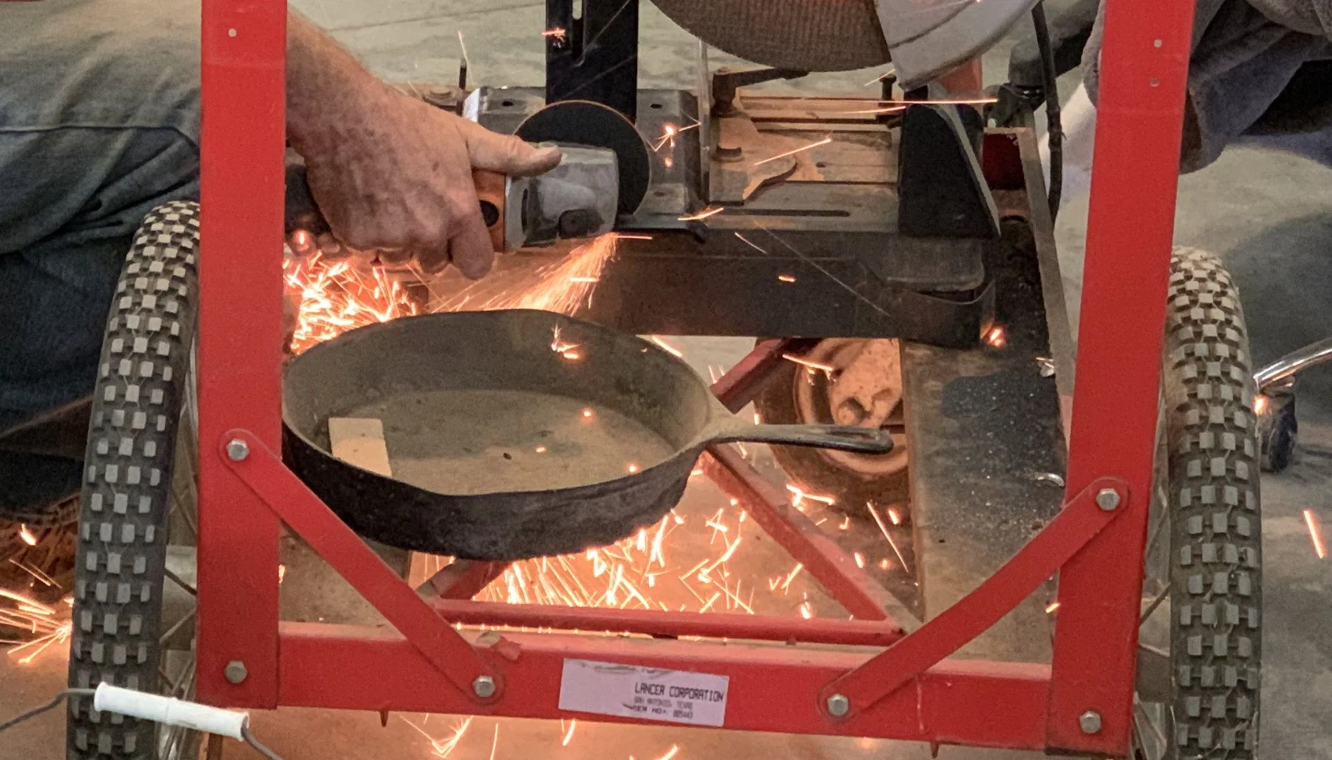

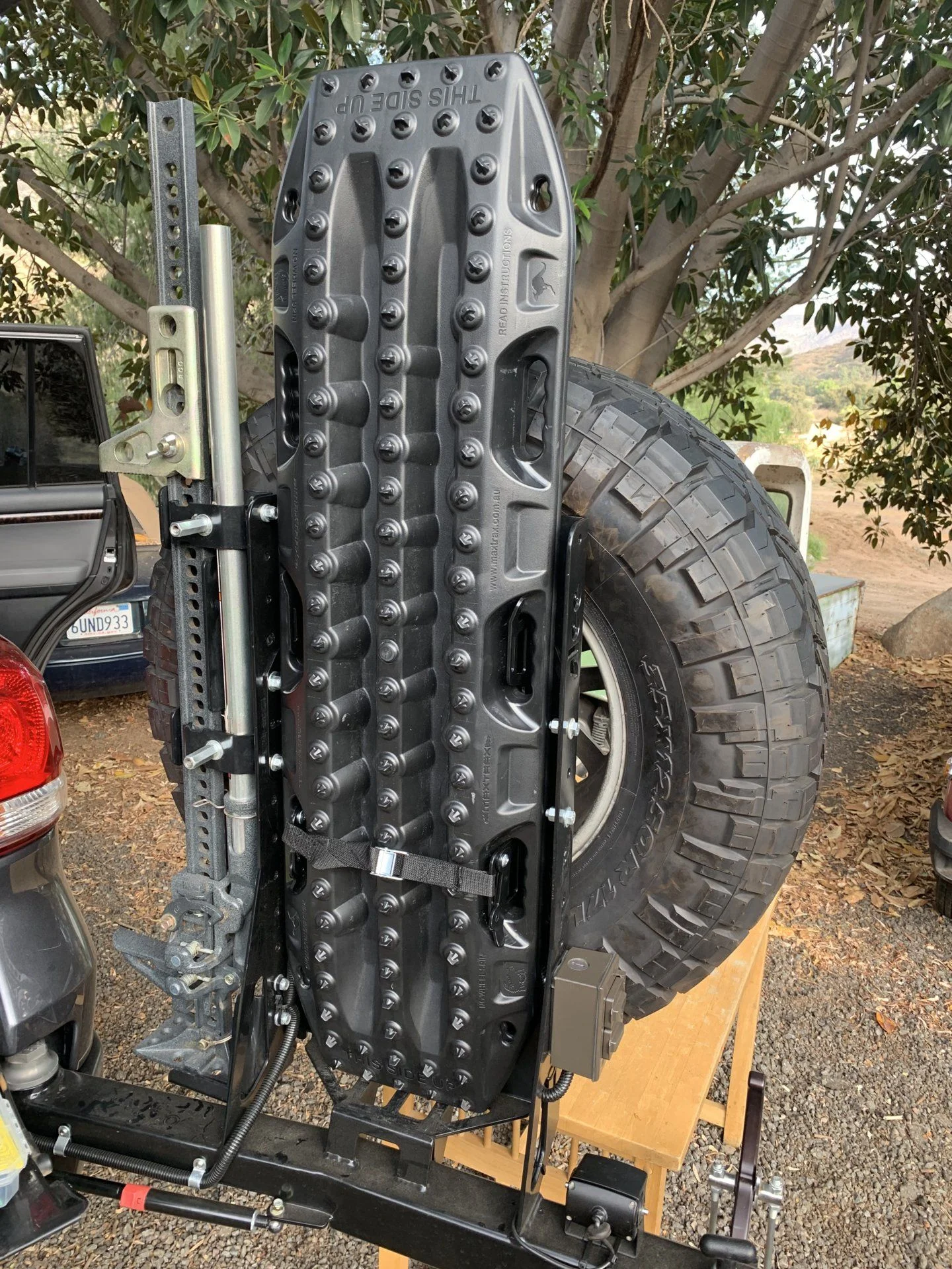

Took some work to swap out my Rotipax for Slee’s Maxtrax Mount...but only because my early Slee rear was made before their Maxtrax Mount existed. Trimming an inch to off each side of the spare mount plate did the trick, with steel to spare ...
(Above note: strap is put on wrong above :) )
Nice mod, only 1 question though, what's the purpose of the cast iron skillet or should I ask where you mounted it? :hillbilly::hillbilly:

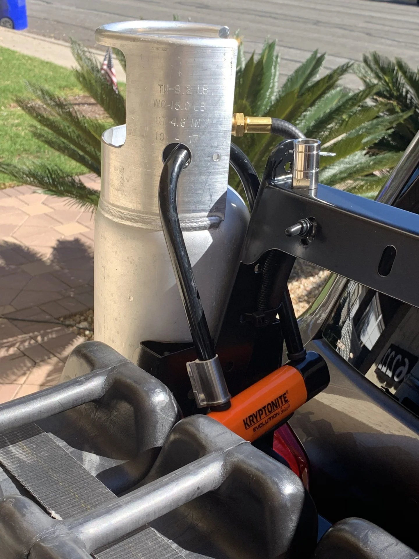

@RET2 pointed out ease of theft...and he’s right. Came up with a simple solution to prevent theft of my propane tank that doesn’t rattle or move...
PS. Temporary solution til I find something lighter...but this works.
Would advise NOT taking Saline Valley Rd. ? :rofl: Good solution though
Hmmm...
Is that where that ol criminally insane Ralph guy lives? ;)
No, it's just 25 plus miles of some of the worst washboard road that causes self destruction of any thing thought to securely fastened. Now that you have outed me I will use it in future defense when needed.
