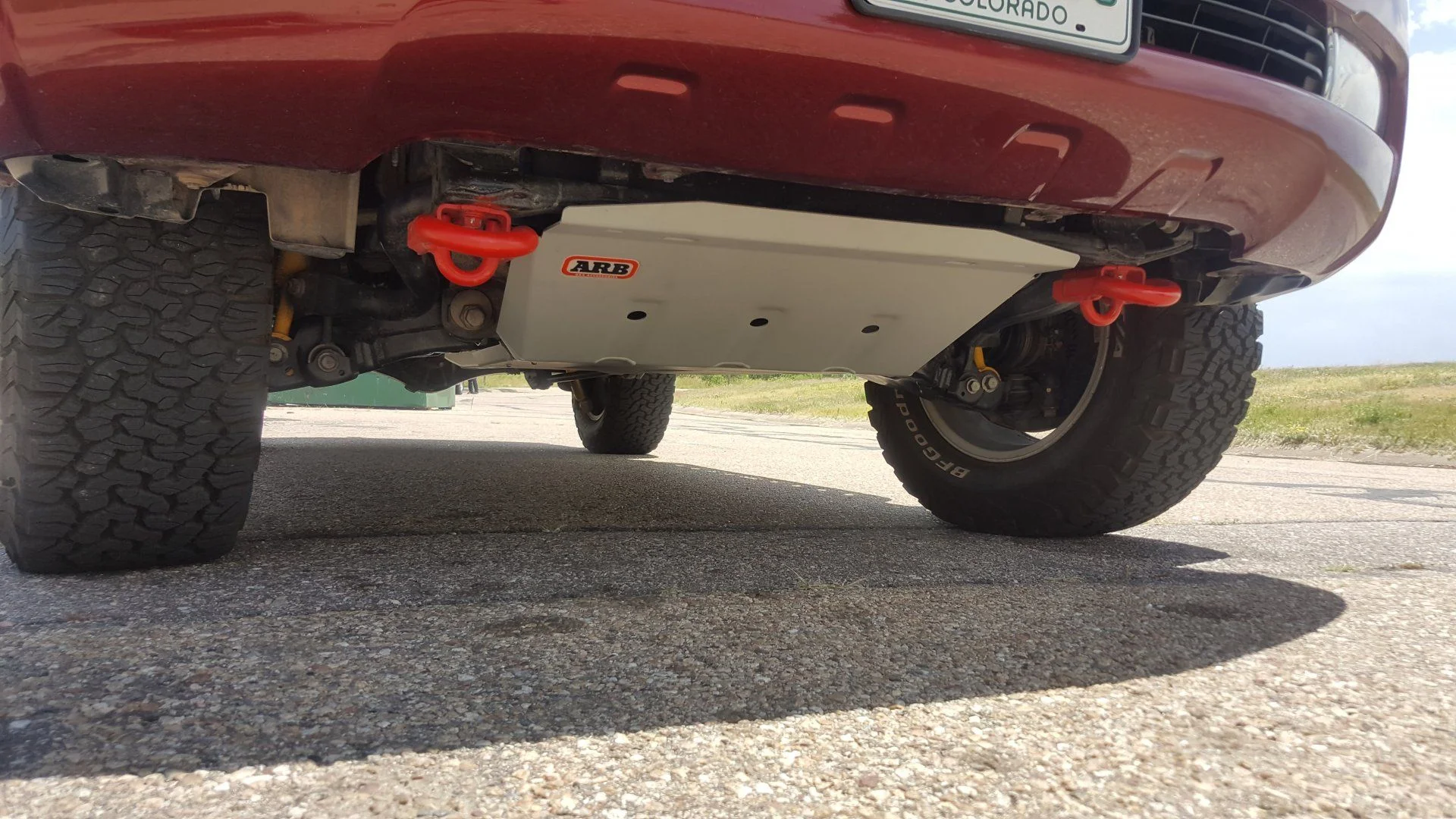

Gave the truck a little tummy tuck to firm out some of the softness underneath. Might have to have the guys @ slee do a nose job this fall.

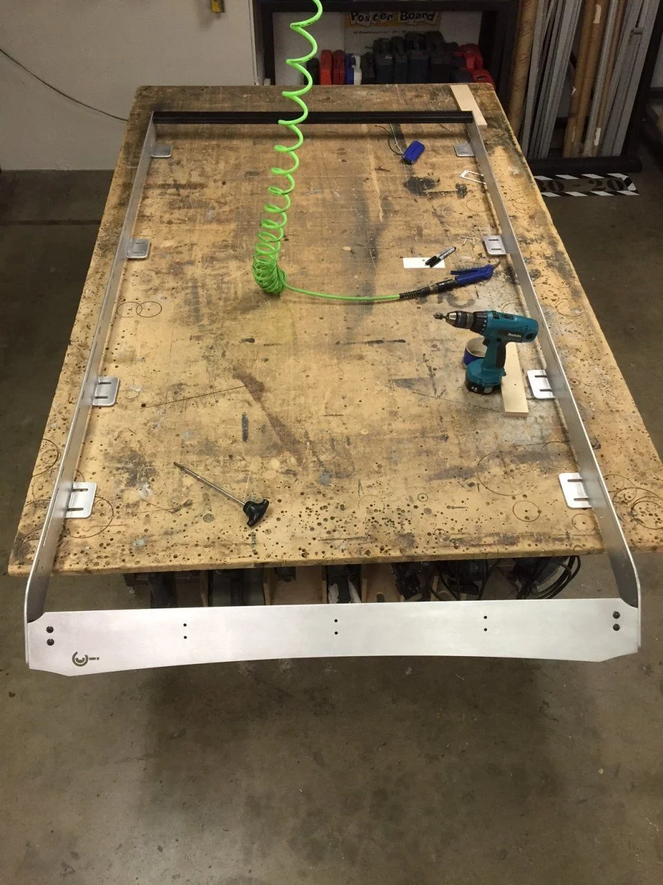

Just doing some final mock up before I send my roof rack to powder. I had to competition modify it a little first, haha. I put a radius on all the sharp corners, pre-drilled it for camp lights and I'm about to countersink all the holes on the air dam so I can use flat head hardware, all black stainless of course. Now I just need to decide between BK08 20% gloss black or BK120 10% gloss...

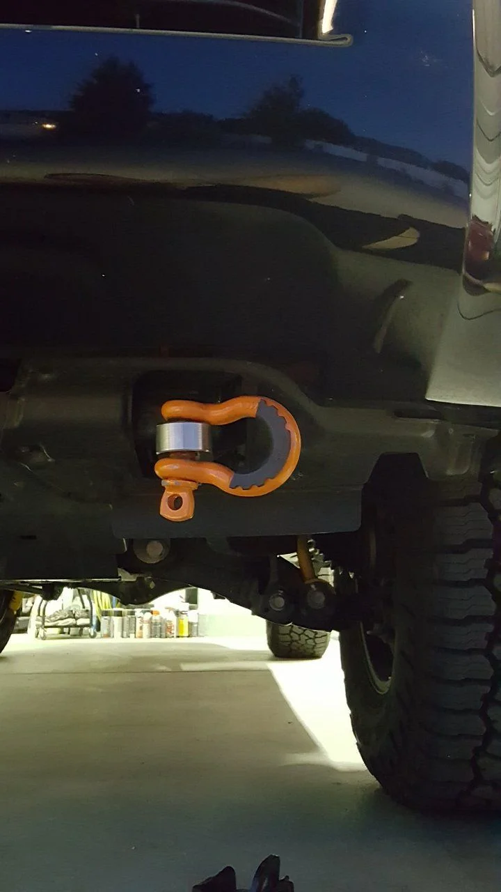

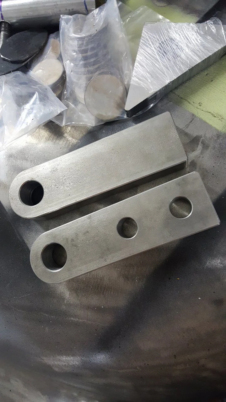

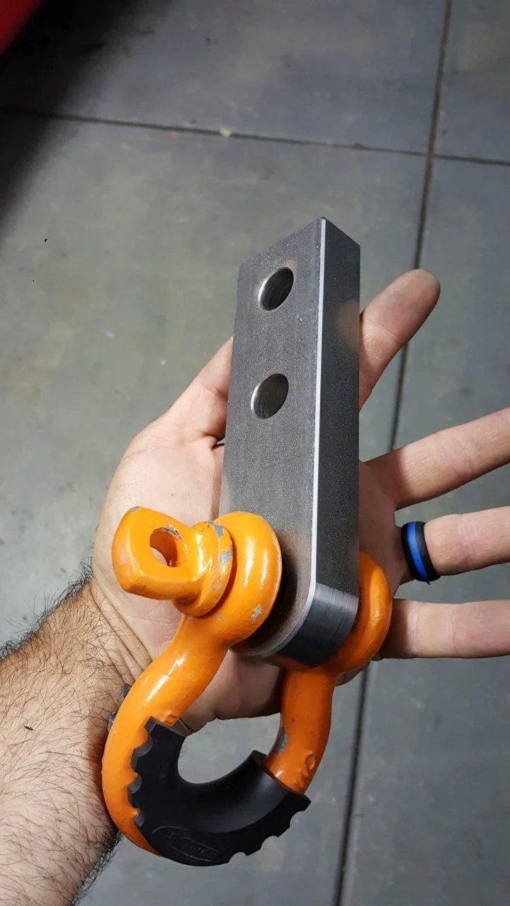

Discovered another option for some beefy D-ring mounts up front. I was browsing CHASSIS UNLIMITED's website when I came across these bad-boys. They are 1" thick and come either drilled with mounting holes 2" apart, or you can order them blank and spend 8 drill bits drilling them yourself :eek: . I ordered a set of both, turns out the pre-drilled unit fits fine (you'll need longer bolts though). Best part, they are $24 each, or $20 blank (still with the D-ring hole though). 2" Extra Long D-ring/Clevis Mount I will be using these to weld my bumper light-bar I am creating onto.

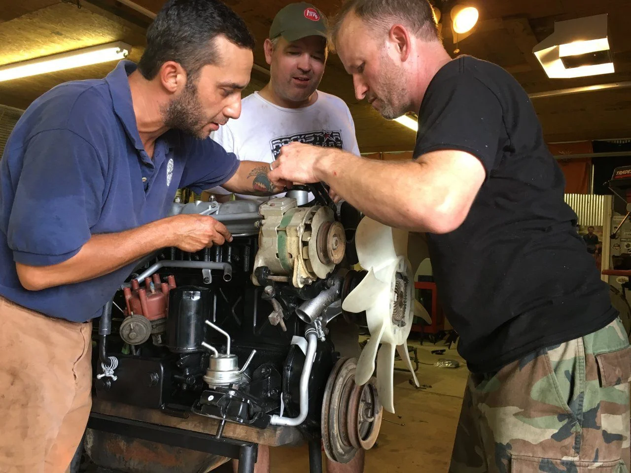

Met up with our fearless Moderator @beno ; he gave me a truckload of FJ40 parts I had ordered.
Then we worked on a buddy's 1968 fj40--assembling the engine and installing it.
