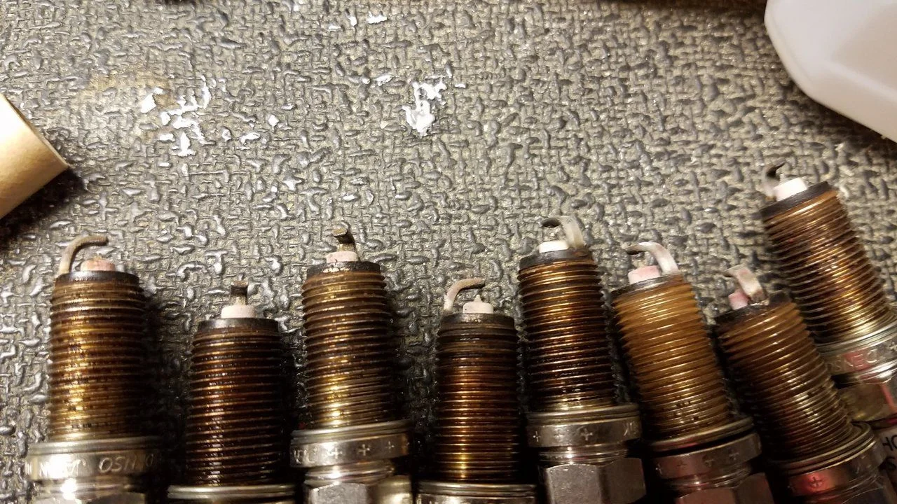

Changed out spark plugs. 118k and they still looked good and the gap was still 44. I changed them anyway and got 30% off at advanced auto parts for them so $50 beats $90 from the dealer or other parts houses. They are cheap on Amazon, but going on a 3k plus trip this week and did not want to wait. Took about 1.5 hours. including getting ready. The passenger side was actually the easier side for me to do even having to move the water pipes. Ill see if any MPG gains, but not really expecting anything major. All my 120k maint is now done.
