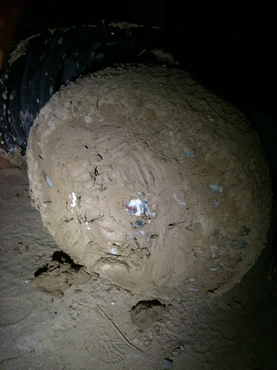

Ya, I saw that & that's helpful. I have sometimes had the impression that many plastic-dip success stories might not be subject to much abuse, so I've been curious.
For example... When I did this to my front wheel in on Valentines day...
...I guess I'll just try it and see! :)

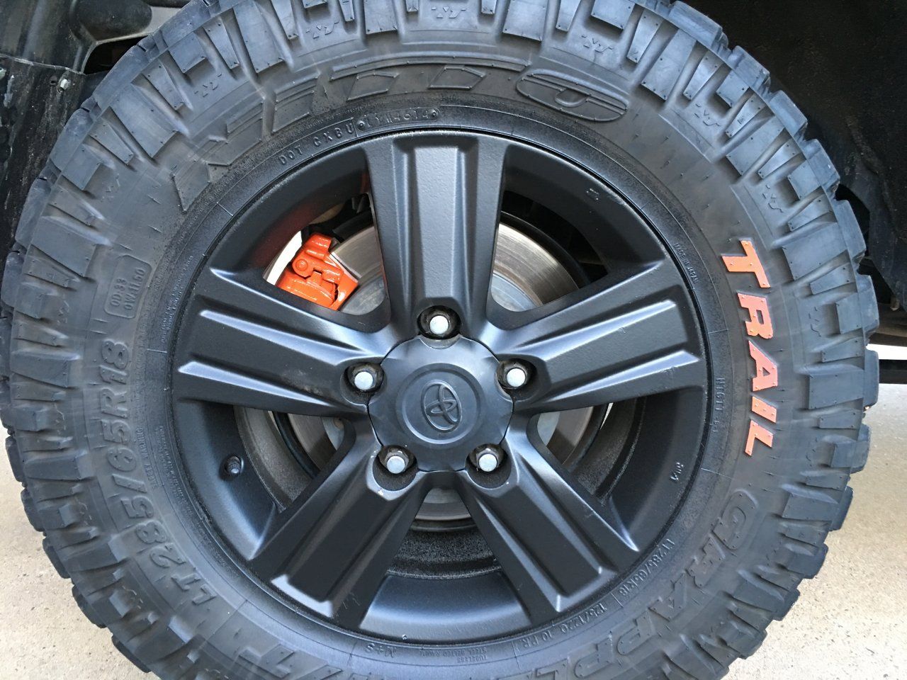

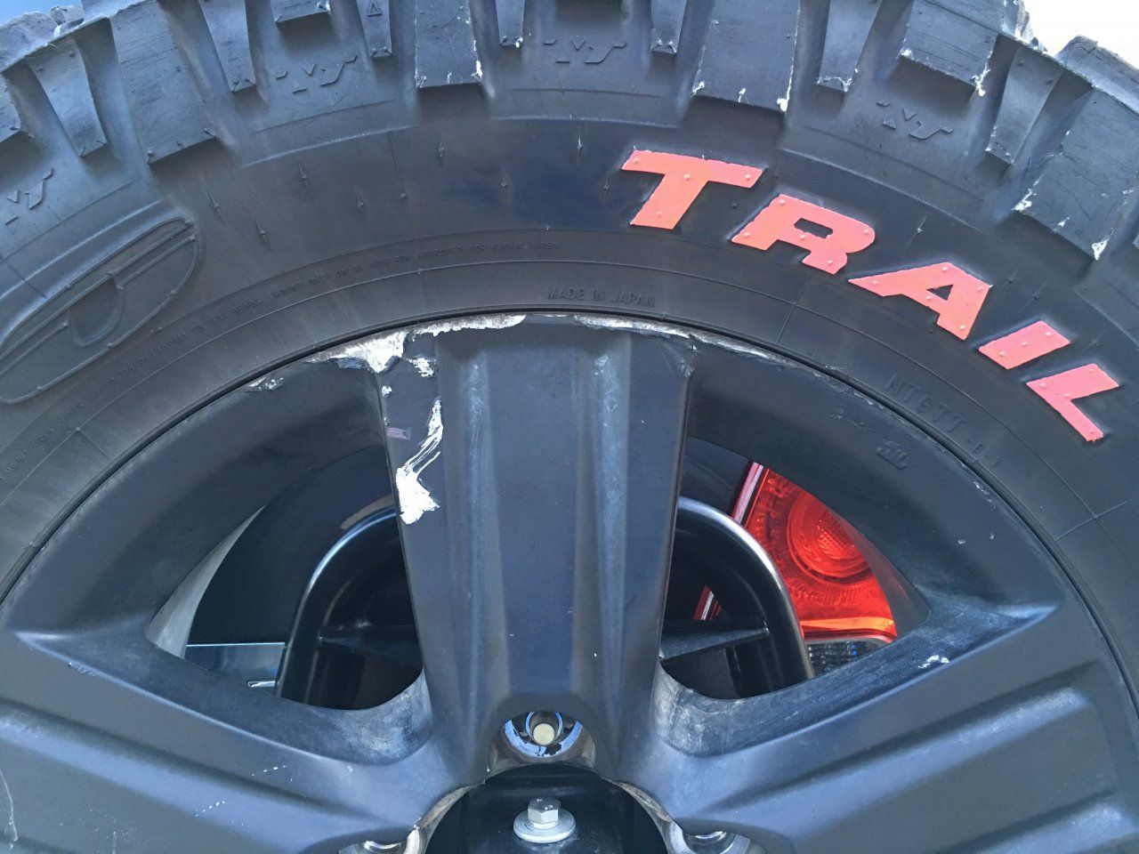

If it helps, I plasti-dipped my wheels last year before Ouray and they have held up for almost an entire year since. I almost only drive my truck to wheel it--on rocky trails and in snow.
I have re-done one wheel (2nd picture) and it took me only a few minutes (pull off the old stuff, wipe the wheel clean with rubbing alcohol, apply a few coats). It's especially nice because overspray on the tire is a non-issue.
There are definitely scuffs and areas that are scraped, but I personally think it looks pretty cool. Plus, re-dipping is super easy, fast and cheap. More money for the expensive mods!

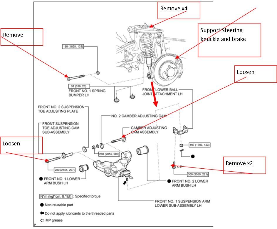

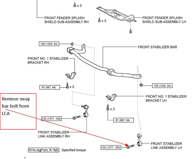

I've briefly mentioned this in other threads but I've never done a write up. I recently had to change one strut and I was able to do it without breaking the steering tie rod or UCA ball joint. It was the fastest I've ever changed a strut. I got the idea when I swapped out my LCAs. Here are two pictures with what to loosen. I don't have time to give you the long story but if you remove the two bolts from the bottom of the steering spindle, remove the swaybar bolt from the LCA, Support the steering spindle and brakes, loosen the LCA bolts and allow it to swing out of the way and the struts can go in and out from below.
I've you're doing this as part of a full install and have the change to UCAs then you'll have to break the ball joint but that's not too hard. Breaking the steering is a beeech. (don't hit the brake guard.
Does all this make sense? Ant
(obviously you'll need an alignment immediately)

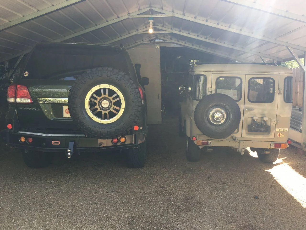

Bought Fat Amy a companion.
