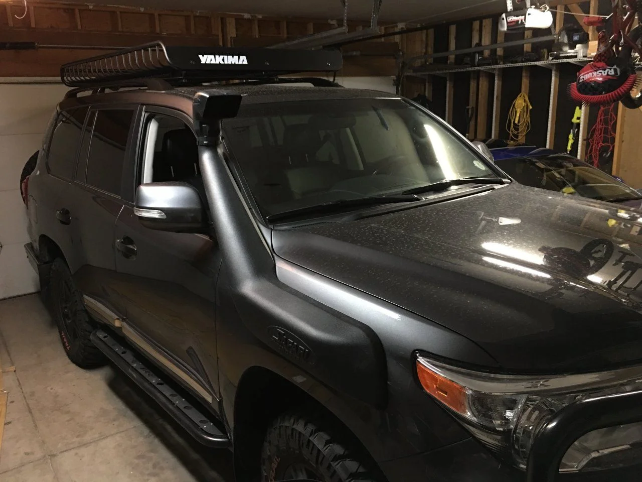

Went with the Yakima Megawarior with extension. Fits in the garage...just barely.
post an after photo when you get a chance @Markuson

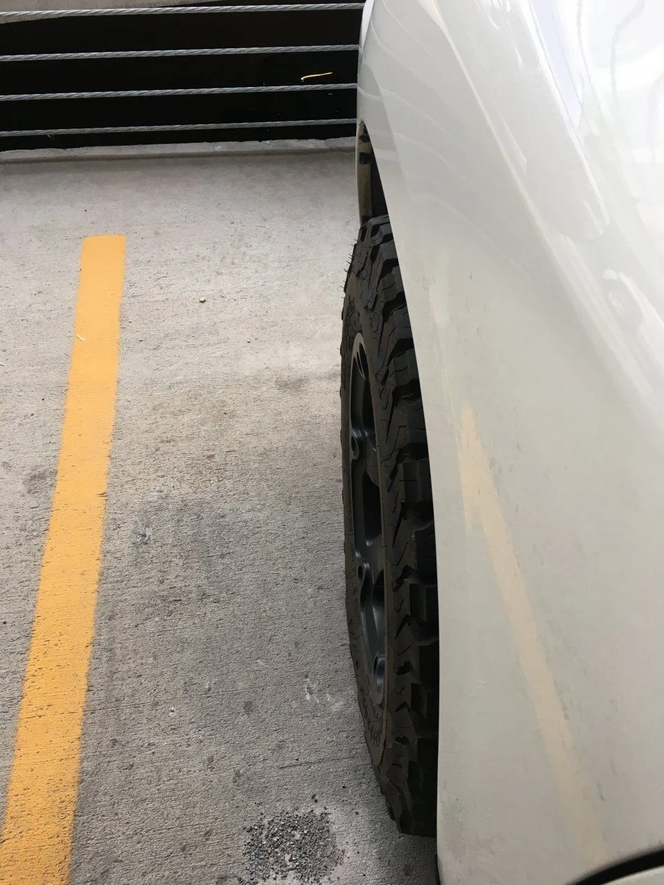

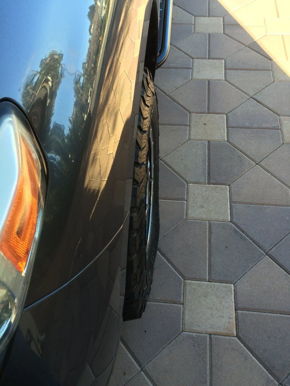

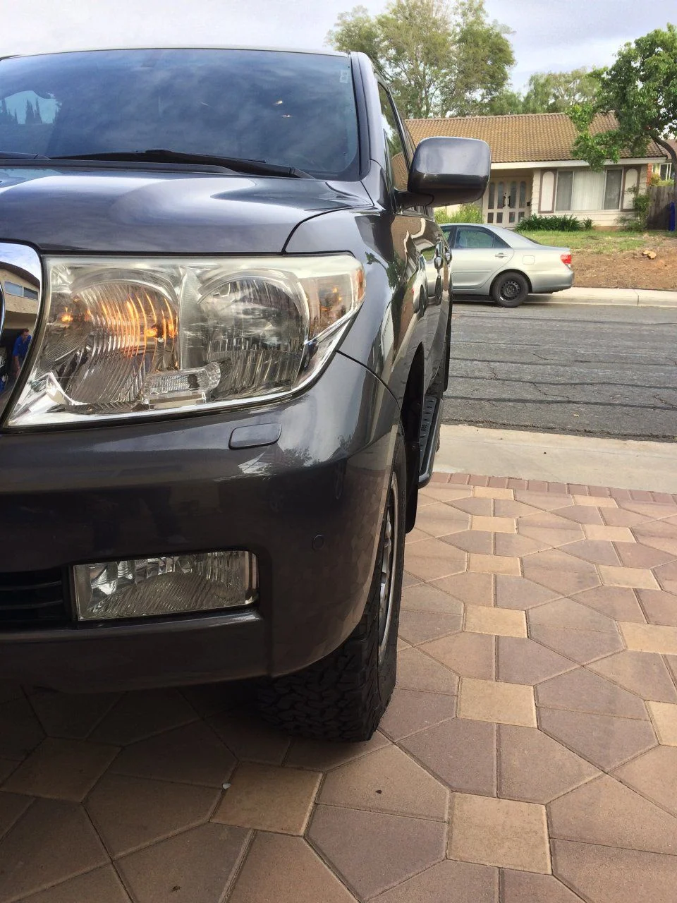

I'm very happy with the result of the 1.25" Spidertrax spacers.
These are not wide tires. Just 285/70/17's on Rock Warriors (50mm).
So... they do not stick out like some with 35x12.5x7s do...
BUT... They are now just about EXACTLY flush with the fender...with perhaps just a hair of the sidewall stickup out a bit...but with the treads throwing rocks and splatter barely inside.
Before this, my tires looked sort of SUNKEN IN within the wheel wells...especially when viewed from the front, or near-front at an angle.
Here's POST SPACER: (notice the back tire too)
Compare that to teh BEFORE here...sunken-in tires:
When you compare the back tire, especially, you can see the difference. In front, it's flush, without sticking out far enough to blast folks with pebbles who are behind you on the highway. The tread is fully enclosed with just a bit of sidewall reaching beyond. Perfect, as far as I'm concerned.

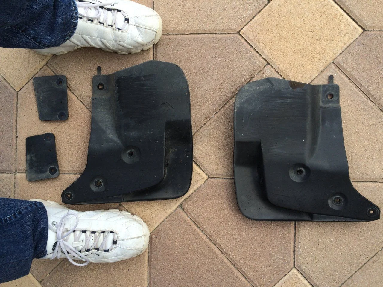

They DID rub... so I removed the mudflaps behind the front wheels:
Personally I think it looks better without them anyway:

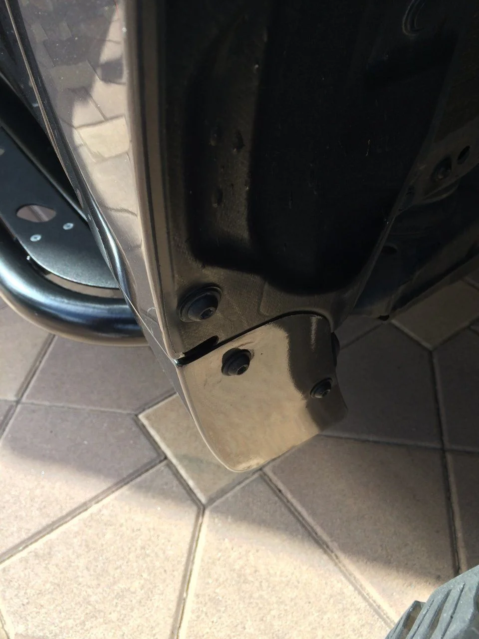

This left a tiny bit of rubbing that I noticed in REVERSE while turning. It was barely touching the little front flaps and a bit of the skirt in front of each tire.
For that, I decided to MELT the bumps in the skirt flat rather than cut them out.
I used a heat gun to soften the small bowed-out parts of the skirt...right where that tiny little extension sticks down...and then used a putty knife to just FLATTEN that particular bump.
...and VOILA!!! All rubbing gone.
I really feel like this accomplished what I wanted.
I wanted to get rid of the sunken-tire factor, but did not want to get the tread beyond the fenders. Sidewall OK...tread, no.
Very happy with the result.
So...
Rock Warriors, 285/70/17 KO2's, and 1.25" Spidertrax spacers...front mudflap removed, and tiny portion of front skirt heat-flattened...
...and all good!

One more re: the Spacers... Showing the front well with treads inside, but sidewall juuuust peaking out.

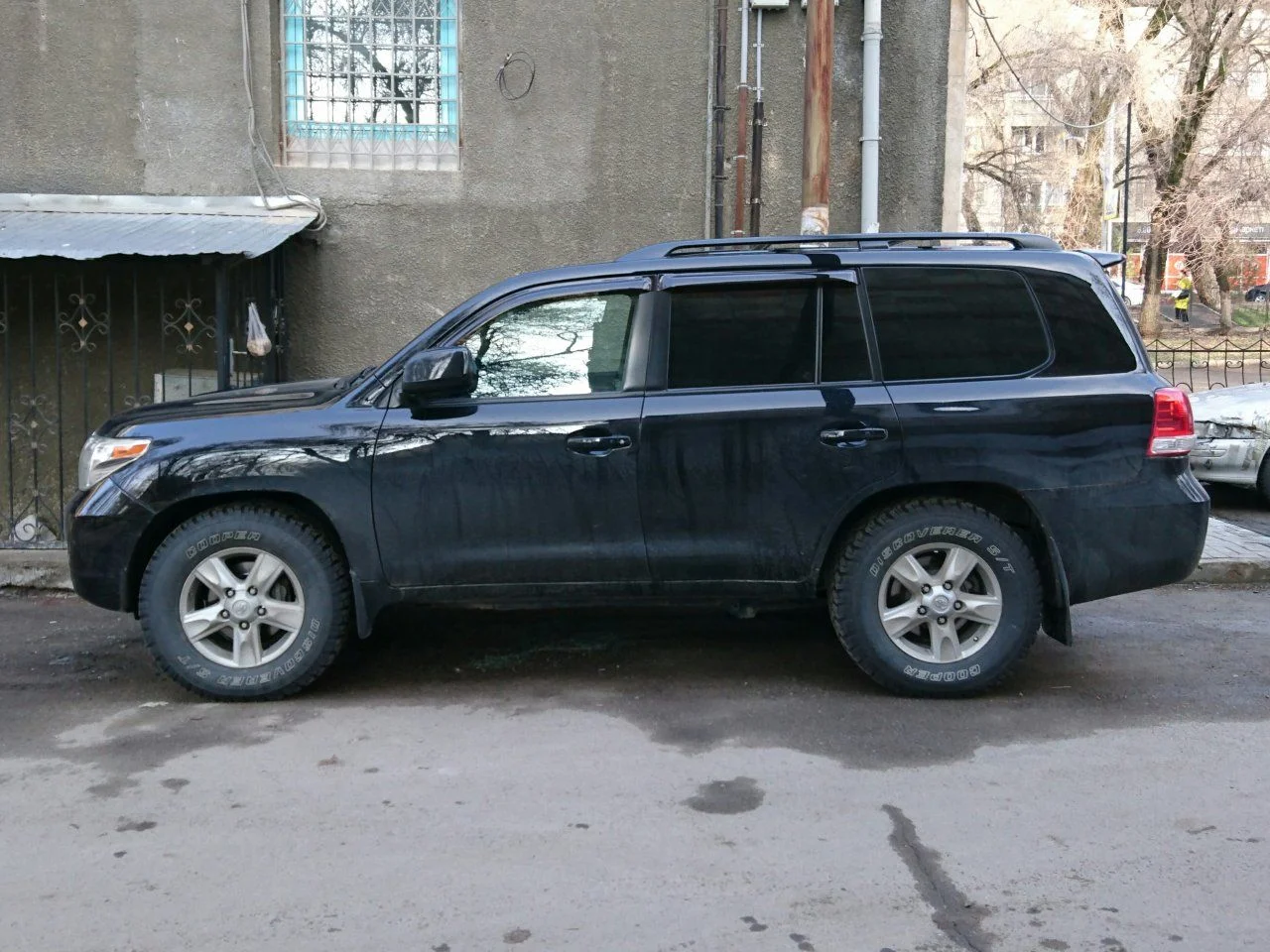

Installed Ironman Foam Cell Pro shocks with Performance (B) springs. My old springs were quite a bit tired, so instead of 2" I gained about 3" in the front and 4" in the rear. Also replaced tie rod ends but that's just maintenance:)
Before:
After:

Looks pretty similar to my 20Mm offset wheels without spacers, cool!
Ya... With the Rock Warrior offset (50), + 1.25", I think it comes to a total offset of about 18...so should be pretty close to yours.
Are those 18" wheels? If so, I think your tires are slightly larger than mine over all...?
I had to remove mud flaps and slightly re-shape the front skirt... Curious if you needed to. ?
Yes they are 18", the tires are stock size 285/60/18, I did not do anything, once in a while when I back up at full lock I do rub, but it's so seldom that I did not do anything.
Ah! 285/60/18's are actually a bit smaller than mine by about an inch, which would have cleared on mine too...
