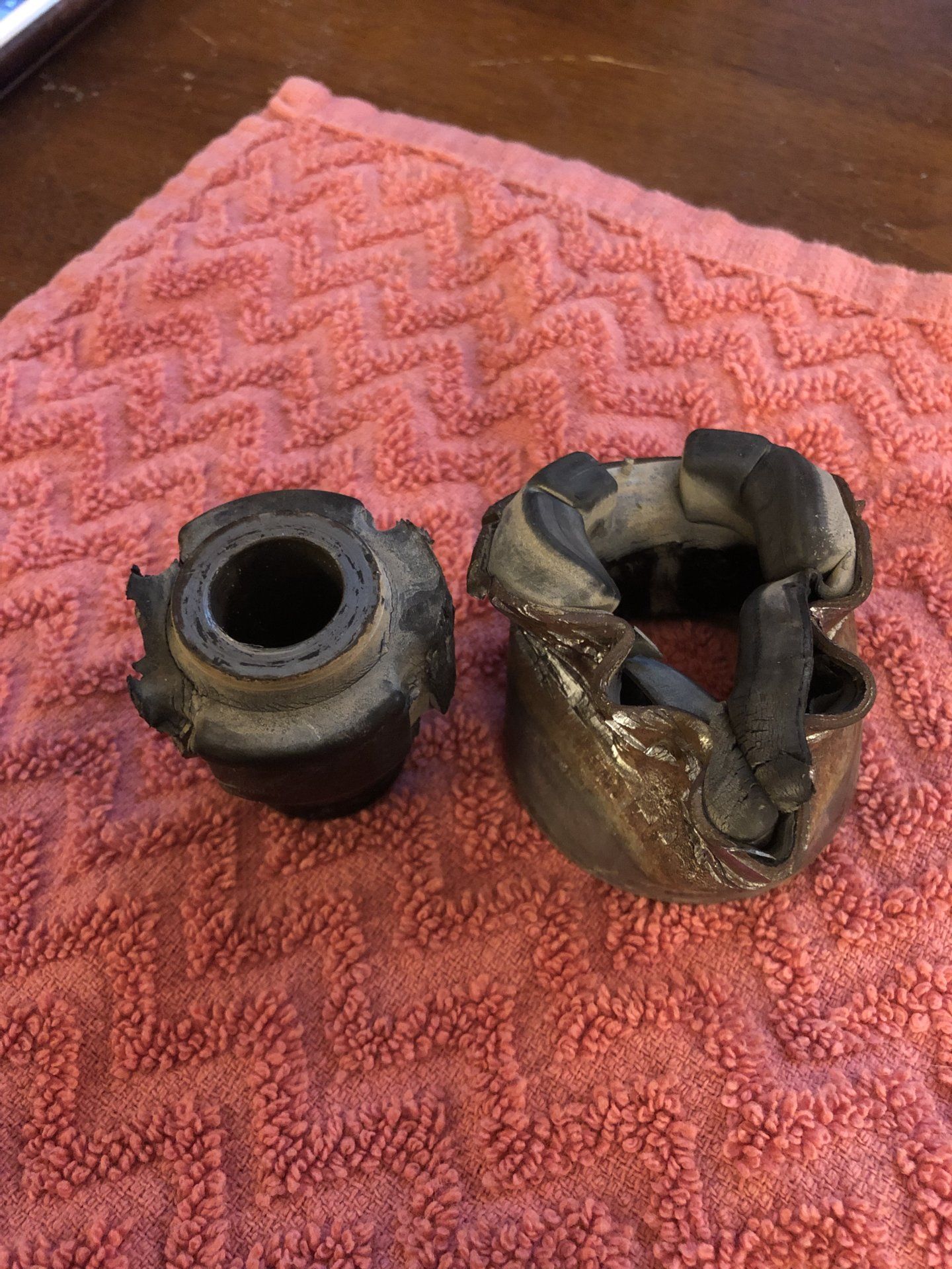

Finally got around to changing my front most front diff bushing that I’ve been dreading. As happens most of the time it wasn’t near as tough as I thought it would be. I was ready with an air chisel but didn’t even use it.
When I removed the bolt the inside of the bushing just fell out. It was definitely shot. It took me about 10 minutes to remove the bushing with a BFH and hand chisel. I pressed the new bushing back in with a ball joint press. The toughest part of the whole operation was just getting the new bushing to start straight. All in all the entire job took about an hour.
Now my clunk is gone and everything just feels tighter. I should have done this a long time ago!!!

Hah! Yeah. I think the issue most people have is not using a big enough BFH and chisel. I used a 3lb sledge and a beefy chisel. The bushing metal gave like butter with that setup.
Oddly enough the two most utilized tools in my bag are the BFH and Torque wrench.
Is there a right up for this? Or a video that you followed?
