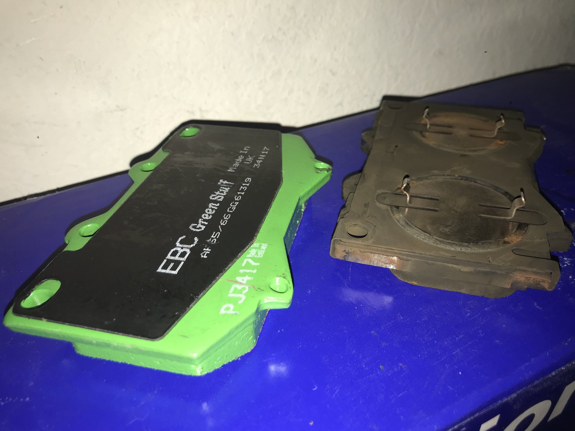

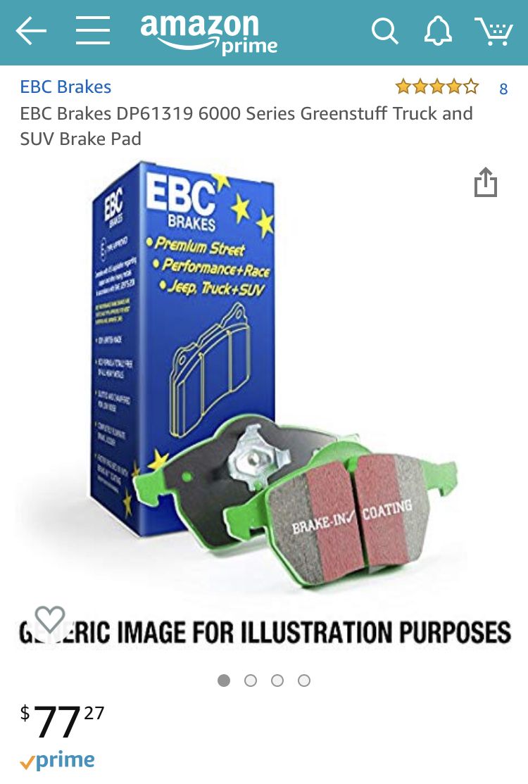

@bentonrover after a few days of research i went for the EBC slotted & dimpled rotors and 6000 series green stuff pads. I initially ordered Yellow stuff but later realized and confirmed thru a few friends that it sheds a lot of brake dust while stopping power is almost the same (unless on a track day).
Here’s a comparison on the OEM Toyota and the new pads
The EBC pads already has a shim on it (on double sided adhesive)

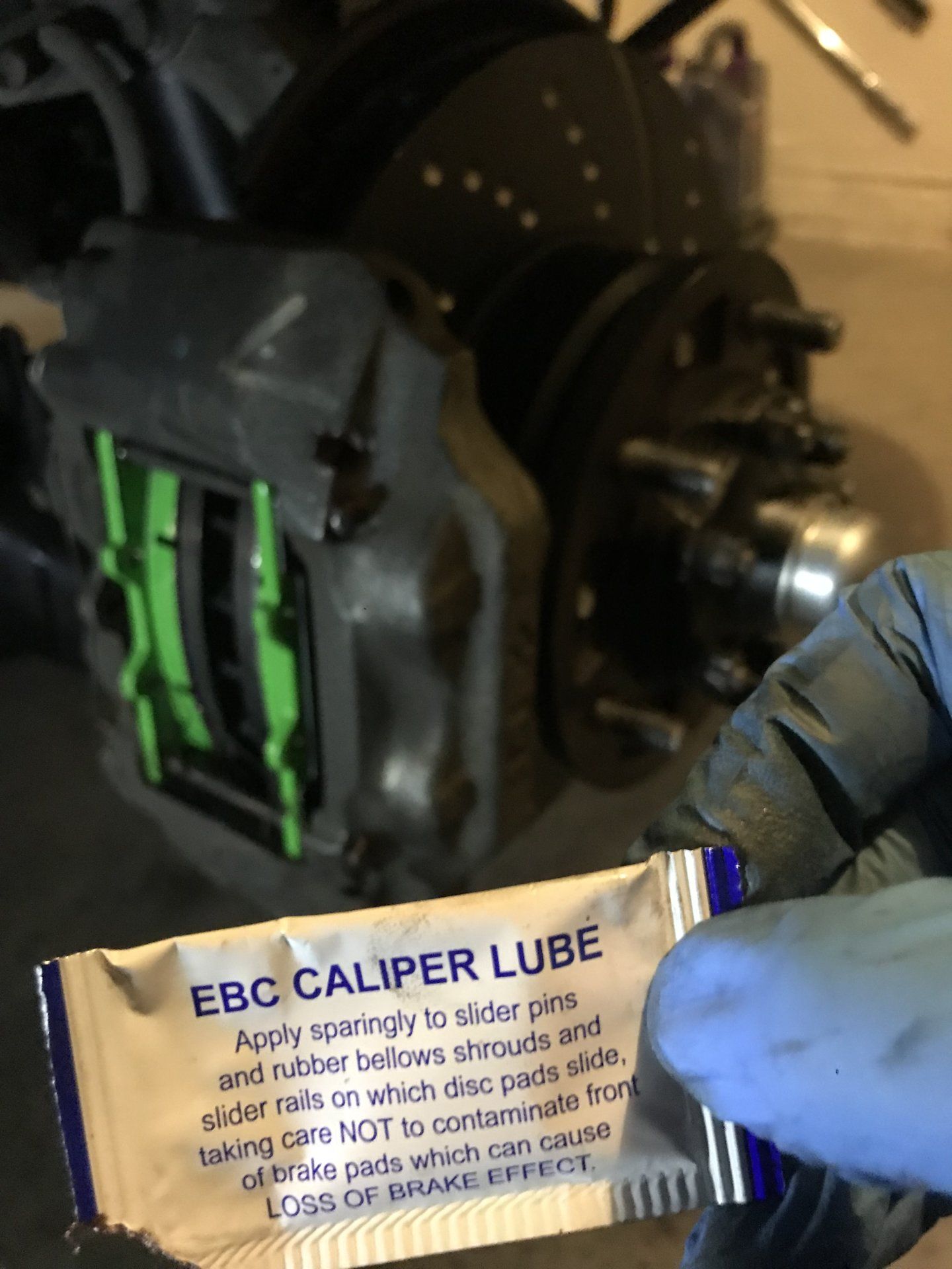

While at it I serviced the wheel bearings too made sure it’s still intact (thankfully it is), repacked fully synthetic grease on the hub, cleaned the surfaces too using steel wire brush and semi-detailed the wheel well area, even pulled down the OE skid plate and repainted it full with 2K polyurethane clear lol.
Even came with this:
Looks like it’s a type of anti-seize grease similar to that of what Denso provides with their Oxygen sensors except this is metallic gold in color.
Here’s a comparison on the OEM Toyota and the new padsView attachment 2009406
Where did you purchase from? I’m close to needing a brake service
