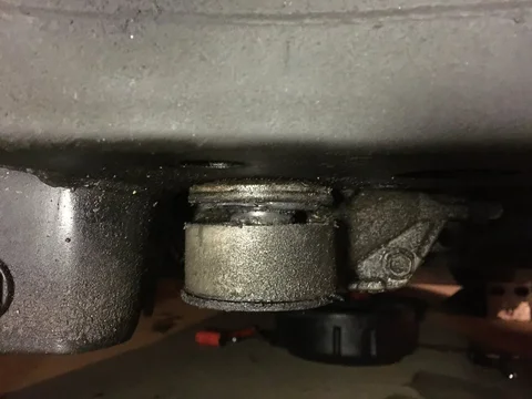

So that no-one makes the mistake I made today, I wouldn't recommend doing this in-situ, tried to press the bushing in when the front diff cover was still installed and cracked the front support, as per the picture, just a bit of FYI, (Pretty sure I have caused this due to the angle being a little bit skewed)

View attachment 693012View attachment 693013
Gentlemen, I'm needing to replace the front diff bushing. I've ordered the cushion mentioned earlier, but do I need? two? I haven't checked the rear mounts' bushings since reading this thread. The oil is from my valve cover bolts being less than finger tight....
