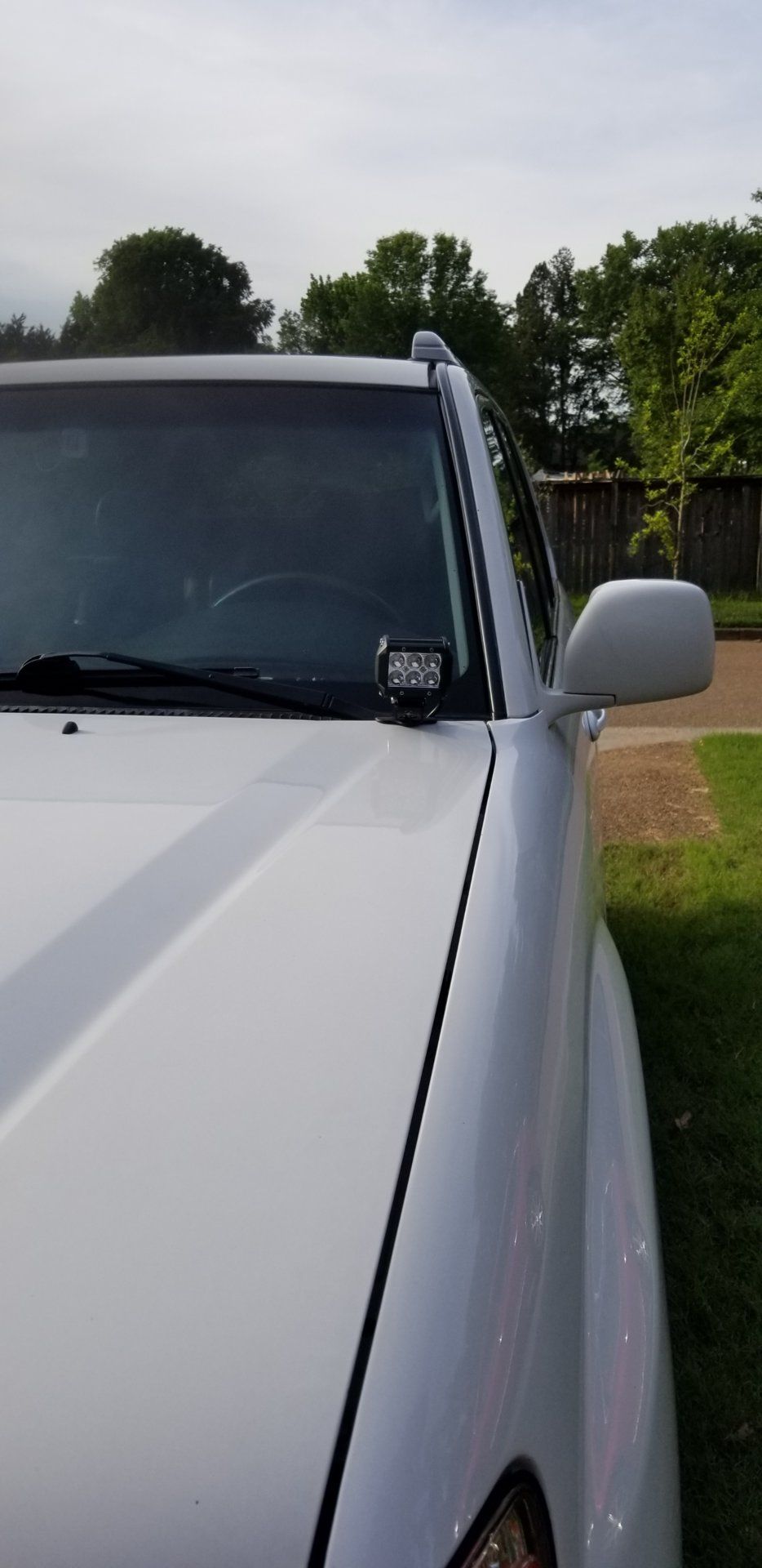

Got 2 of my 6 lights installed and wired up. Have to change the wire on the switch as I must switched it or it was backwards as the light in the switch is staying on. Easy fix but was too tired to mess with it once I was done. Two more will go on the bull bar and two more on the rear. I will post the rear when done as I bought 2 brackets for a ATV for $12 and with a little more bending on the vice they will be ready to mount lights.
