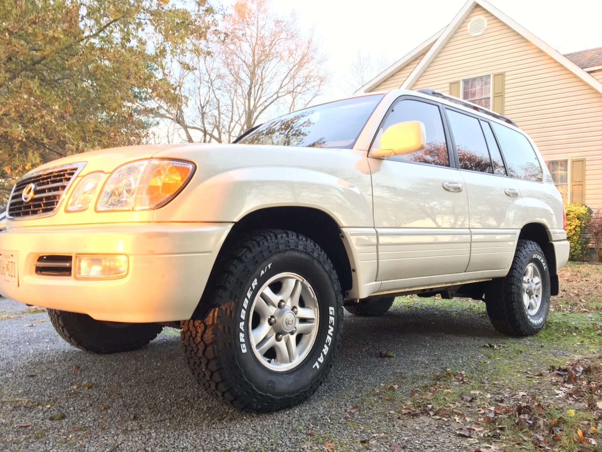

Recently put some new shoes on my LX. I went with the General Grabber AT-X in 285/75R16. They are really quiet. Also installed the Precision LED interior lighting kit from their black Friday sale. I still have a lot to do.
