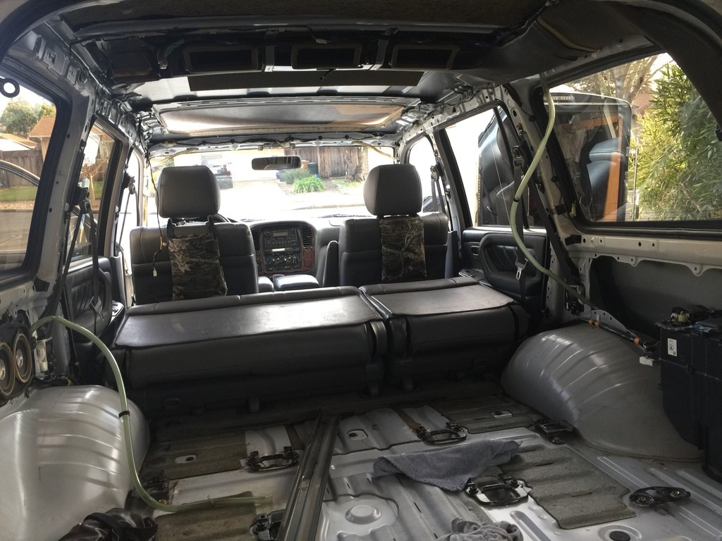

Walked out after letting the Cruiser sit in the rain for a couple of days and checked the rear cargo area for water. Found a wet carpet & pad a while back, but never found the source of the leak.
It's back.
Sunday, it's raining, might as well find it now....
Take out a couple of parts... look for water....
Seems to be dripping on top of the speaker housing....
Do a search on MUD and find info on the 1/4 window belt moulding leaking around the clips.
Yep, that's it.
Off to search for sealant and parts tomorrow.
