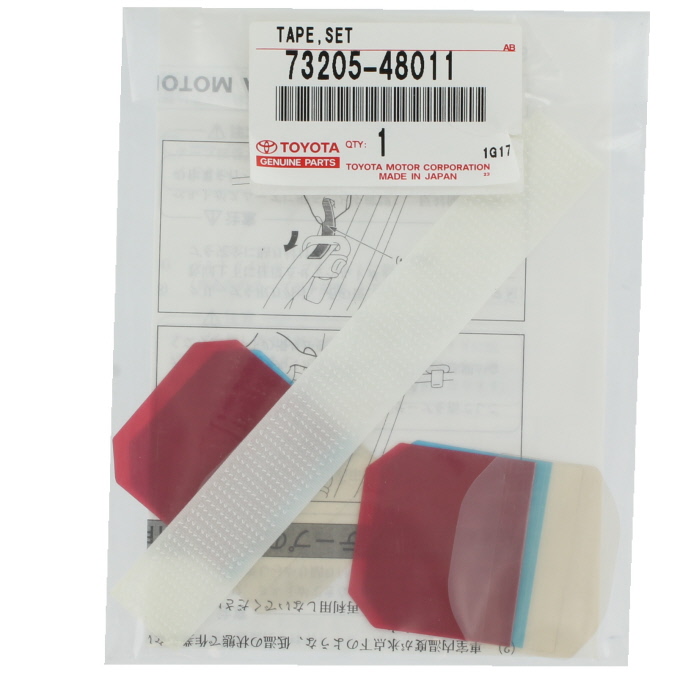

If you're feel like REALLY getting after the belts, Toyota makes a kit that includes some Velcro to clean the plastic loop the belt pass through as well as some slick tape to place over that surface to aid in the belt gliding over it.
