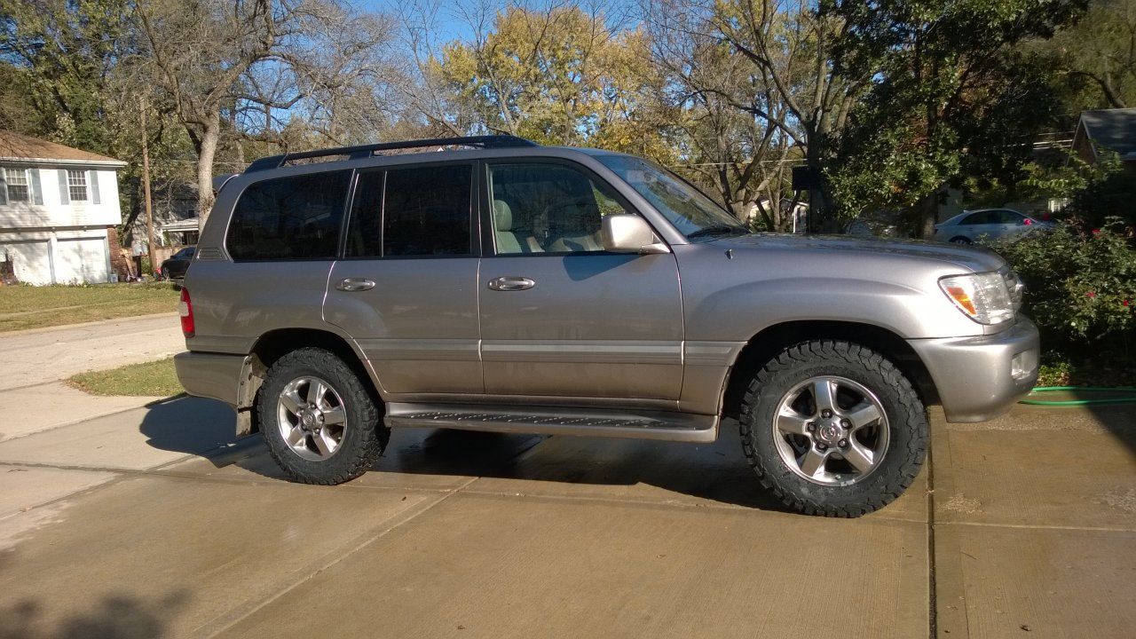

I bought a high mileage ( 325,000 miles ) 100 a couple weeks ago that was in great shape considering miles. The PO had spent around $8,000 on it in the last 10,000 miles, new timing belt & water pump, ignition coils, radiator, brakes, rotors, and a bunch of other service items. Anyways, got it for $3,400 and it runs like a new one and zero drips on the underside. It's been in Tennessee since new so there's no rust. She's not perfect on the outside and the front seats look a little rough but I'm really happy with it. Ordered a new OME lift from Kurt at Cruiser Outfitters and got it on this week, also installed a Amazon snorkel, extended my diff breathers, and had some new 295 tires put on today. She'll be heading to the fabricator shop next week for sliders, roof rack, rear bumper with dual swing outs and front winch bumper. I didn't care much for the mahogany pearl color at first but it's growing on me.
This is the day I bought it
This is today
@10ga looks good! Those 295 TGs look great. I think I may pick some up for my new LX I got.
Thanks, man. I caught those last week on eaby for $508 delivered to the door. It was a promo Discount Tire Direct was doing. I've only driven them home but seem to be a good tire.
I'm sorry, they were $608.......had my numbers turned around. Still a good deal. Local shop wanted over $1000 for 4
