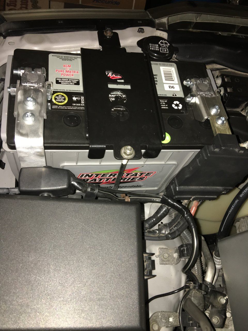

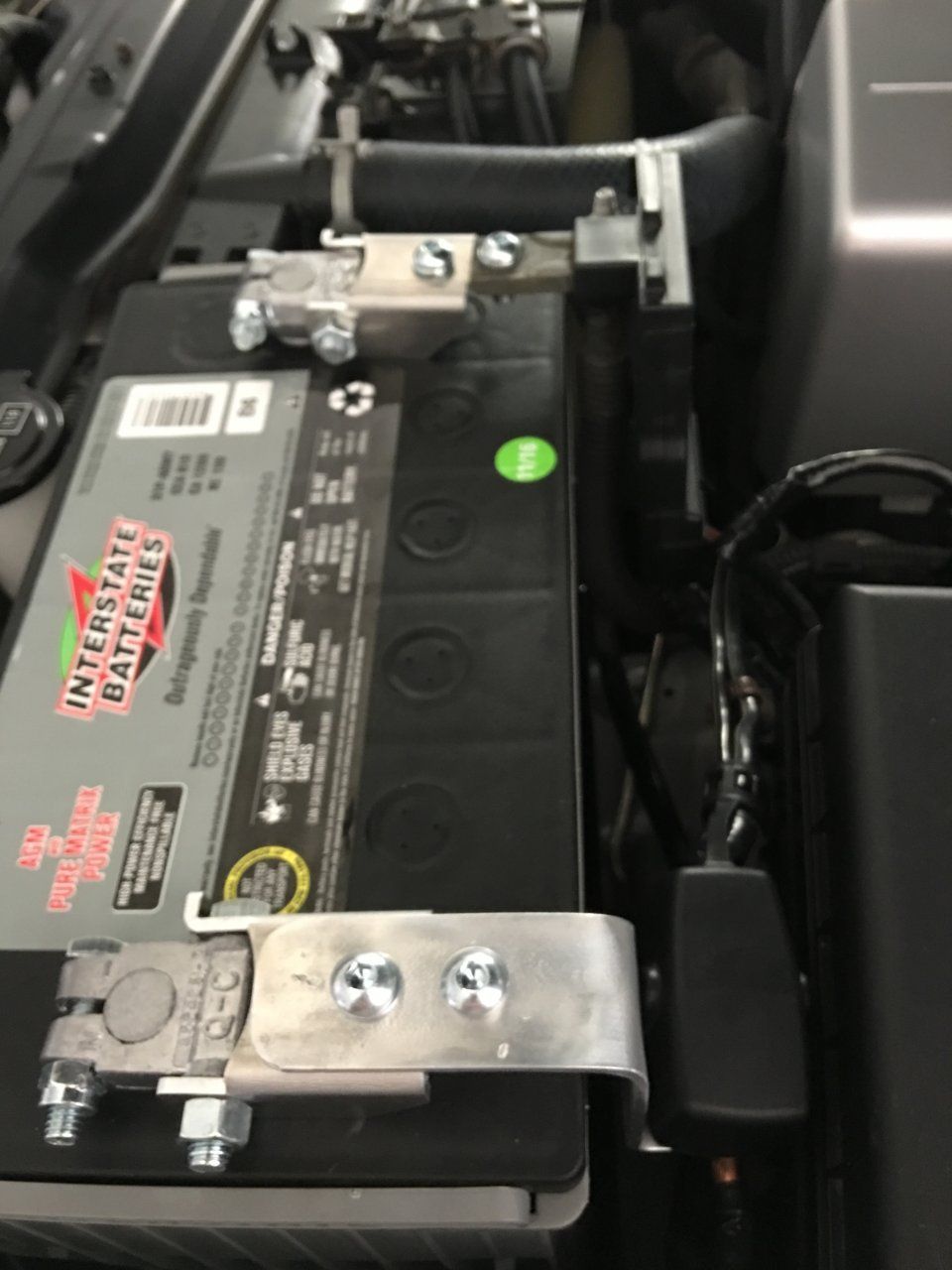

Where did you get those adapters that connect to the military-style terminals? And is that bar relocating the negative terminal post home brewed? Any more details? Thanks.
The adapters for the military terminals came as part of the Slee group 31 battery tray.
I had the bracket relocating the negative terminal post made from flat aluminum. The aluminum is the same gauge thickness as the adapters. Probably could have made it myself but wanted to ensure I got the angles right so the negative post would fit right behind the battery. I have a crude drawing with measurements that work with the Interstate battery. I can take a pic and send to you or post if you're interested.

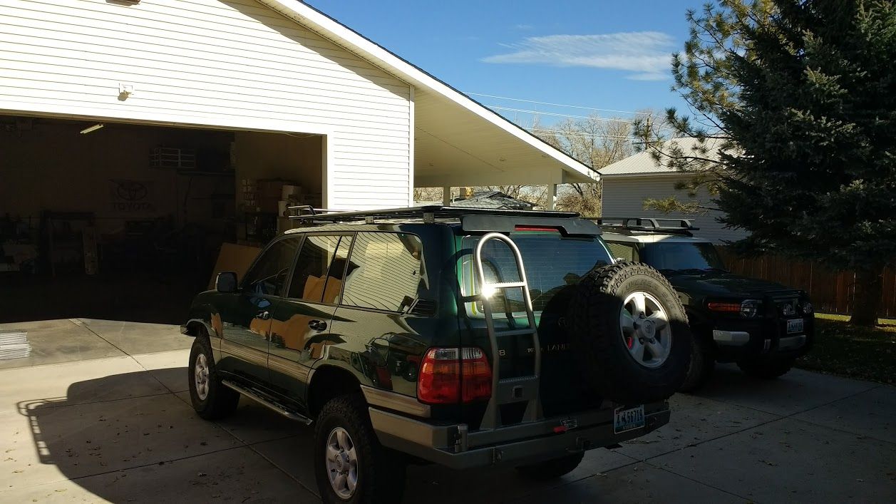

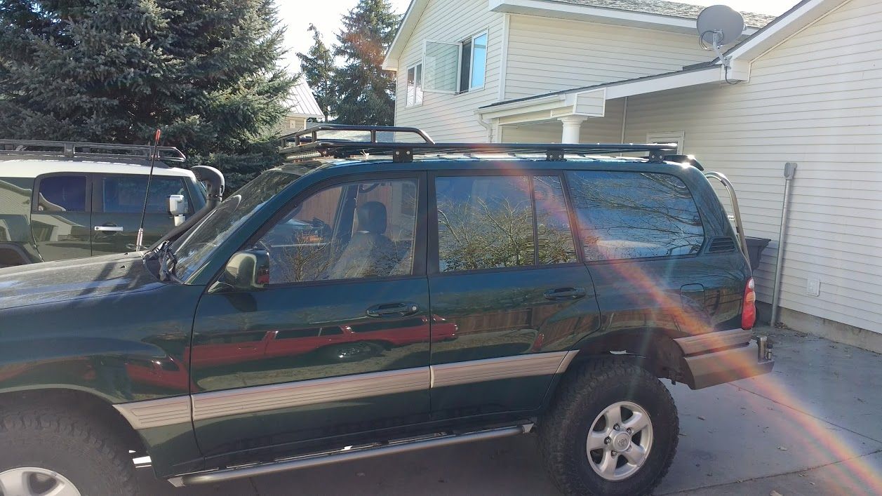

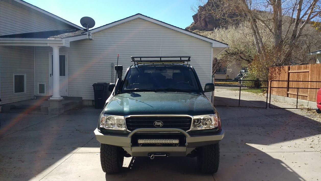

Rack is on. Extremely happy with the new mounts and the low profile. Approx. 5/8" off the highest ridge. I weigh 260# and standing on the center of that crossbar I still have 1/2" of clearance. I can live with 1/8" of deflection over a 50" span of 1" tube all day long. The light bar is about 3/8" off the roof.
Still need to do all my wiring and add the rear rack lights as well.
