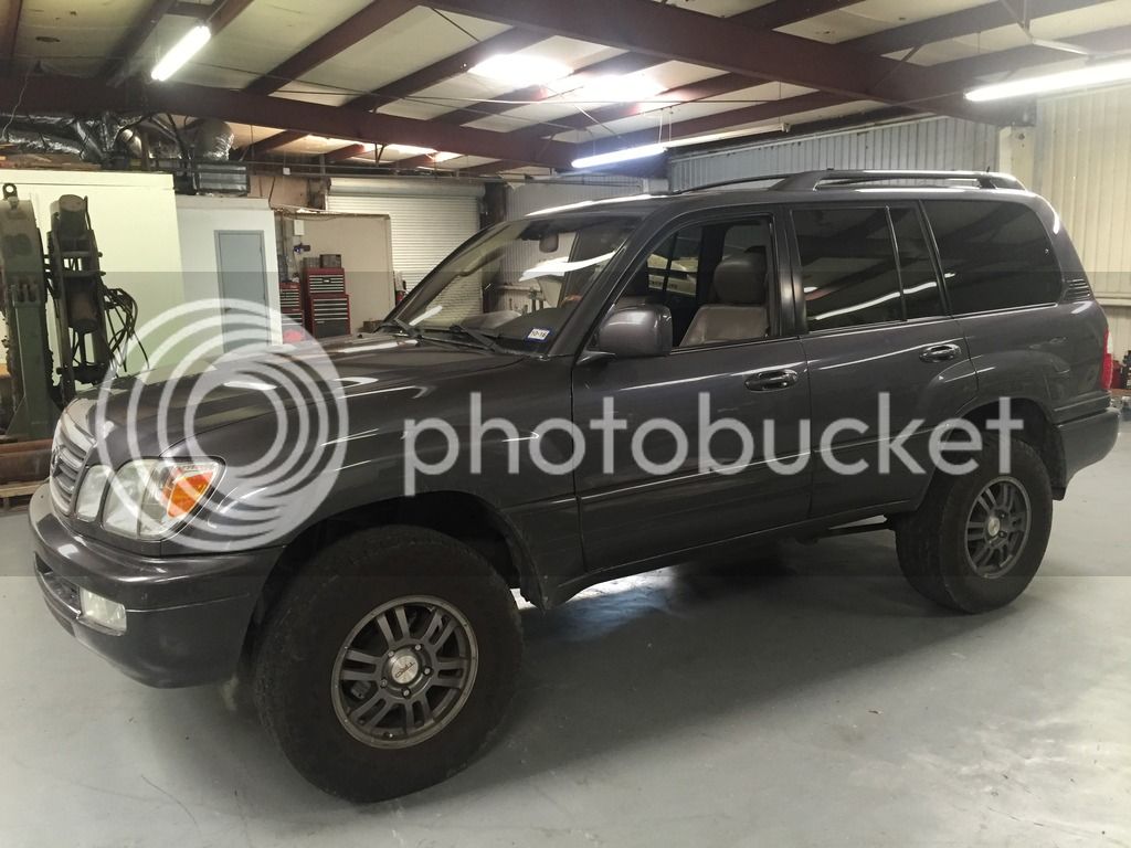

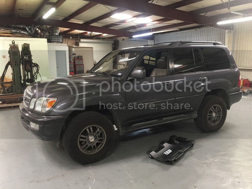

My wife wouldn't let me take the side steps off. Well, we've been married 11months, I'm gonna go ahead and do it now so that I have Mexico and our anniversary to make it up to her haha.
And installed my factory 18s with 33x12.5x18 Toyo MTs.
Needless to say, I'm very happy with its look now. I do still love my RW wheels but a little change is nice now and then.

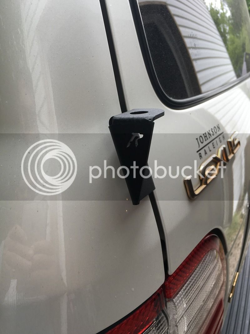

Installed labraks brackets for the rear. Now have to install the CB antenna. Got 2 brackets and will put a LED light on the other side but don't have one yet so I'll have to get that coming.

Are you running wheel spacers with your wheel setup? If so how much? How's your upper control arm clearance?
I'm running Slee 1.25inch spacers and with the 33x12.5x18 I still have about 1 3/8ths gap between the sidewall and the UCA. But I might note that I'm running a OME Medium Kit with UCAs upgraded.
Cool, thank you for the information.
