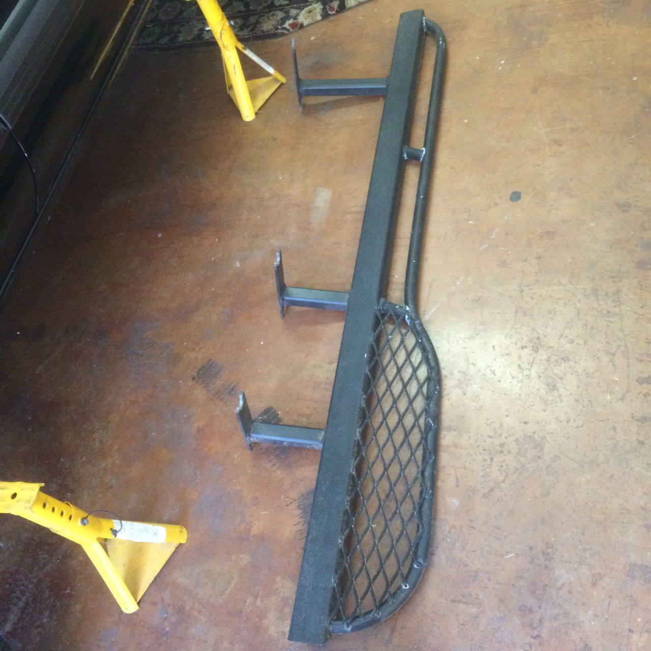

Did a lot this past weekend. My cousin fabbed up sliders last fall and just got them installed. Sliders are not finished gonna reinforce the feet that mount to the frame so I can hi lift on them
Installed 1in coil spacers, cranked the T bars and Fox 2.0 in the rear. Already had OME 865s
I also have 285 General grabber AT2s. Here is my truck next to a stock worn out 100

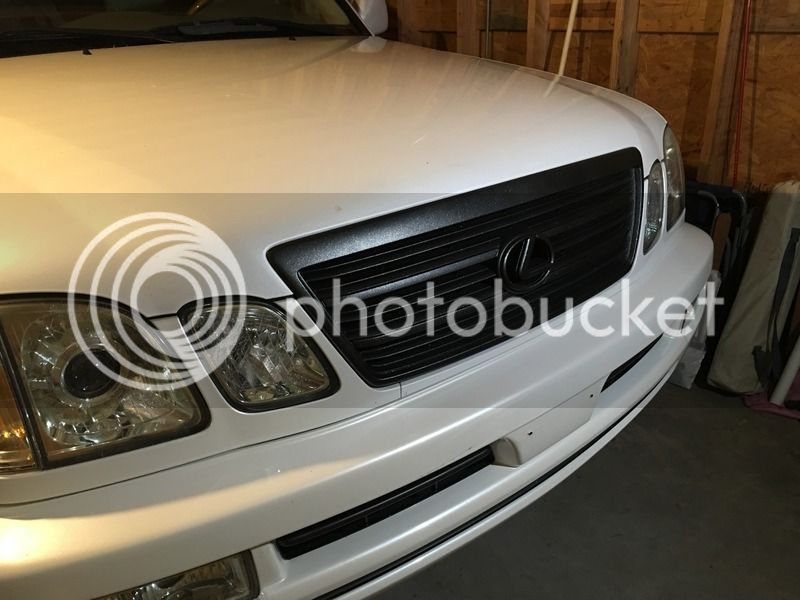

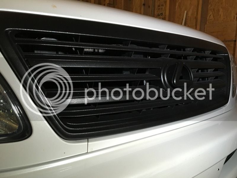

I blacked out my grill and removed some emblems on the rear and painted the Lexus emblem and the chrome the same color as the grill.
Ive been thinking about doing this to my LX470 also. Im certain that its the same color!! Do you like how it turned out?
Looks good @redman333, what paint did you use? Or is that Plastidip?
It's plastidip. I used 4 coats of plain black. Then 1 light coat of copper metallizer, 3 light coats of silver metallizer and one more light coat of copper again.
I love how it turned out! I have done plain black on other vehicles of mine but it tends to look like a faded flat black. I didn't want that. This way it has a slight metallic black look to it and semi gloss shine.
Best photo I have of my grill which has the gun metal color with graphite metalizer. The graphite metalizer looks awesome on the gun metal grey and the black. I bought something like 15 cans of it lol
