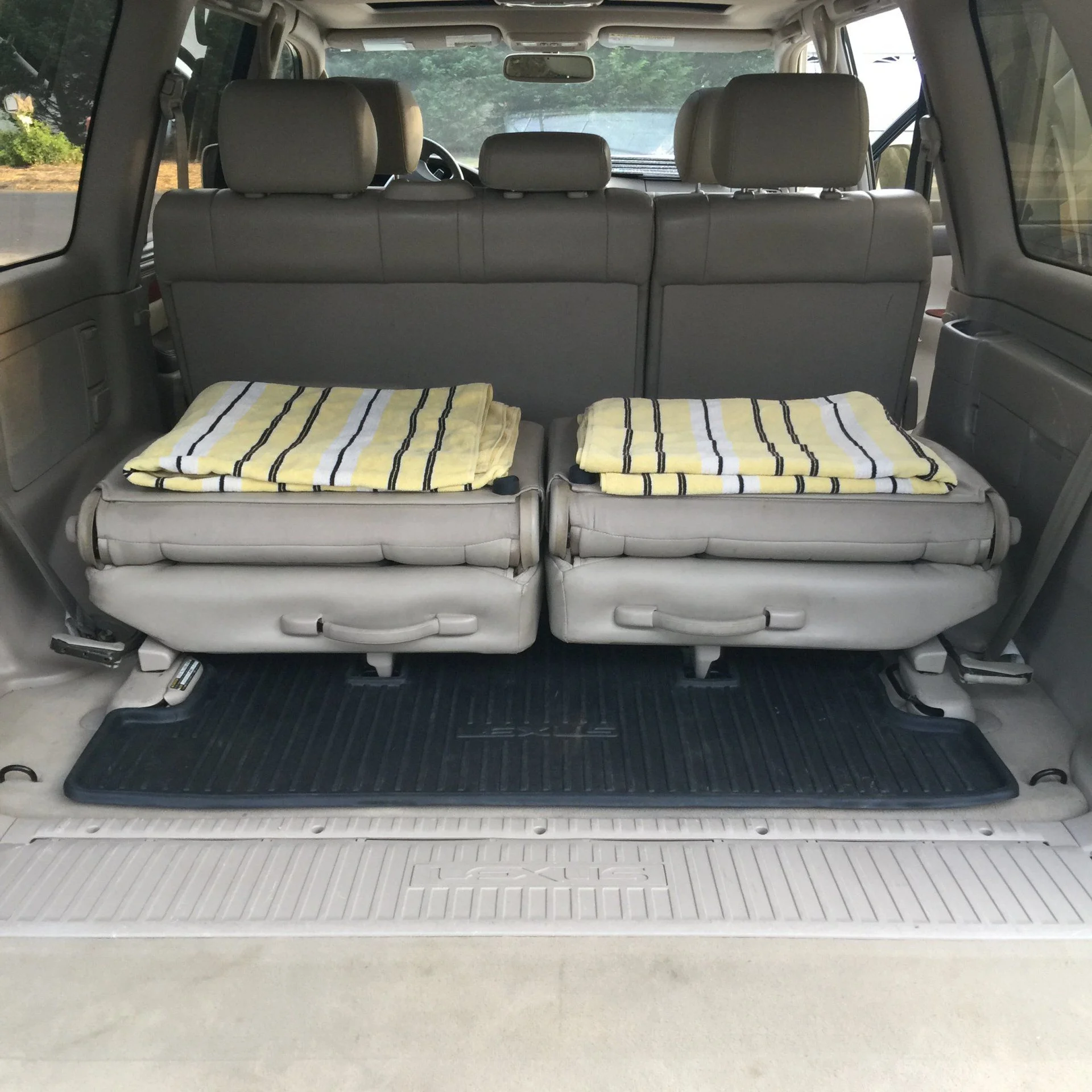

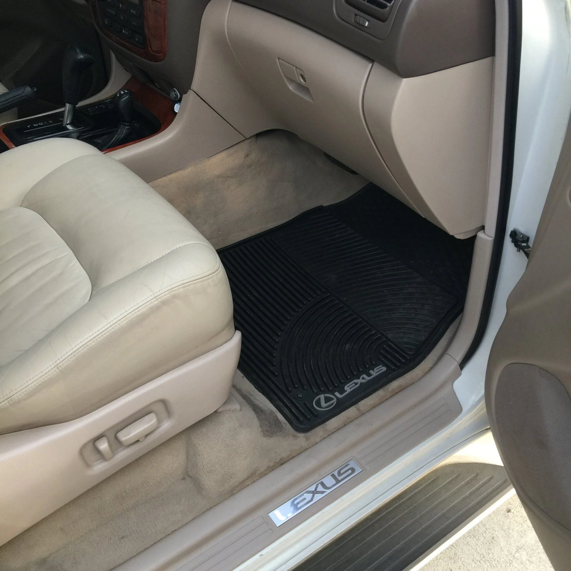

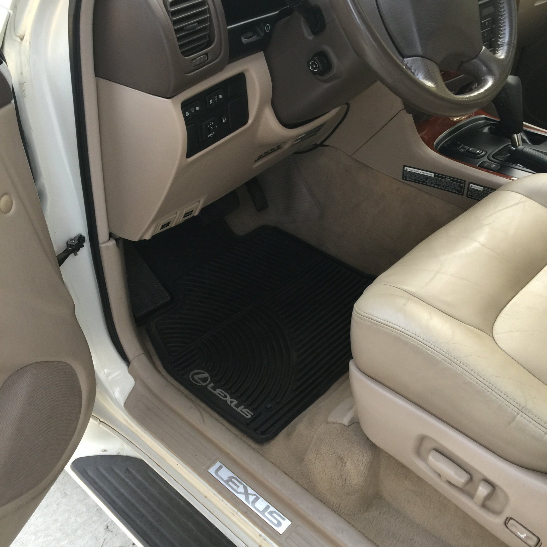

Installed my new, (to me at least), OEM All Weather Mats! Been looking for these for ages now....thanks to @VidereStudios for hooking me up!!

What the heck. I thought these were unobtainium. I just bought some Weathertech's but love these. @VidereStudios do they come in gray?

You are welcome Grayson. I am glad they could go to a good home! They look great in your rig!
They pretty much are...I haven't seen them up for sale anywhere for ages. I only happened to get a complete set when one of the LX's I bought from a private party came with them installed. I think that is the only way to find them now.
They are super nice...seem to be made a bit stronger than the Weathertech's and the fit is obviously perfect. I only got rid of them because I am tearing out my interior to make it more of a camping rig.
