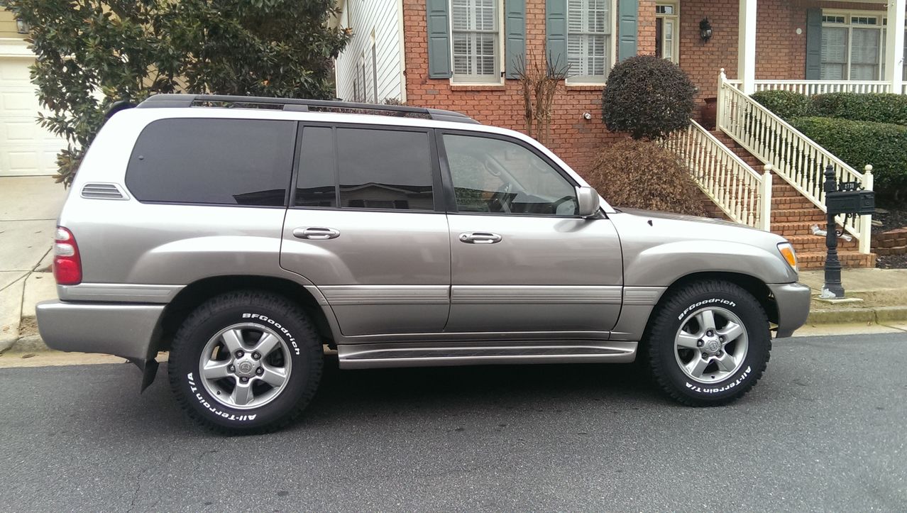

Poser pics of new BFG AT KOs in 275/70r18. Running boards on and white letters out, for the haters :flipoff2:. The new tires really highlight the need to crank the torsion bars.
