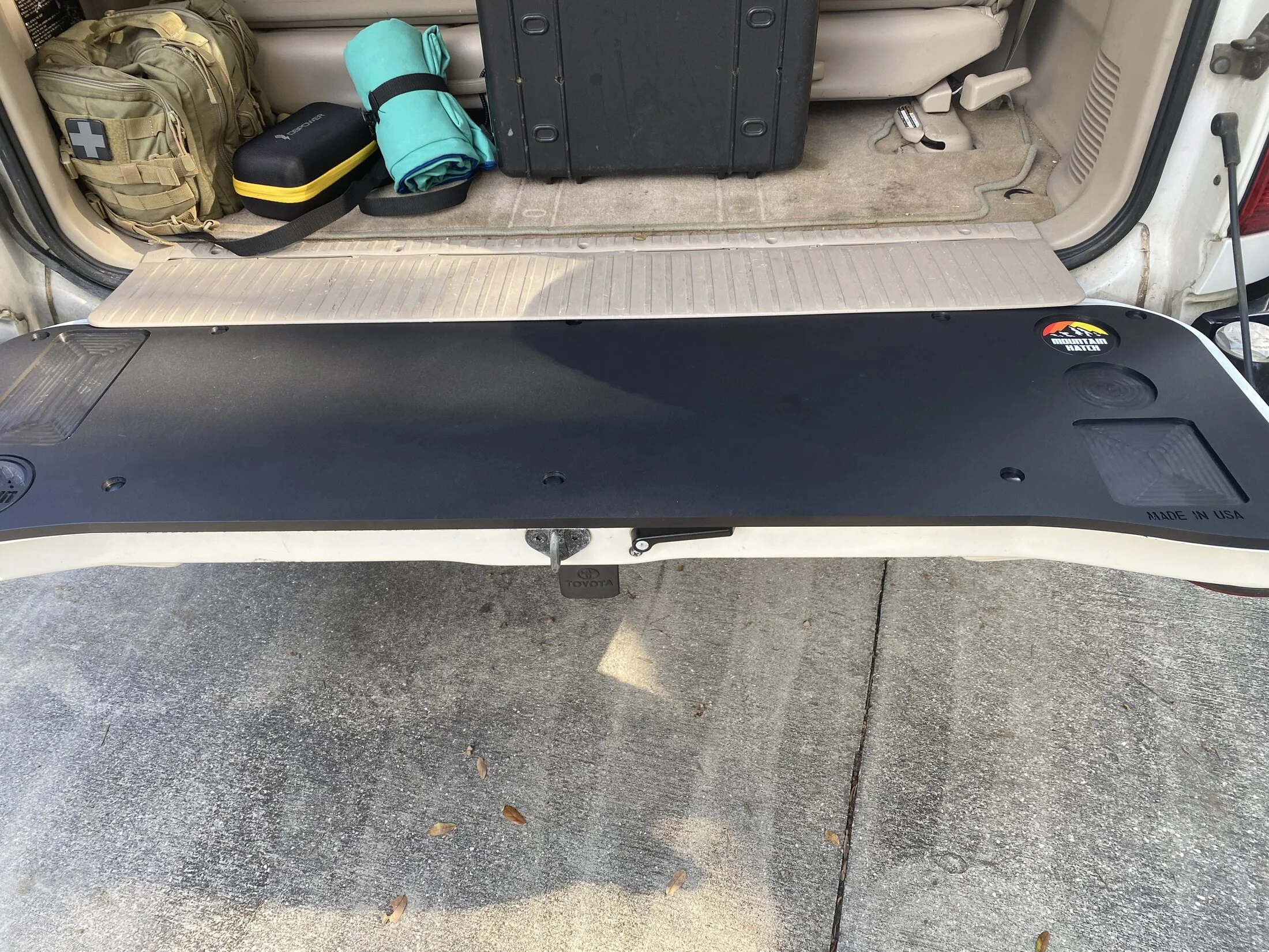

Replaced the tailgate carpet with a Mountain Hatch top.

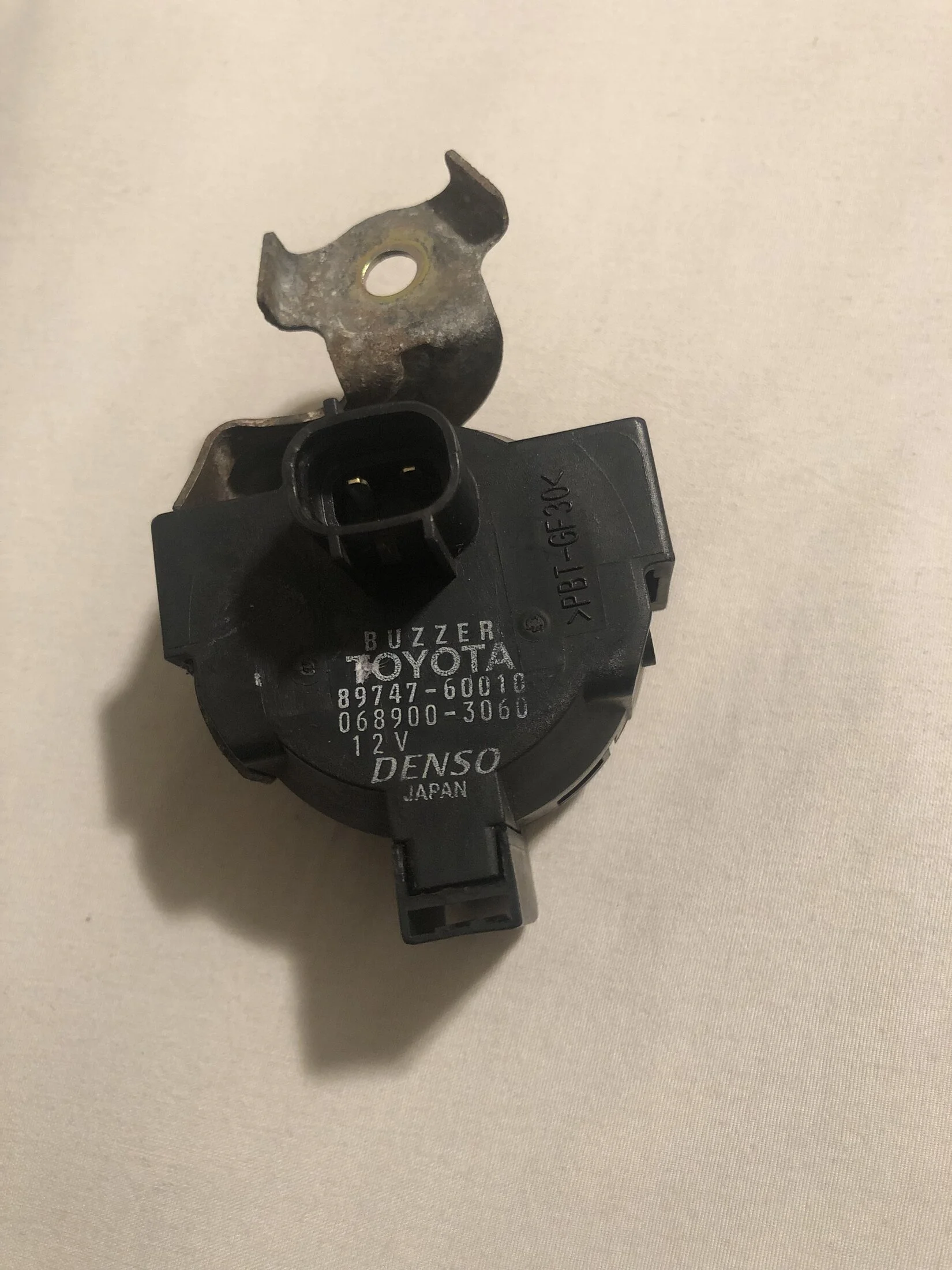

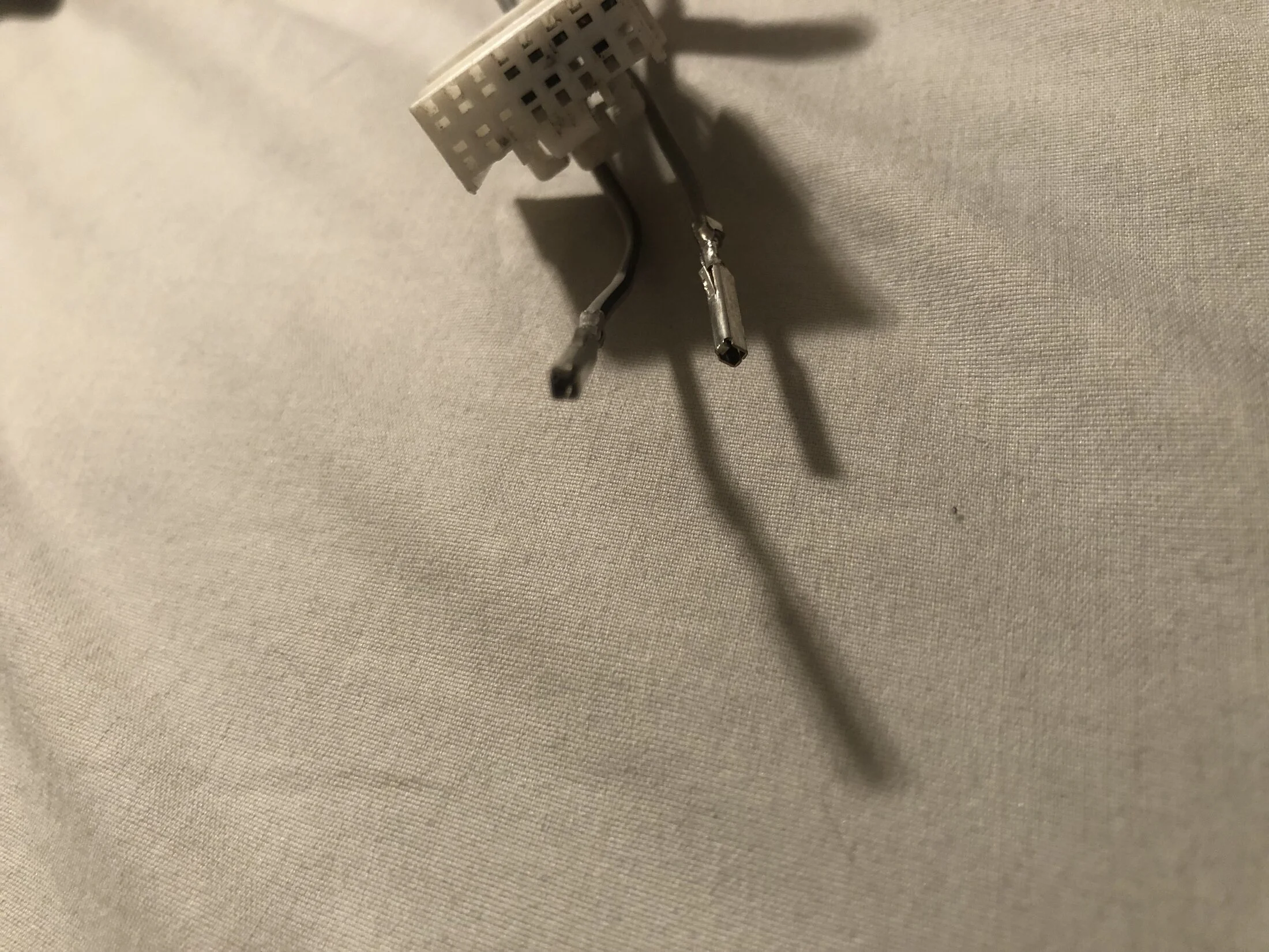

Added the Lexus wireless door lock buzzer to my LC. I followed the instructions here:
Thread 'Keyless Entry chirp added to 98' 100- EZ Mod'
Keyless Entry chirp added to 98' 100- EZ Mod - https://forum.ih8mud.com/threads/keyless-entry-chirp-added-to-98-100-ez-mod.44462/
I bought a kit of terminal connectors to fit into the wire harness that connects to the security box but they were all too big. Ended up de-pinning and old stereo connector that I had in the junk pile and it fit perfectly ($0) 😩
I have one extra buzzer that I’ll put in the classifieds if anyone is looking for one.

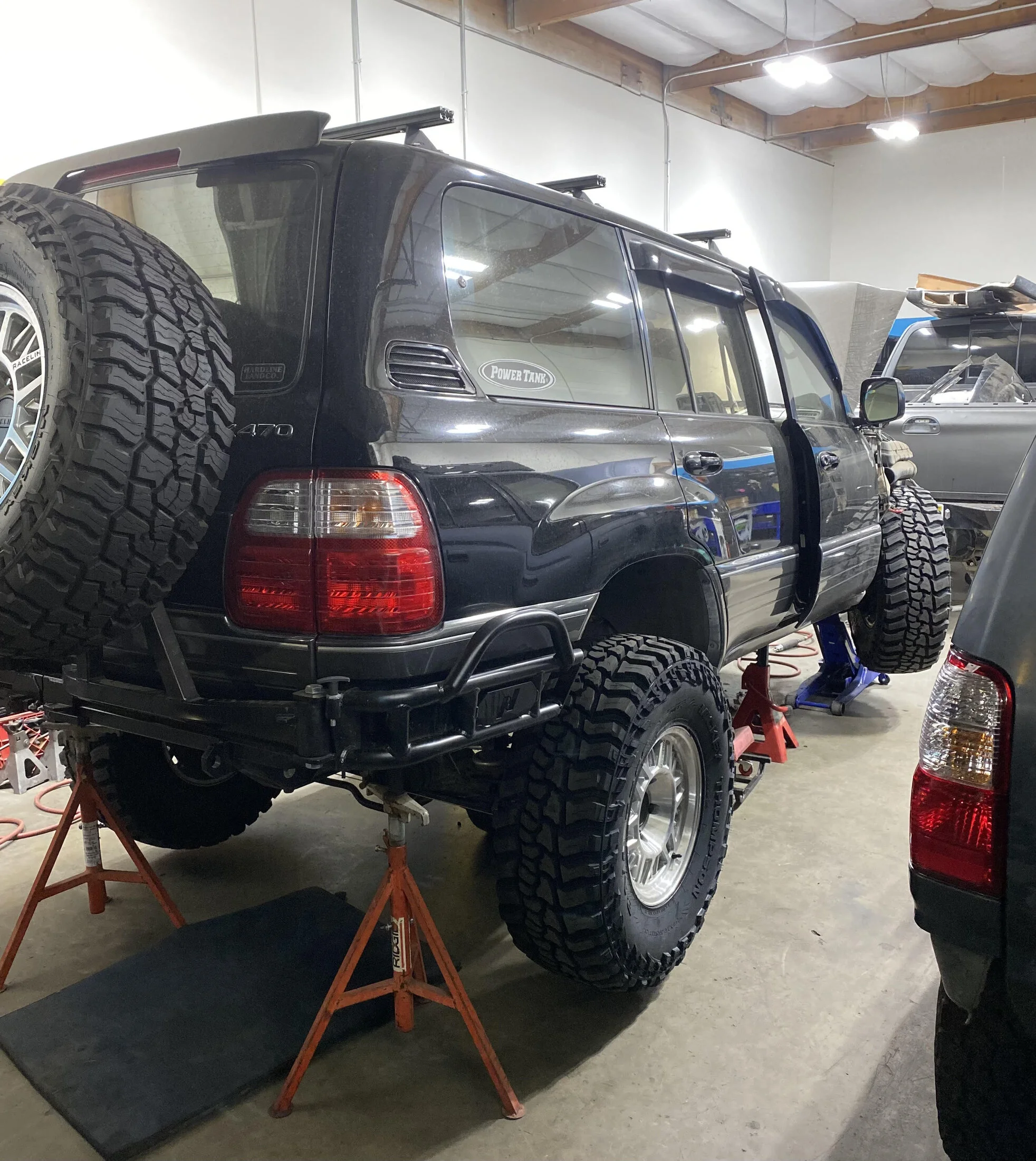

Finally got my rebuilt door lock actuator in and installed to discover they'd put the wrong rod for the lock actuator on, so I pulled the unit, swapped on my old rod and got everything reinstalled. Way more of a pain than it should have been, but it's done!

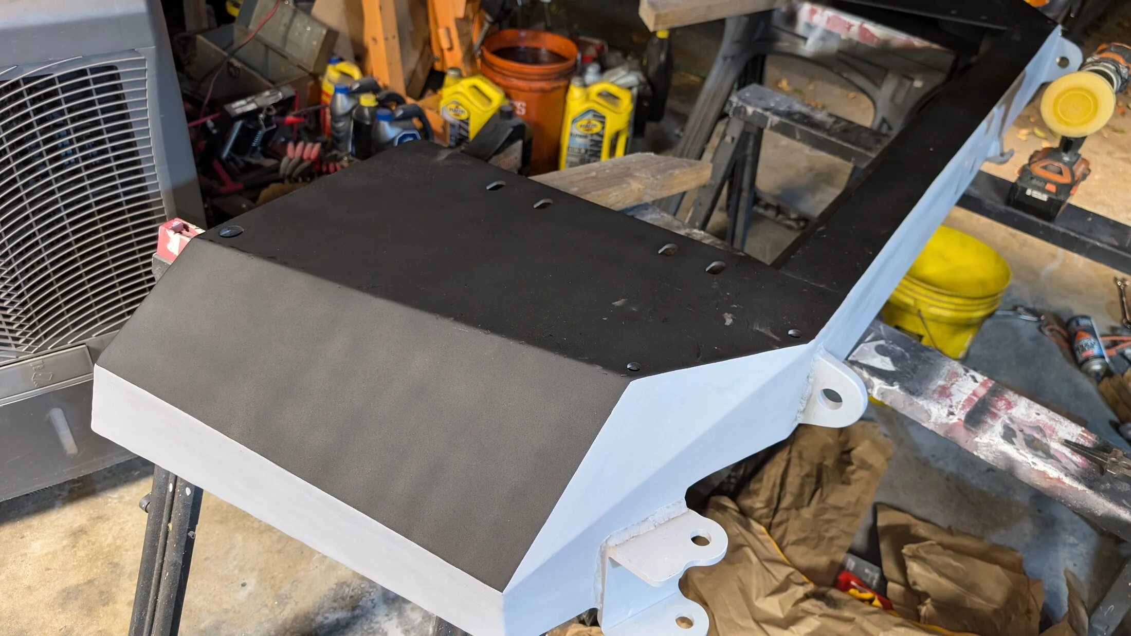

Also this week I got my coastal offroad rear bumper primed and sanded, and added some paintable rubberized undercoating on the bottom side and the surfaces that get stuff from the rear tire kicked up. Hopefully the grey color match paint I ordered shows up soon so I can get it sprayed.
Do you have a part number I couldn't find them on Toyota partsca or rock auto. Thanks
You also need to get the brackets for them

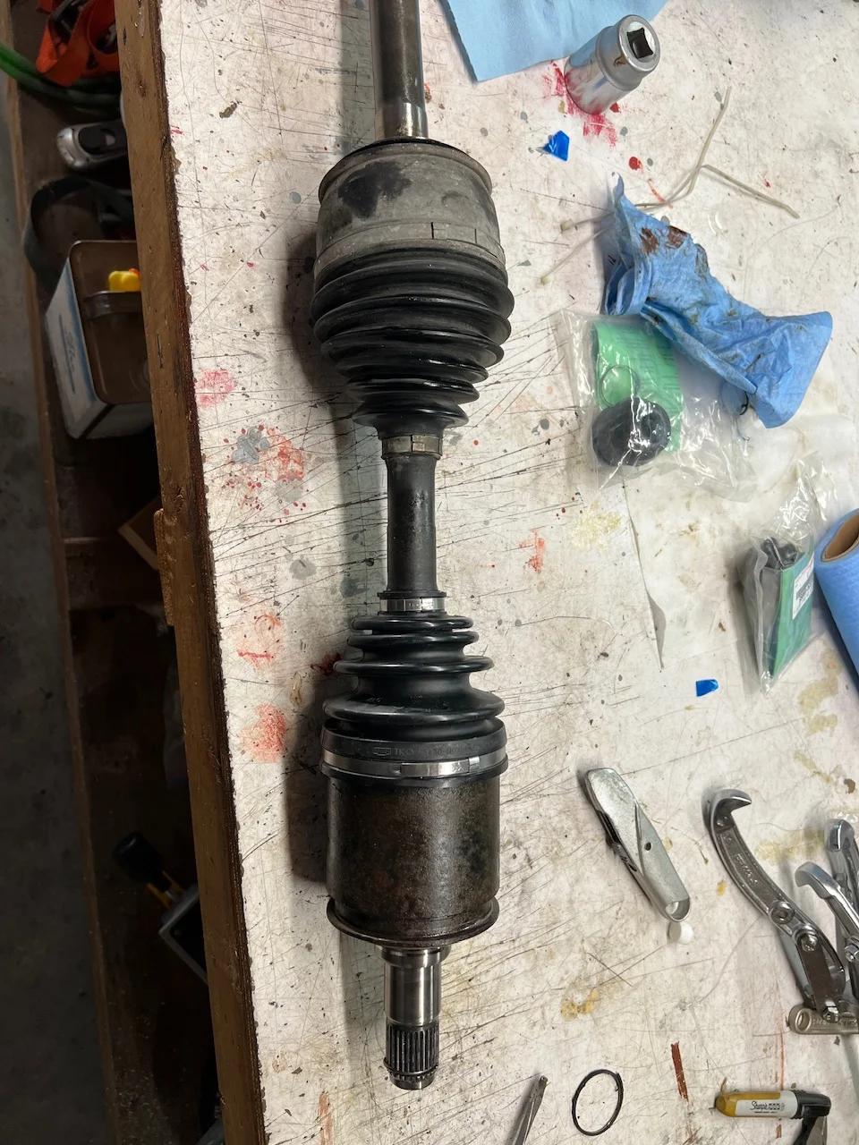

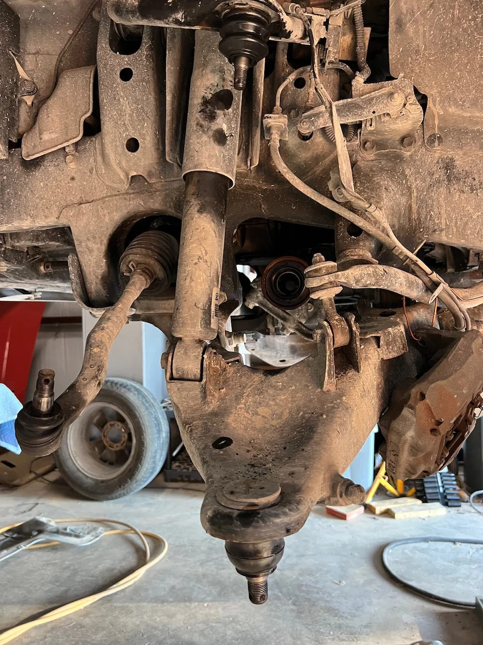

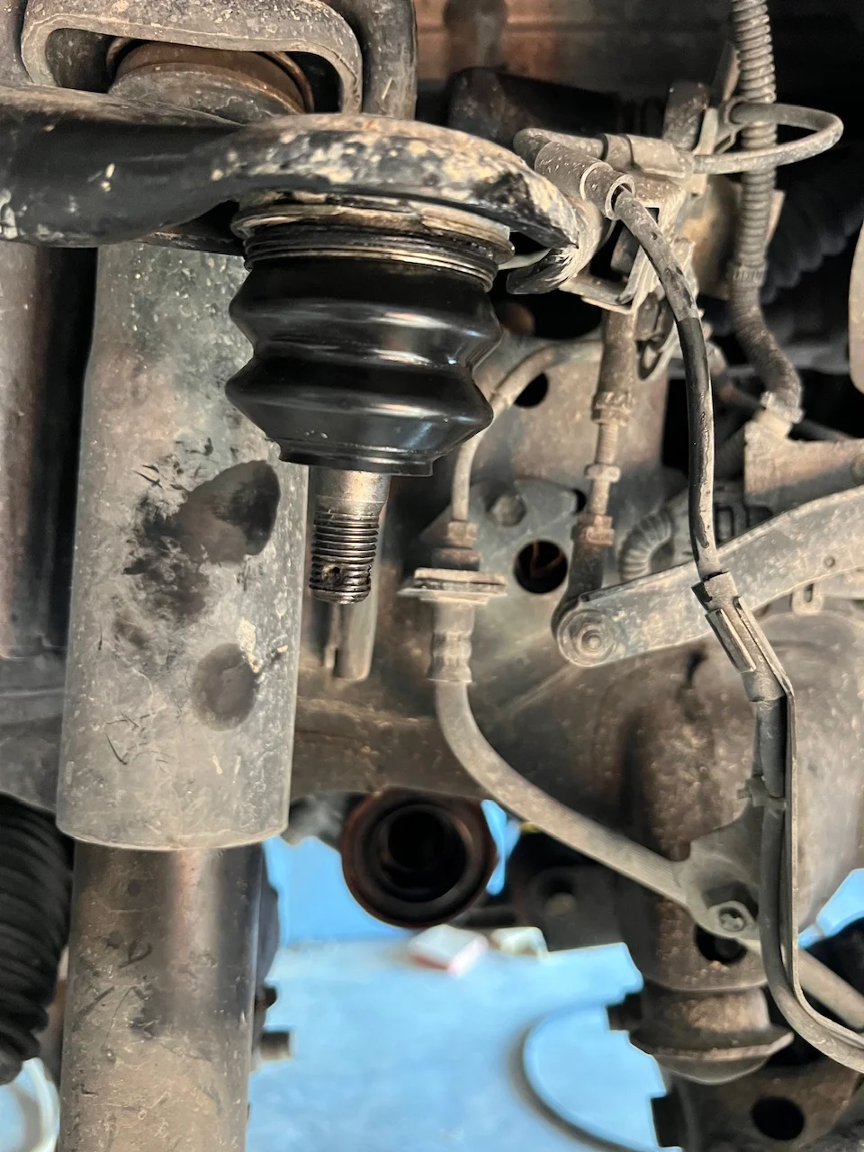

Rebooted the inner cv boots (original boots with deep cracks ready to let go) and new boots and grease for the ball joints. Started on the timing belt and found my radiator was leaking at the upper seam, so ordered a new Denso.

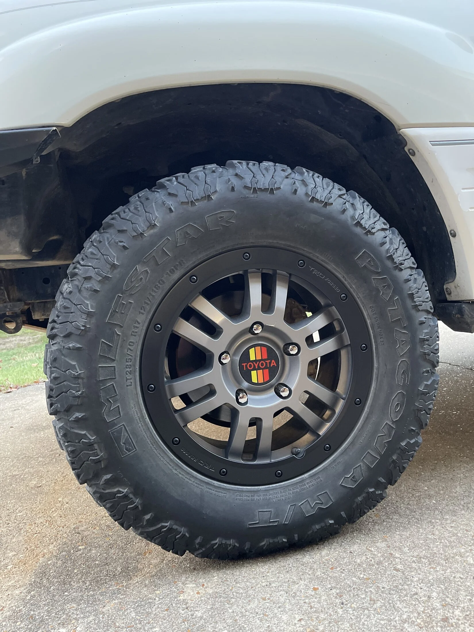

Is that what you’ve ordered? I just put bigger tires and my speedometer is off. Looking at what options I have to bring it back to spec.

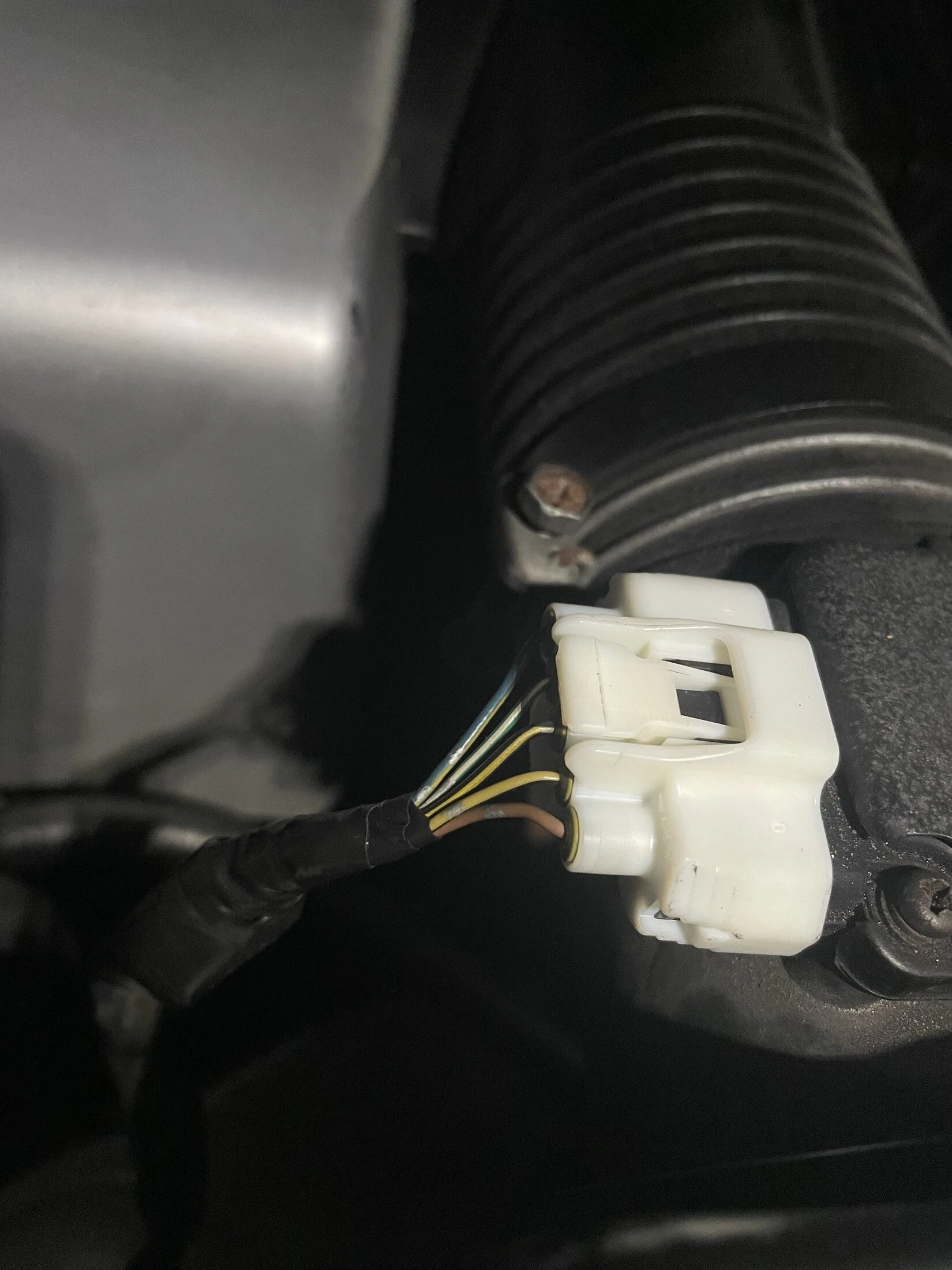

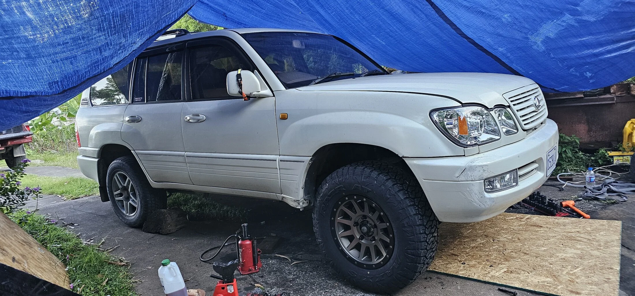

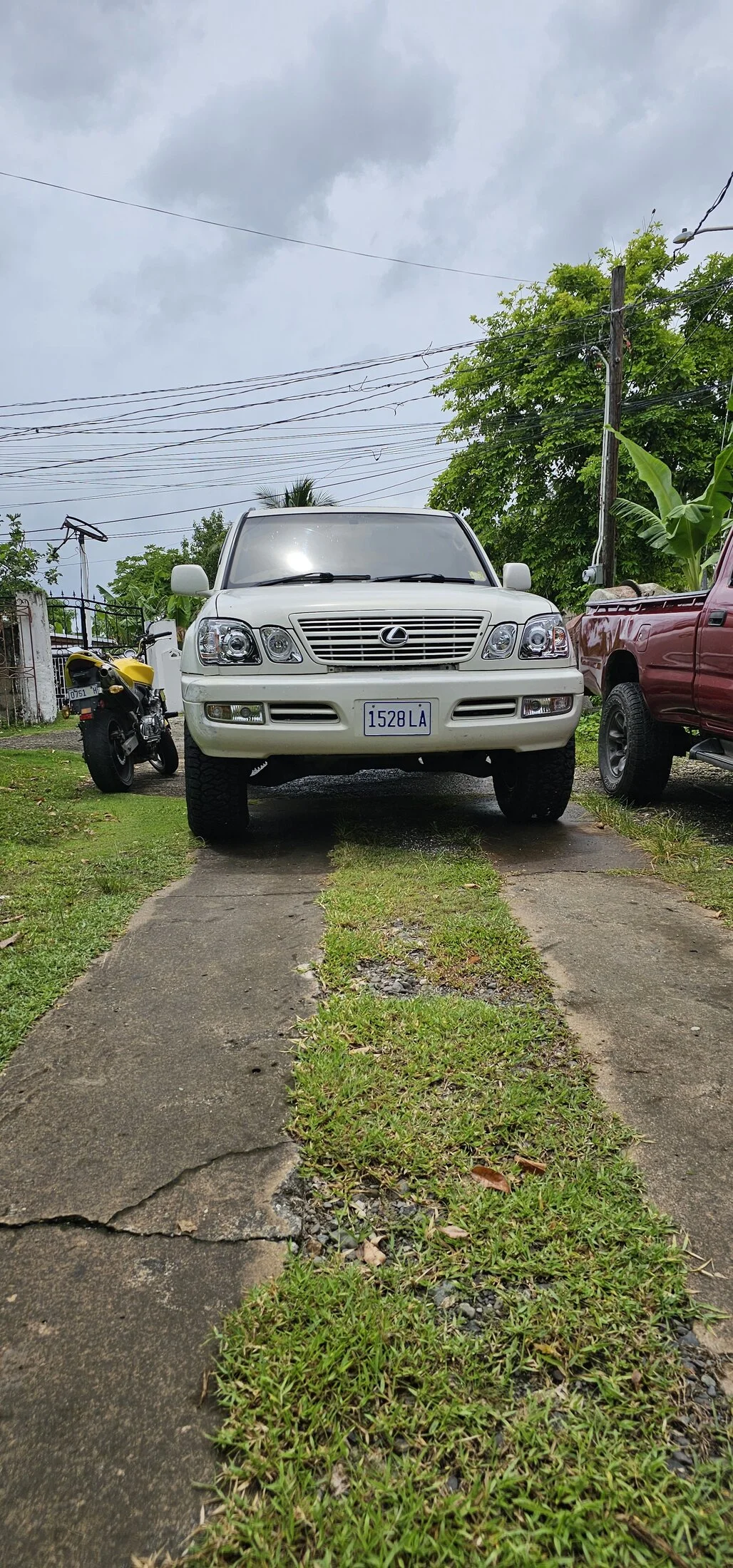

A couple little things today..
New MAF sensor plug housing, mine was cracked since I got it 5-6 yrs ago, never gave me issues but it bother me:
New air filter, old one had several years of dust in it, in FL they last long so didn’t rush it.
New power steering reservoir from a GTO, and Redline D4 atf.. my new favorite!!
Smooooth..
Yep. Yellow Box is good, but Lutz looks like a cleaner design, has had a lot of approval here on 'mud, and based on posts, is a bit more refined. I'll update here after install.
