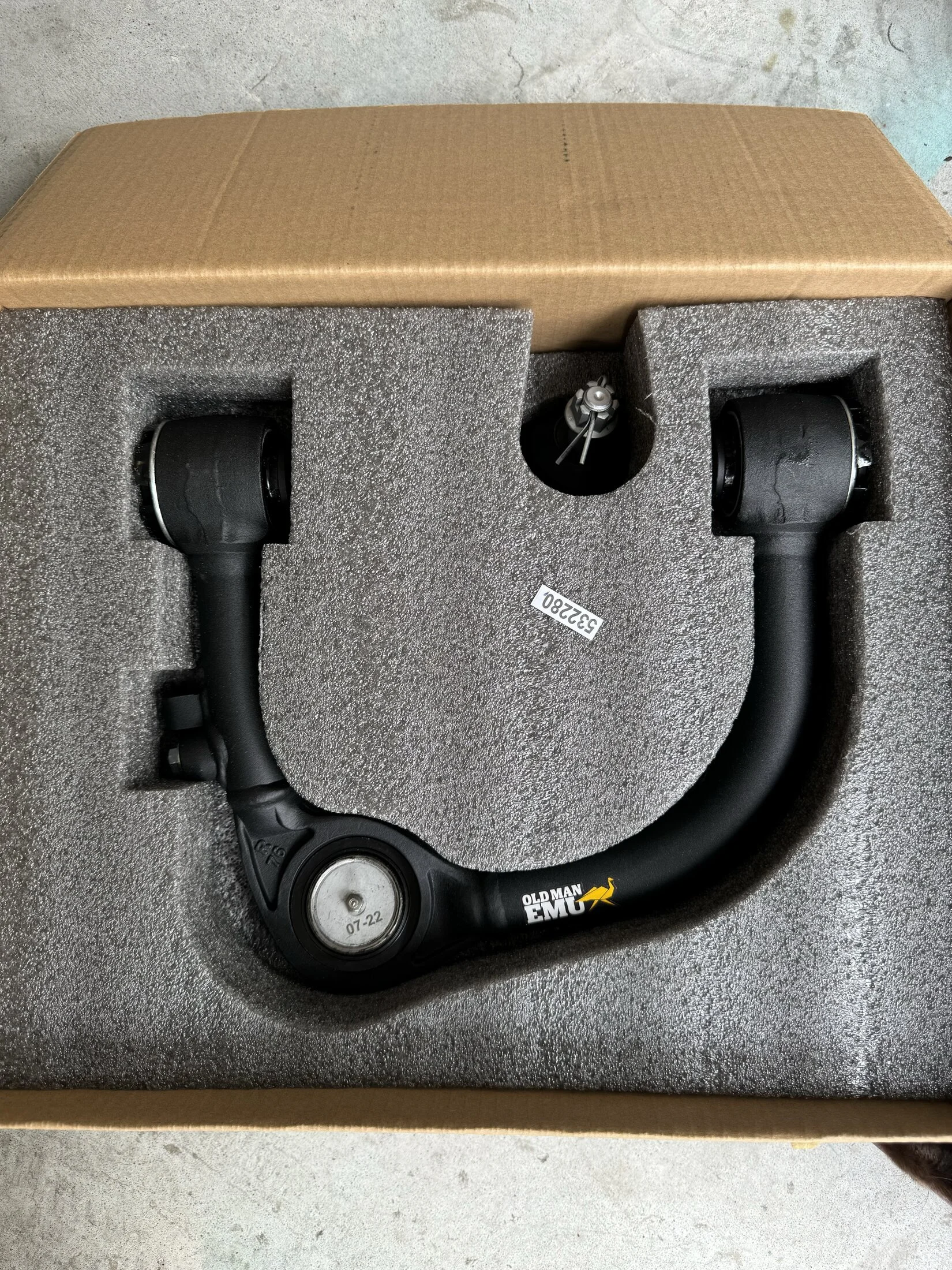

New UCA installed last weekend and alignment. Drives much better after new rack bushings/UCA.
Valve cover gaskets up next.

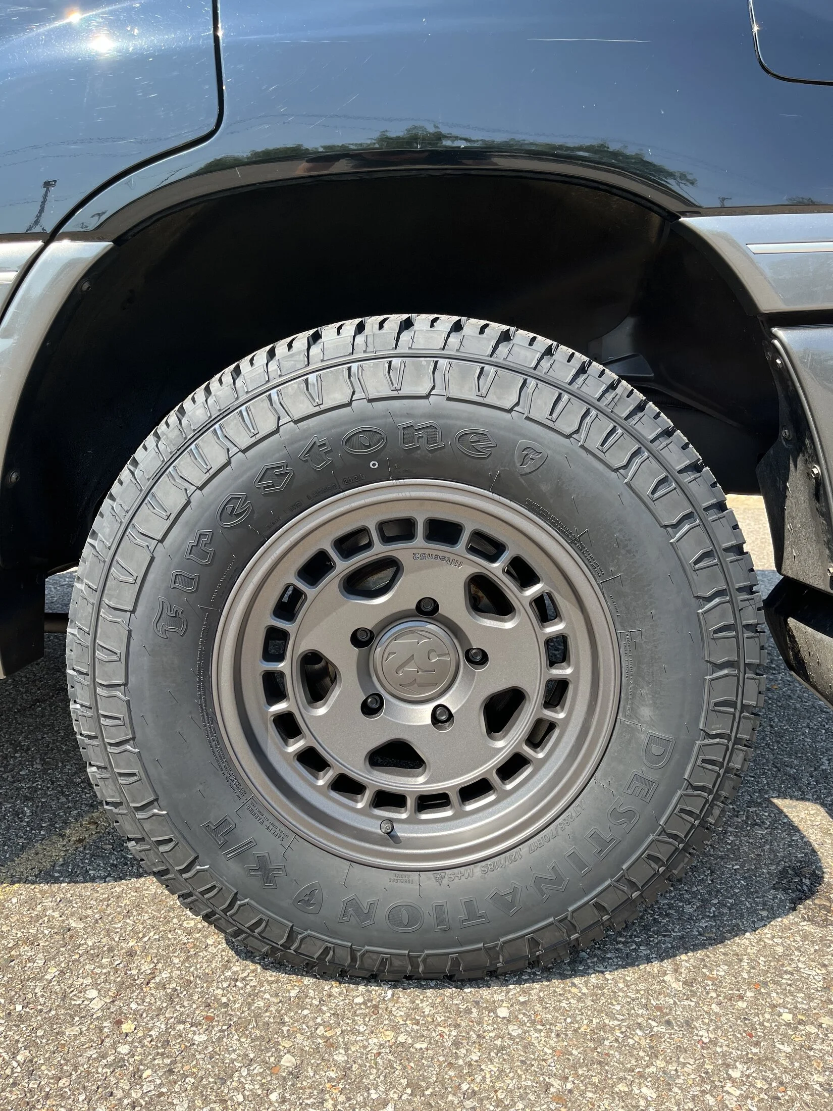

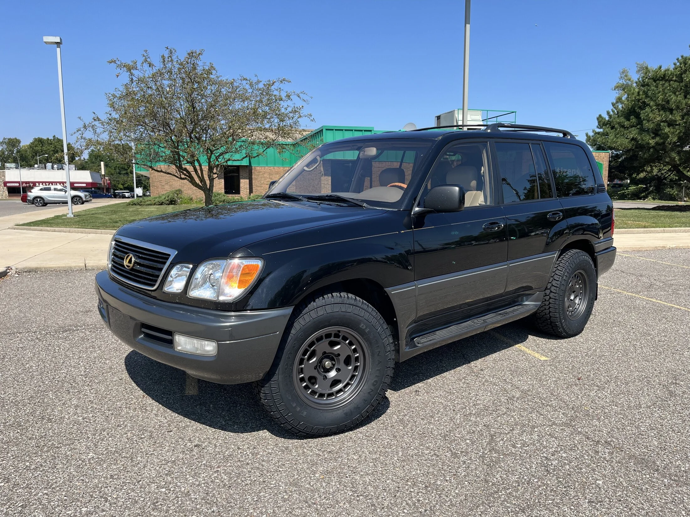

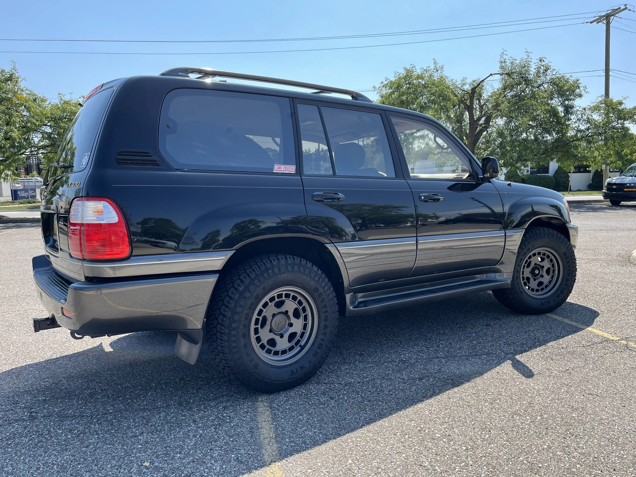

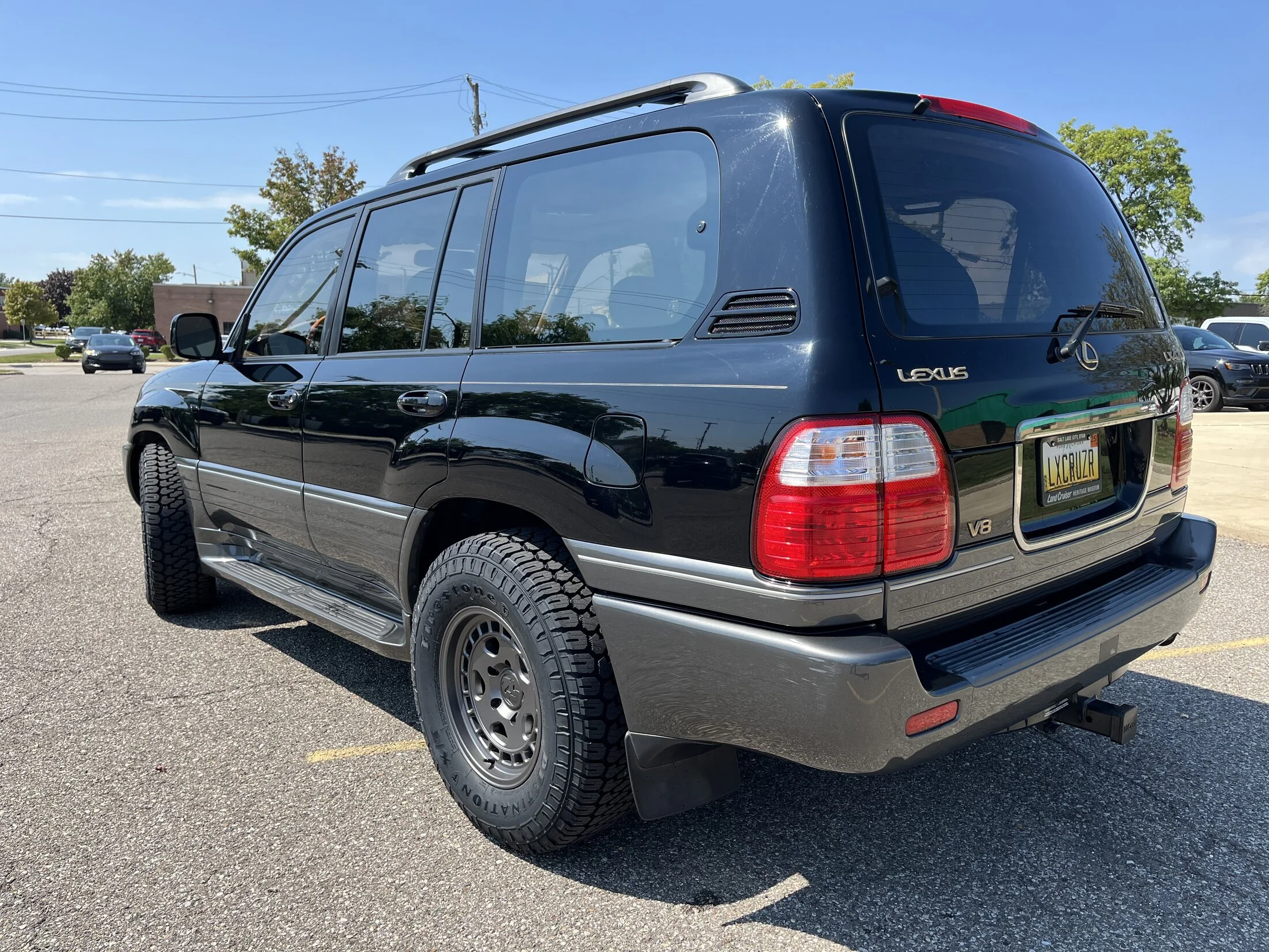

New shoes for my daily:
Fifteen52 Turbomac HD Classics in carbon grey (matches the two-tone lower trim pretty well), 17x8.5in with 0 offset.
Tires are Firestone Destination X/Ts in 285/70 (about a 32.8” diameter).
Next up is an AHC fluid change, pressure check, and ride height sensor lift. All stock otherwise (besides a muffler delete), just hit 302k miles.

I drove a rental Jeep with Firestone’s on and they were just awful with only 25k miles. I hope you have a better experience.
A buddy of mine had them on his V8 4runner and loved them, and I’ve driven on some KO2s and Goodyear wranglers that kinda sucked. So far these are quiet and comfortable, but I’ll post an update once I really live with them. Wildpeaks would’ve been my other choice

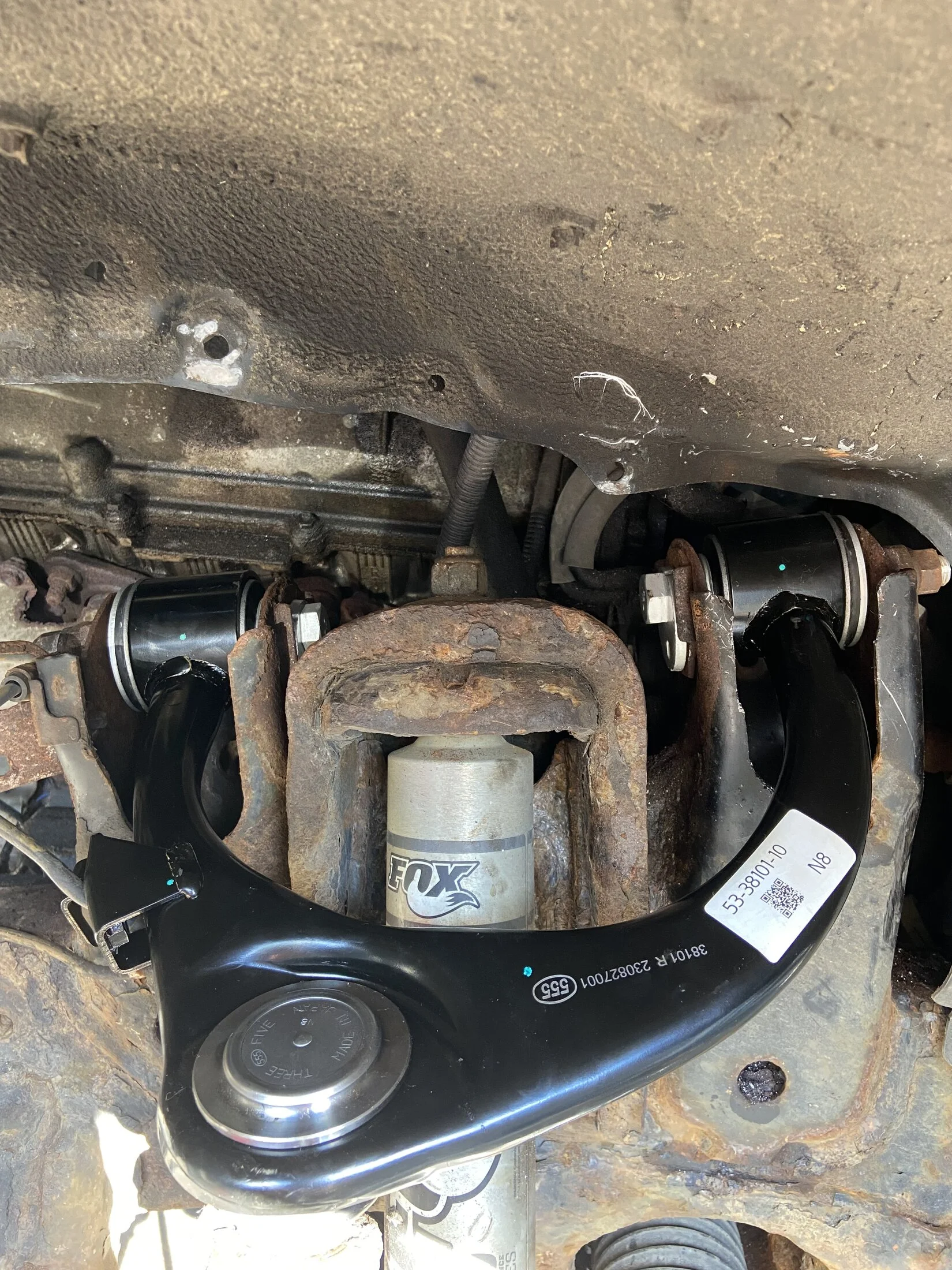

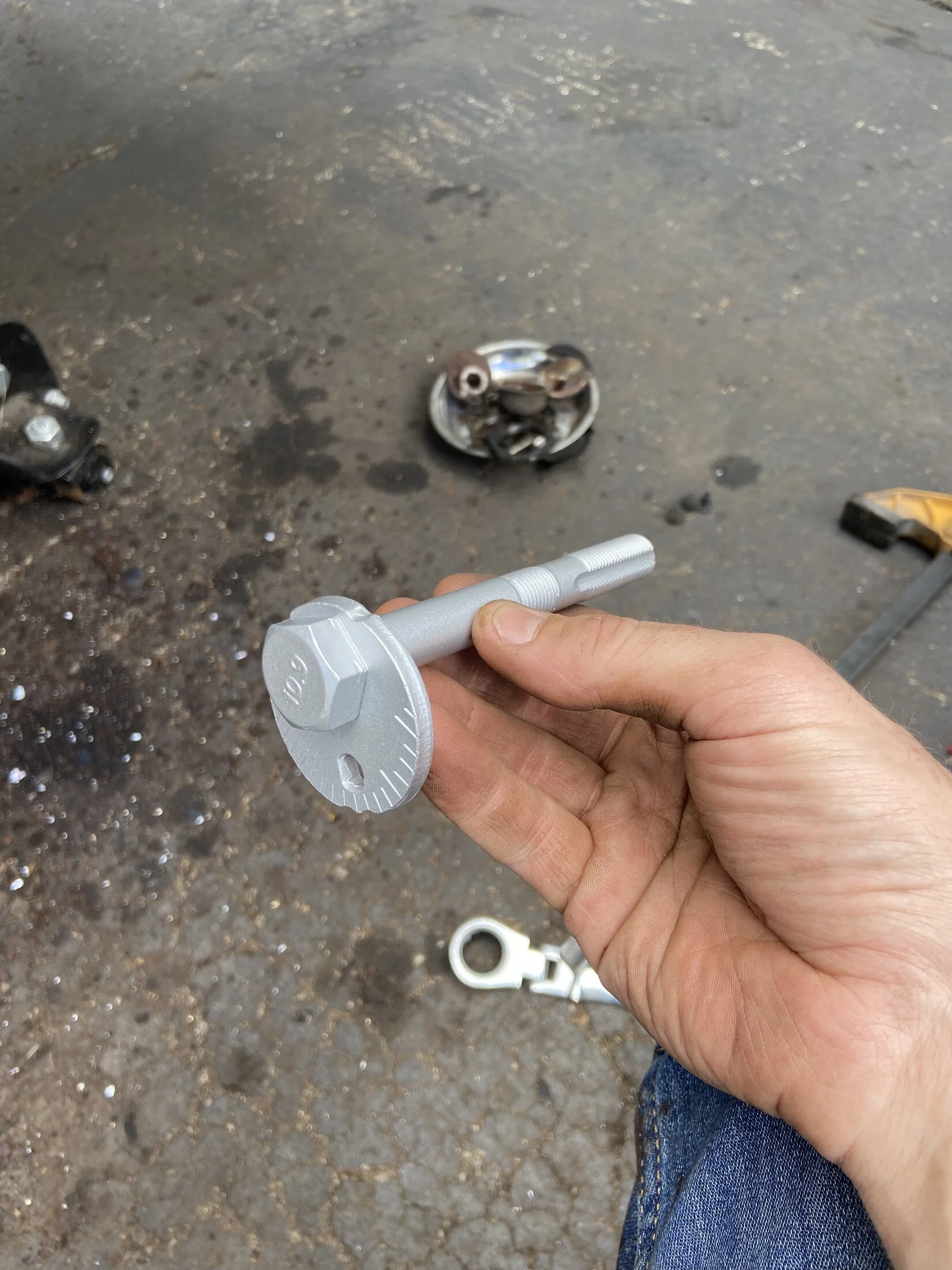

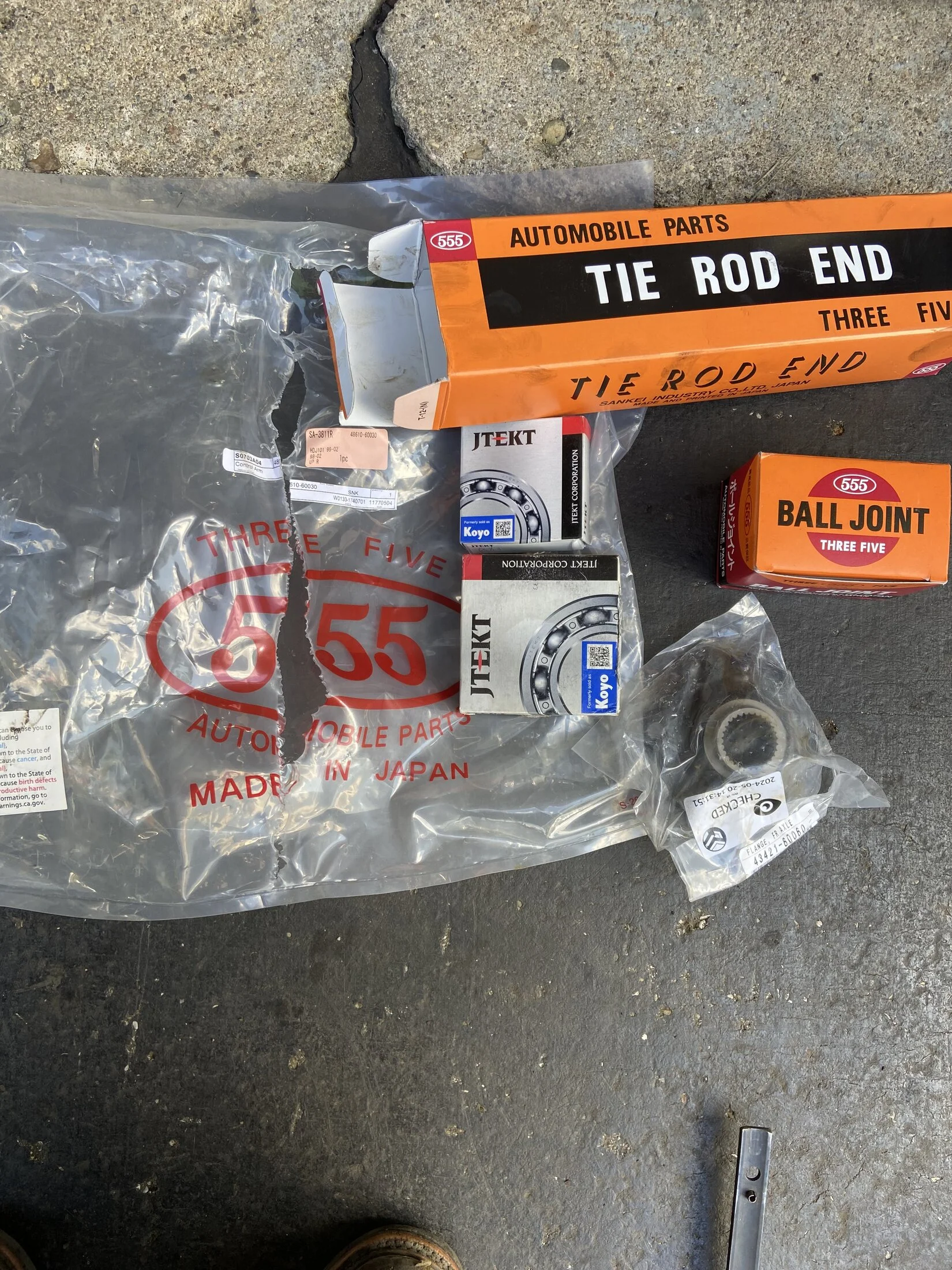

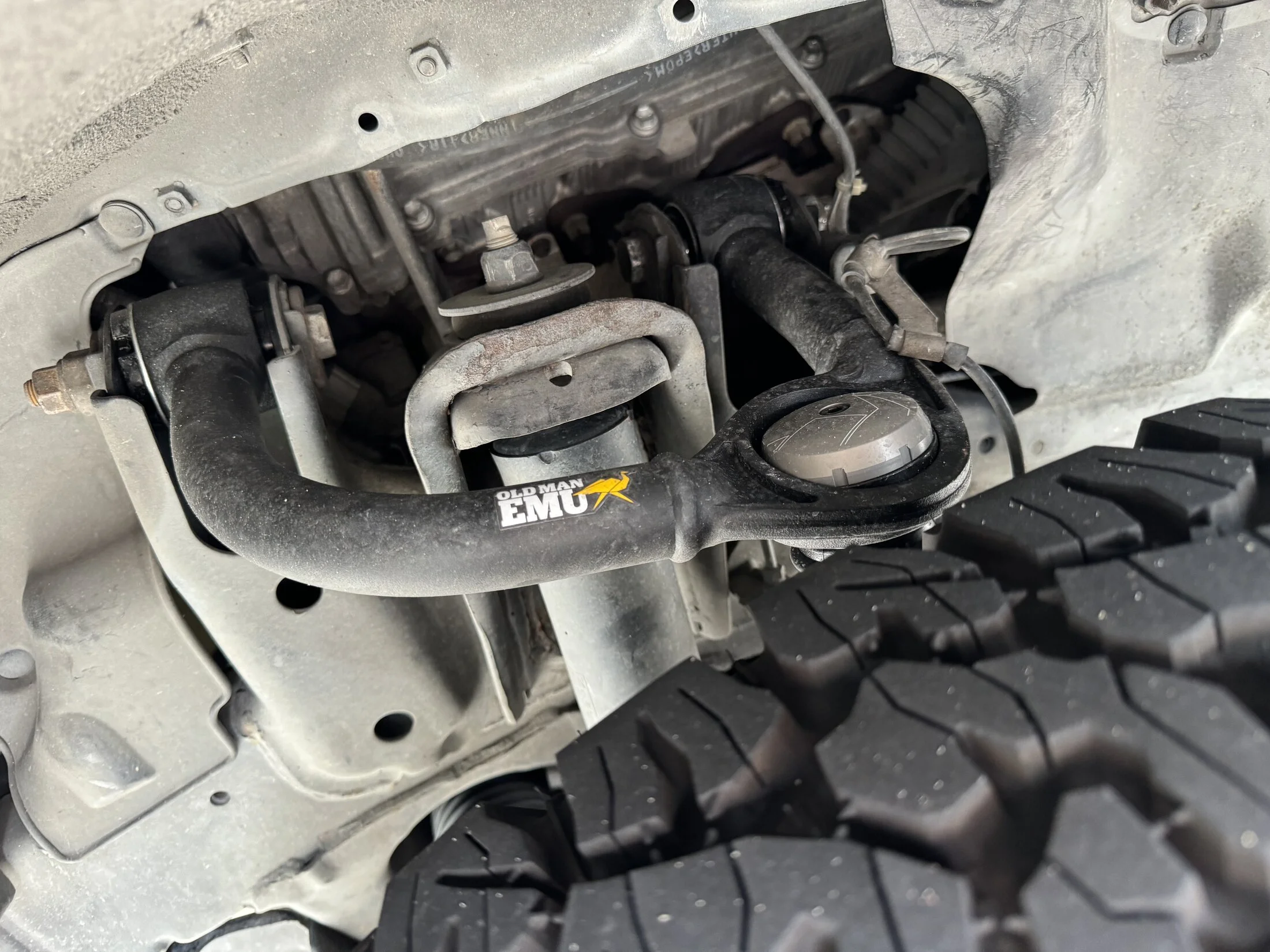

Trusty ole crusty Blue got a 300k front end refresh. New 555 UCA, Rebuilt OE UCA w/ 555, new 555 TREs, new 555 LBJs, new Febest cam bolts, new OE drive flanges, new Koyo bearings, and new cone washers, snap rings, and hub bits. I’ve been squirreling away parts for a few months in preparation and planning around my 6 month old daughter’s super fun sleep schedule. Anyway, watch your eyes, she’s flaky.

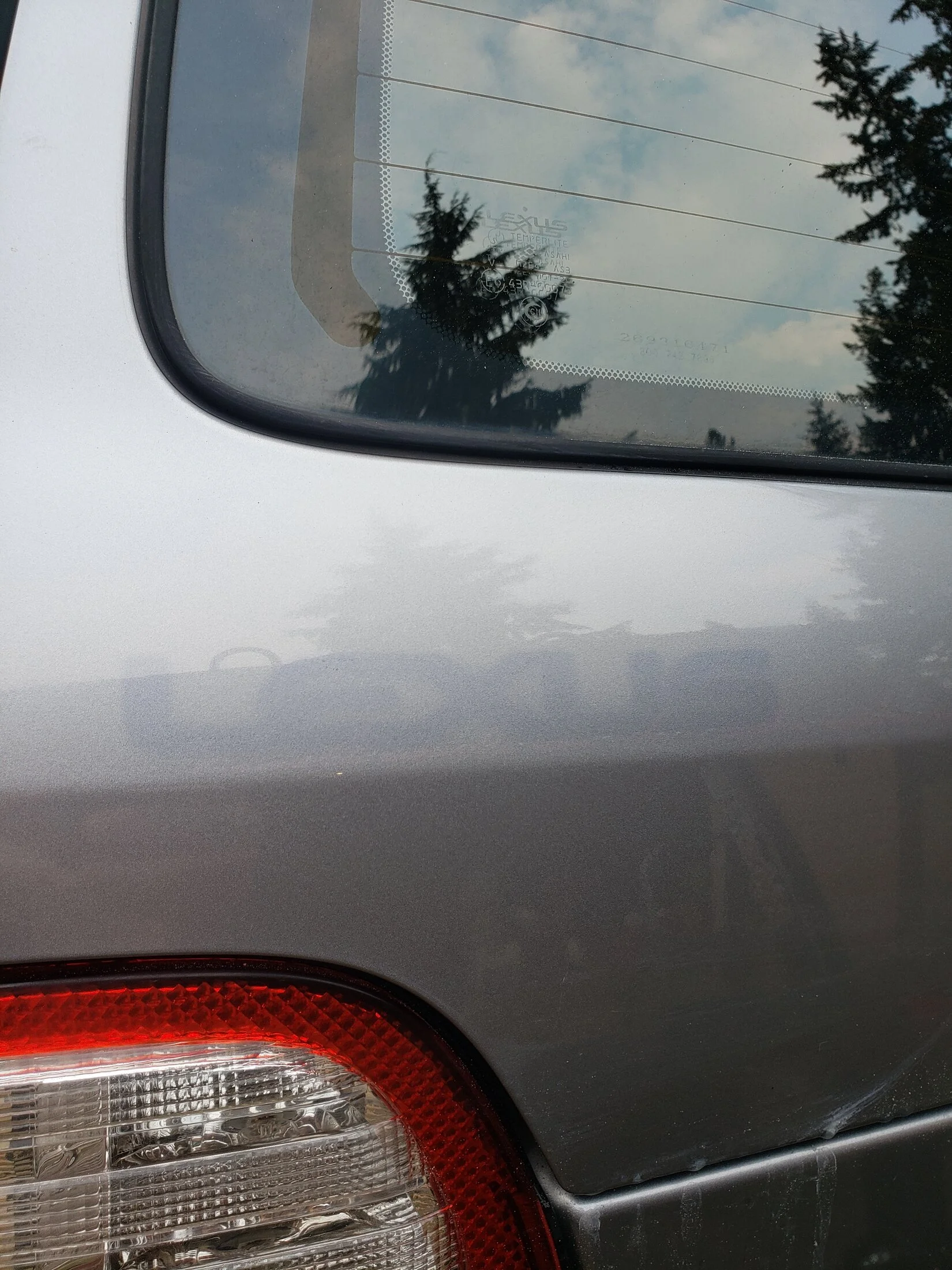

Finally got around to debadging the rear of my LX..... and dammit, looks like the Blue Vapor Metallic is just too far gone.
This is after wet sanding with 2000, 3000 and compound and polish. The LX470 badge side is even worse, some chipped clear coat. Guess they're going back on lol
I like the “shadow” ;)

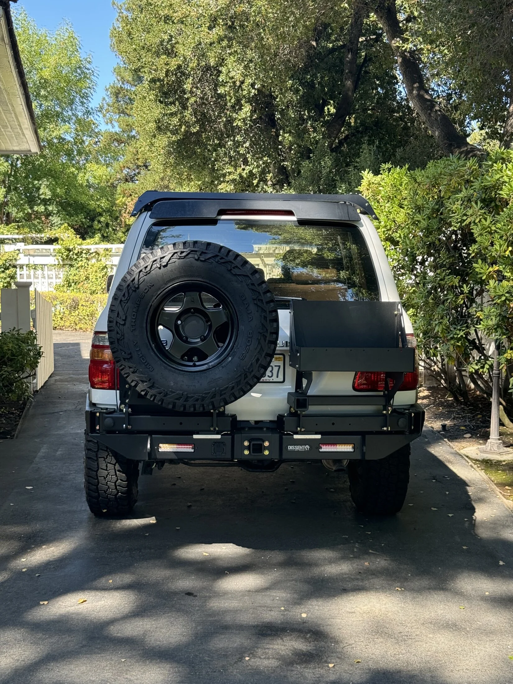

Guess I now need to move my plate after installing the spare on my Dissent 😂

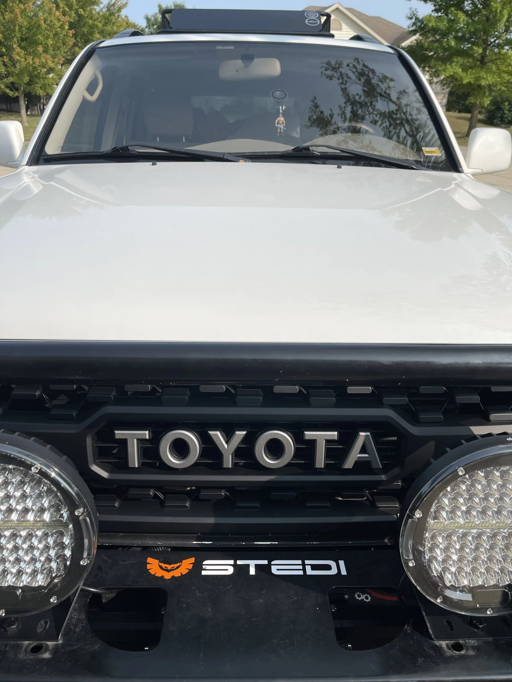

*Added a TOYOTA grille from Trail Runner Customs. I moved the 9 inch lights out as far as I could so I can see more of the grille

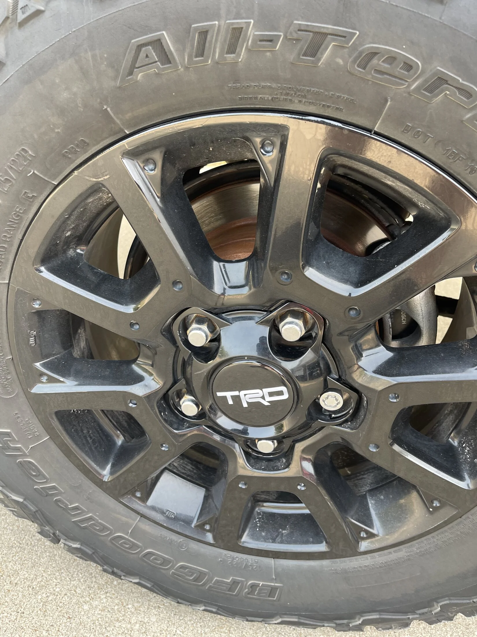

*Had custom silver TRD Center cap stickers made.

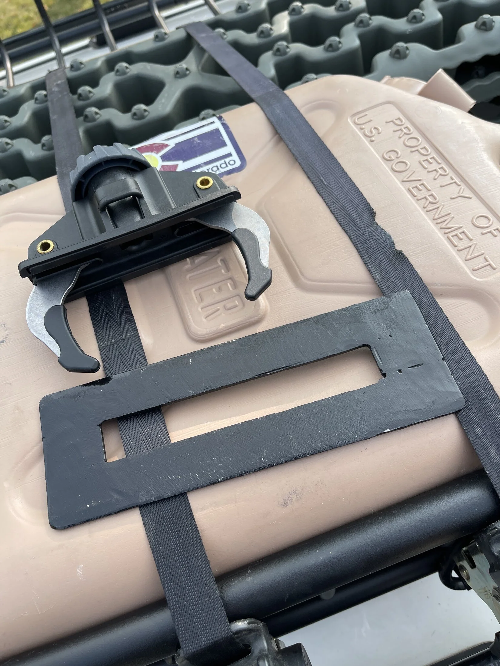

*I'm a roof basket fan for our trips. We leave the Cruiser in a couple of different airport storage units out towards Moab / CO and fly out for trips. Most of them have 7-foot tall doors and I got sick of taking the roof basket on and off with the annoying little hat brackets and 8 threaded knobs. Took 15 minutes. I tried Thule quick clamps designed for their cargo boxes and they work perfectly. Welded up some platforms for them to sit on to mimic how they are used on Thule cargo boxes so they distribute the weight better and this thing is rock solid up there on the factory crossbars. Takes under 90-seconds now and I leave the gear attached to the basket when I remove it. Front locker going on in 2 weeks. Have a good week!

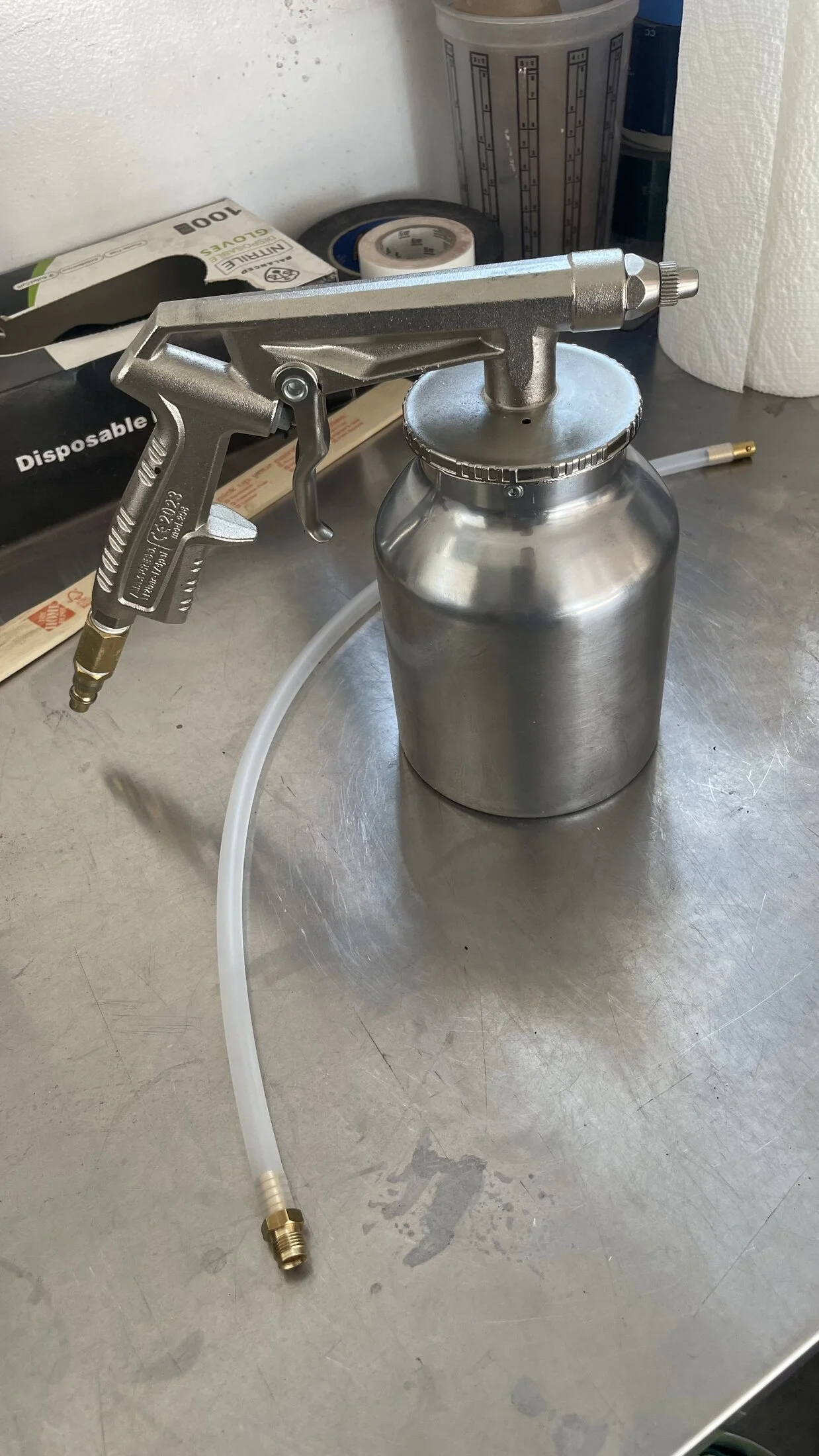

That little bitty blue spec, that is the pillar pod. Second time using it is every bit as messy as the first time. Even with taking necessary precautions, I still walked away looking like a coal miner. However, the result is acceptable, even after only 1 coat of this stuff. 98% is covered, the rest looks like Ehren from Terror Taxi in Jackass, patches are quite visible due to me not applying enough material.

Seeing STEDI being deployed always brings a smile to my face.
