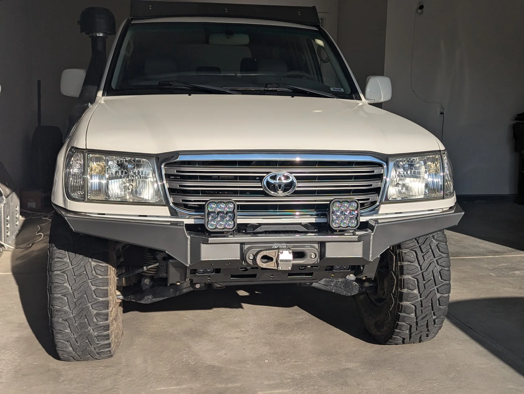

Not today but got few things done over the last couple of months…
Dissent Extreme Clearance Front Bumper. Sold the badlands and saving for the come up winch.
Baja Designs LP6 lights.
Brand new OEM lights retrofitted with micro D2S projectors and LED high beam. Indicators wired into OEM clear corner lights.
Metal Tech Sliders.
BBS TRD PRO wheels with 295/70R18 Toyo RT Trail tires.
AHC lift.
Aftermarket grill is starting to grow on me but if anyone has an OEM grill that they would like to get rid of, let me know.
Seat Jackers.
Cabin air filter.
Engine air filter.
Oil change with M1 and OEM filter.
OEM Japanese rear wiper.

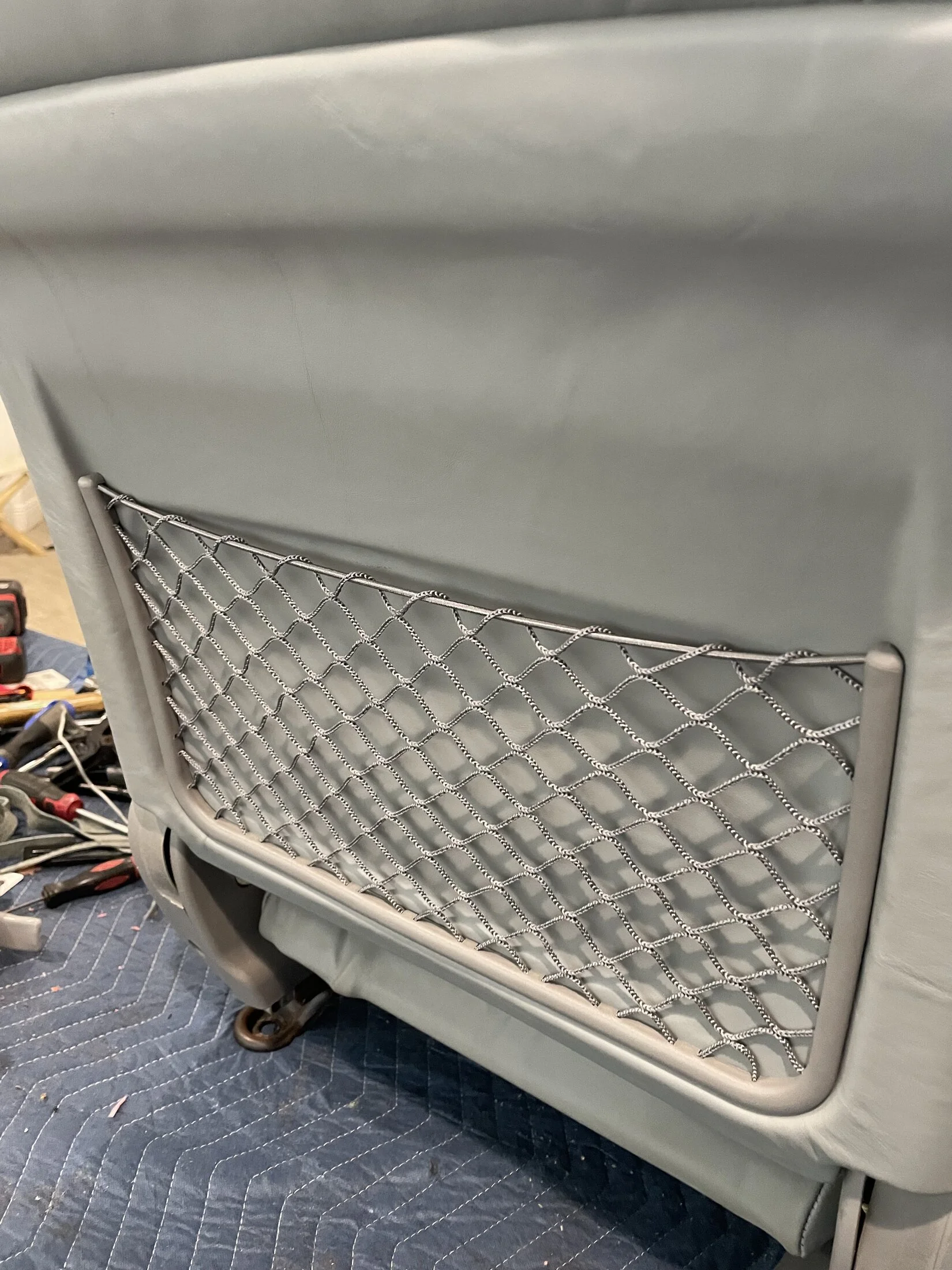

Done with all seats!
Quite a job.
The new nets are the finish touch.
Metal Tech Sliders.
AHC lift.
Seat Jackers.
Cabin air filter.
Engine air filter.
Oooo! Did you do the retrofitting of those headlights yourself?

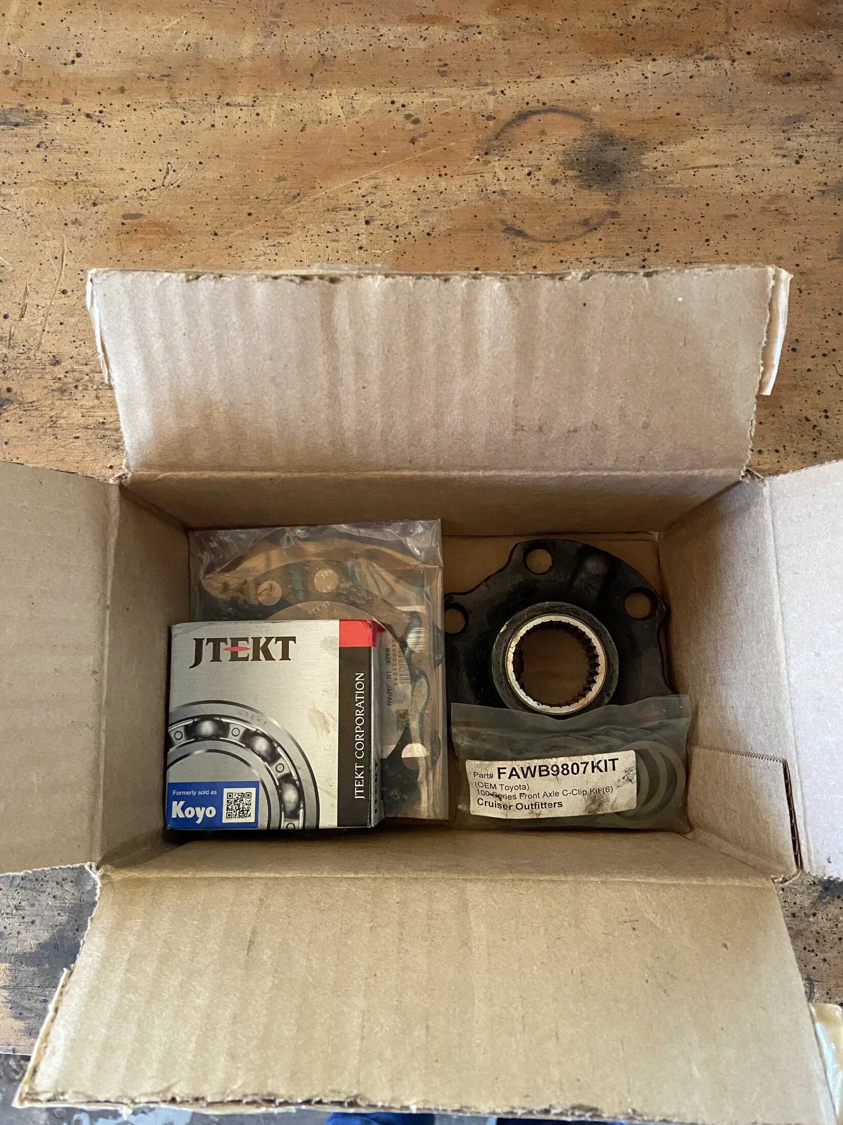

Made a roadside kit to fit in one of the rear cargo compartments. I pulled some like new Timkens out of the hub when I replaced them with Koyo. Those and the drive flange were in great shape still. So I threw the flange, extra gasket, bearings/races, extra cone washers, and CV clip assortment in a small box and stuffed it in back.

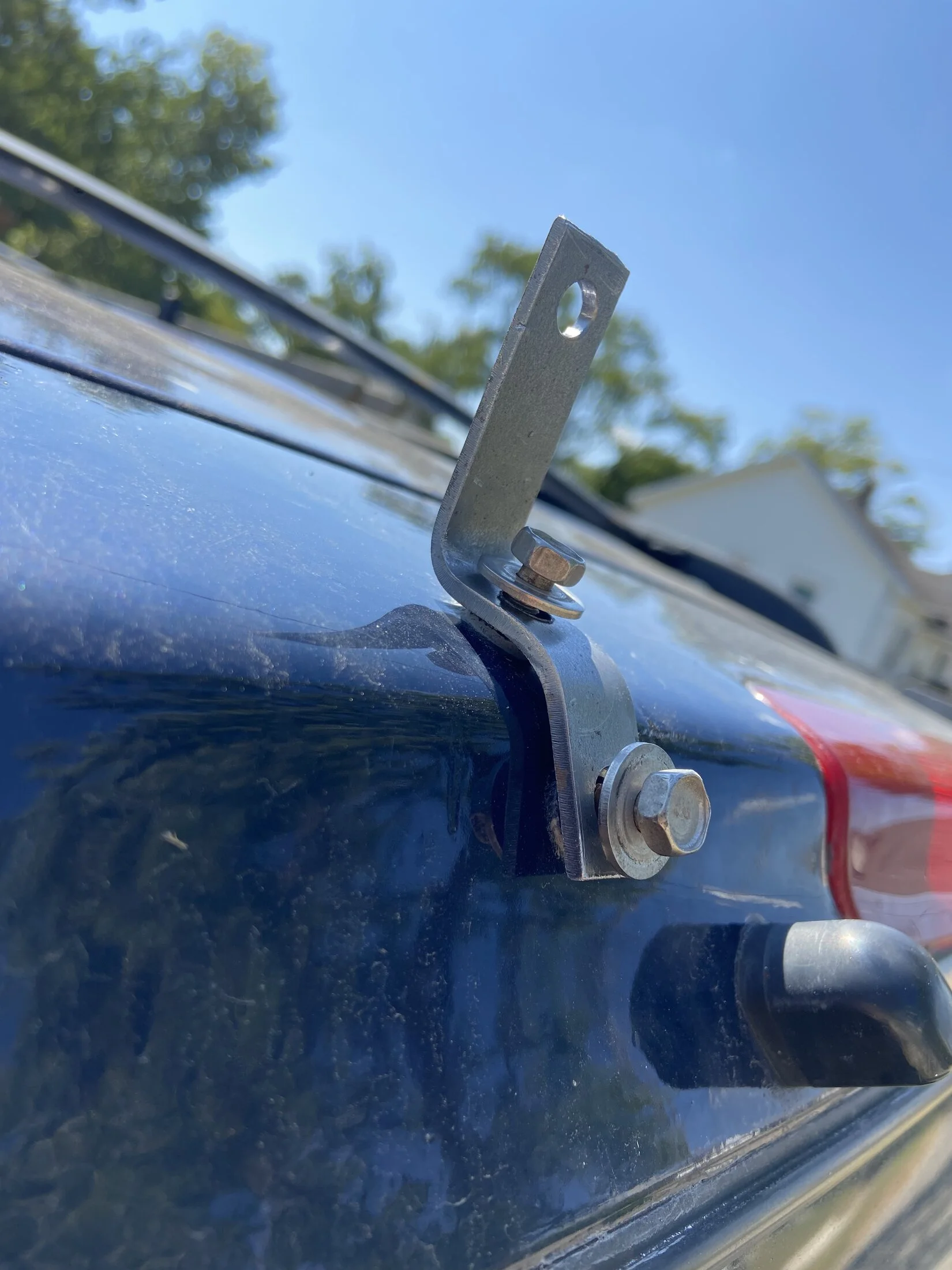

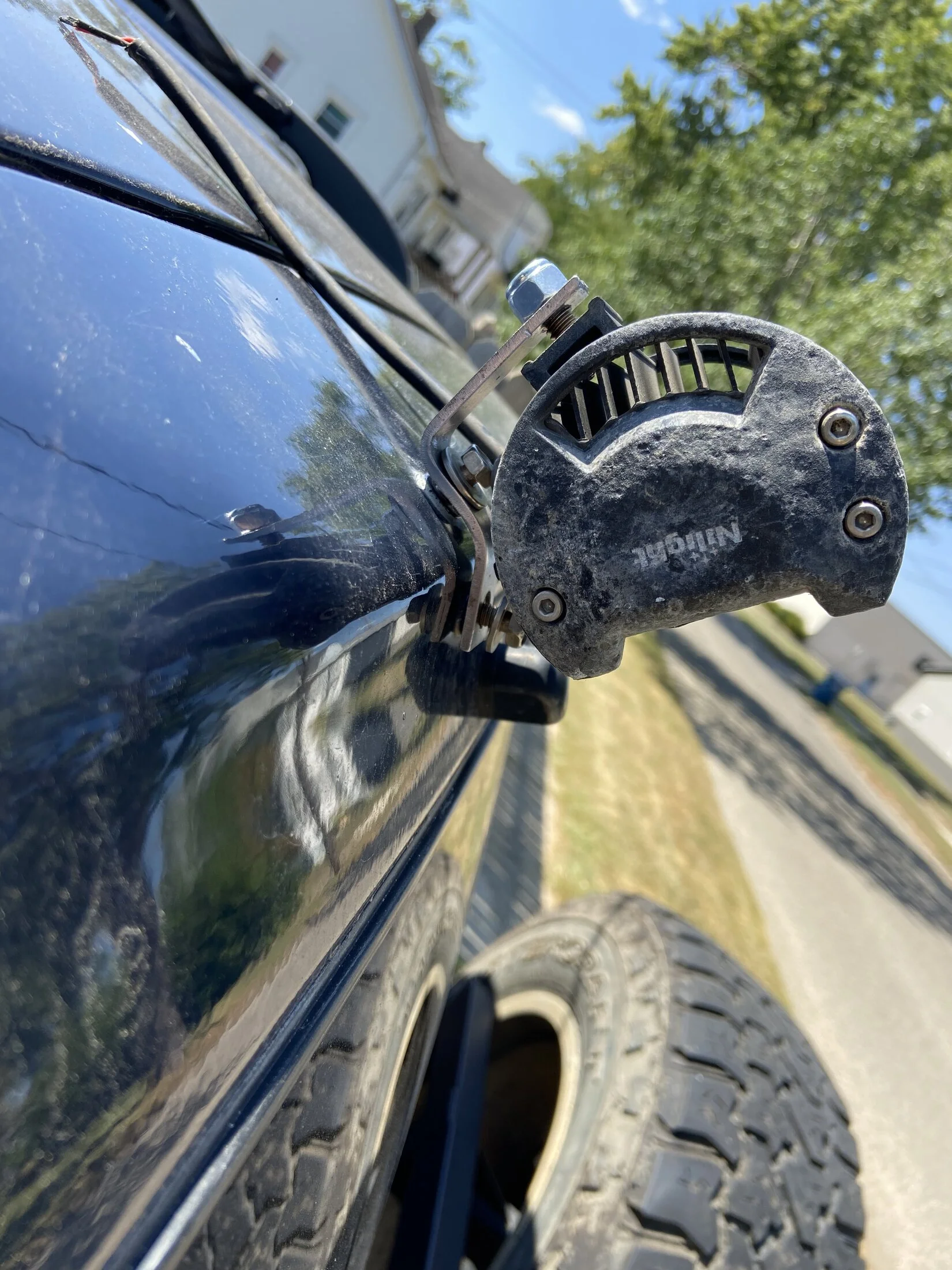

Test fit some homebrew rear pod brackets. Debating on a faring type of mount with a bar across the center and somewhat enclosed.

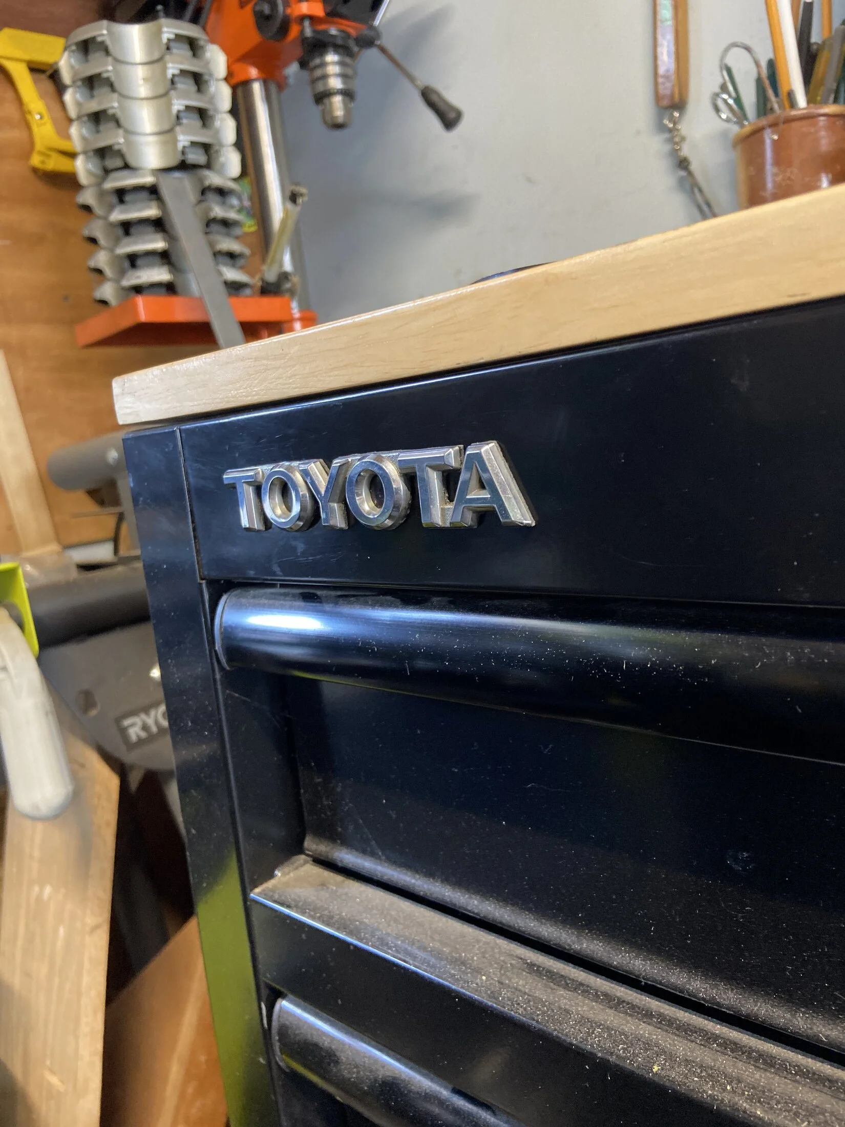

Also took an old upper lift gate Toyota badge and VHB’d it to my tool chest.

Would you have the tools and grease to disassemble a spindle/bearings and reinstall? Or is the thought you could get it to a local mechanic?
I carry a socket set everywhere I go along with various other “basic” tools. Outside of the 54mm hub nut, it wouldn’t be so difficult. And honestly, a screw driver, determination, and some time would take care of that if need be. As for grease, I left the bearings grease packed and bagged them into the boxes as such, with that thought in mind. The reality is, it’s highly unlikely I will need them, but if I do - I am prepared. Also prepared if someone else on the trail is in need.
