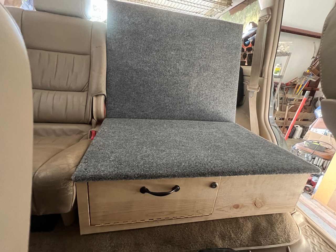

Last “upgrades” on the truck before our trip. We always had just enough room, but my wife decided our dog is now a regular on our camping trips, so I made some room.
I built an attic rack.
And a locking cabinet and cubby for the second row. Altogether it’s lighter than the seat, I get some hidden storage which will free up space, and suitcases will stack much better. I’m adding some anchors so I can strap it all down, as well.
