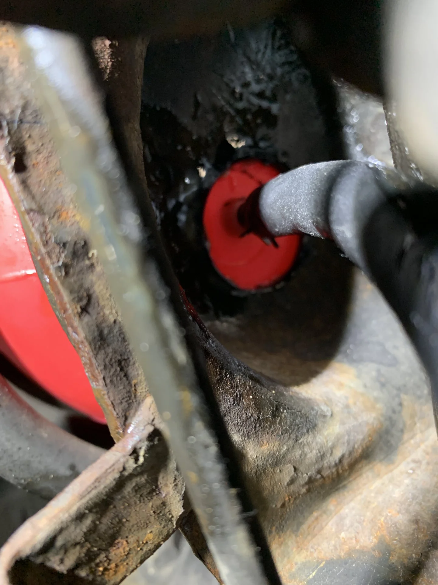

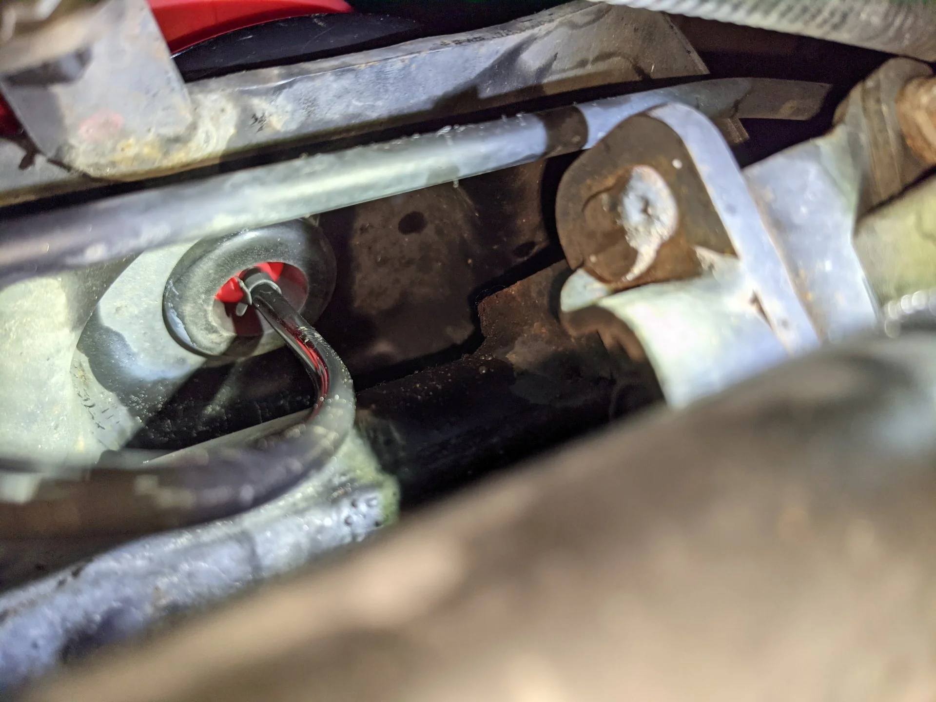

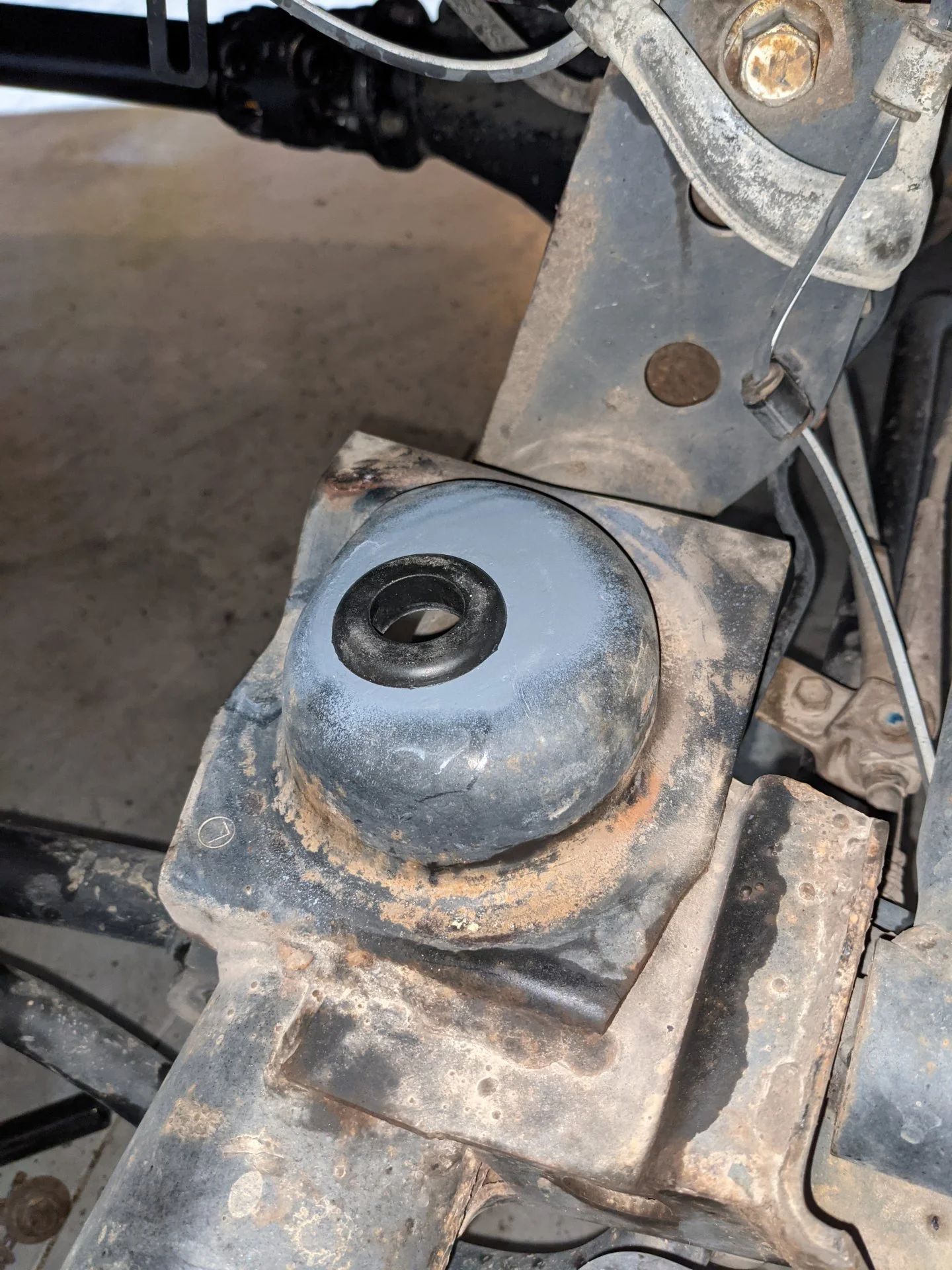

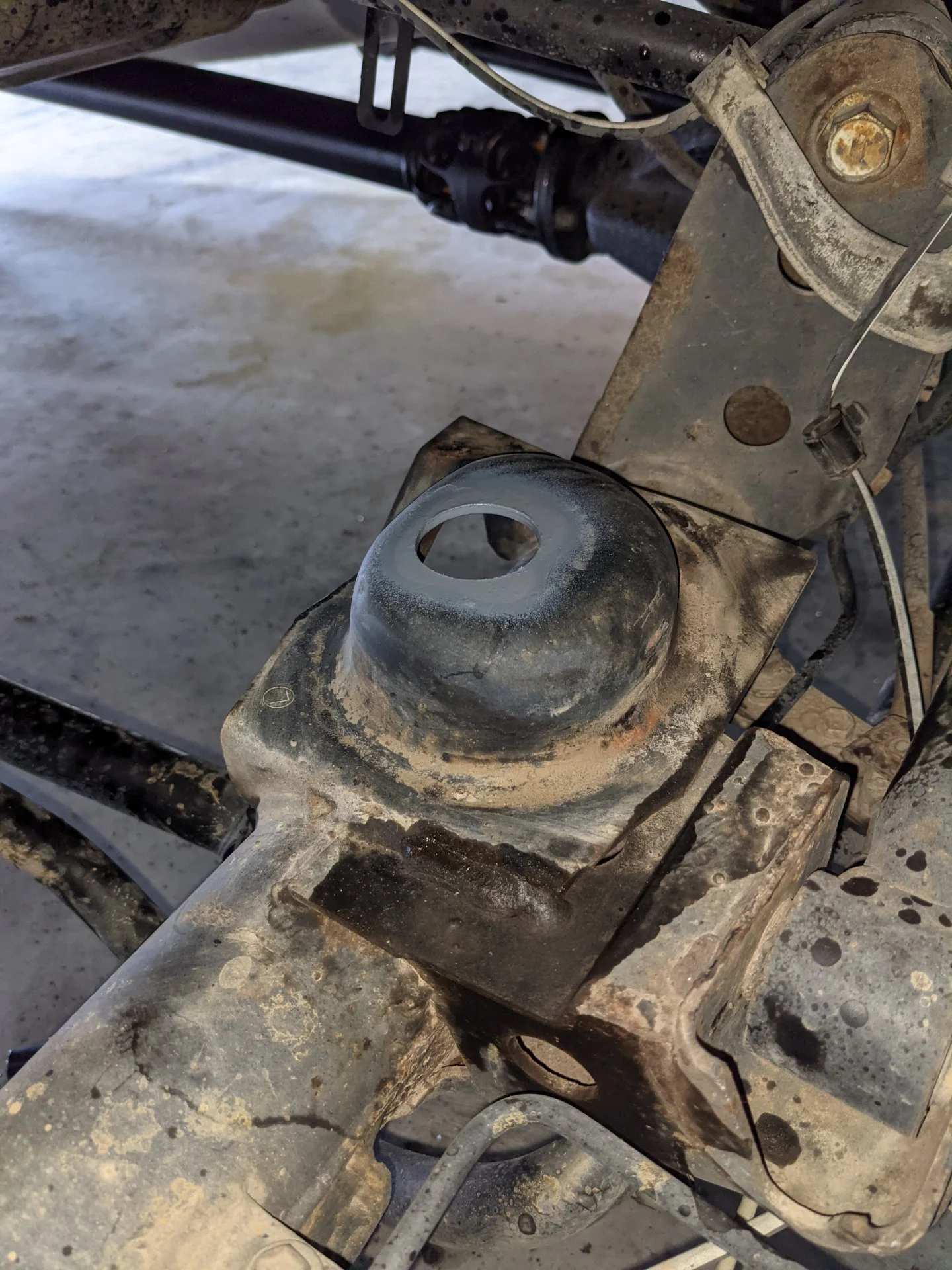

Hey what would you guys recommend...?
Grommet = slightly smaller hole which seems borderline restrictive during suspension articulation..
Or no Grommet = leaves more space but doesn't have the edge protection... Hole without grommet is 1-3/8" and I drilled the existing (off-center) hole
Picture below is with Grommet but the bag is not in its "natural" position... The nipple wants to migrate to the edge of the grommet opening and sort of rub against the side
Please share your recommendations..
Thanks!
I have tried a good bit to make it work without cutting a larger hole....but no dice. I think cutting a larger hole is the answer with or without a grommet.

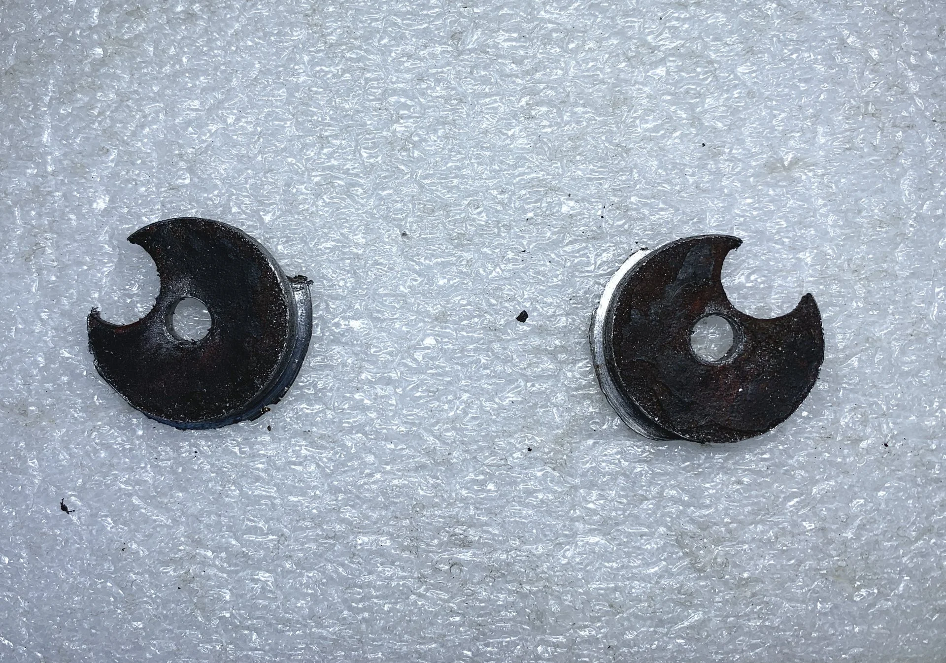

The existing factory hole in the lower spring perch is not centered to the spring. Test fit the airbags and mark center where barb touches perch. I drilled a pilot hole at the mark (about 1/2” from existing hole) and used a 1-1/4” hole saw.
These are the hole plugs cut out. The crescents are the factory holes.

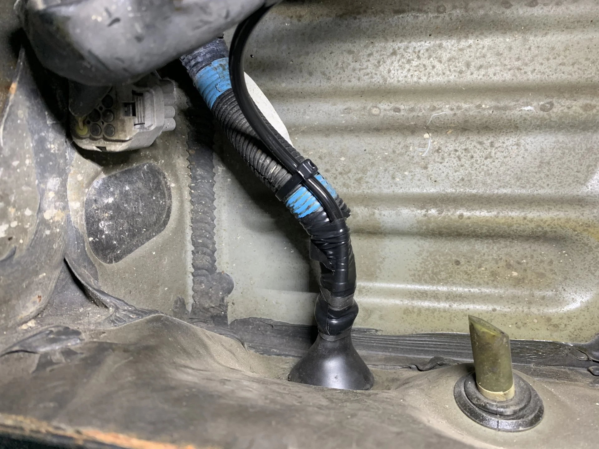

Routed the airline through wire harness grommet on LH quarter panel. Enters cabin under jack storage bracket.

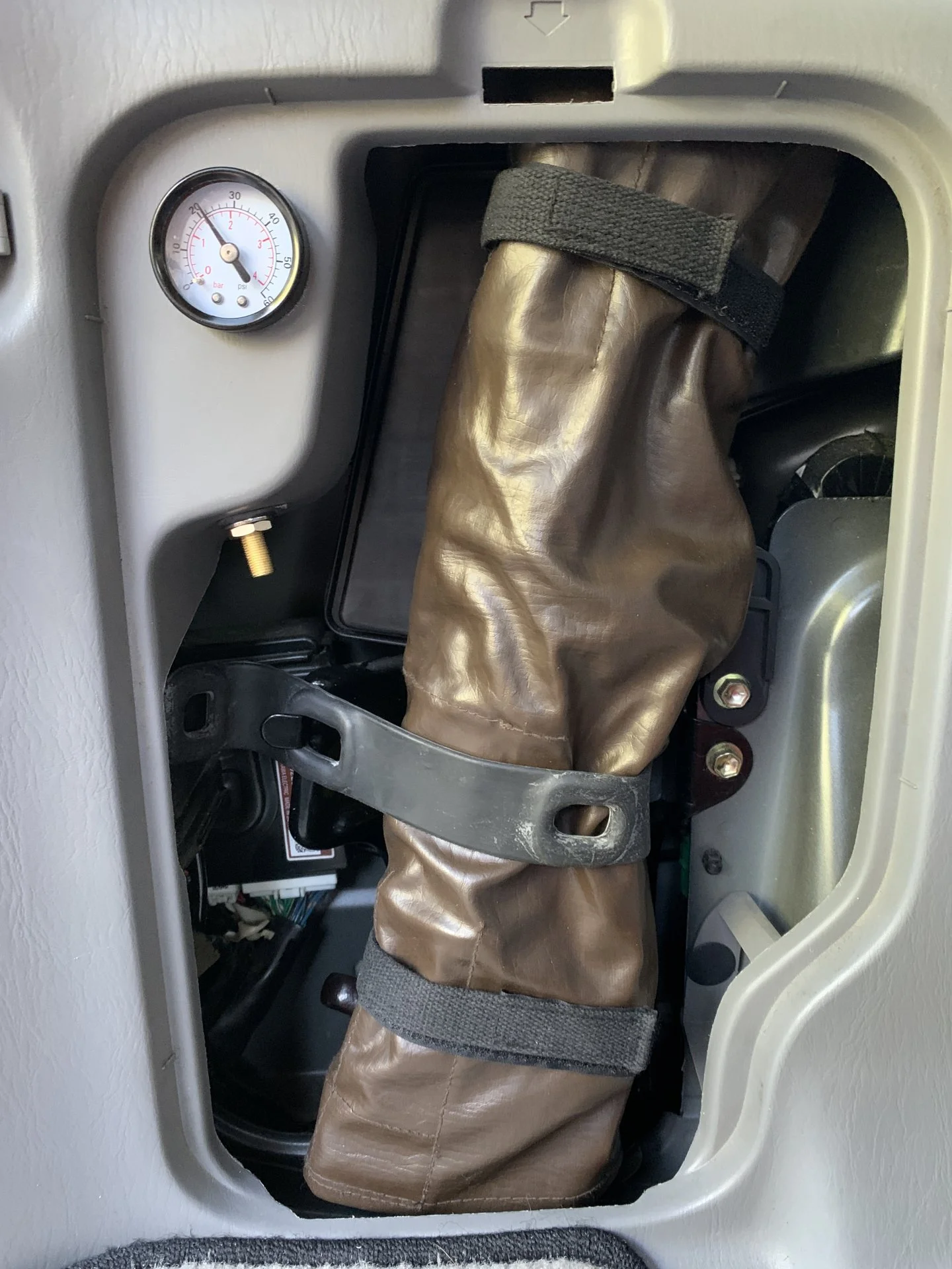

Which makes for a perfect location to mount a 60psi pressure gauge and schrader fitting. Hidden when cover panel is installed.

I like your schrader valve and air gauge install and location. Mine just sits in the wheel well, on the plastic shield that covers the filler neck.
Me too. Your location is so much classier.
I will have to comfort myself with the knowledge that my valves are accessible once the truck is loaded to the gills and I realize I didn’t put enough air in preemptively…..

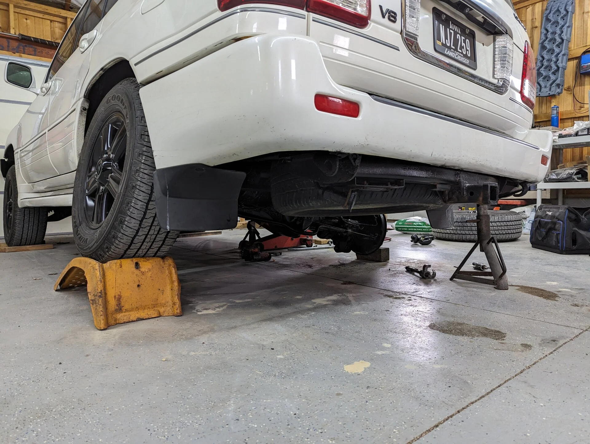

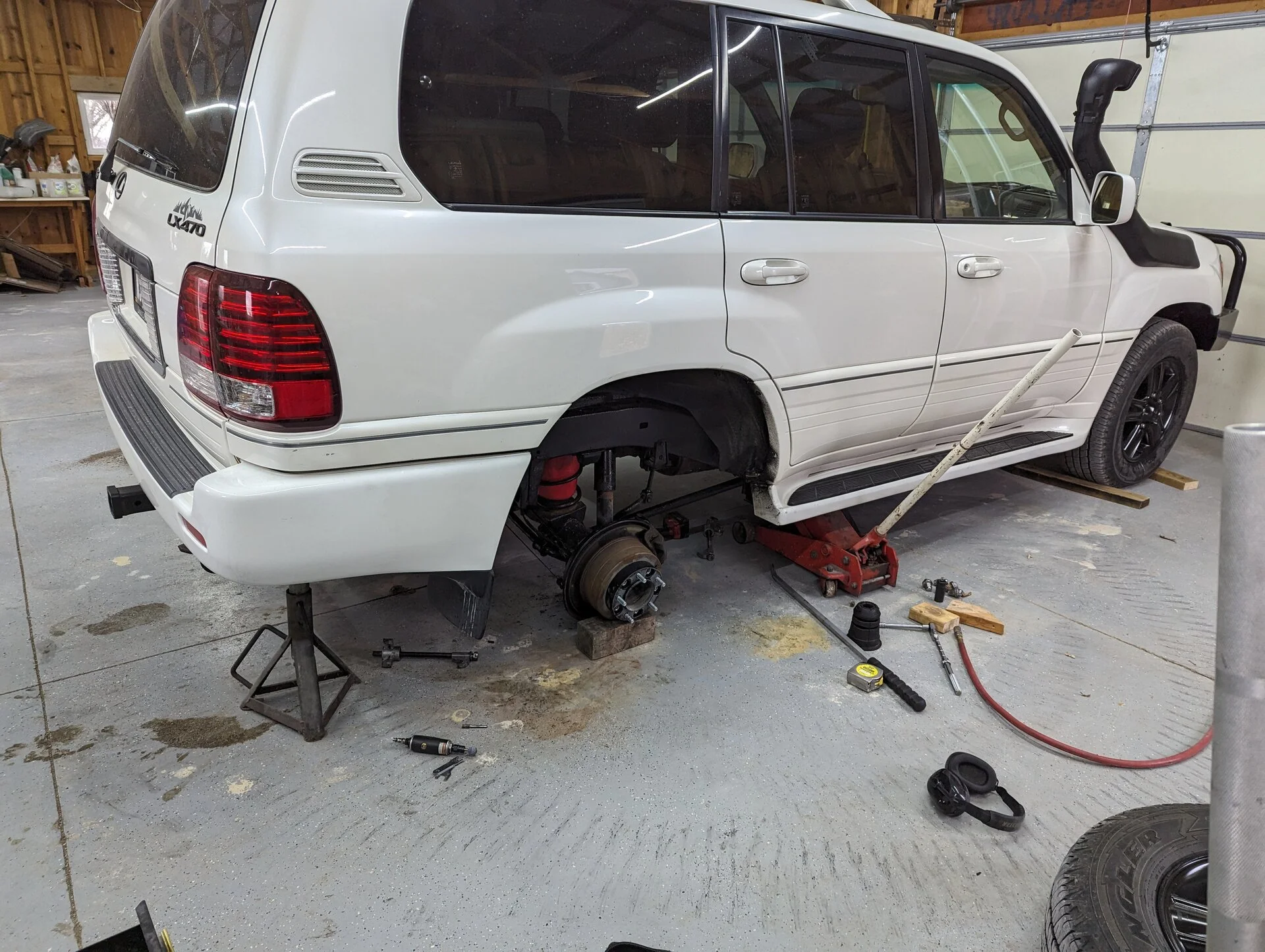

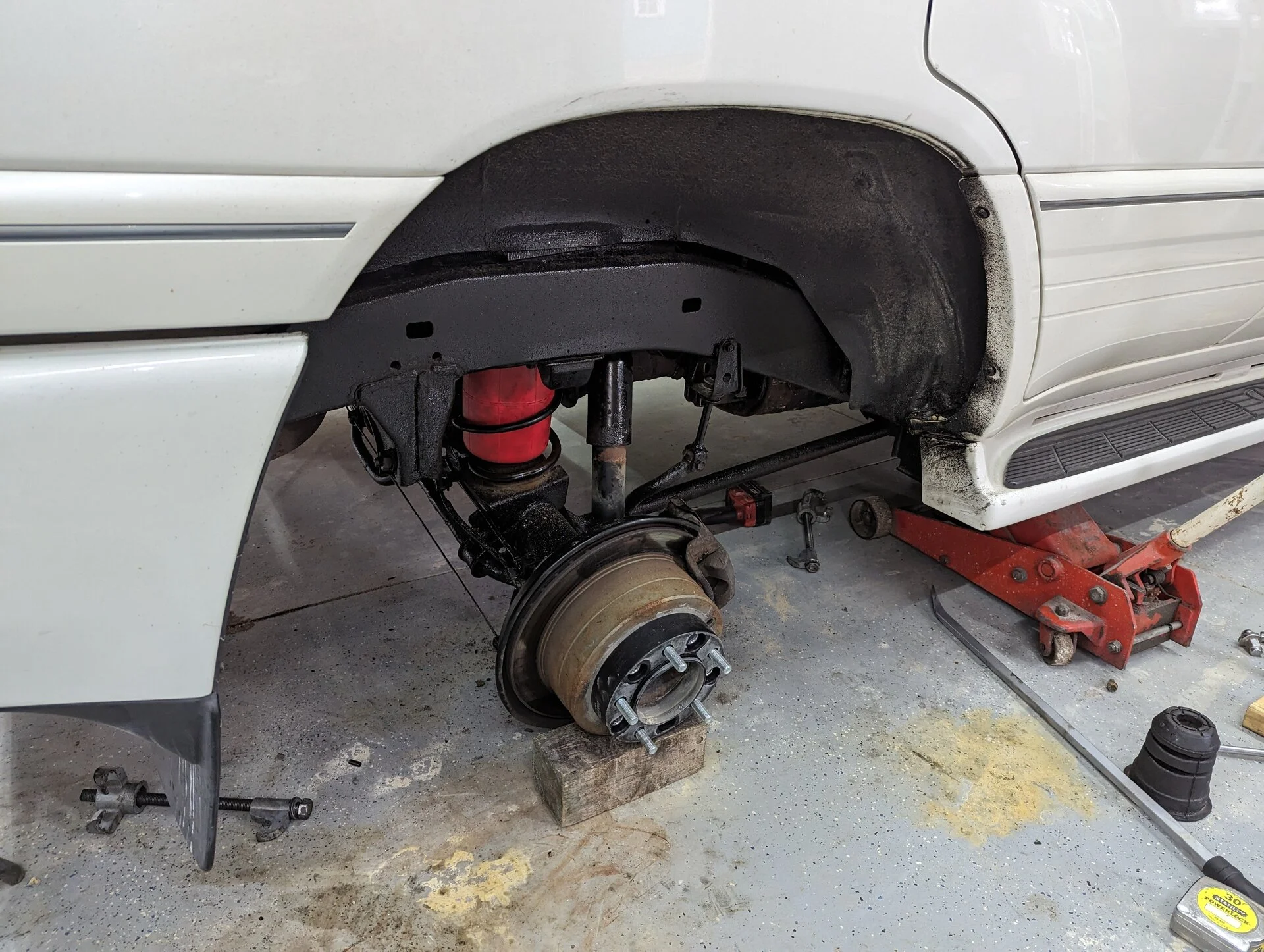

I installed my Air Lift bags yesterday. Install went smooth. Much easier than installing air bags on my Tacoma! First side took longer than second because I had to figure out how I wanted to do it. Wish I had taken more pics. I did not remove the springs in the end. The LX AHC springs allowed me to remove the bump stop through the coils and push the deflated bag into the spring that was as well. I marked a circle where the bump stop had touched the perch assuming that was center of the spring instead of the existing hole. Then I used a pneumatic (die grinder?) to make the hole bigger. Once it was about 1.25" then I deburred it with a spherical grinding bit on the same tool. Everything seemed to line up well. I put one valve on each side of the trailer plug. Seems perfect for me.
As for jacking up the LX... I drove the opposite rear tire onto a ramp, jacked up the axle on the side I was going to work on, removed the wheel, let the jack down until the outer hub part of the axle was resting on a wood 4x4. Then I jacked up the frame to get as much droop as possible. I didn't unhook shocks, sway bars, or any lines.
