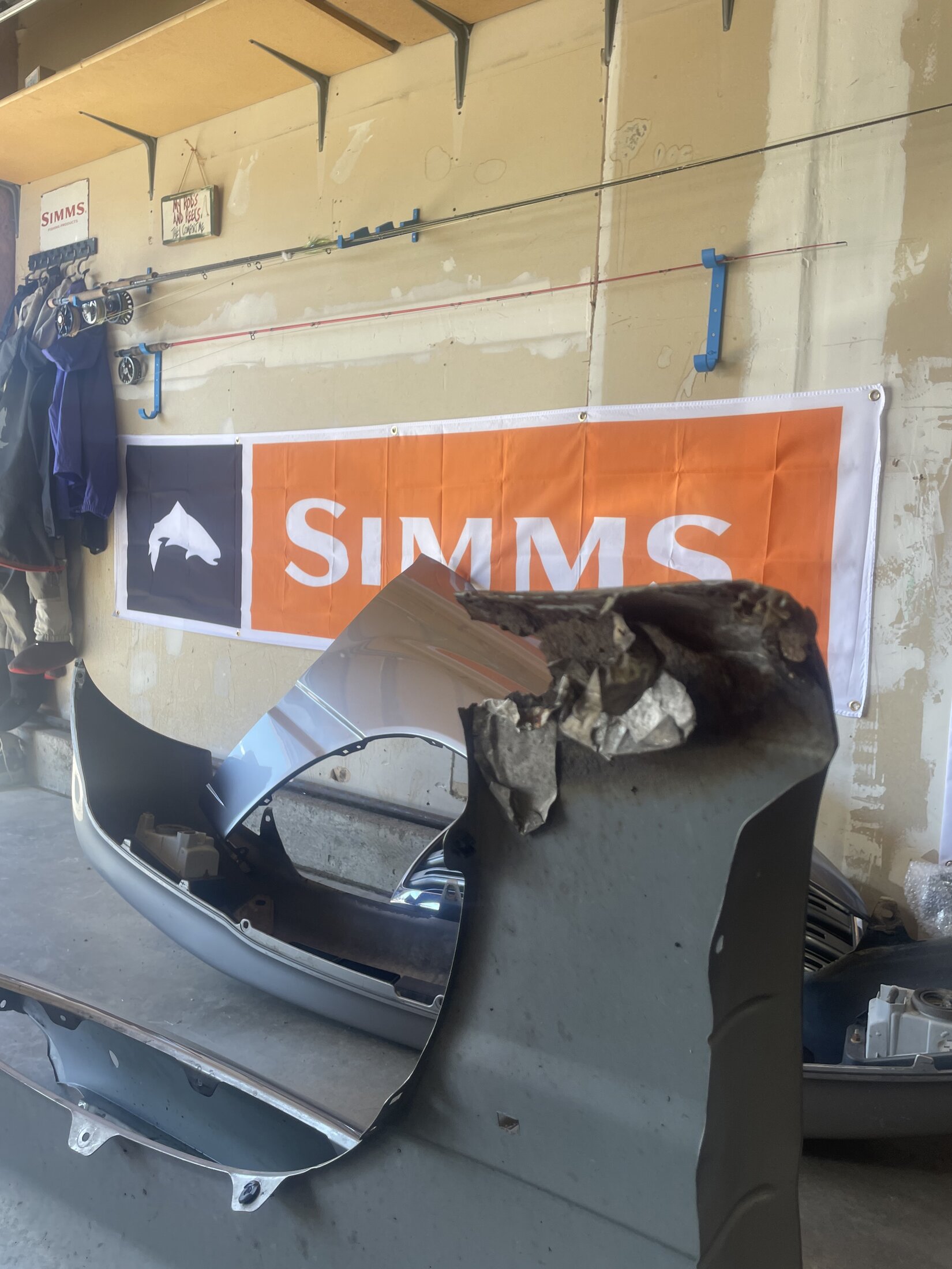

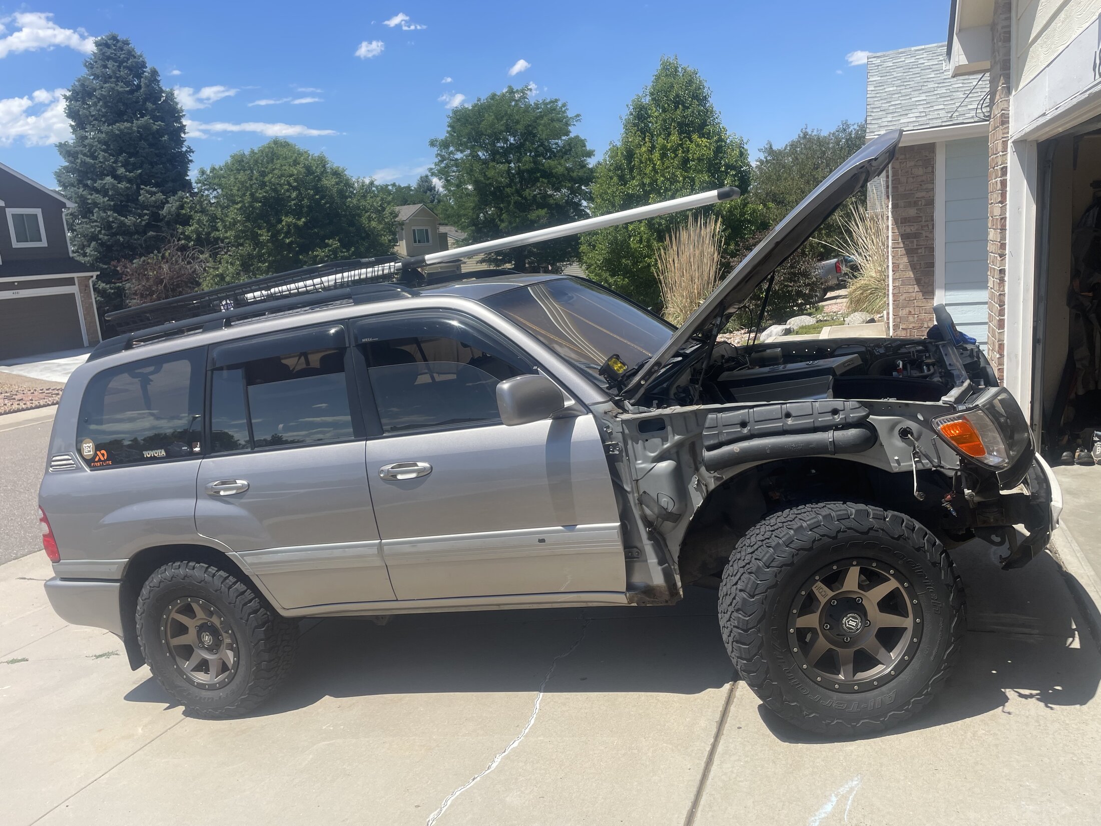

Issues. Rust. Not fun. Inspect your vehicles better.
Had to replace fenders due to the rust underneath creeping its way out. First the steps had to come off, but the very first bolt broke out. That was a trend for yesterday and today. Looks nice with the steps off though. Hope I bought enough spare hardware..
Mechanically done. Will do electrics during the week.

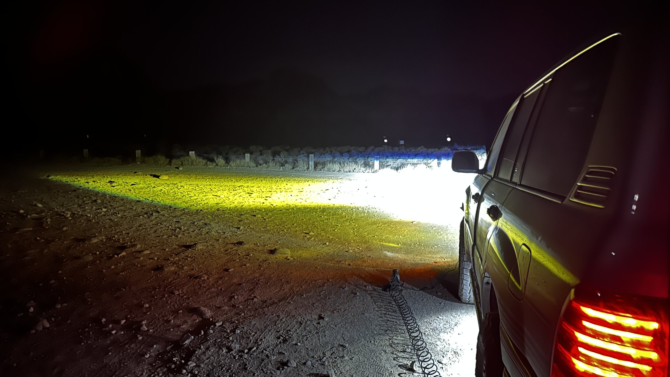

Love those 6” Rigid SAEs from the controlled cutoff to it being road legal and how wide the spread is. Props to Dissent’s design as well as it is pointed a little towards the ditch making the coverage more wide.
Me airing up at the trail head after we went down from the mountains - recent night adventure with my two girls.
All fenders rust at that spot due their stupid design. Even with fender liners in place, there is a nice pocket at the bottom of the fenders to collect moisture and dirt and rust at will. Check for rust on the body side too. I'd recommend coating with a rust covertor primer and then putting down a truck bedliner type product on the inside of the fenders before installing them back on.
Another area that loves to rust on these trucks is the front bottom corner of the rear wheen arches. There too, Toyota inexplicably decided to leave some pockets to gather moisture and rust :(
Finally, I would take a close look at the rear lowest part of the quarter panel (under the rear bumper side wings). Sunroof drains terminate there and can easliy flood those corners, leading to rust.

Love those 6” Rigid SAEs from the controlled cutoff to it being road legal and how wide the spread is. Props to Dissent’s design as well as it is pointed a little towards the ditch making the coverage more wide.View attachment 3662053
Very cool, yeah. Looking forward to have the fogs and sequential blinkers running. Hate cables so my main challenge is still ahead of me :-D
All fenders rust at that spot due it stupid design. Even with fender liners in place, there is a nice pockets at the bottom of the fenders to collect moisture and dirt and rust at will. Check for rust on the body side too. I'd recommend coating with some rust covertor primer and then putting down a truck bedliner type product on the inside of the fenders before installing them back on.
Another area that loves to rust on these trucks is the front bottom corner of the rear wheen arches. There too, Toyota inexplixable decided to leave some pockets to gather moisture and rust :(
Yep, crazy because when I bought the truck a couple years ago the rust was not this bad. But it seems like from the moment I got it, the rust spread like wildfire. I definitely treated the inside before installing back on.
now to see if I can salvage the trim moulding pieces from the old fenders.

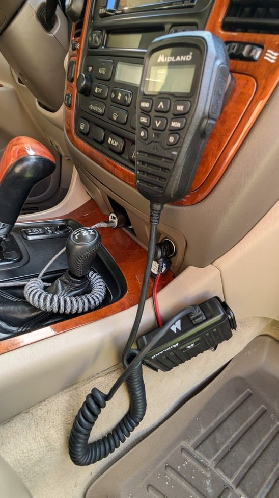

Have been slowly getting the electrical sorted. Just need to wire up the rear outlets and run power for the radio to the house battery.

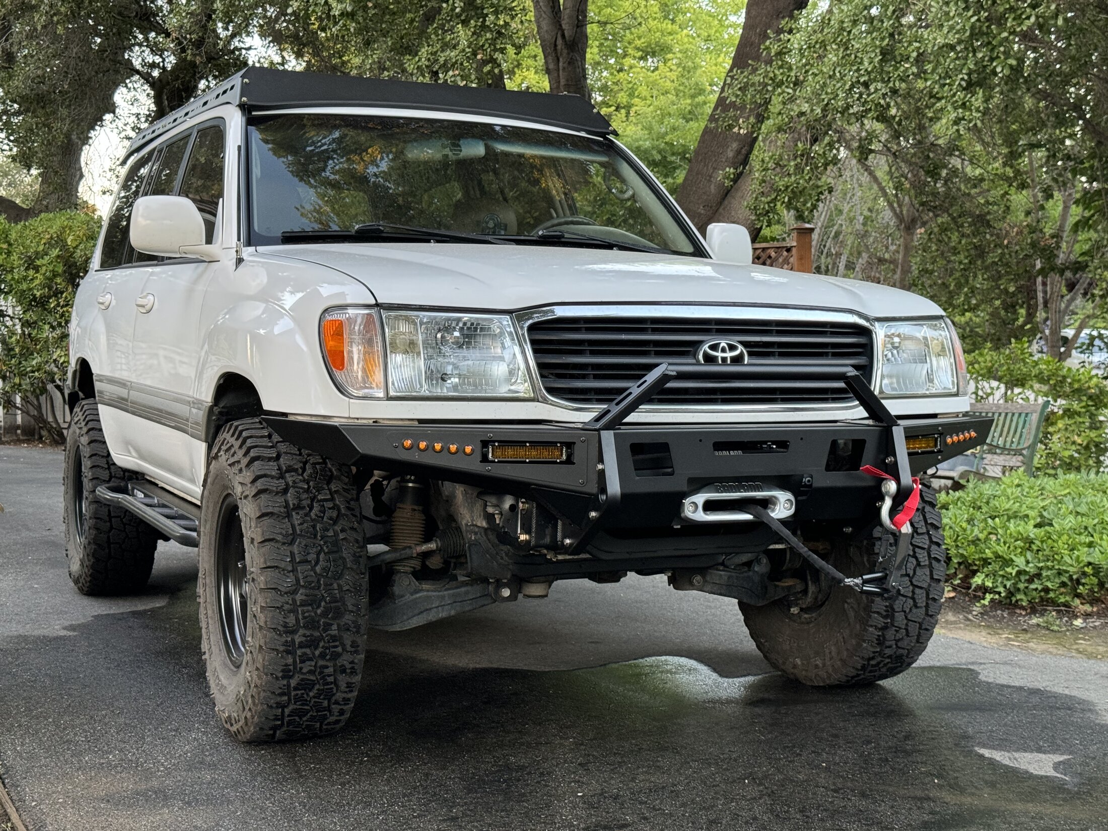

All in all it went fine, but drilling a straight hole was my problem 😂
Also don‘t like the stainless bolts and will swap them out with yellow zinc ones.
Looks great! Glad you were able to mount the Apex Badlands winch in there. I struggled and finally gave up mounting the same winch but in the extreme clearance bumper. Need to look for a winch that is clockable on both sides. Wish I knew this ahead of time.
