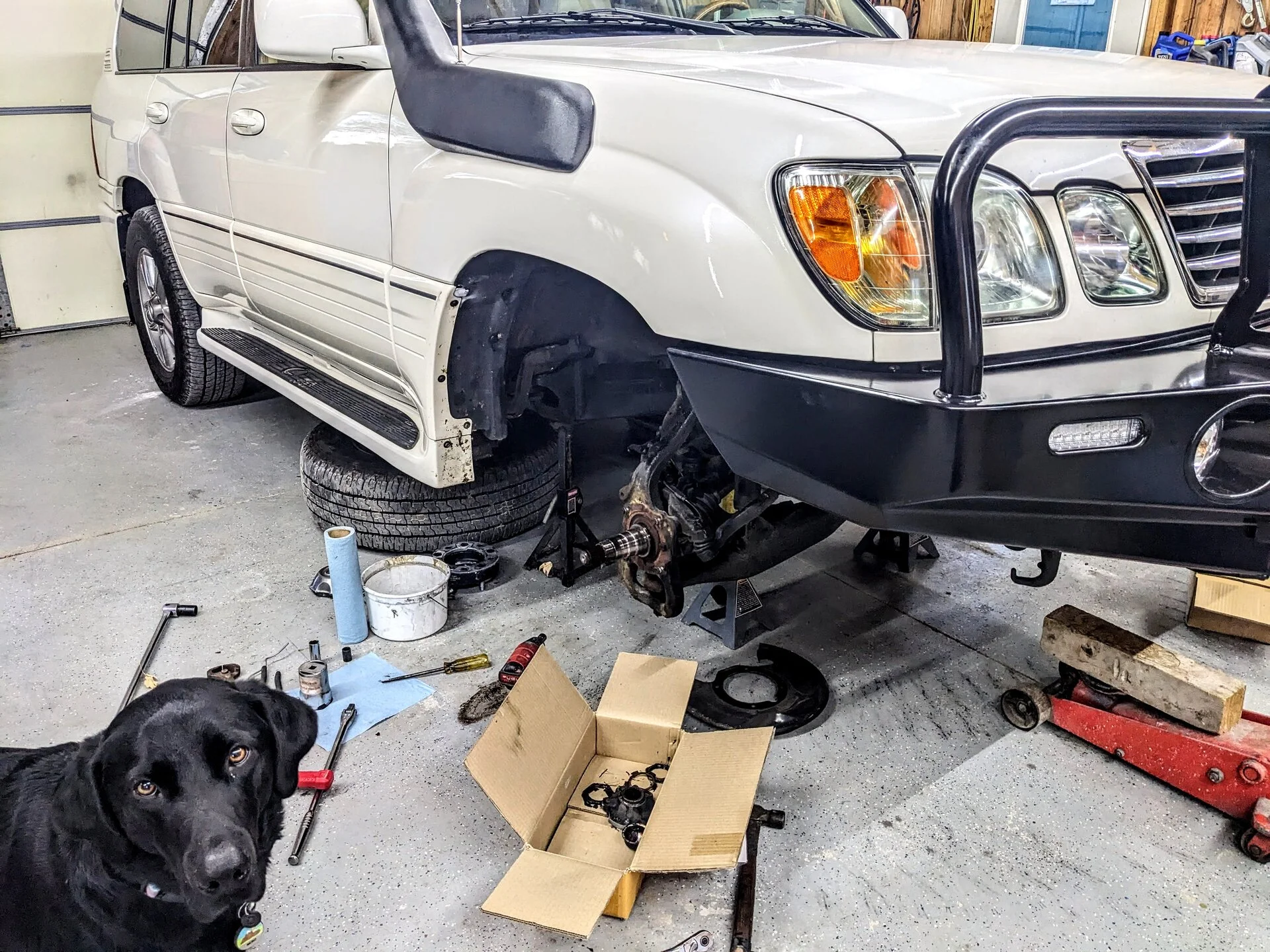

Front end refresh has been slow. Got the driver side upper control arm in, repacked wheel bearings. I bought some OEM ones and was going to switch them out but they were Timken bearings and looked almost new so I repacked and reused them. OEM brake pads installed. Can’t break the tie rod ends loose tried PB blaster, heat, and nothing seems to work. Still have to do LCA, shock bushings, no 2 bushing and sway bar refresh.

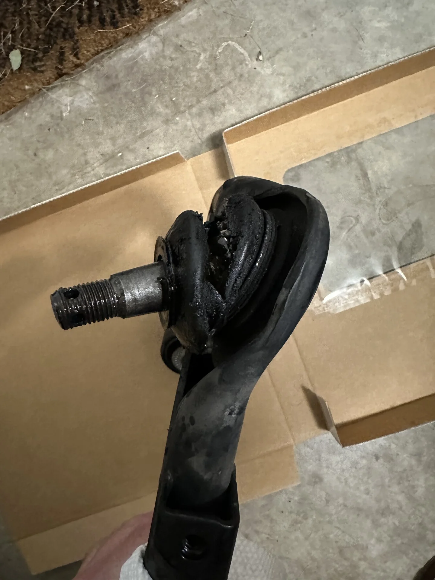

That tie rod jam nut was SUPER tight on mine when I pulled one off. I needed to replace a rack boot and it took longer to get the dang tie rod end off than the whole rest of the job! Found out both outers were bad and need to be replaced. Seems like every time I repair something I find something else wrong...

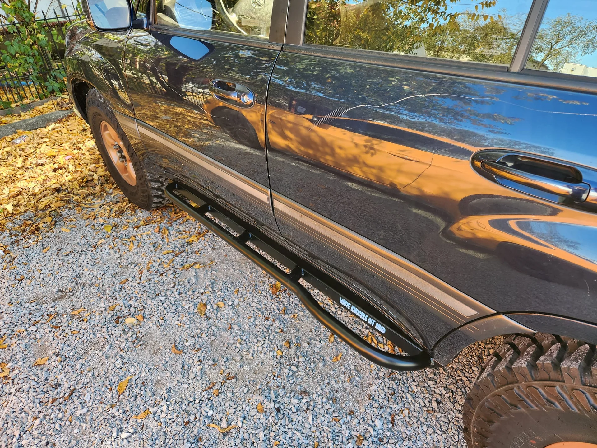

Installed the WKOR sliders today. Super easy install especially with a spouse handing you hardware.

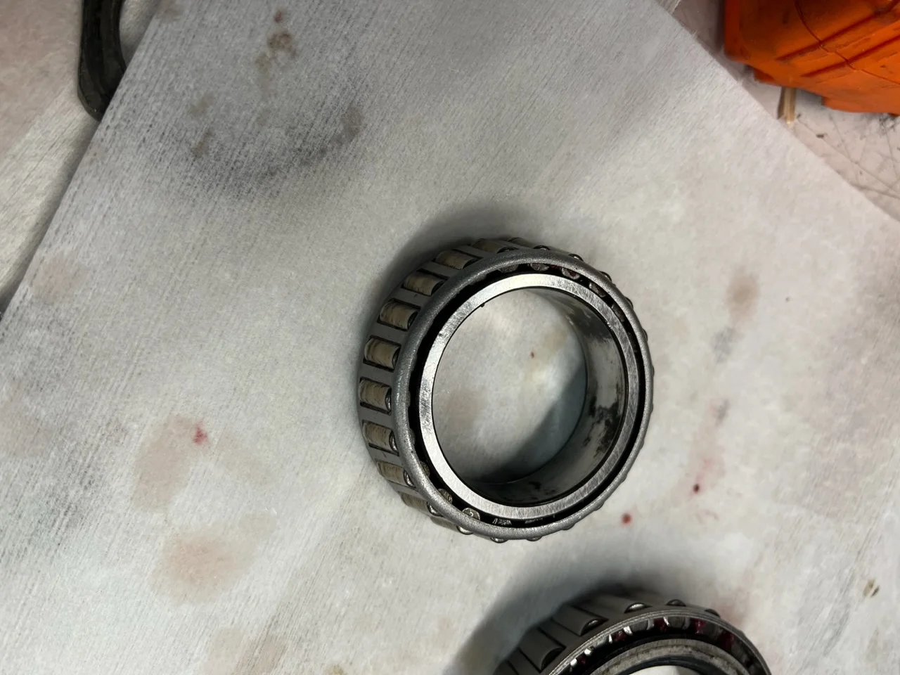

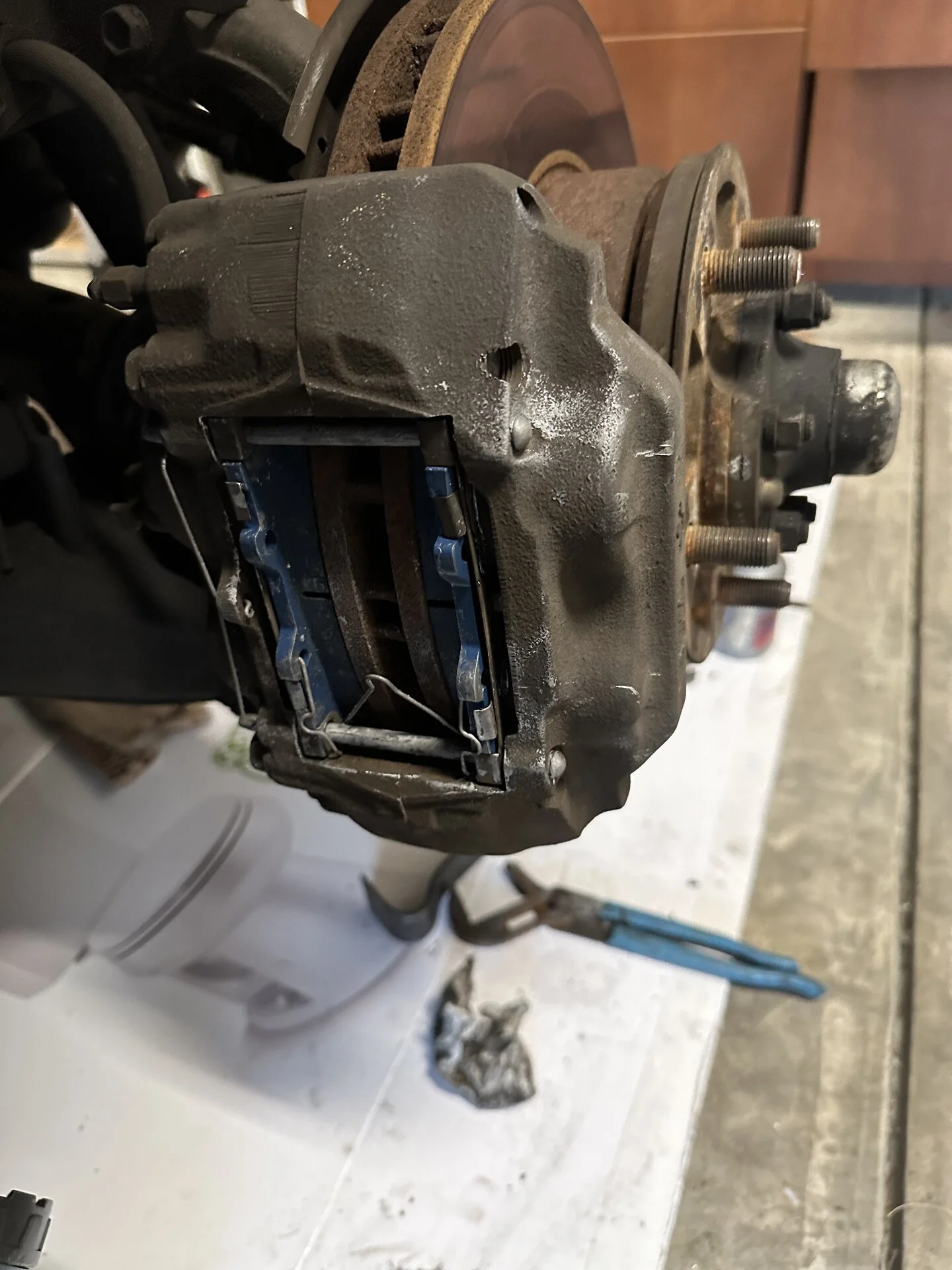

Repacked the wheel bearings. 30k since last repack and 60k since I rebuilt the front end. I little darkening on the inside of the bearings, but the grease looked good. Definitely time to do it, though.

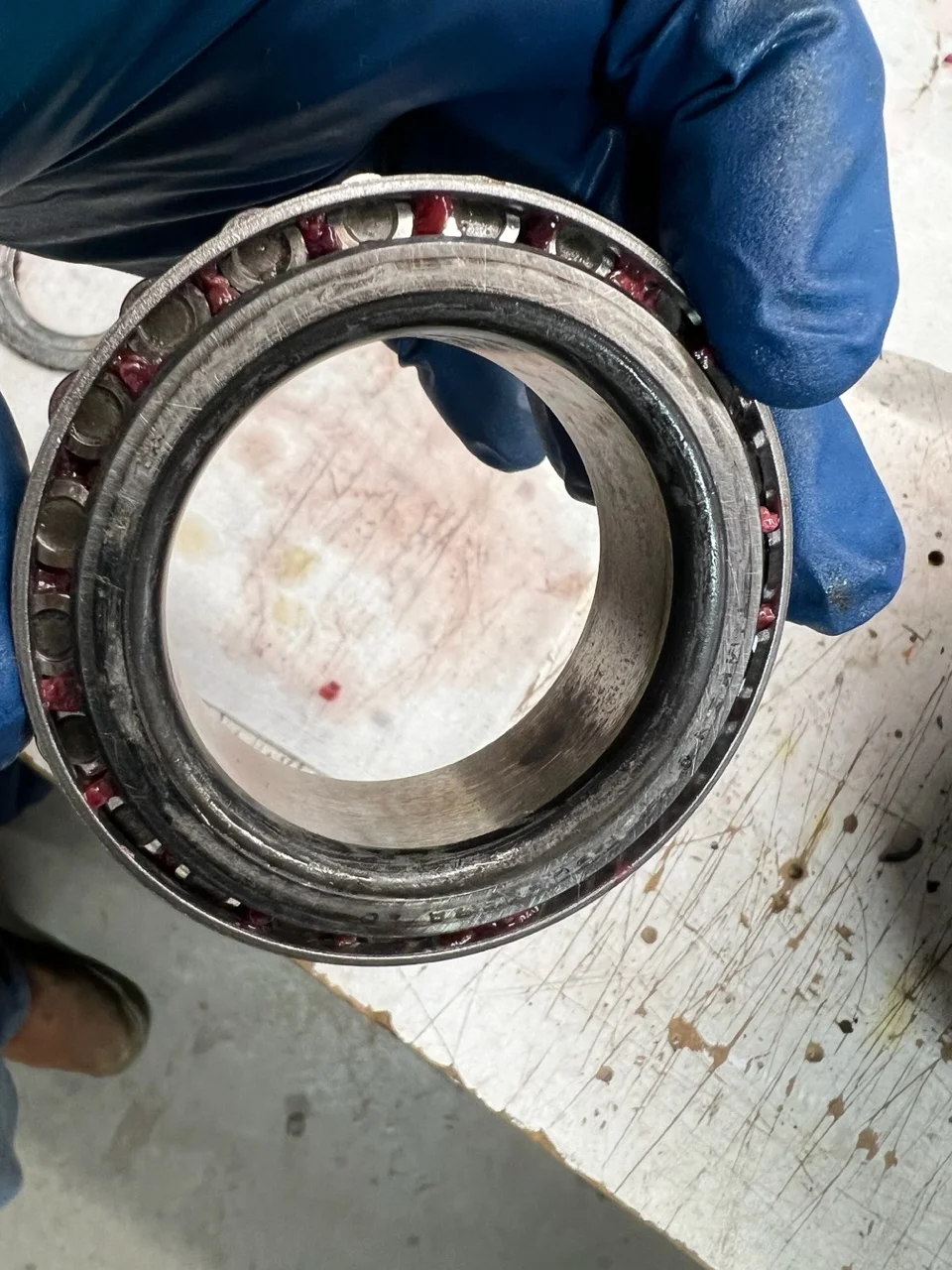

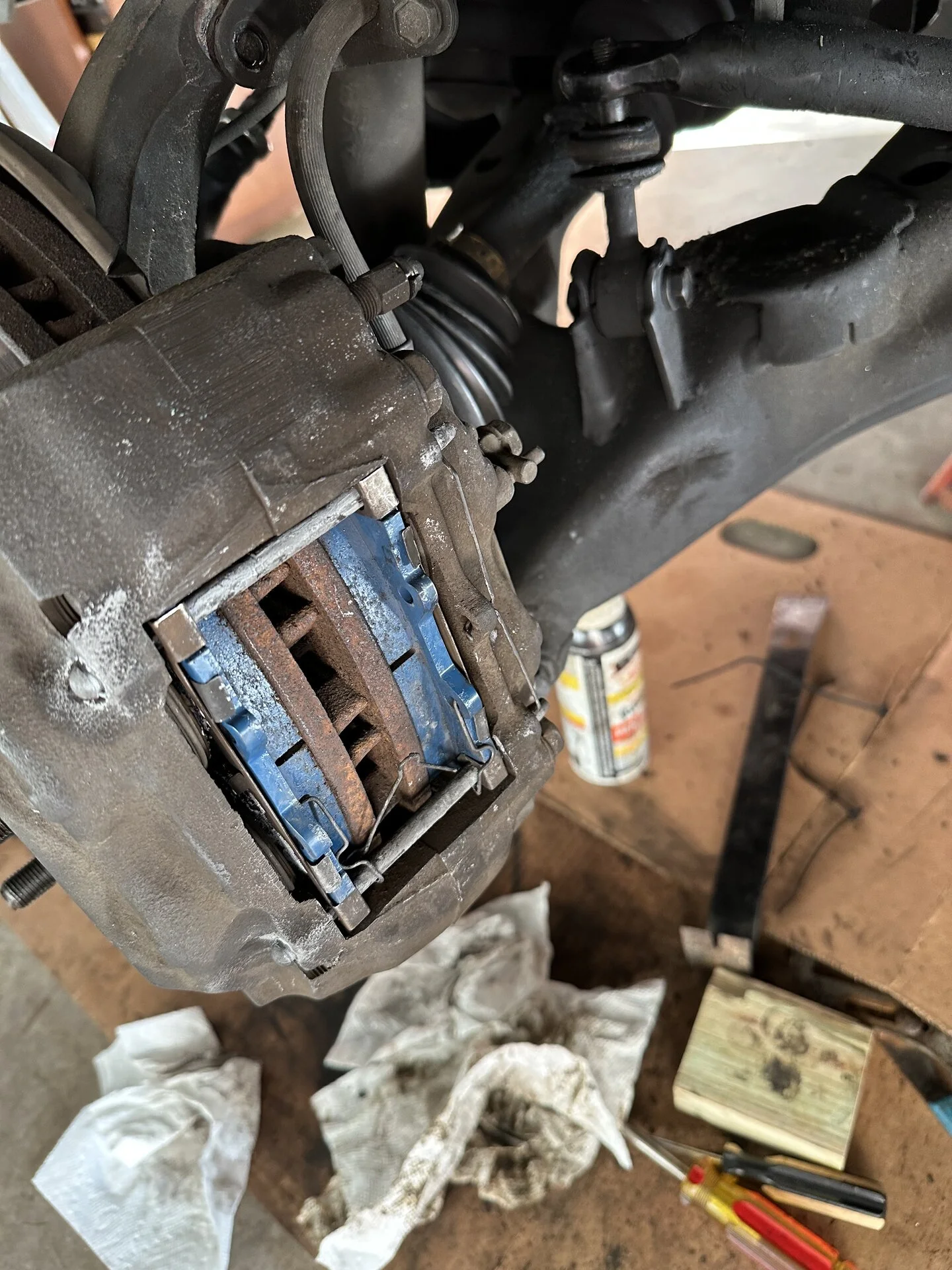

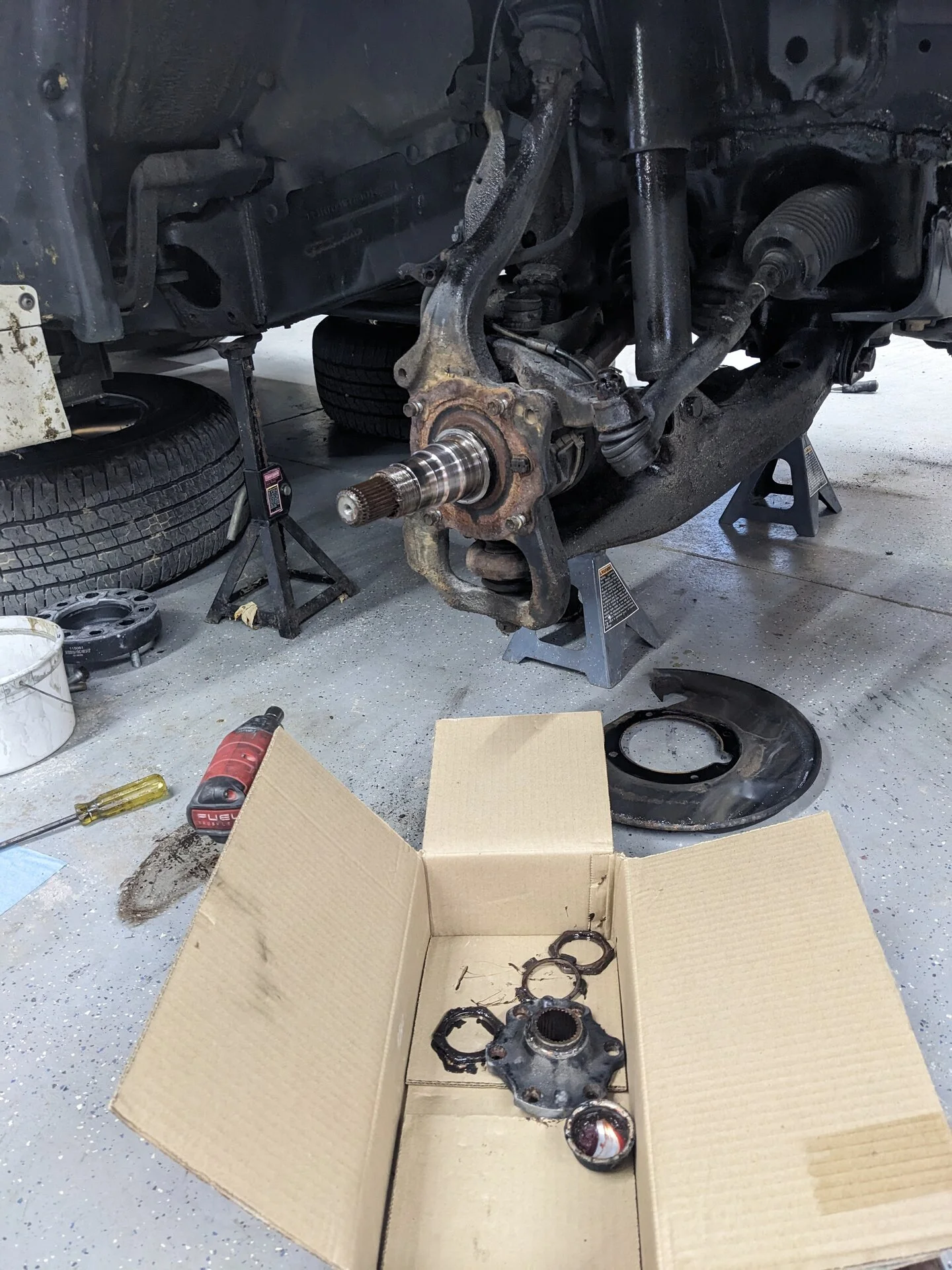

Front wheel bearings were a little loose. Passenger side bearings looked and felt great. Grease was in good condition and the cv axle and flange splines looked good as well.
Driver's side bearings were a little discolored, didn't feel great, and the grease was in bad shape. CV splines were badly worn and flanges weren't great. So I ordered some parts tonight.

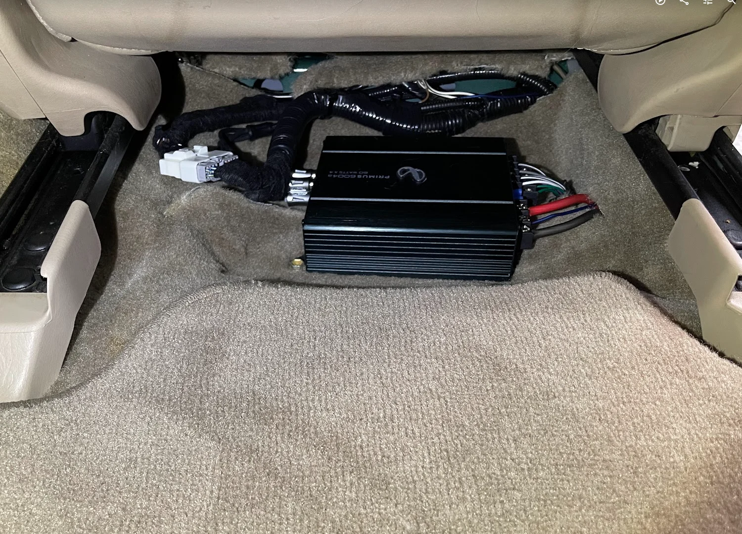

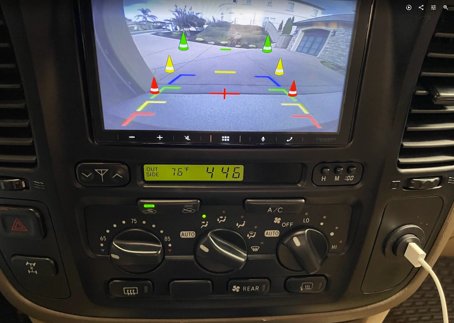

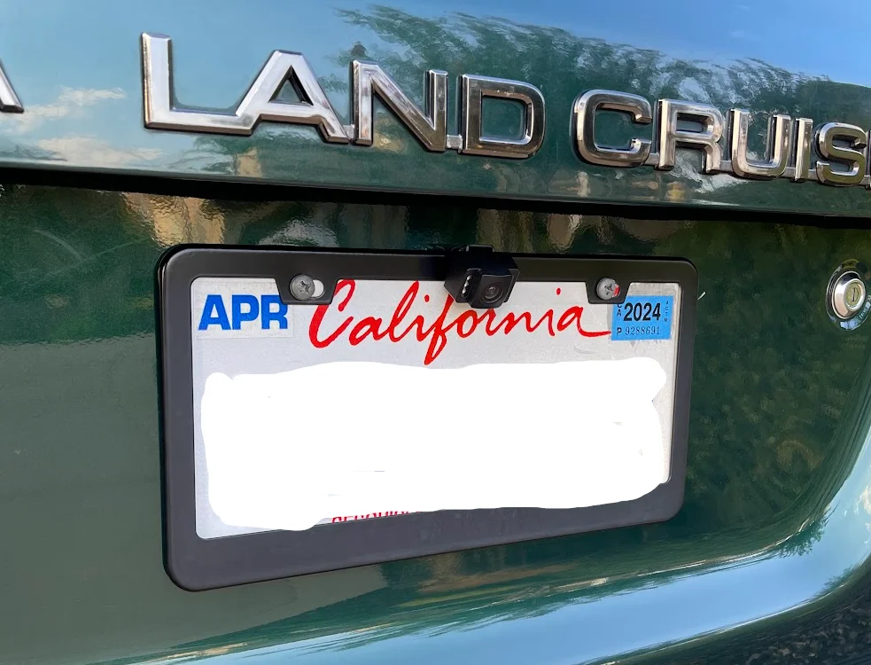

Finished my sound system replacement today. I started with a new head unit, speakers, and a backup camera, with a Metra harness to reuse the factory amp. When I got that installed last weekend, I had a hiss from the speakers, even while in ACC mode, and with the volume turned completely down. I had seen this on the forums, but some people who reused the factory amp did not have the issue, so I decided to try the factory amp first. Last week I ordered a new amp and a bypass harness, and it sounds awesome today. I don't currently have a sub, but could add on pretty easily if I miss it. Honestly, the sound is far above what the factory setup was, so I am pretty happy so far. The backup camera is okay, but I would recommend trying a different model. They Boyo one I got had good reviews and was recommended by the sales person, but it is kind of washed out...I haven't called to see if there is anything I can do to adjust that, but I haven't found anything in the documentation.

Pic of the backup camera. That washed out look is a bit annoying, but otherwise the camera works great. There is a wire you can clip to remove the cones and lines...I might do that.
My makeshift bracket causes the amp to be not perfectly straight, but I'll never see it. :)
Backup camera mounted behind the license plate frame using the same bolts as the frame.
I had to drill for the backup camera, behind the license plate. I sealed the hole after routing the wire, then followed the same path as the other wiring on the driver's side. This took a long time, but keeps everything water tight.
I am using the Crutchfield amplifier bypass harness (the long one that goes from amp to radio) & had no power to the radio. I troubleshoot with Crutchfield & they are sending me another radio to try. I was just wondering if you had any problems like that during your install?
I did not. I actually started with the harness that keeps the factory amp, and had a lot of static. Once I switched to the bypass harness, and installed my own amp, everything worked right from the start.

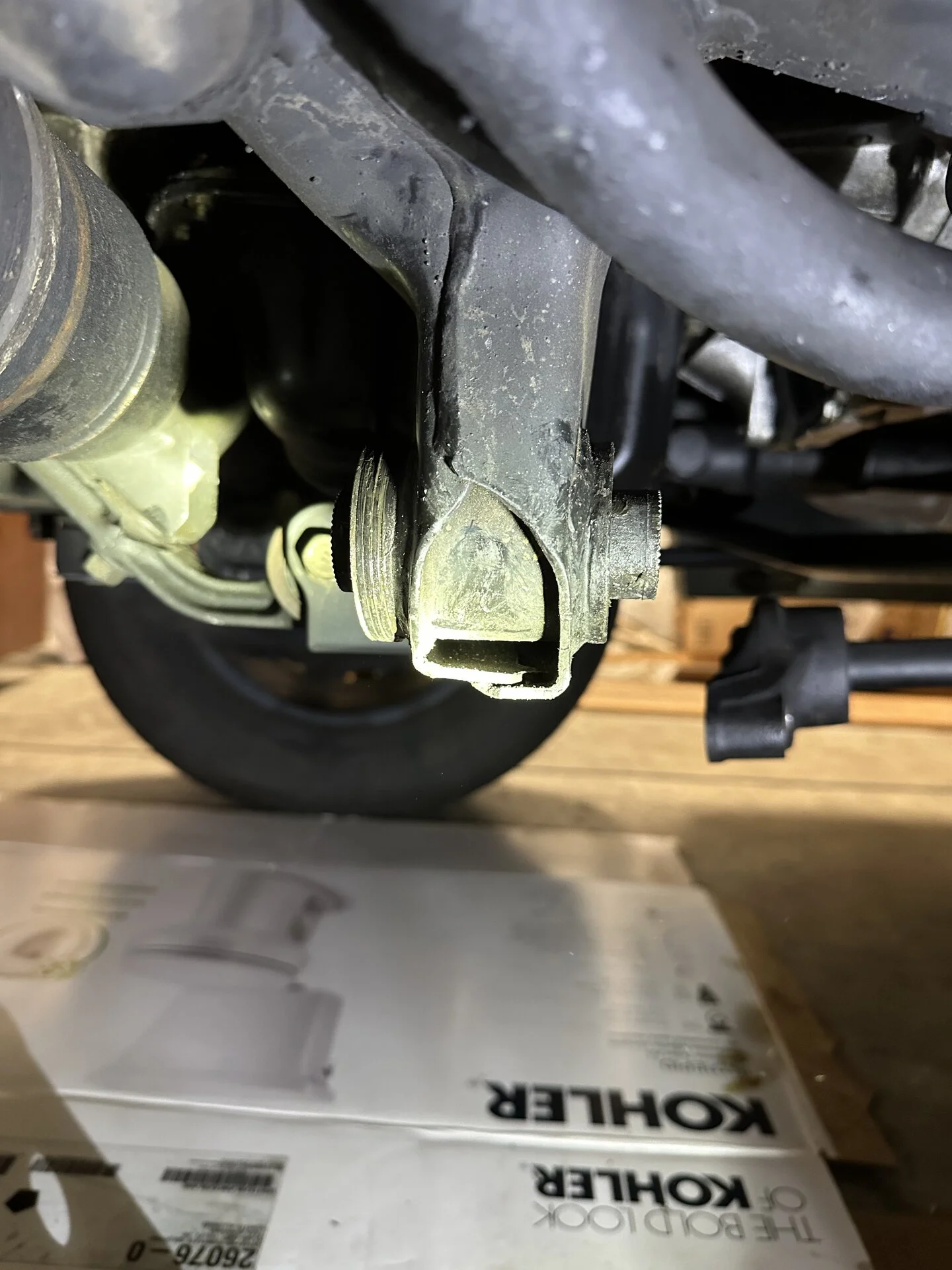

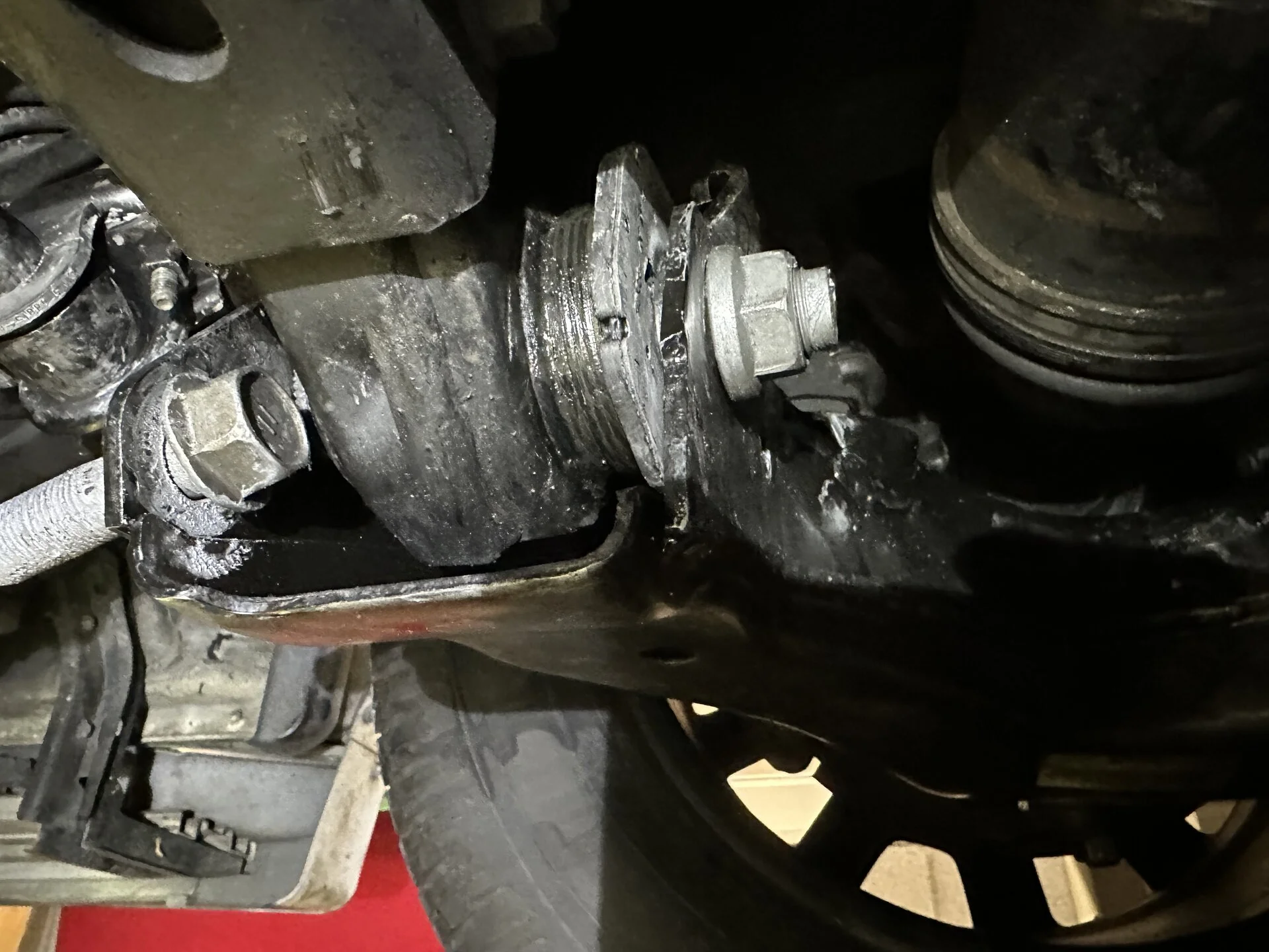

Got my drivers side front end refresh back together and moved onto the passenger side. Had to add additional spacers for the lower control arm to fit. Still have to torque everything and replace tie rod end but I need to find some bigger wrenches. Hopping passenger side goes quicker.
