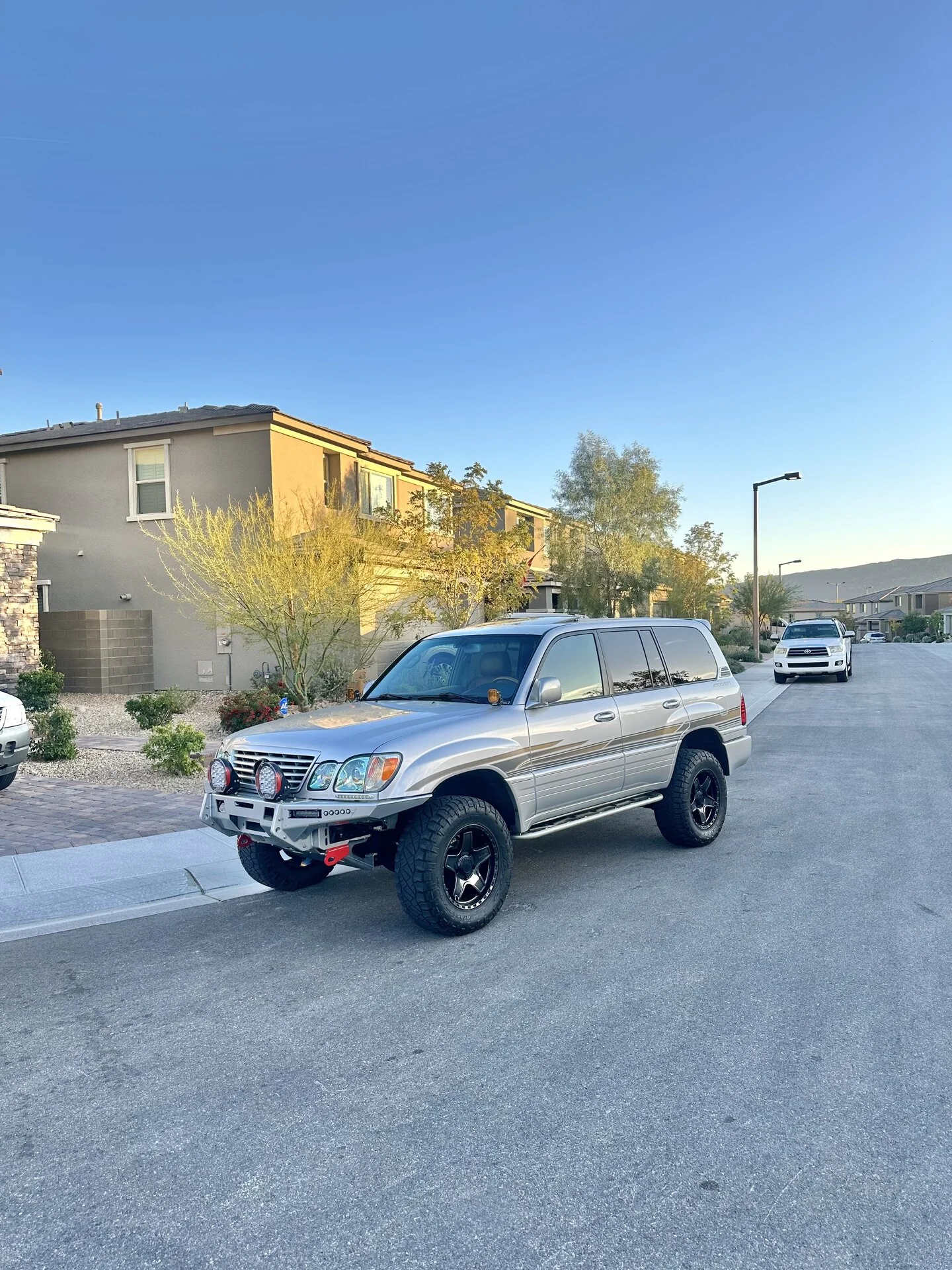

Few weeks ago I downsized from 275/70R18 to 285/65R18 tires to personally experience how 285s would look like on my 9.5” wide wheels, I like it but dislike the 65 aspect, looks short lol. 35s indeed coming soon. The amazon ditch light bracket is now finished with the Diode Dynamics SS3 Pro, loving the not super raised and looks minimalist look.
Few weeks ago I downsized from 275/70R18 to 285/65R18 tires to personally experience how 285s would look like on my 9.5” wide wheels, I like it but dislike the 65 aspect, looks short lol. 35s indeed coming soon. The amazon ditch light bracket is now finished with the Diode Dynamics SS3 Pro, loving the not super raised and looks minimalist look. View attachment 3479583

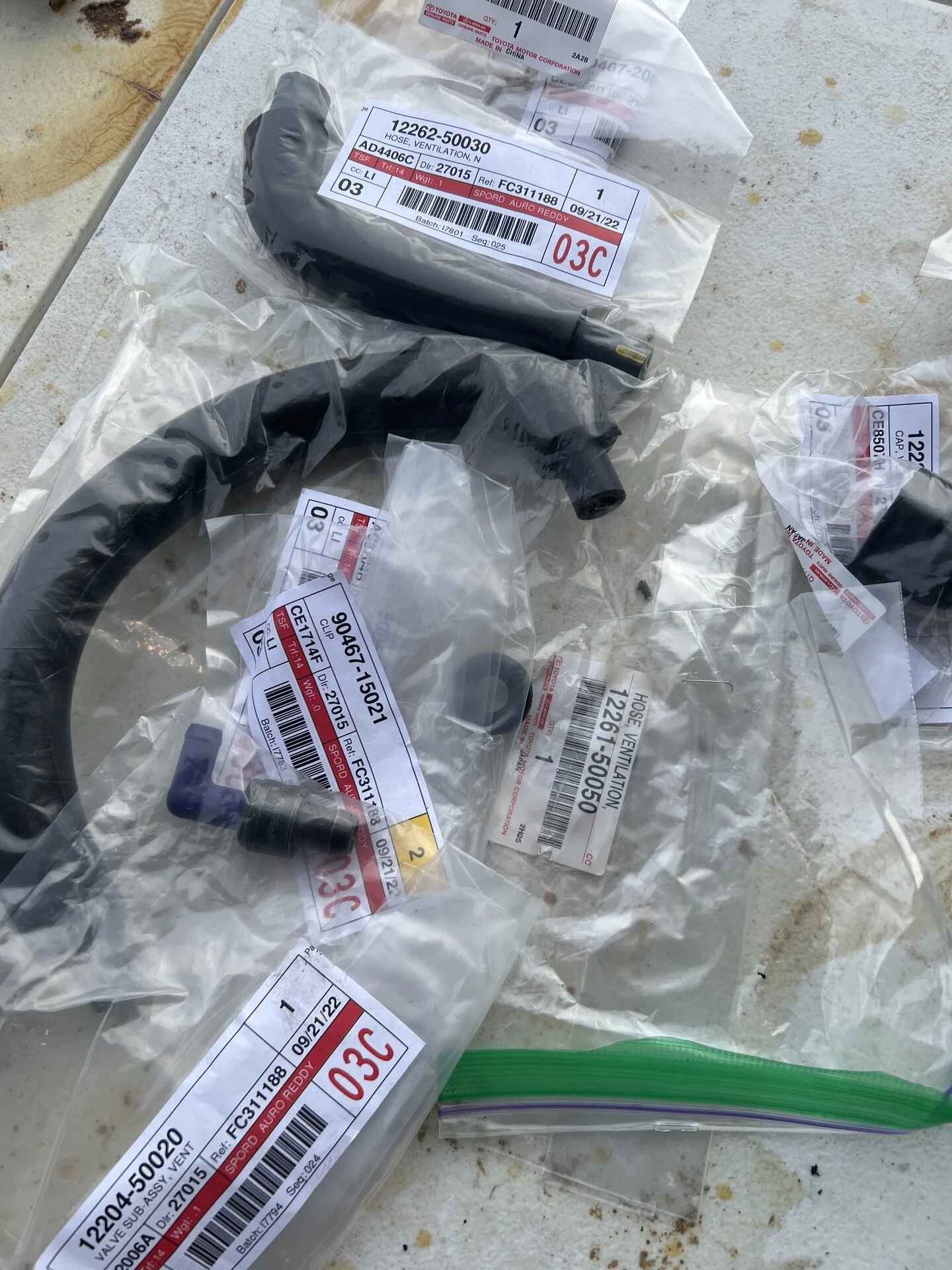

Was going to change pcv and some hoses today. But half the grommet fell into to the hole and it’s not recoverable 😞. Really don’t want to pull the valve cover gasket off as I just did them about 5k miles ago
It just happened to me too. I grabbed a needle nose plier and a head lamp right away jumped in the engine bay and luckily I got it pulled out. I just did the valve cover too. Not sure what would happen if a small piece of rubber falls in there when the engine runs.

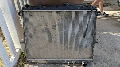

Quick backstory: Playing around at the offroad park in March when my heater tee blew at the back of the park. Next time I turned the ignition on temps showed 276. Limped it back down, friend saved me with some brass fittings and distilled water, got it home and tried some repairs. Continued to overheat in short tests but I never let it surpass 220. Was also dealing with hard start/no start issues so I thought it was something internal (head gaskets or the like) and decided to let it sit for a bit.
Couple weeks ago I dive back in, start pulling everything apart, and find this....

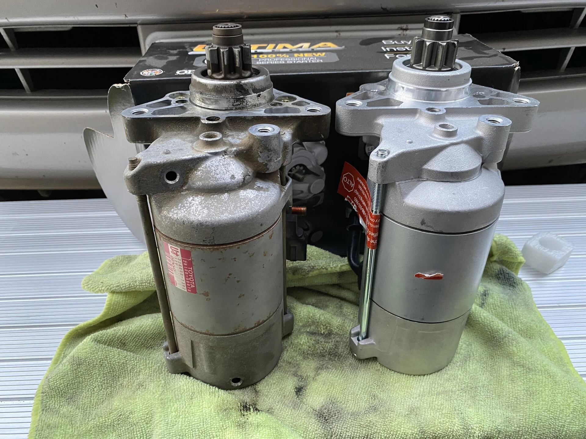

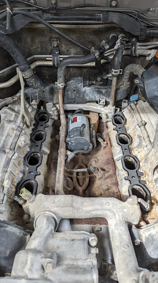

With ~60% of the radiator fins completely clogged with mud I decided to clean this out, replace a few bits (while I'm in there), and see where I'm at before tearing the engine down. Because I had the starting issues, and I'm currently at 249K, I decided to pull the IM and replace the starter.
On the IM I went ahead and replaced all injector seals, grommets, and o-rings. Also replaced all other gaskets and o-rings that would require removal of the IM a second time, then put everything back together

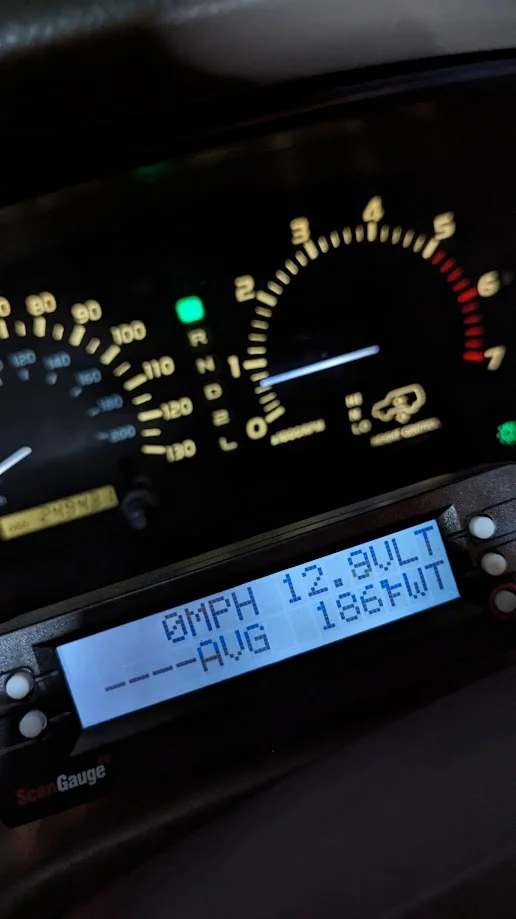

Battery was dead-dead holding only 5V, so testing had to wait. Was able to start it once I got 12V (ignore voltage reading on my ScanGuage below, it's fine now; final charge days later was 12.7V) and bled the cooling system. Pressure holds, no leaks, and the thermostat is opening at 188 just as it should!

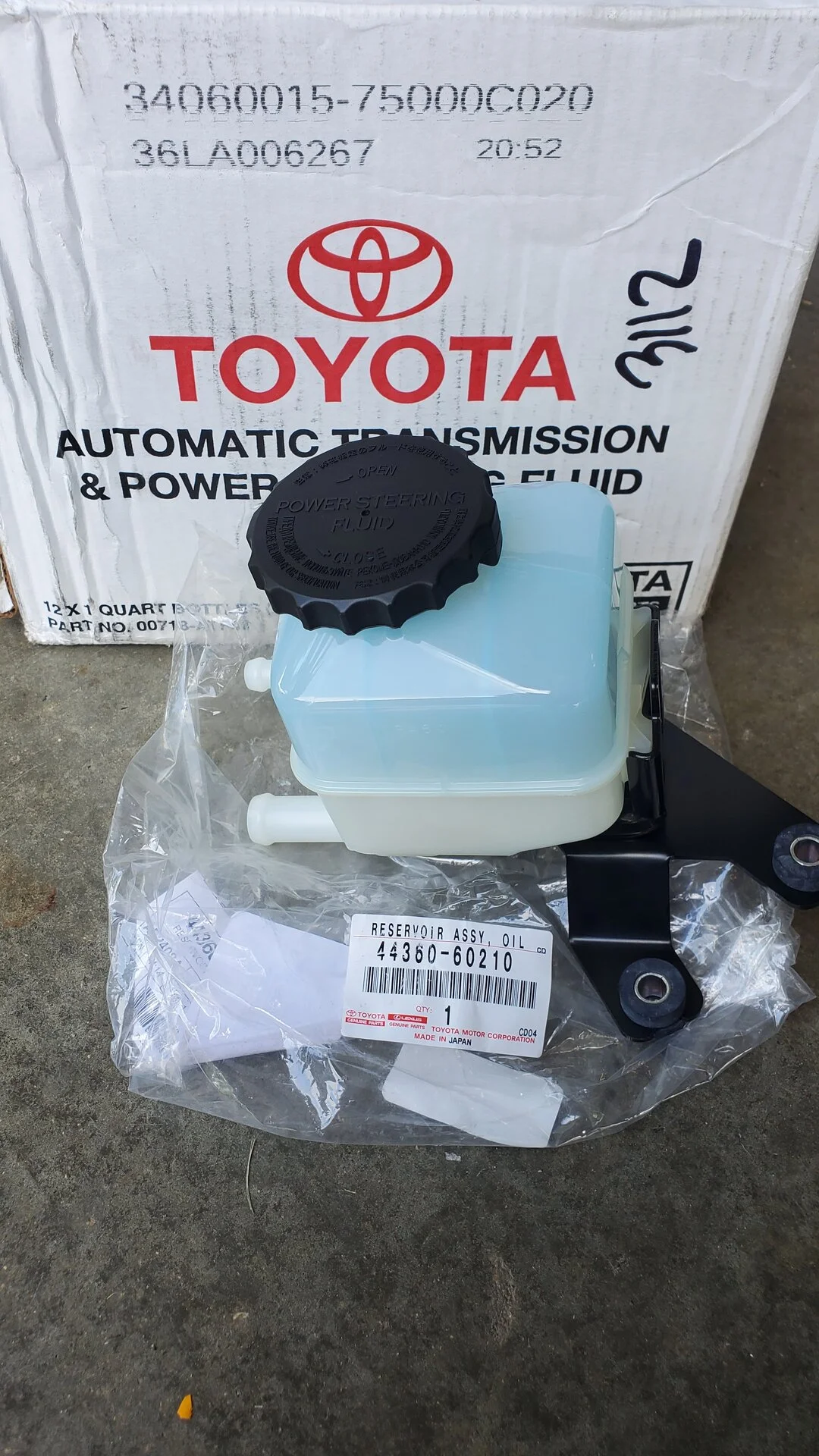

Replaced the power steering reservoir and flushed with almost 4 quarts of Toyota ATF. My PS steering was screaming bloody murder before the flush, it is now nice and quiet again!
This was a fun job. Kinda. Way harder than it had to be because I replaced the lines as well. But so satisfying to see the new, non-discolored reservoir in there!

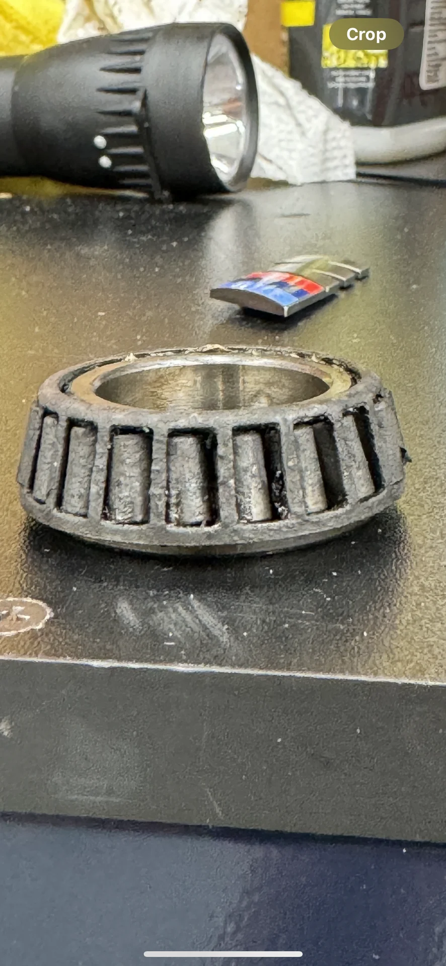

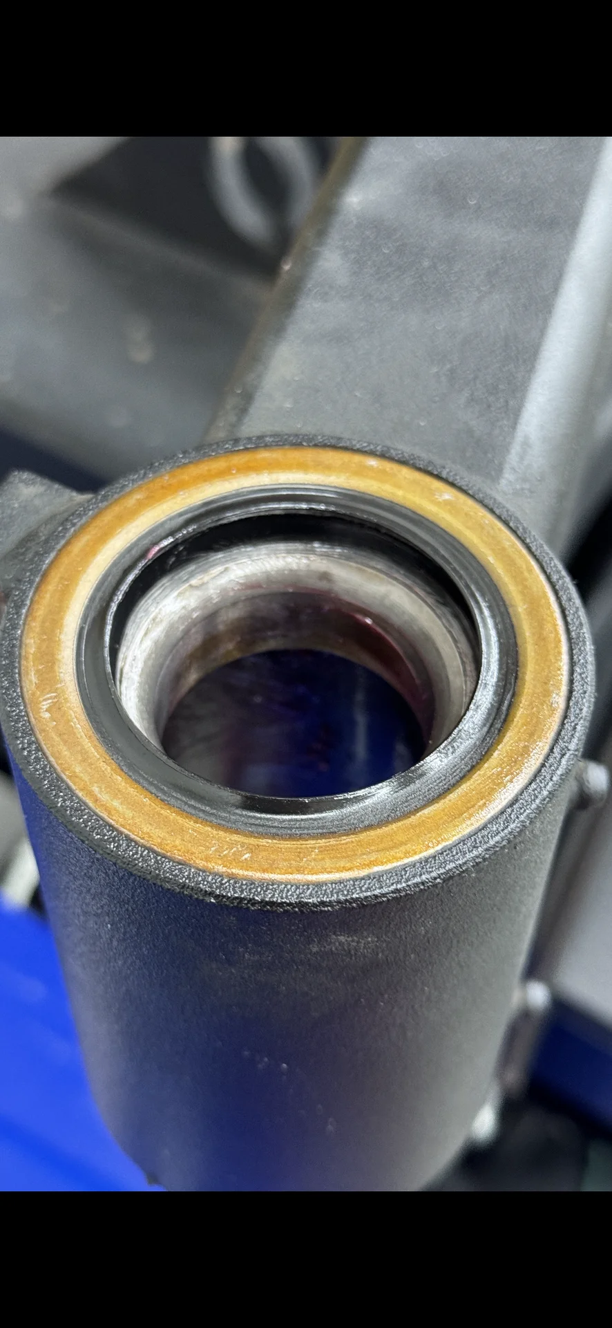

Sunday I pulled both swing outs. The tire carrier was a bit jiggly, and had to investigate. Spindle Bearing blown out, new Timken unit for both sides on order. These have never been serviced, the grease was black and watery. My garage reeks of this stuff. Cleaned everything up, and applied a light coating on Mobile 1 Wheel bearing grease to prevent any flash rusting/oxidization.
