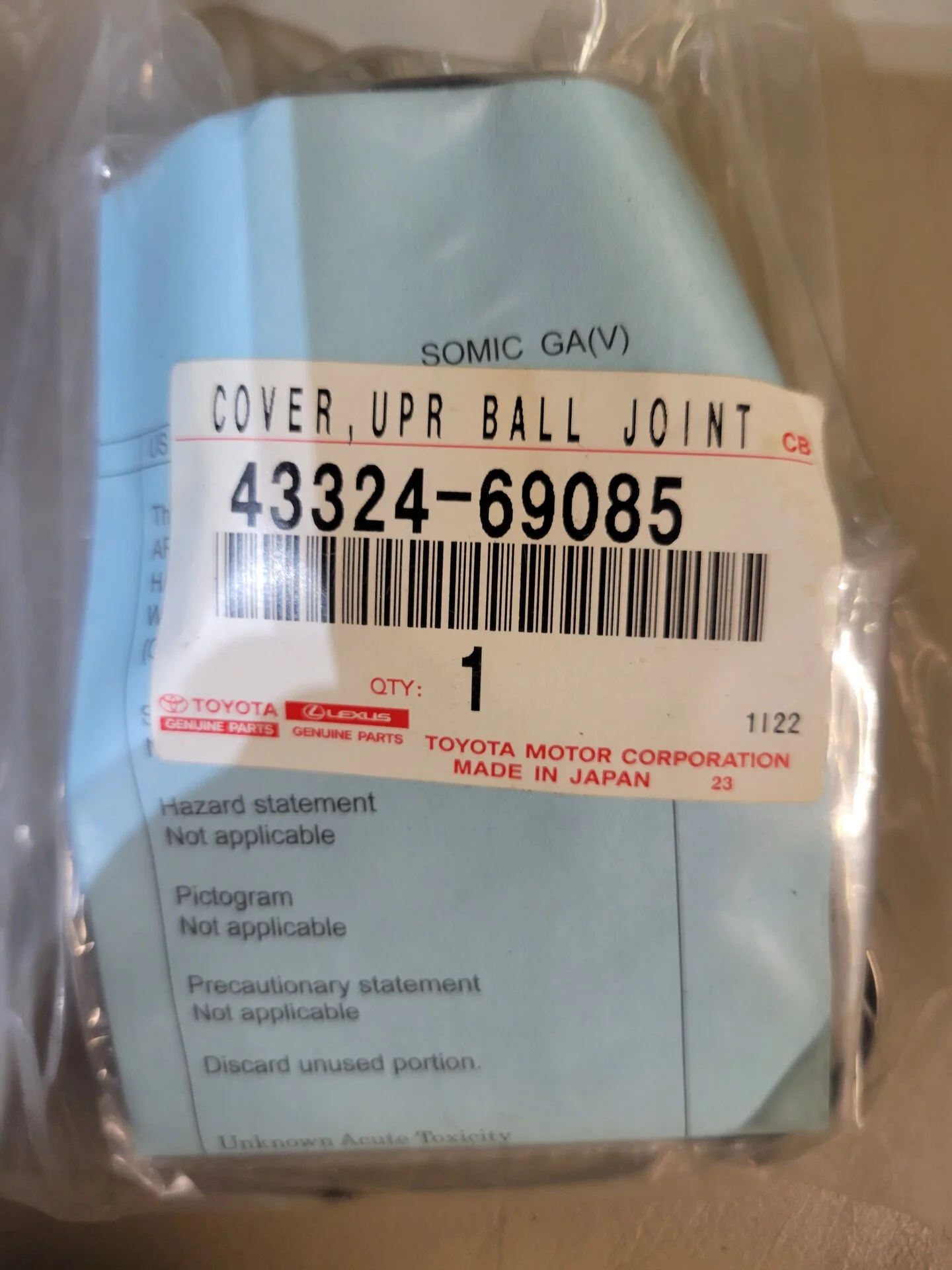

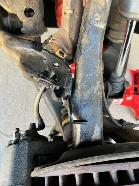

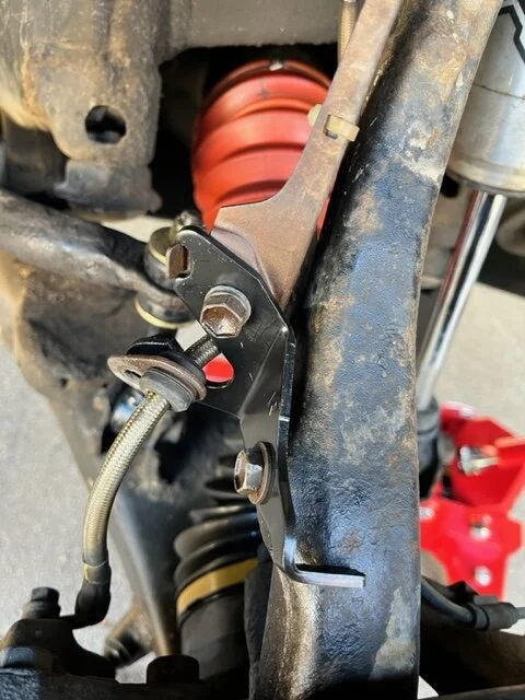

At the same time I ordered new boots (4332469085) for my upper ball joints. Will hopefully tackle those soon.

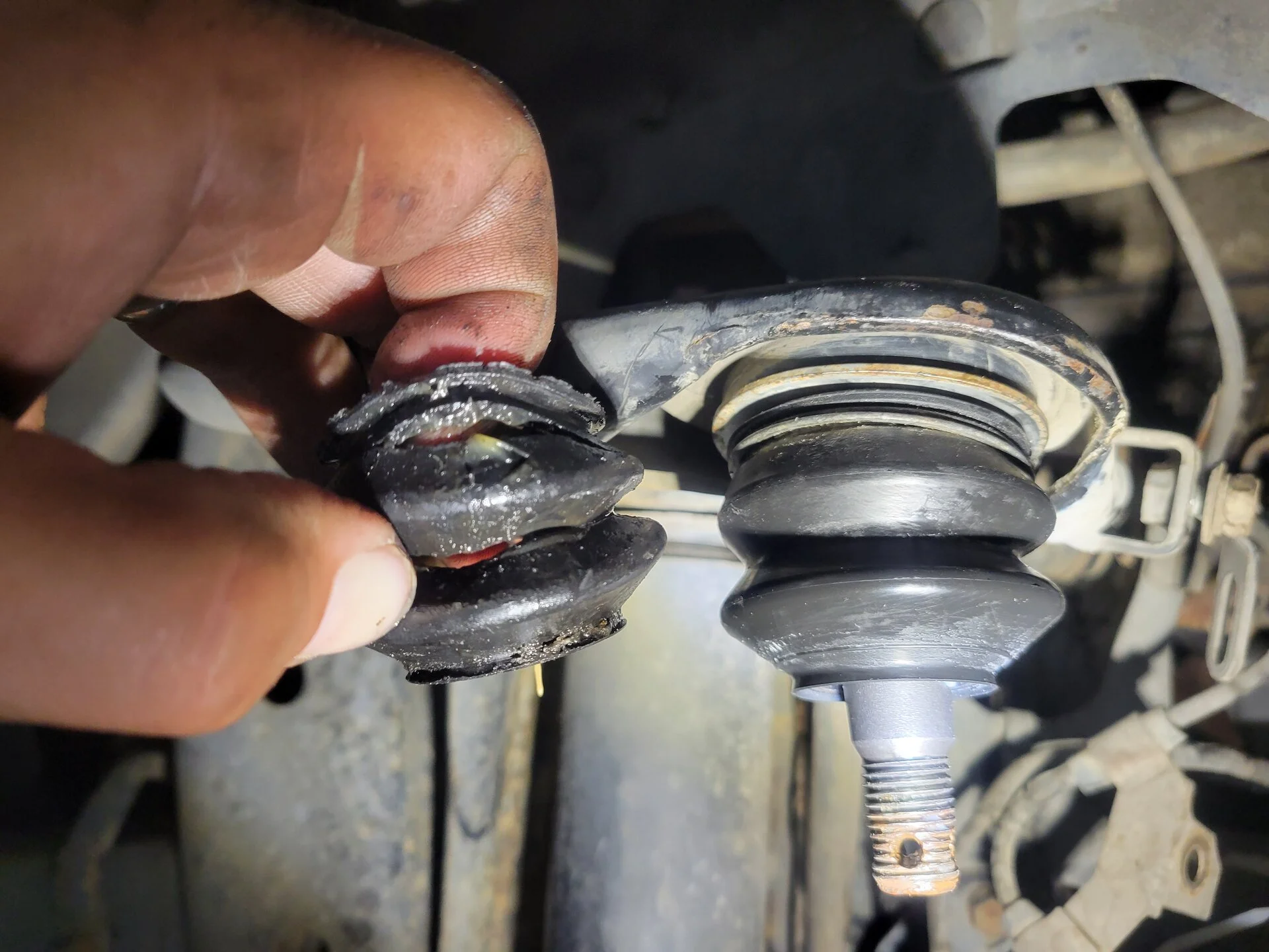

Went ahead and re-booted my driver side upper ball joint this morning. I bought four kits as I thought my passenger side was torn too (one kit for each side and a spare for each side in case of a mistake/tear during install, they are only $6 each), but closer inspection shows it was fine.
Removal and install went pretty smooth. There was a little grease left in the boot but not much. The ball joint felt pretty good, so I'm glad I did this versus replacing the entire thing.

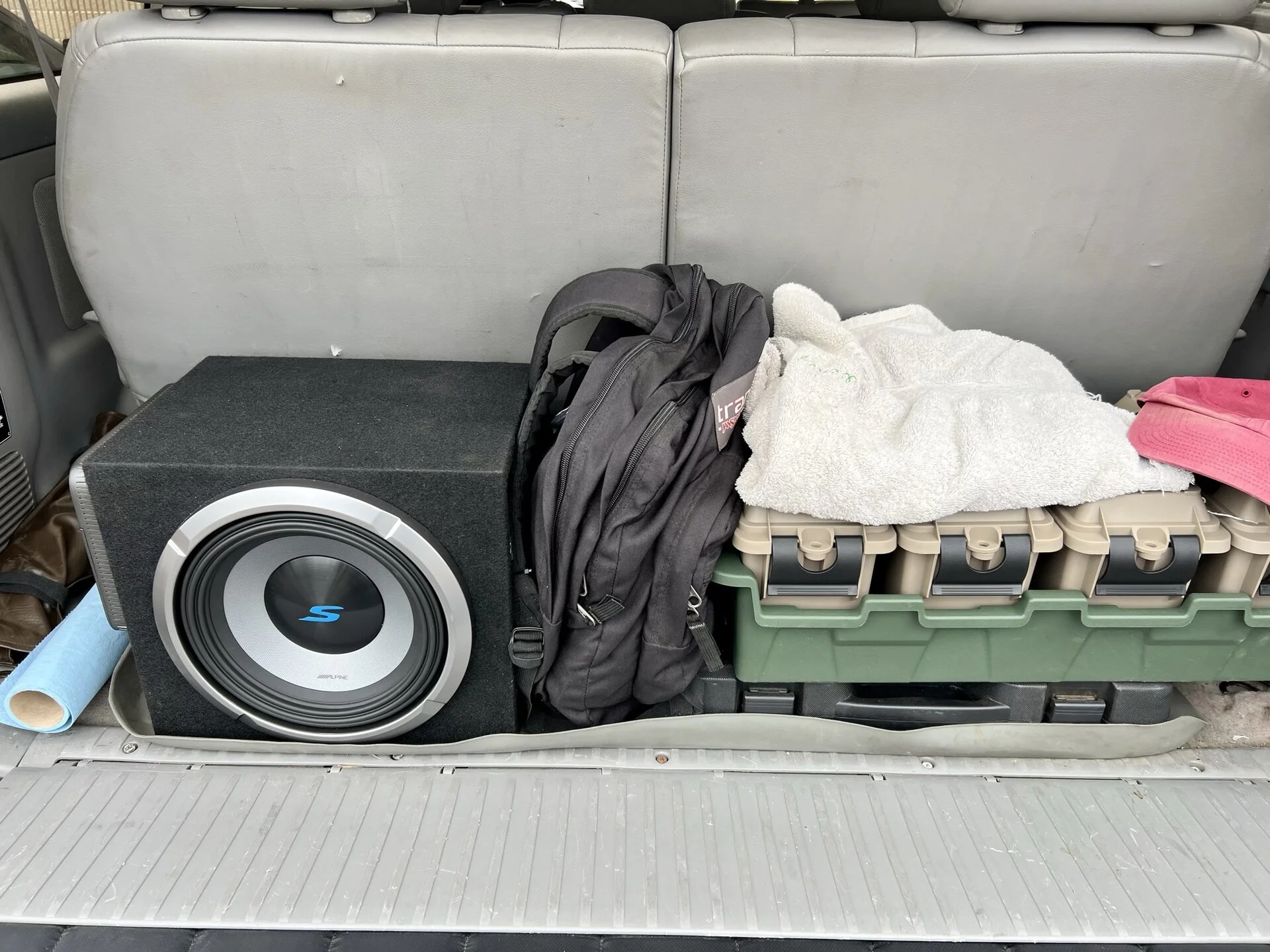

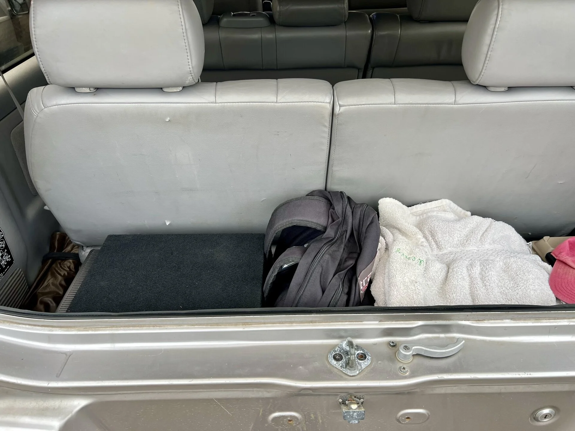

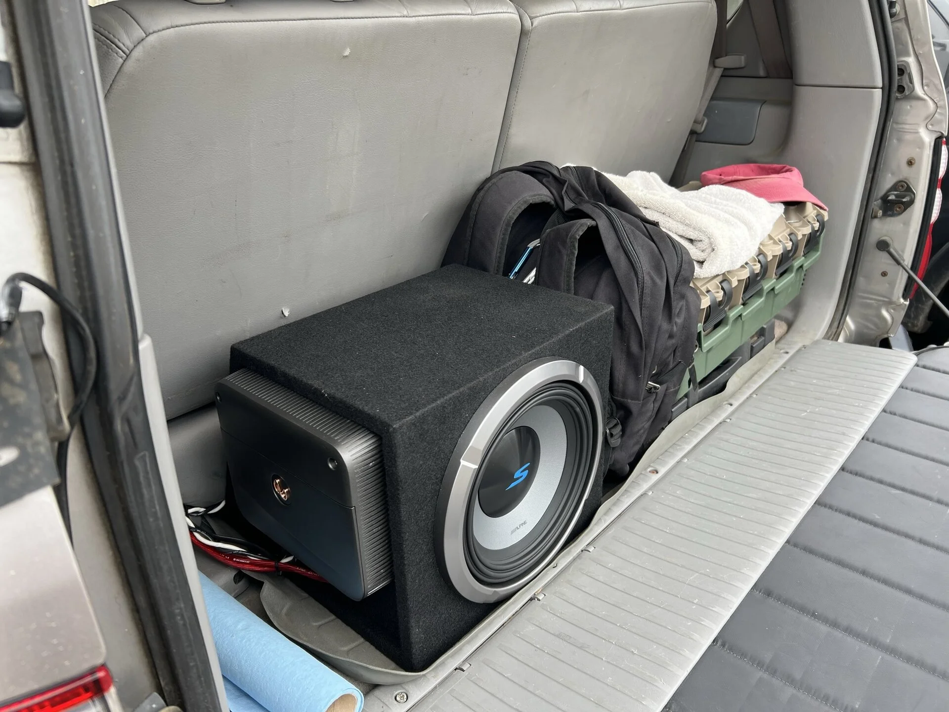

I upgraded all the speakers with Focals (including a cheap Pyle DVC 'sub') a number of years ago, but have never been satisfied with the bottom end. So after picking up a Metra 10" sub box on clearance ($15!) from Best Buy a month or two ago, I ordered a subwoofer that would work nicely in the boix and an amp to drive it. I just bypassed the subwoofer (removed the Pyle completely) and extended to speaker lines to the amp for speaker level inputs. Sounds fantastic, can play much (much!) louder than I need, but extends the bottom end cleanly.

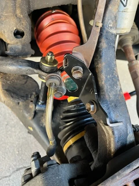

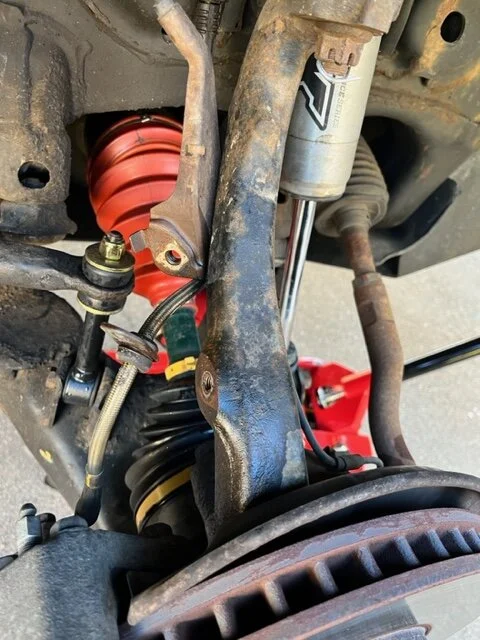

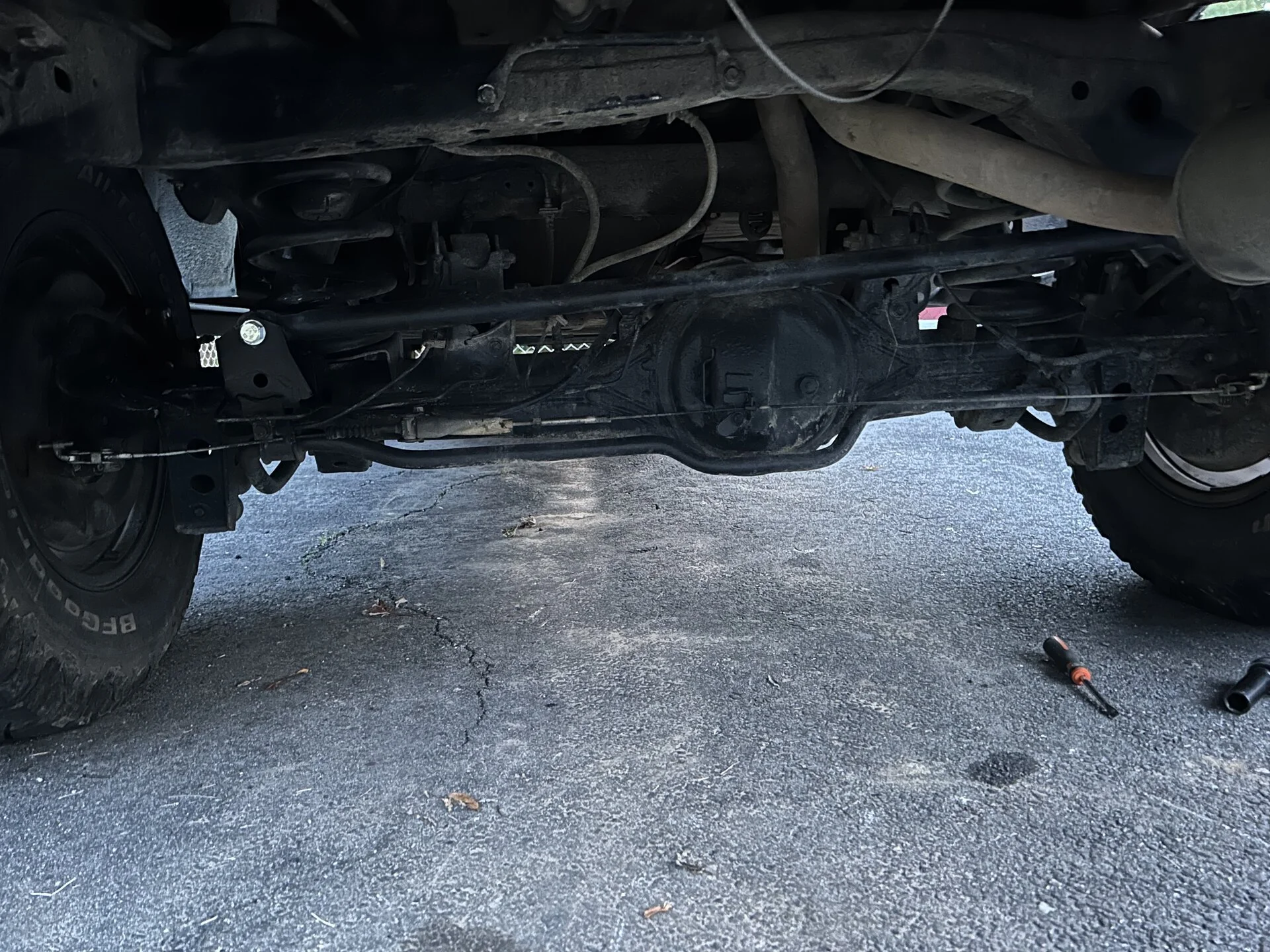

Eimkeith panhard bar correction bracket welded on. So far so good! First structurally important weld. The angles were hard with the mig.
