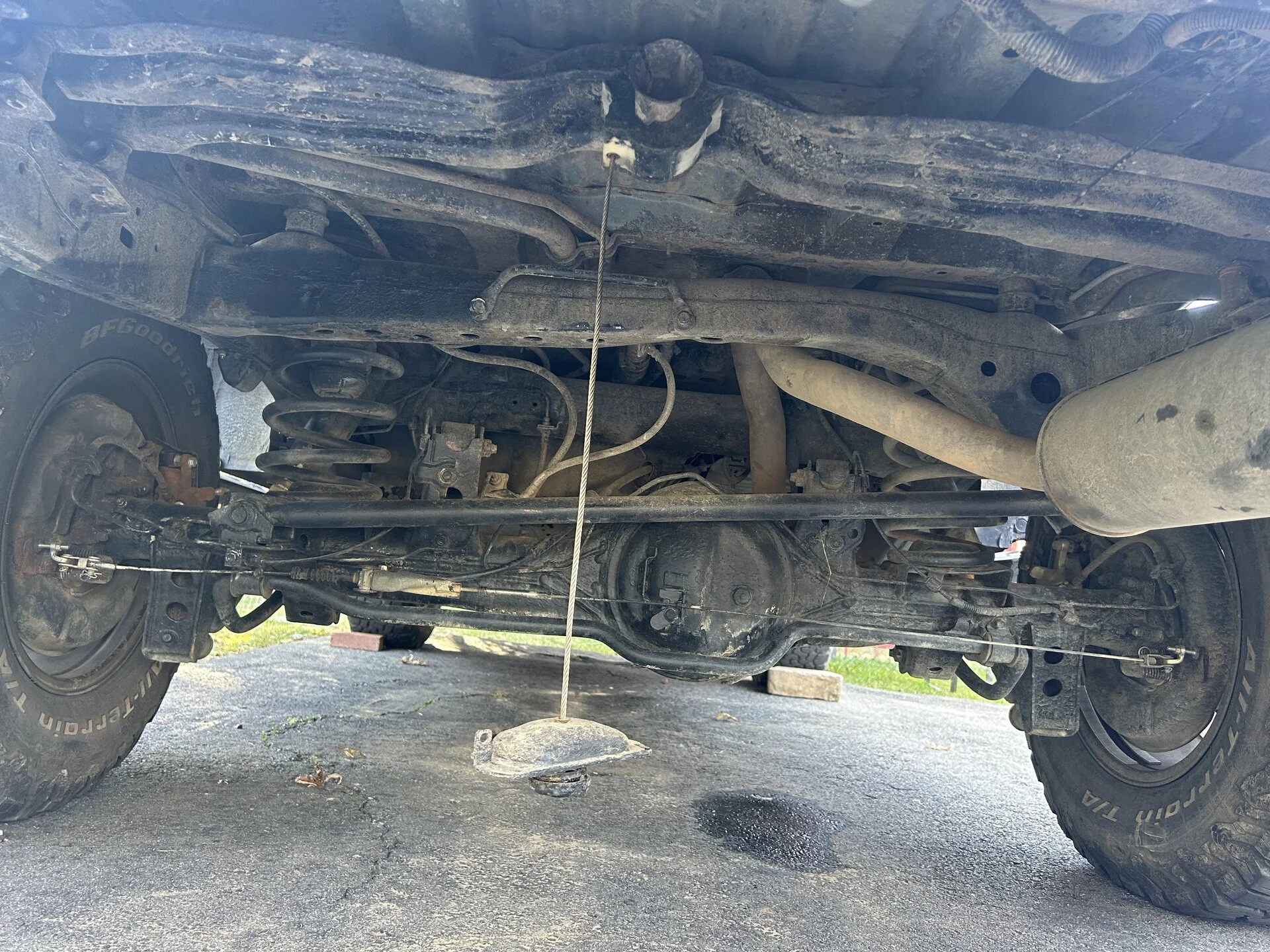

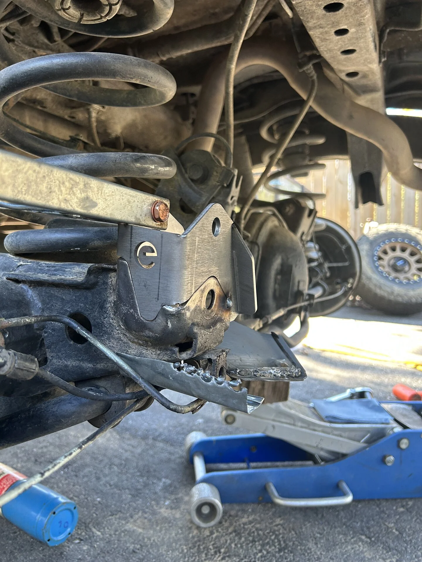

This uses the stock panhard bar, right?
Did use the new, lower hole in the upper/frame-side mount?
Yes stock bar. I raised the axle side mount 2 inches with the new bracket. Didn't do anything to the frame side mount although the kit came with another bracket to lower that side an additional inch if I want to in the future. The bar is fairly level at this point.

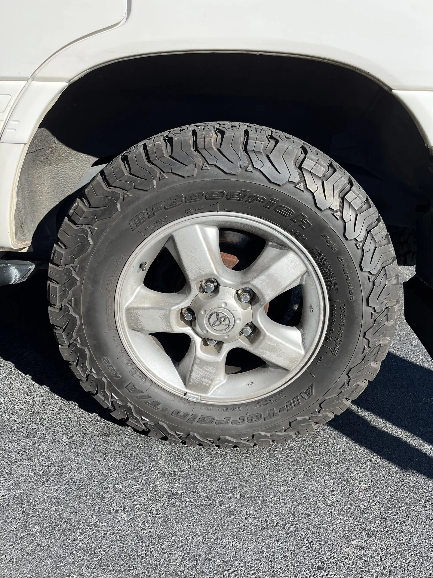

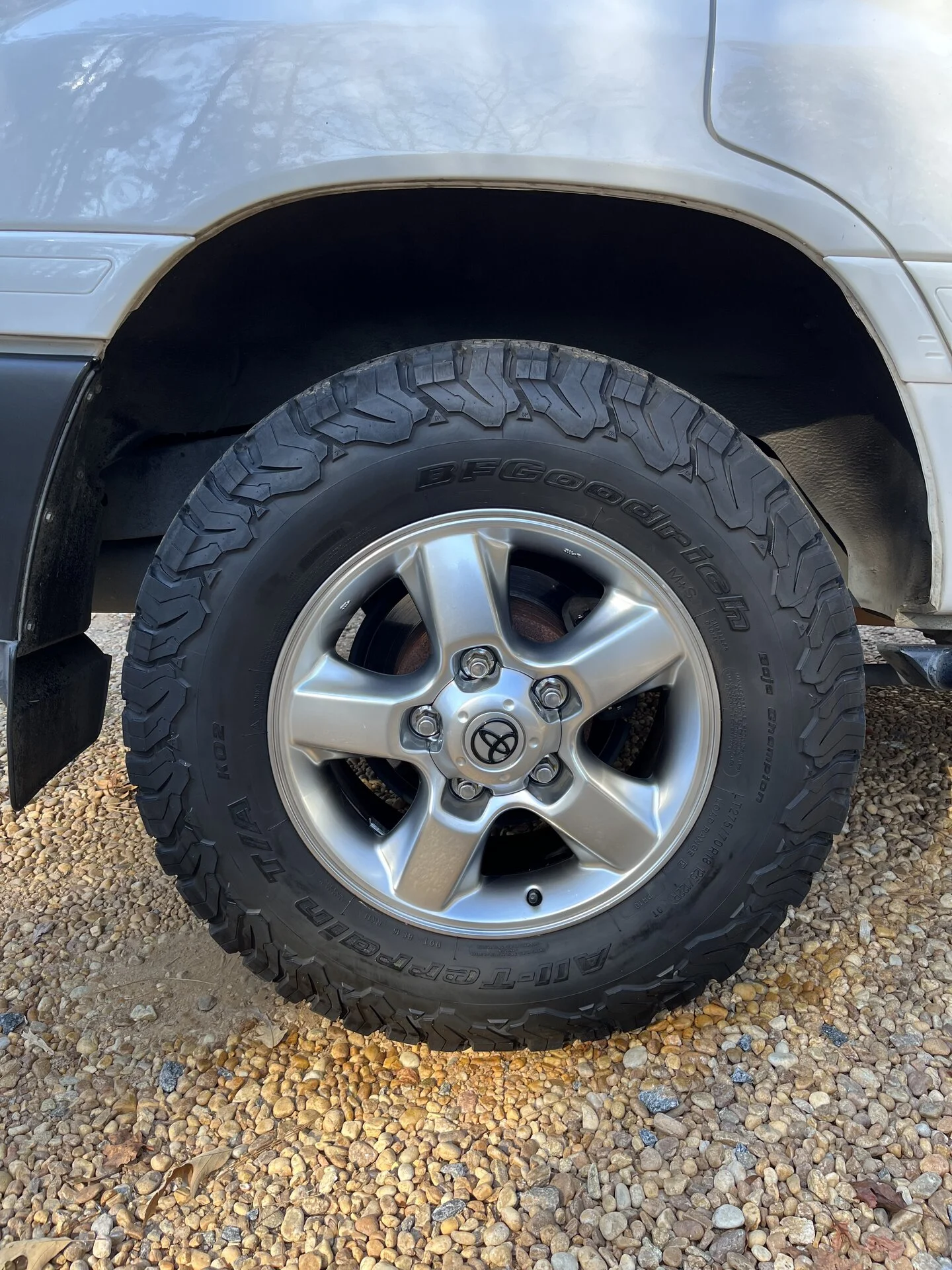

I’ve always liked the later year 100 series OEM wheels but mine were faded, stained and scuffed. Had these powder coated in hyper silver. Really happy with the results, including the black out on the cap logos. If you’re in Atlanta and need wheel refinishing, I’ve got the guy!
Funny, I just pulled over into a random parking lot to talk to a guy doing a mobile refinishing and repair to somebody’s wheels. Mine need it something fierce. Got rust starting around the valve stems and chips and scrapes all over them. How much did you end up paying? Just a ballpark so I’ll know what to expect! Those look great BTW
$150 per wheel. Hard to imagine a mobile refinish since they couldn’t remove the tires and stems. It would probably be more of a touch up. Hopefully cheaper though!

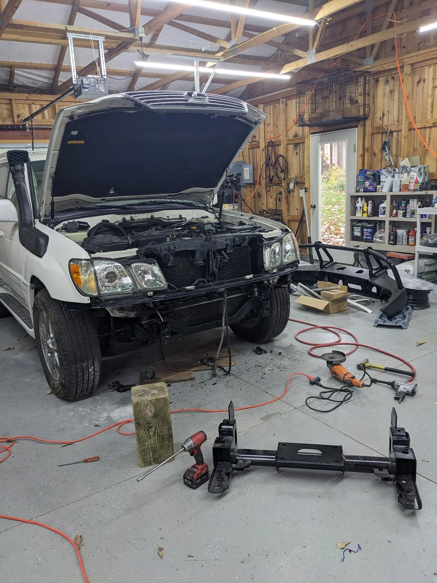

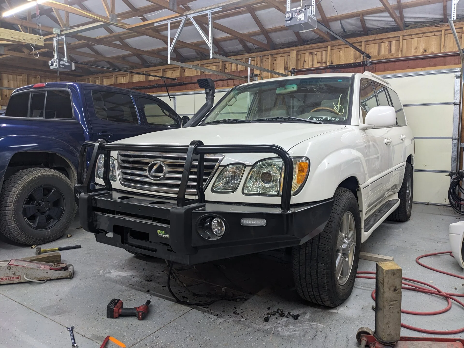

I made the final adjustments to the bumper and drilled the final 4 holes that pin it in place. Ceramic coated the freshly buffed headlights as well.
That’s not bad! Yea he recommended actually bringing mine into the shop to do them since they had so much pitting.
