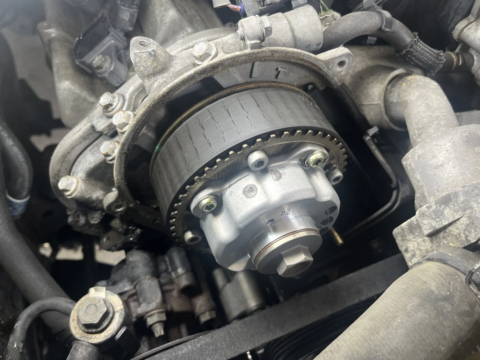

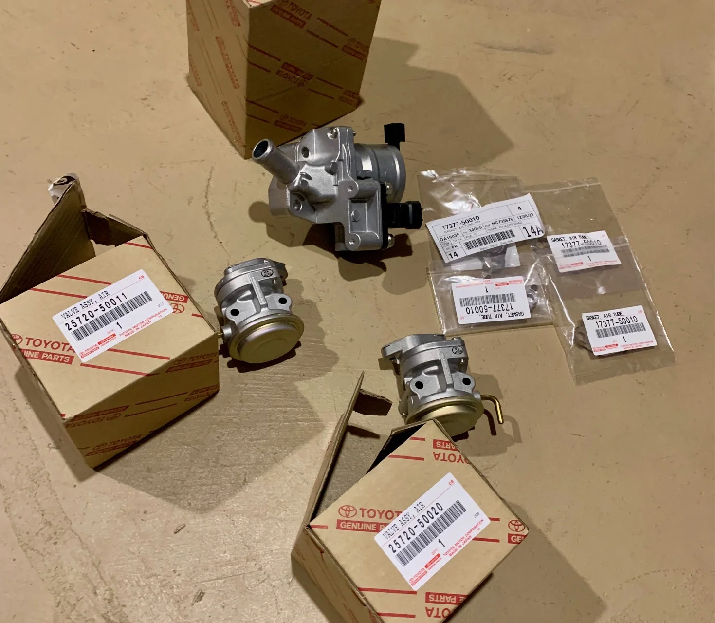

Cleaned out the bypassed and stuck Sai valve and added a filter to the pump (even tho it's blocked off and bypassed)
Picked up a topside creeper for this job and it was WELL worth it. Highly recommend getting one.
About 2 years ago I replaced my SAI pump and I swore I'd buy a topside creeper if I ever had to pull the intake again. Fast forward to last winter and I start throwing an SAI valve code when the temps were below 20 degrees. Once spring came and temps rose, the issue went away so I've had all this on the shelf since for about a year. I need to bite the bullet and replace this junk before it's too cold in the garage, which topside creeper did you end up buying?
#vvtiproblems

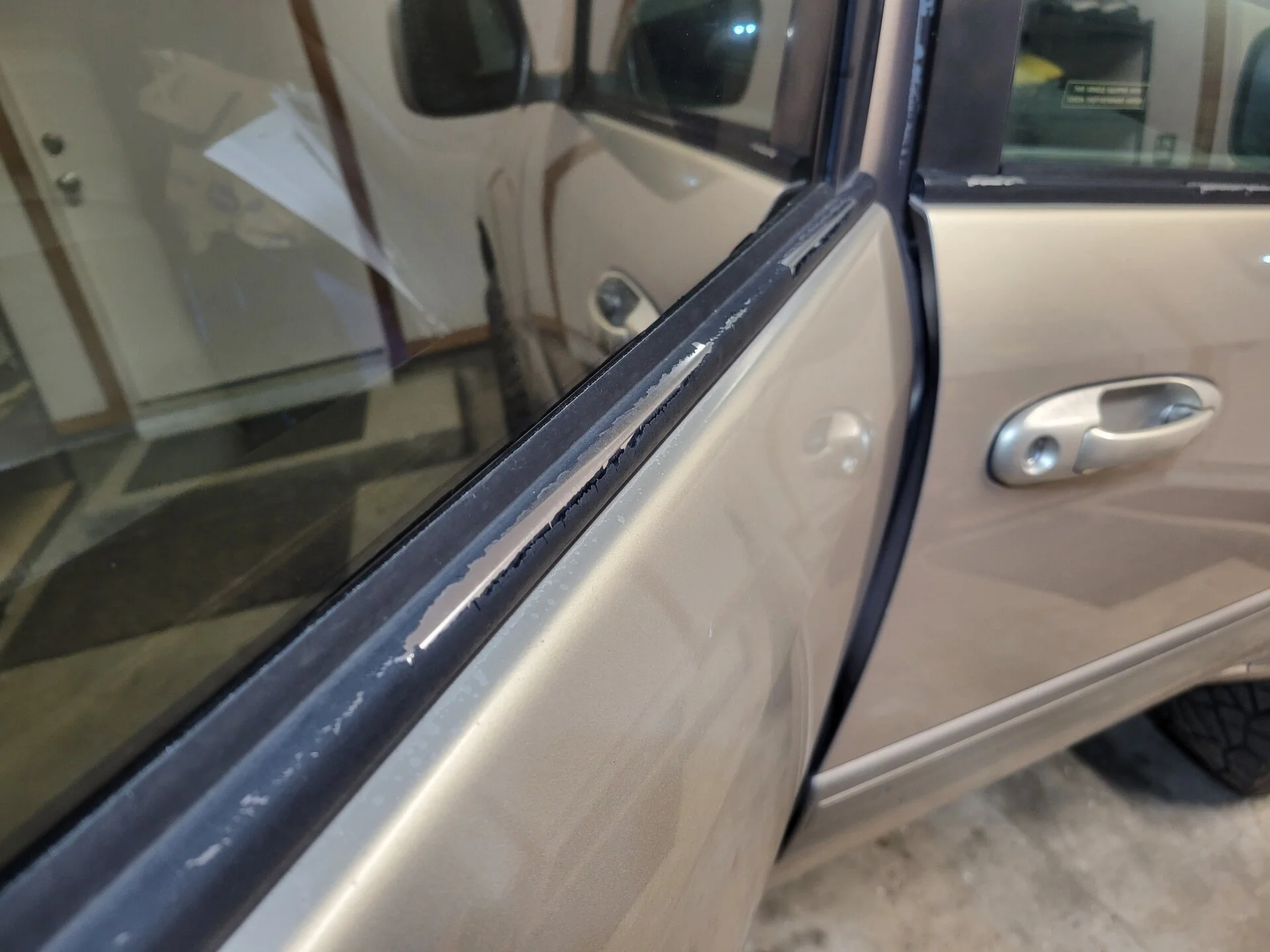

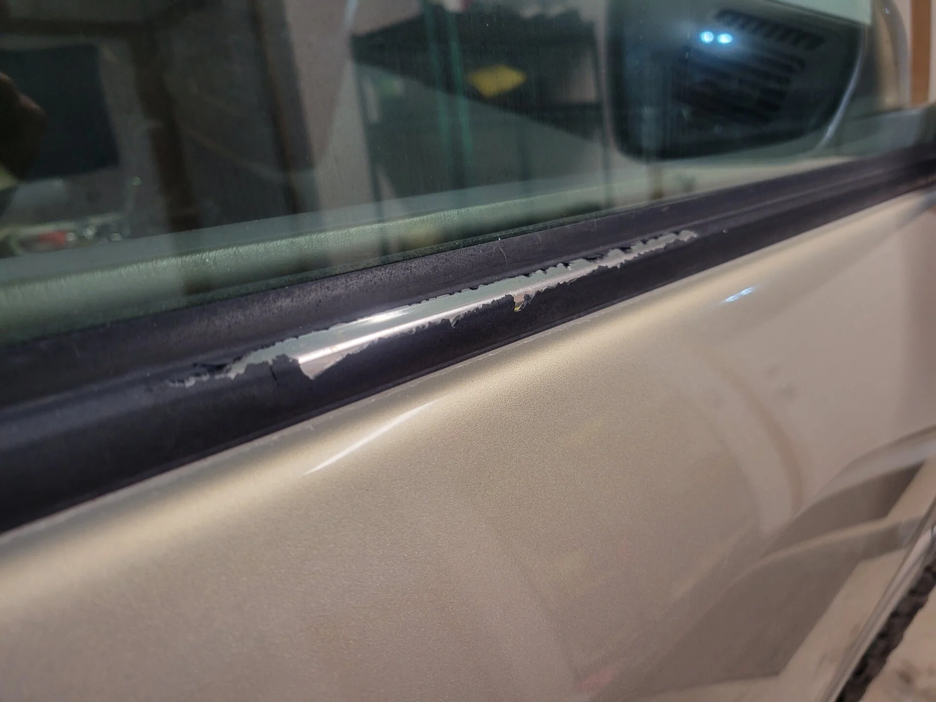

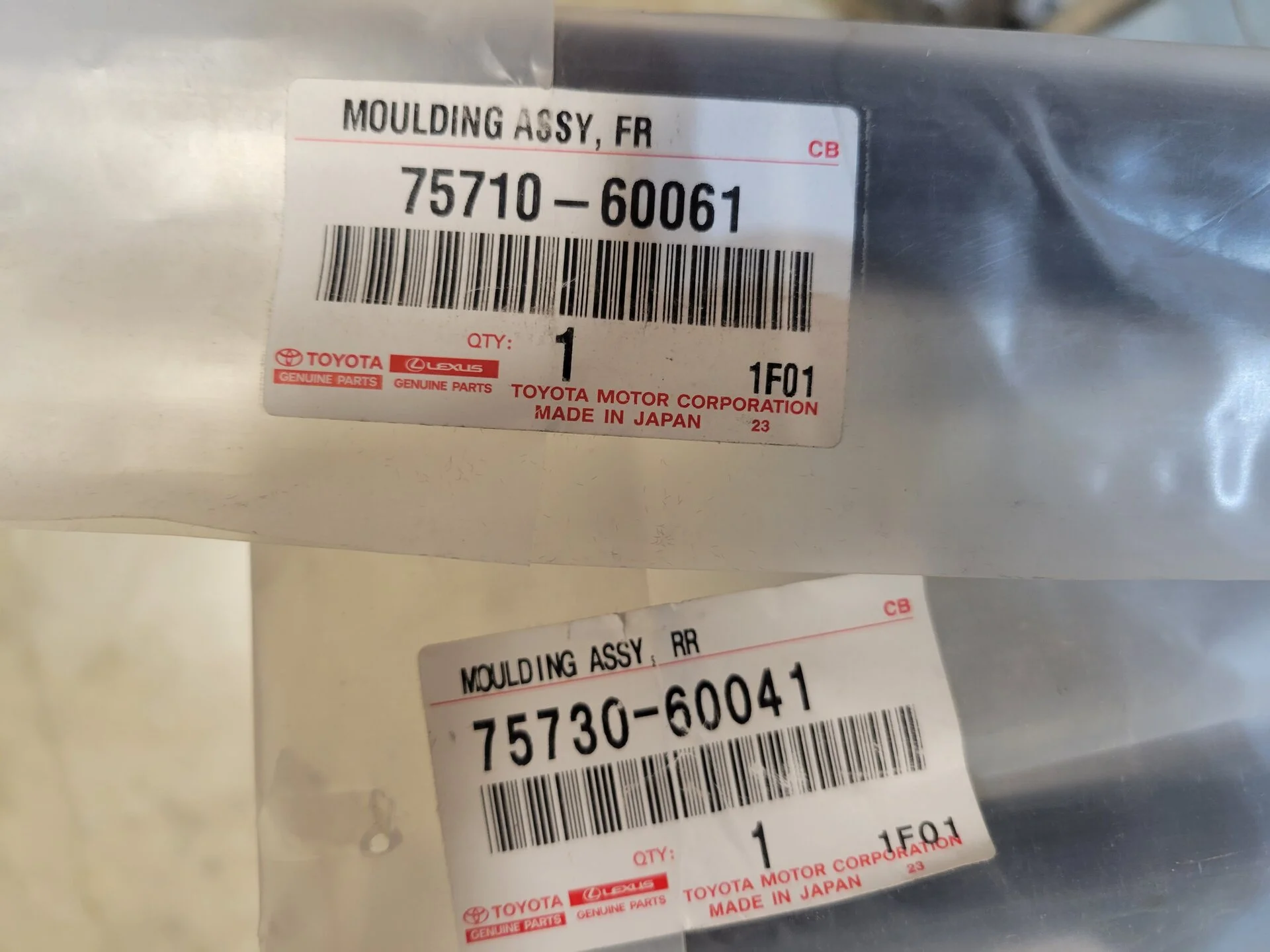

Recently had the itch to do some type of repair/fix that wasn't essential or mechanical. So I decided to replace the trim below my passenger side windows. Mine was cracking really bad and made me cringe every time I washed the truck. Super easy replacement. Drivers side is in decent shape still. Didn't take an after photo.
At the same time I ordered new boots (4332469085) for my upper ball joints. Will hopefully tackle those soon.

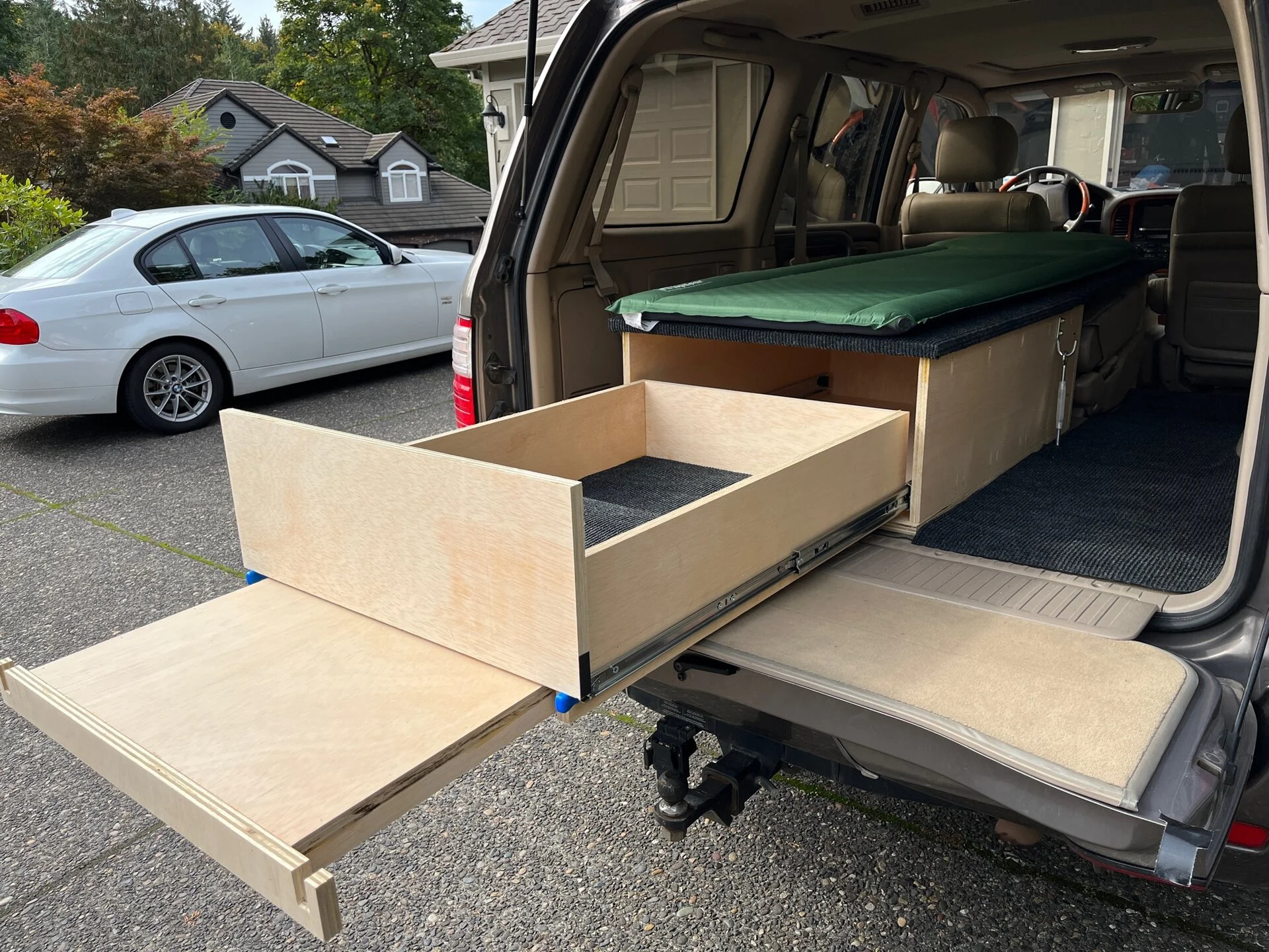

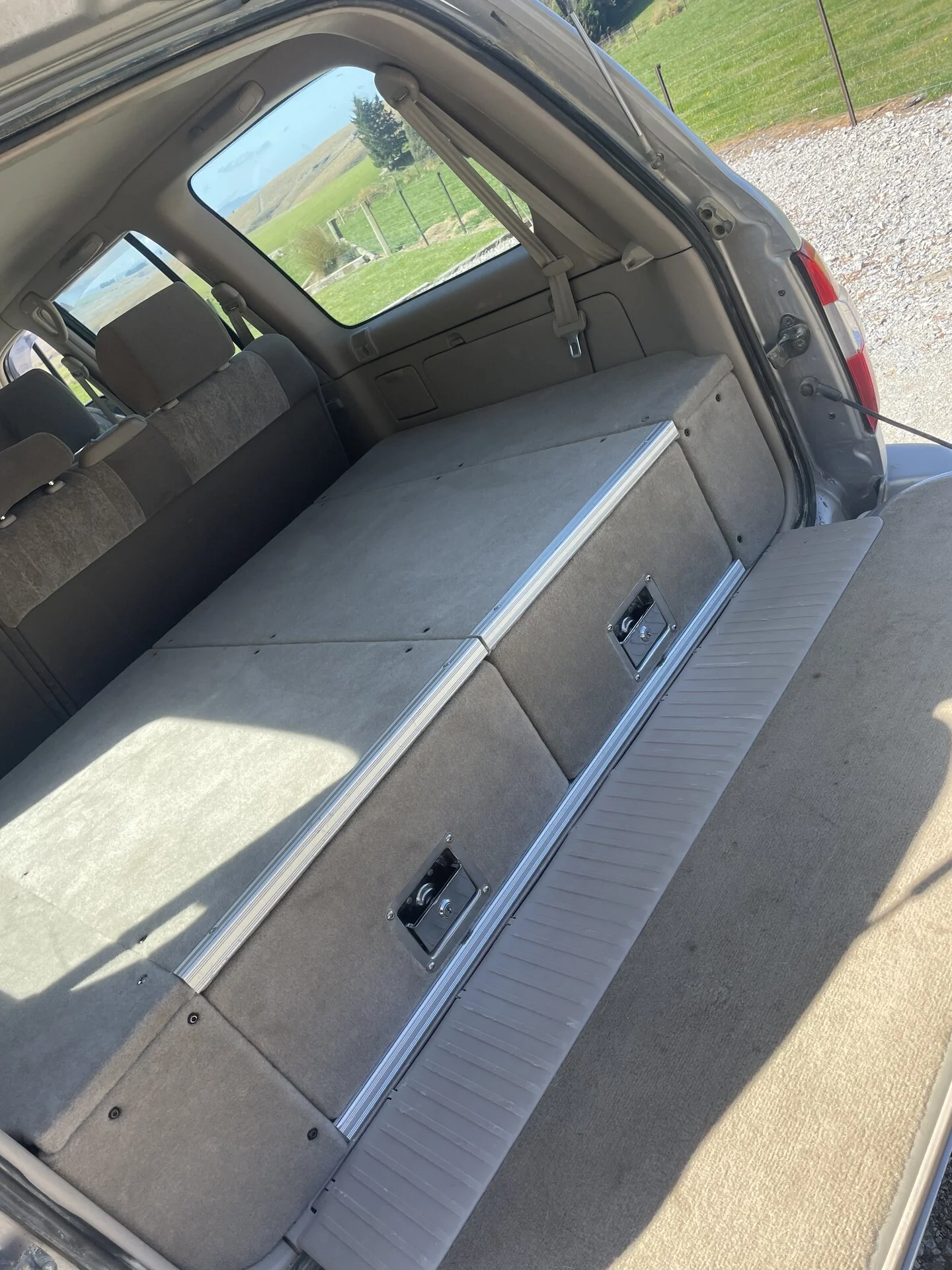

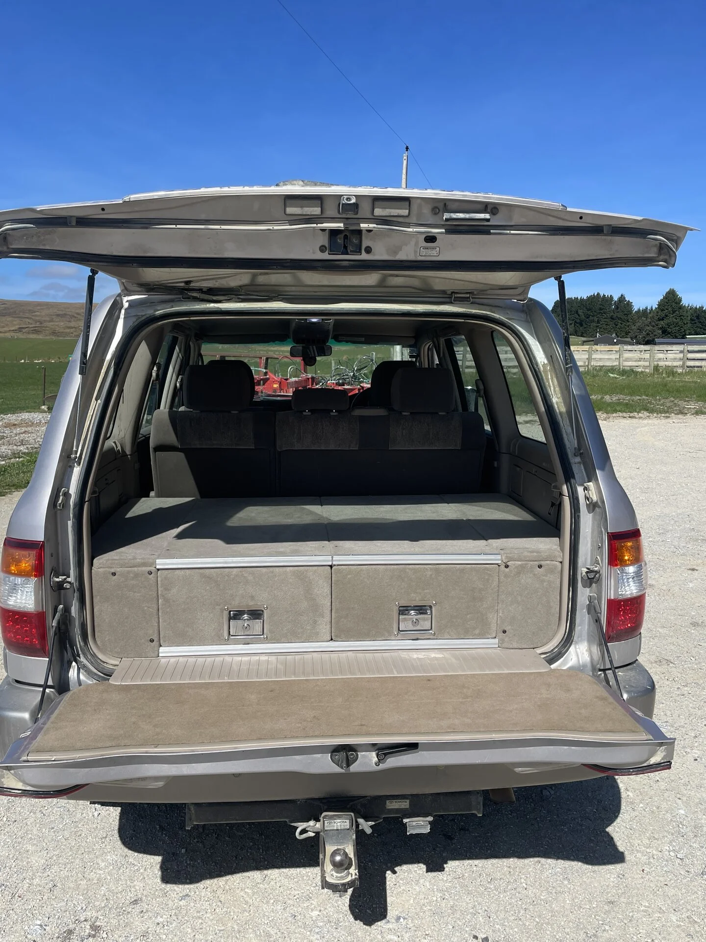

For fall camping, desired to sleep in the vehicle instead of a tent. My 'quick cot' solution got a little more complicated than originally expected, but I had lots of envy from the tent campers when we were hit with a big rainstorm on the last night. Platform is in 2 halves, so front can easily be removed to allow the seat to fold up.
Presume you are single?
