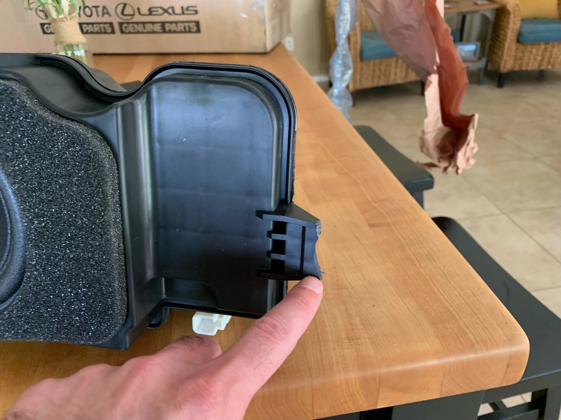

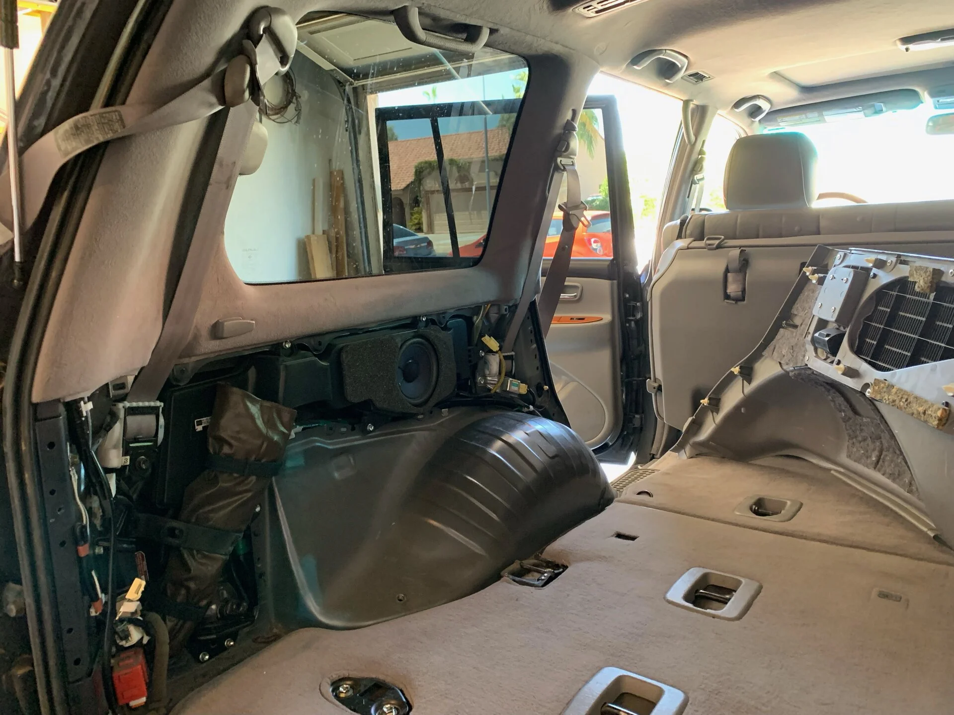

Subwoofer blew out after a wedding. We had a DD and during the ride home we we're blaring tunes and singing like a well-rehearsed choir....
After 17 years of loyal service, I guess we were too much for the ol subwoofer. I looked at a few options. The local speaker shop was like a half-eaten bag of chips...close to worthless....and dealership pricing for replacement was laughable. I ordered a new subwoofer from LexusPartsNow. Unfortunately, I did not realize that one of the plastic mounting brackets was broke until a few weeks after the subwoofer was delivered so LexusPartsNow would not accept a return. Warning to others - if you order anything from this site make sure you open the package and inspect for damage. If I recall, this has to be done within 48 hours of delivery. I'm not going to accept a broken "new" part in my beloved 100 series, so I had to get resourceful. I cut off the bracket from the old subwoofer and did some plastic "welding" using a soldering iron. This worked remarkable well. Check YouTube for a couple videos if you've never seen this. Forgot to take some photos of the finished install but this came together nicely and now the choir is back together blasting melodies for the world to enjoy.

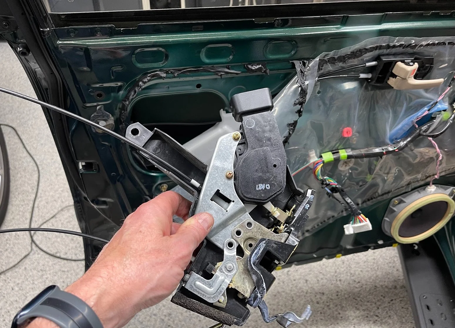

Replaced the complete door lock assembly. I could have replaced the motor only, since the rest of it worked, but the door sometimes didn't latch quite right so I decided to try to replace the entire unit. It's like closing a new 100 door now! :) The old one looked like it was in great shape (below), but I am glad I splurged for the new one. Part number was: AISIN DLT-081
I realized after I took out the old one, that these parts are only for driver's or passenger's sides...I got lucky and accidentally ordered the correct one for the driver's side.

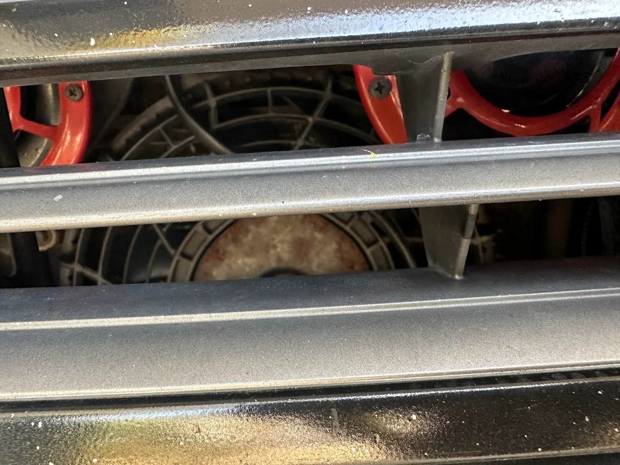

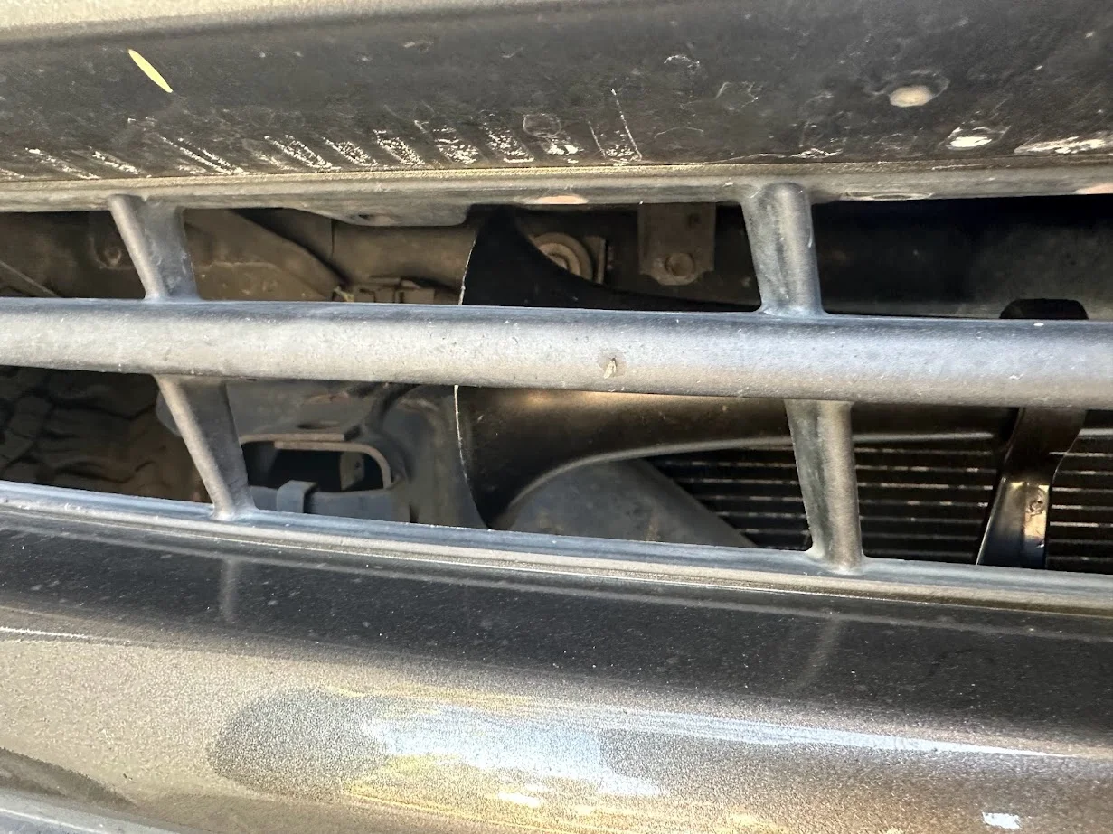

I hooked up an axillary single trumpet air horn for when I need to wake someone up from their slumber at the light. 2nd port connected the electric AC fan for those hot summer days sitting in traffic and the AC cant keep up.

Electric AC fan is now functional
Mounted the single trumpet air horn ontop of the bumper reinforcement bar

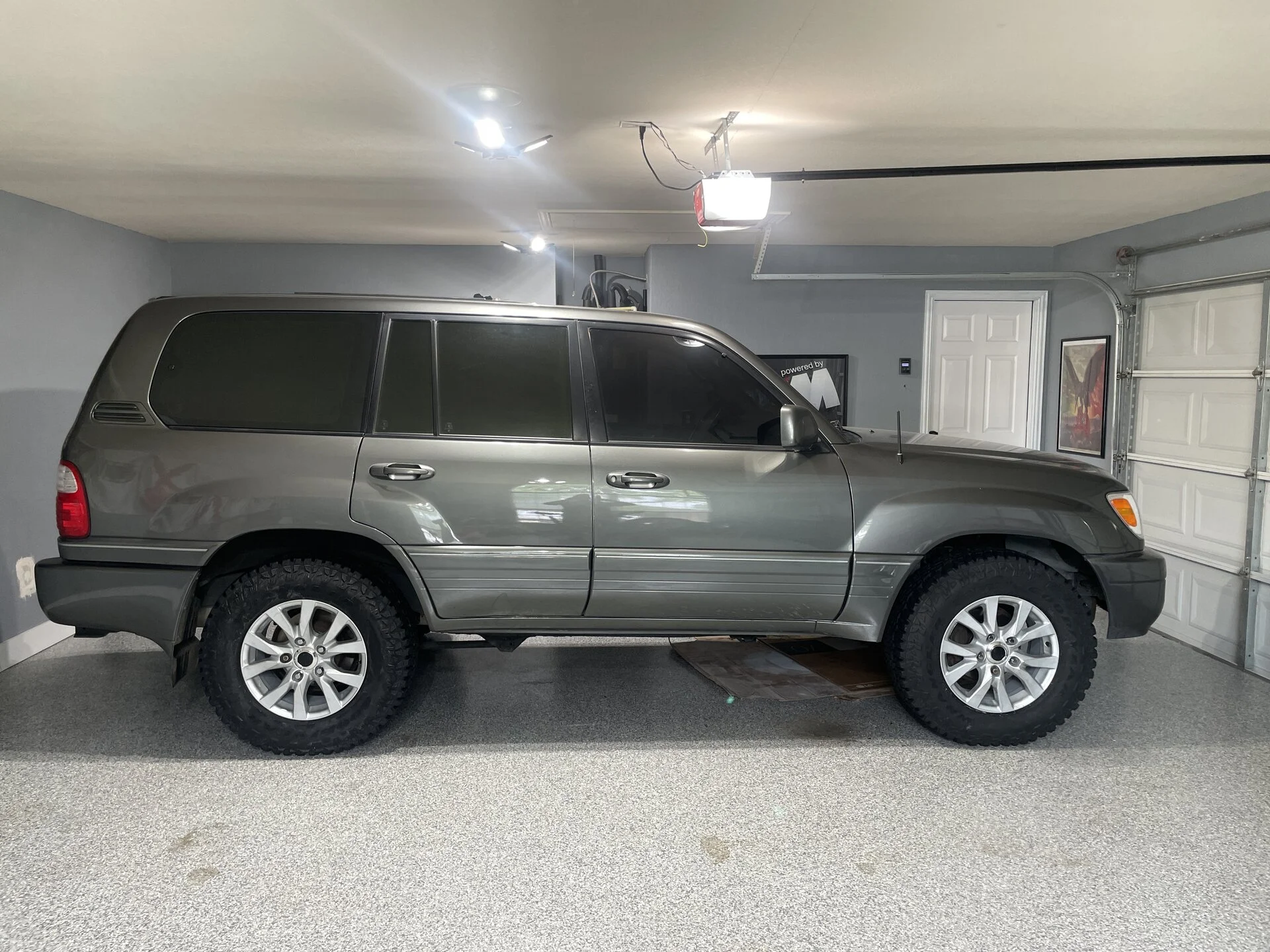

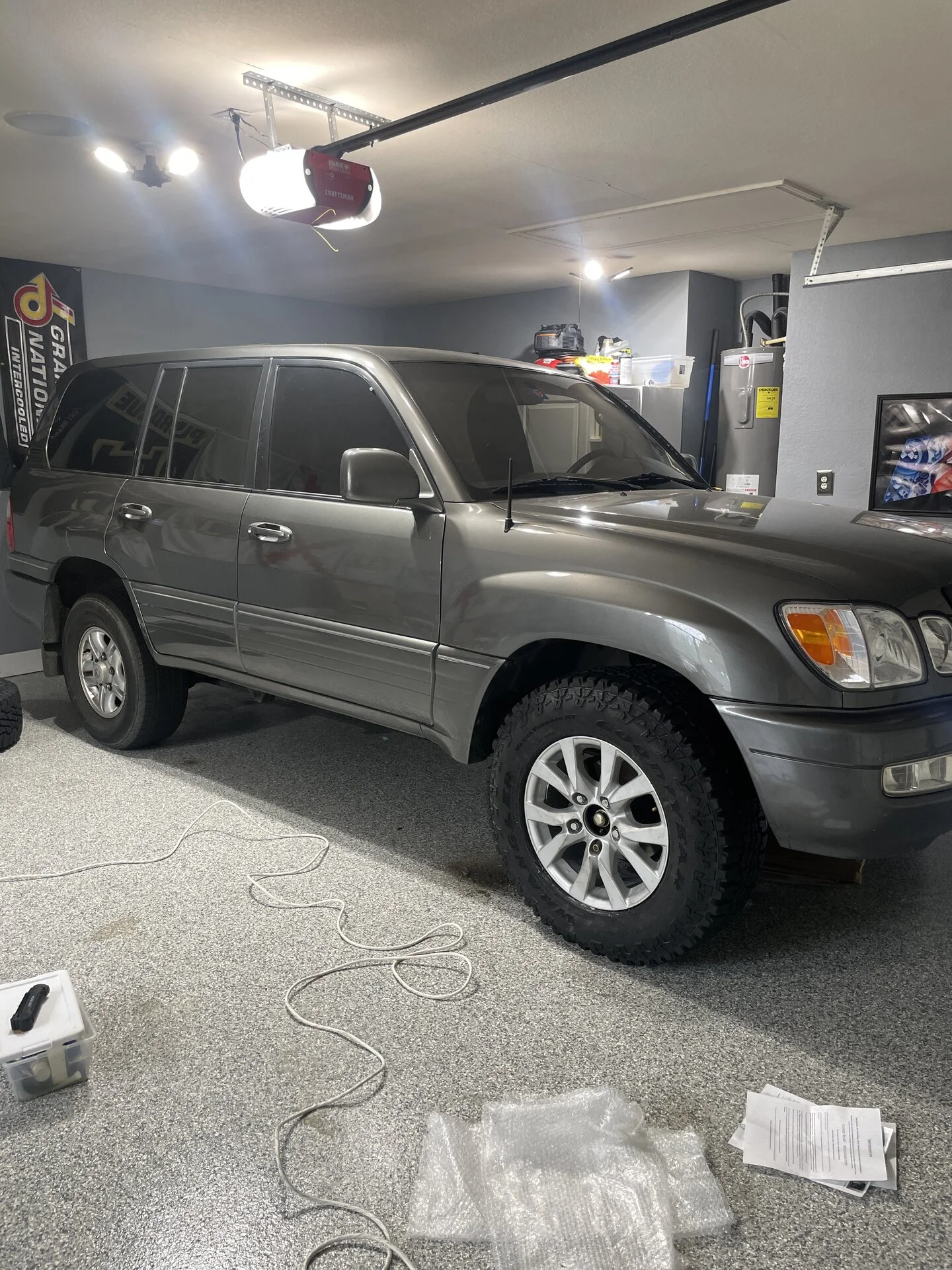

Installed Bora 1.25” wheel spacers, pinch weld mod, and 2016+ Land Cruiser wheels on GoodYear Wrangler Ultra Terrain AT 275/70/18.

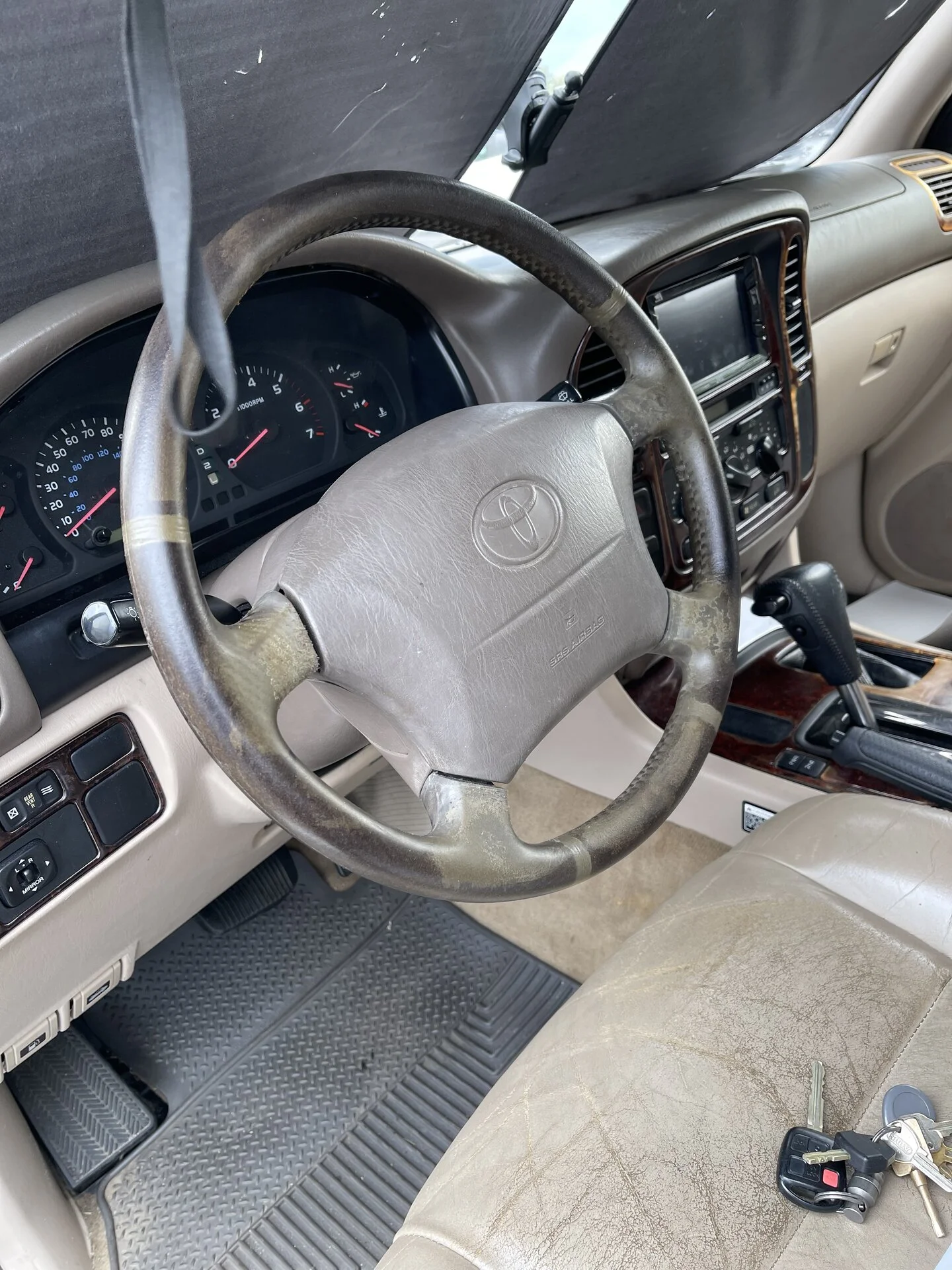

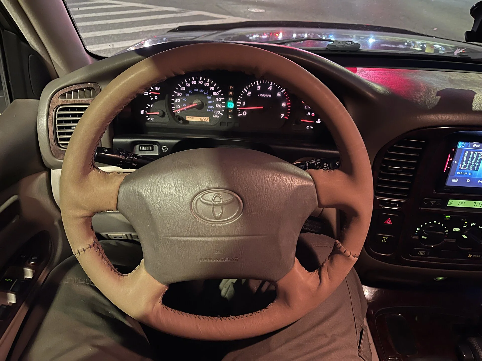

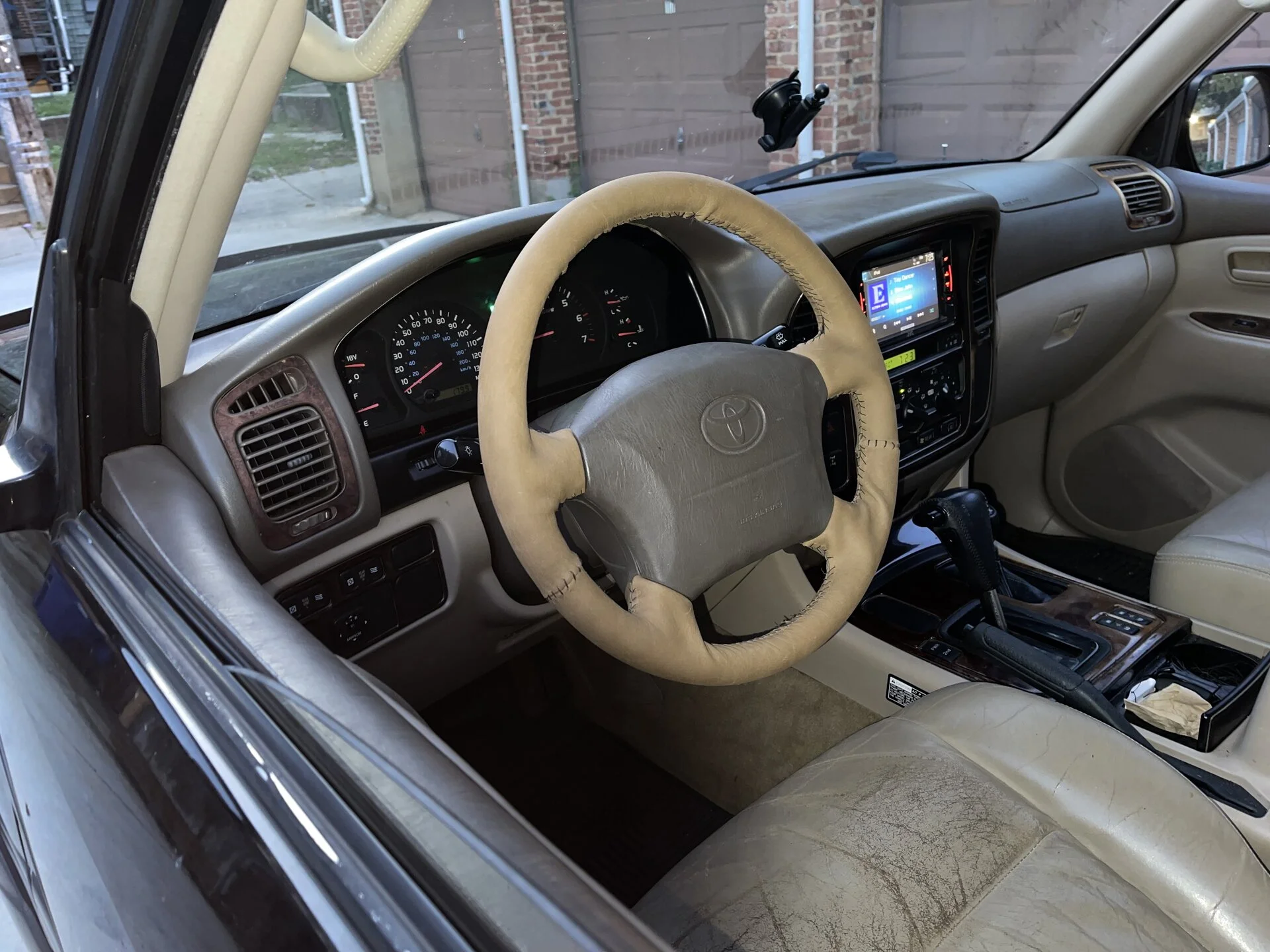

Without a proper template, it is crude with. Imperfections, but it’s comfortable. It’s gonna stay on there and I learned a lot during the process, and I’ve seen worse.
Those are the exact wheels I've been searching for to get for my cruiser! They look really good!!

Good work, it’s not easy. Hit it with a heat gun and quench with a damp towel and you can take a lot of those wrinkles out.
it's HORWEEN leather. I'm not sure if it will work for that. I was thinking of cutting a slit down the back of the spokes to remove a sliver of leather, and then sewing it up tight to tighten the leather around the spokes. no, it was not easy. it took hours.
Update: I ended up just cutting out some veg tan leather shims to shove in behind the leather covering the spokes. it took up some of the loose, and it's a little better. I may have another go at this in a year or so. I'm ok with how it turned out for now.

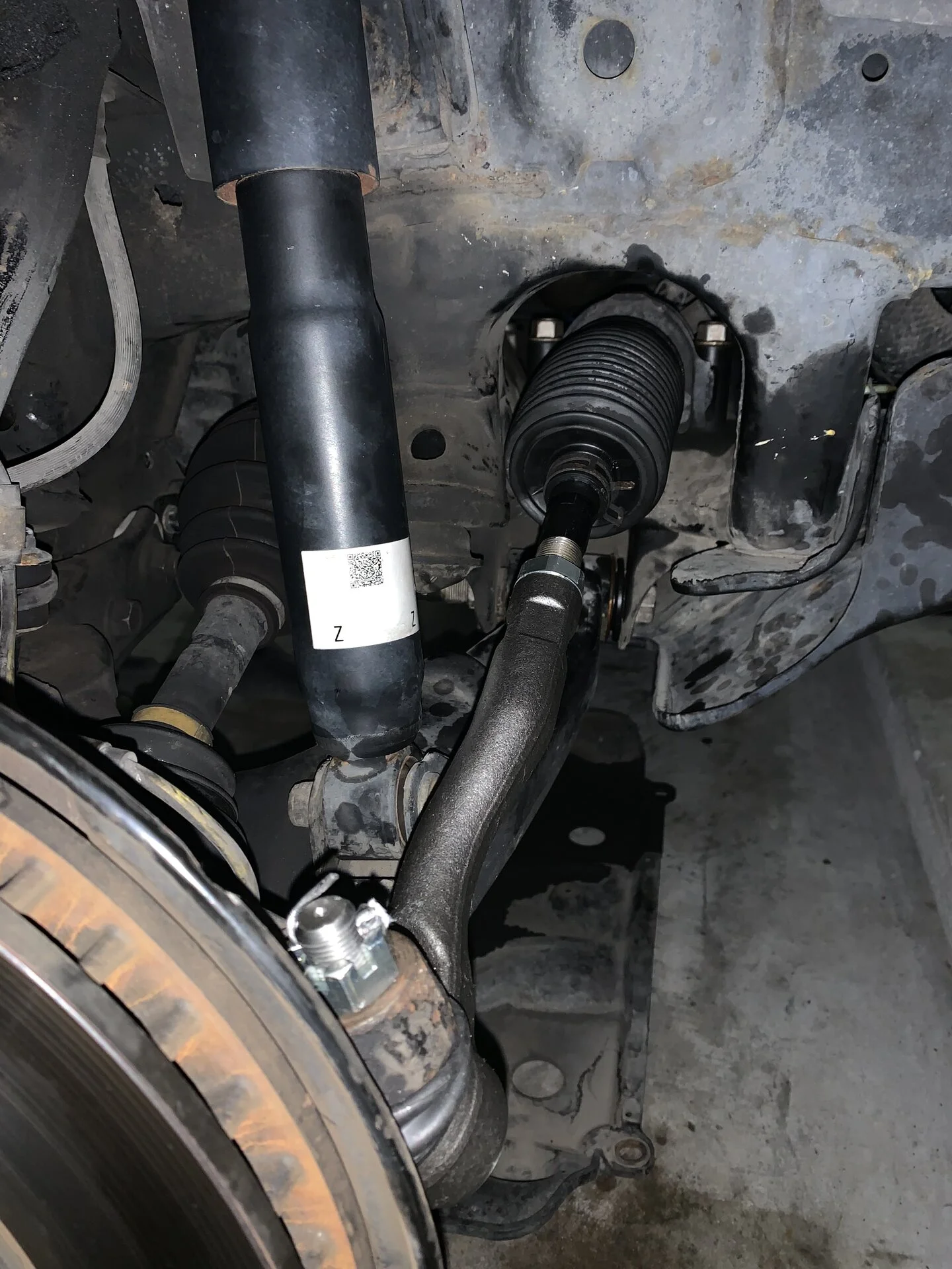

Installed new inner and outer tie rods. Went smoother than expected. was going to do the rack bushings as well but will tackle another weekend.
Question: do I need to paint the outer tie rods or are they ok to leave them how they are?
Paint them. They'll look 100 years old by tomorrow if you don't.
