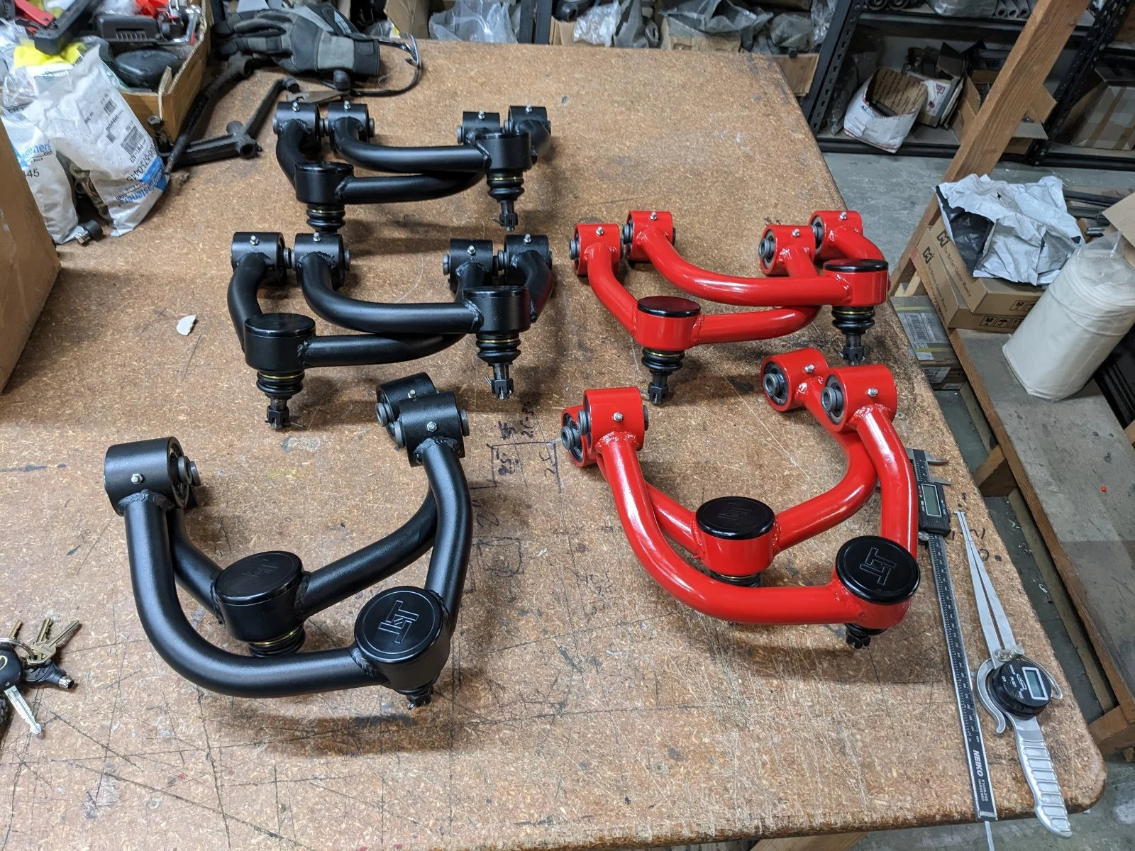

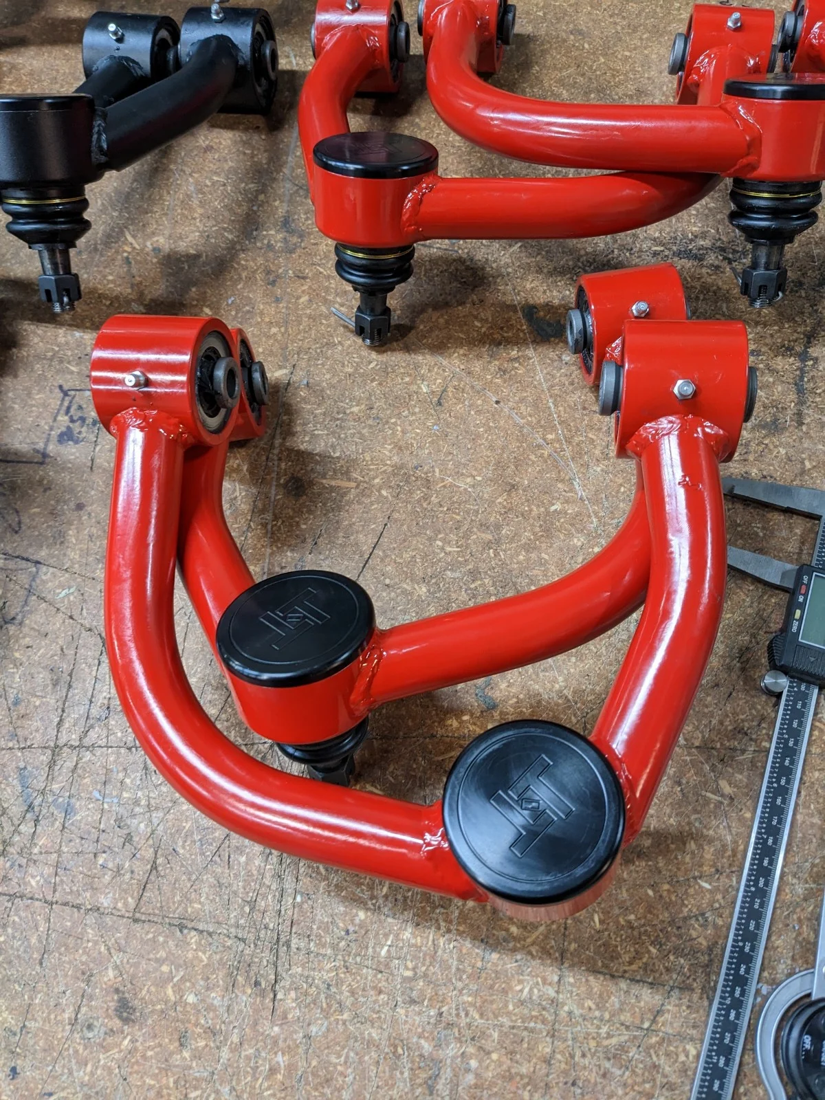

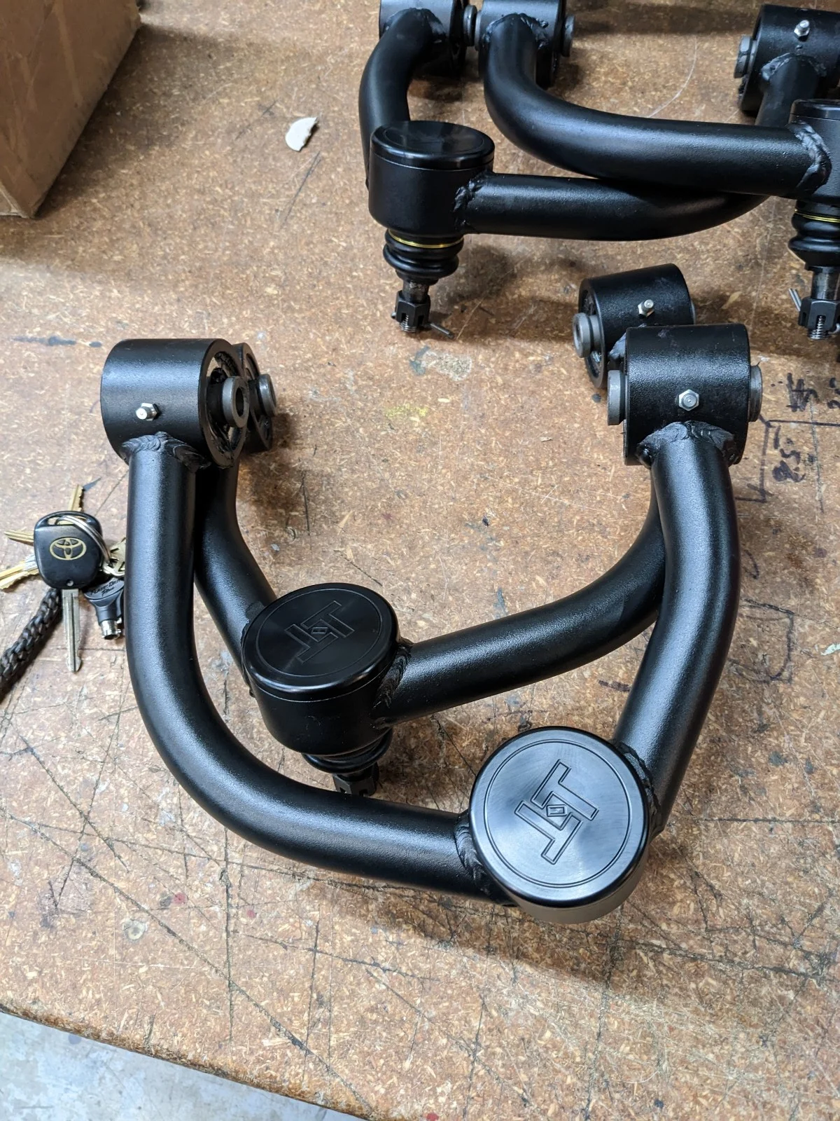

A short run of UCas. @jLB your sets are boxed and ready to go buddy. Thank you.
Jason
The Trail Tailor, TRD/LRD, Trail Teams, Special Edition, Limited Edition, UCAs? Do I also get a certificate of authenticity, and a special dash plaque, for the red ones? 😁
Thanks, looking forward to receiving them.

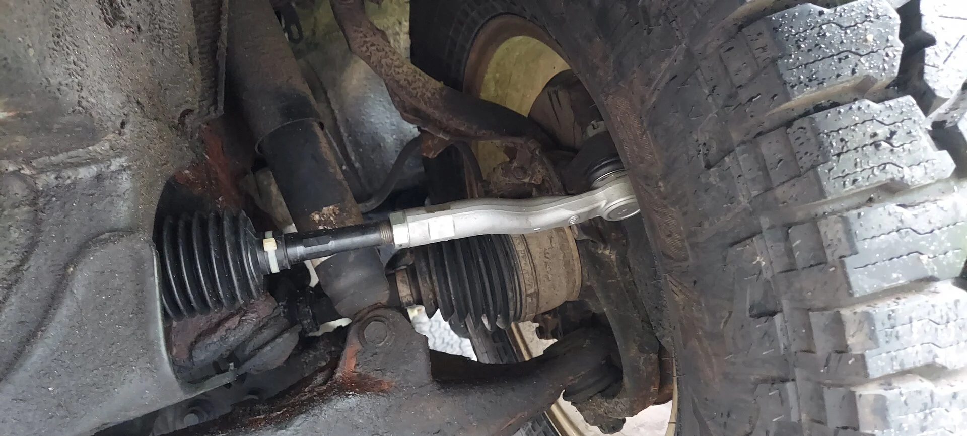

Put in some new inner and outer tie rod ends (SANKEI 555) this week along with new OEM bellows. One side factory bellow had torn and was the reason for tackling this. Due to age, dirt, etc, I cleaned the steering rack with alcohol and re-greased before reassembly.
Had to go with zip ties on the outer edge of the bellow because the old tie rods were very rusted together and no local store (tried 5+) sells 1" constant tension spring clamps... Not happy about it but oh well. The inner edge of the boot (on the rack) reused the original stainless clamp no problem.
Going in for an alignment tomorrow morning to finish everything up.

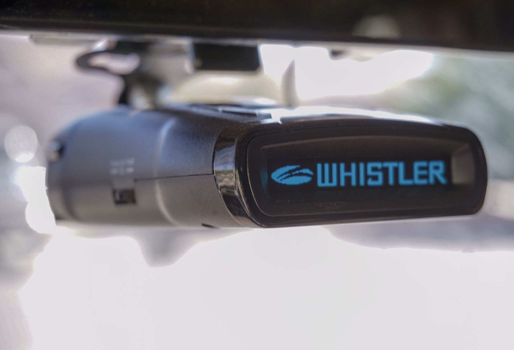

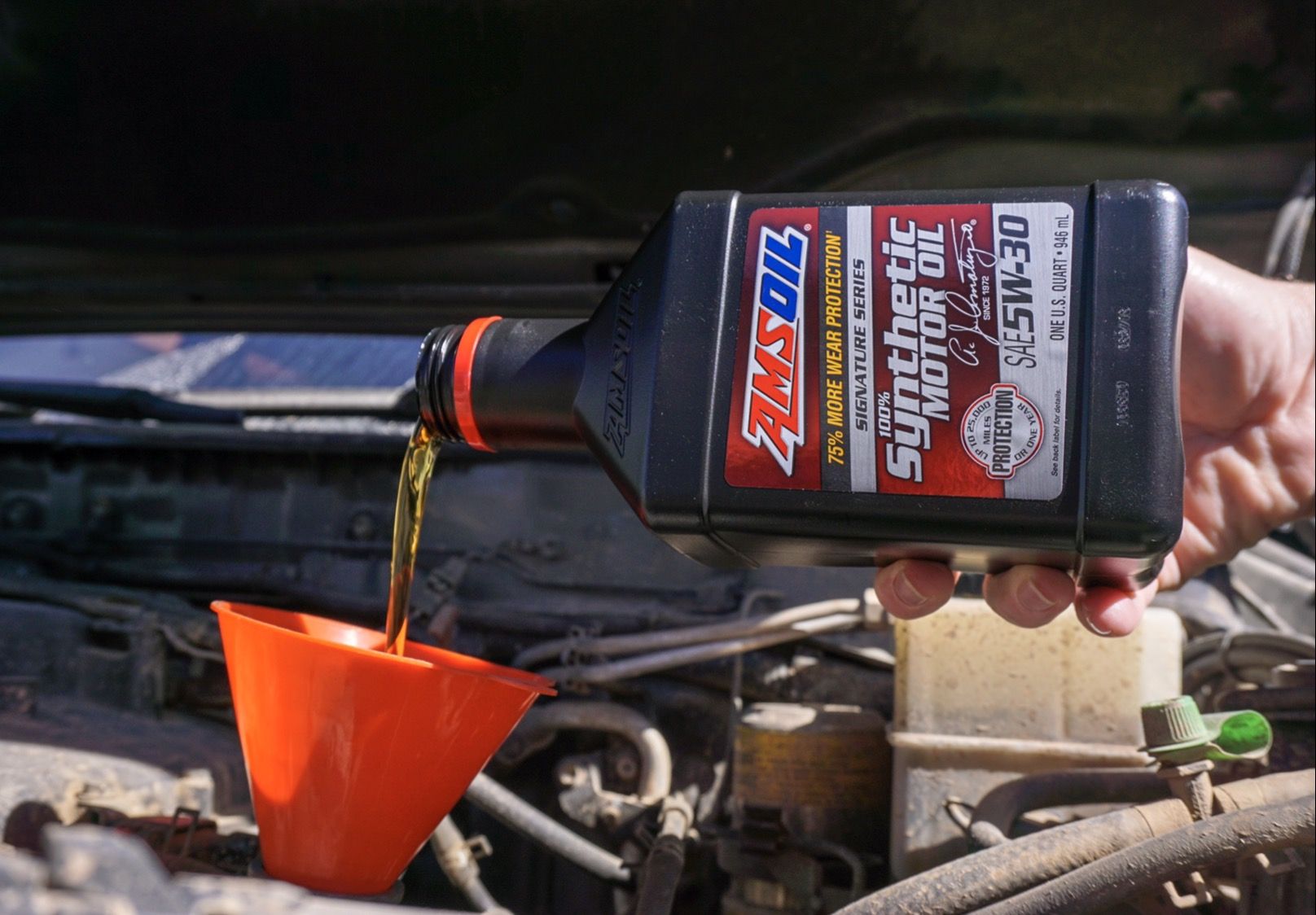

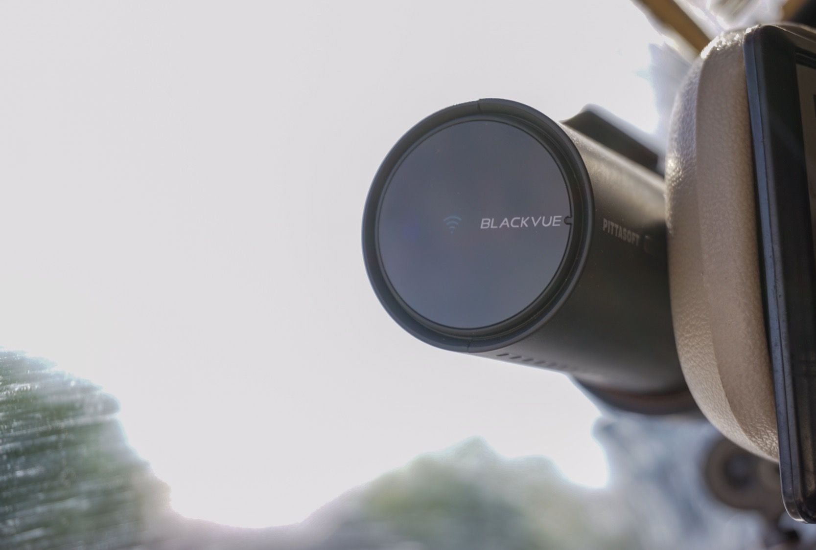

Put in a whistler radar detector. Installed the BlackVue 4K dashcam, and an oil change. Its a good thing I enjoy turning wrenches. I'm feeling beat!
Do you have any tips for a dash cam install for my 2005? The camera kit didn’t come with a fuse so I believe I’ll need an adapter. And patience.

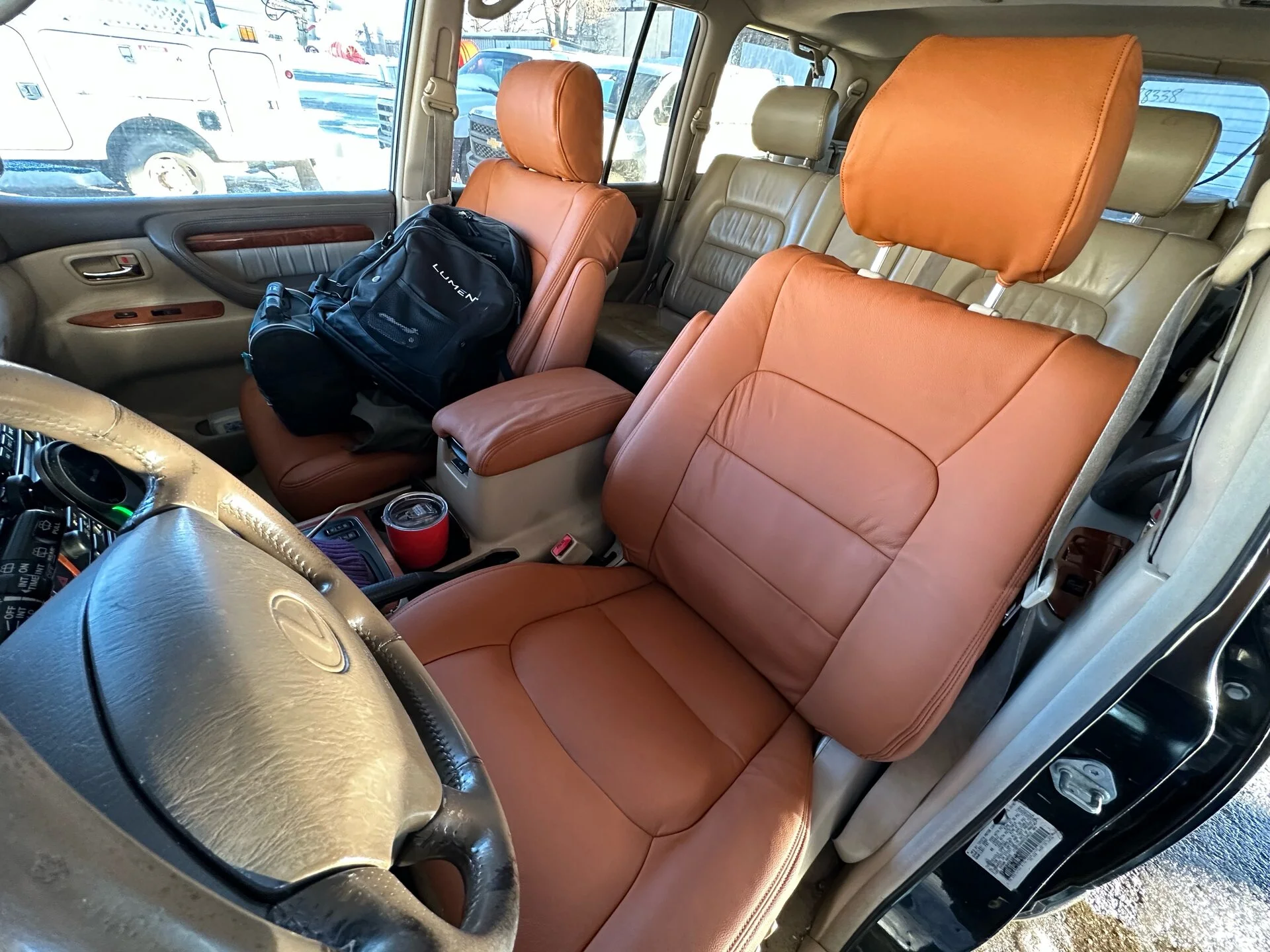

Not this past weekend, but a few weekends back. I was able to replace the worn and torn factory original front seats with new skins from lseat. I received a color I didn’t order but I like how these go with the wood grain color.
With some sun heat, they’re now wearing in pretty nicely.

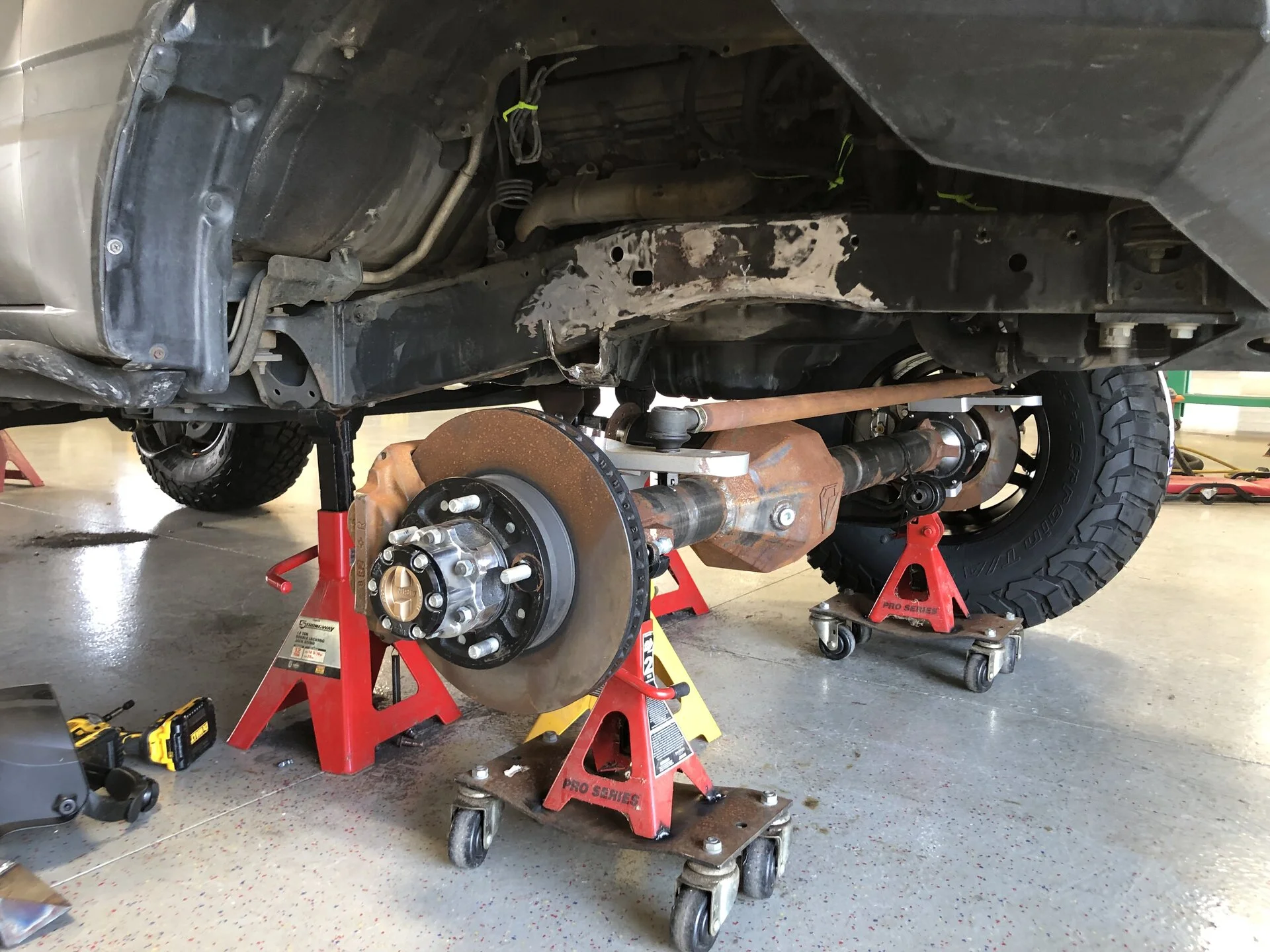

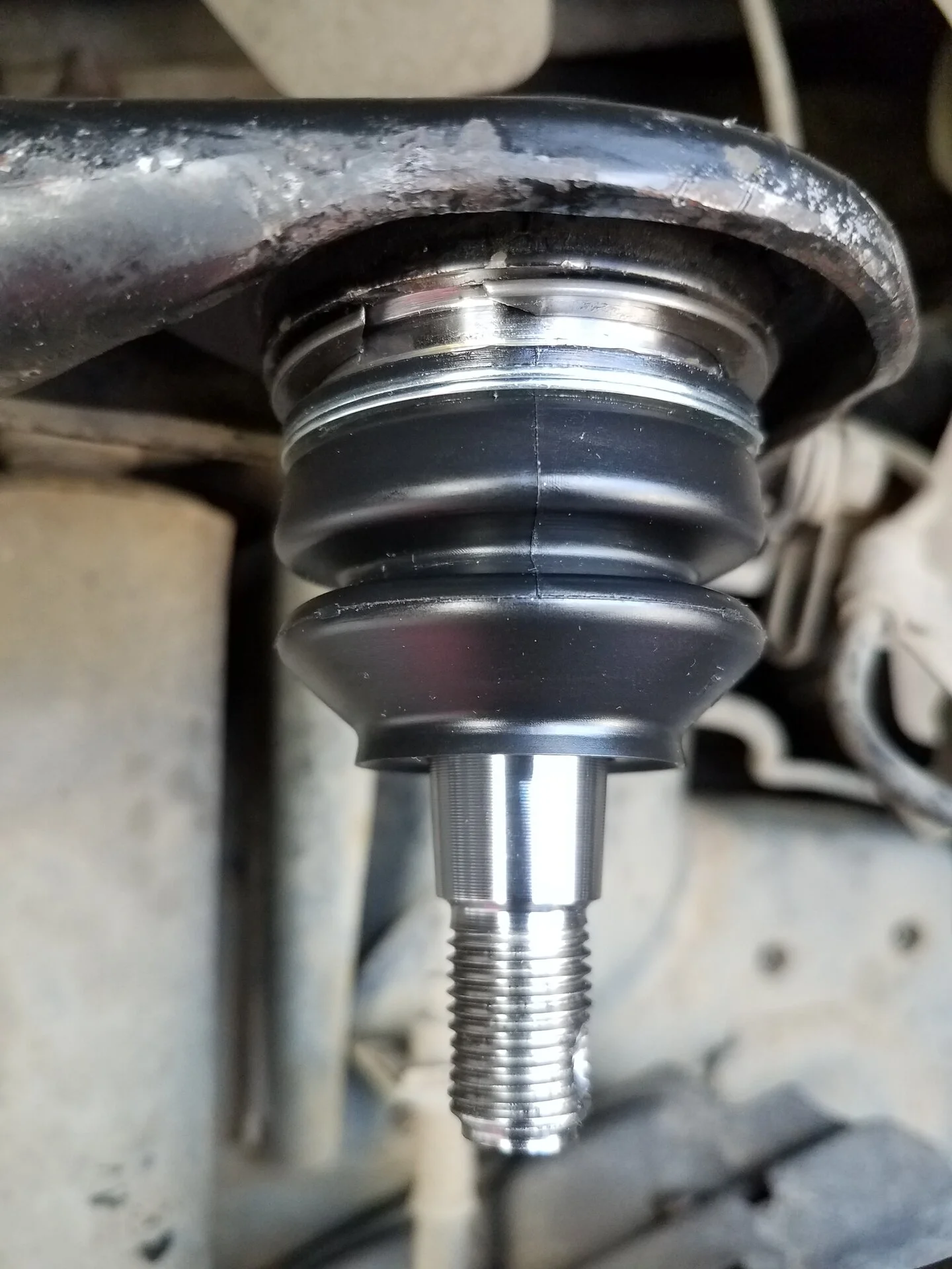

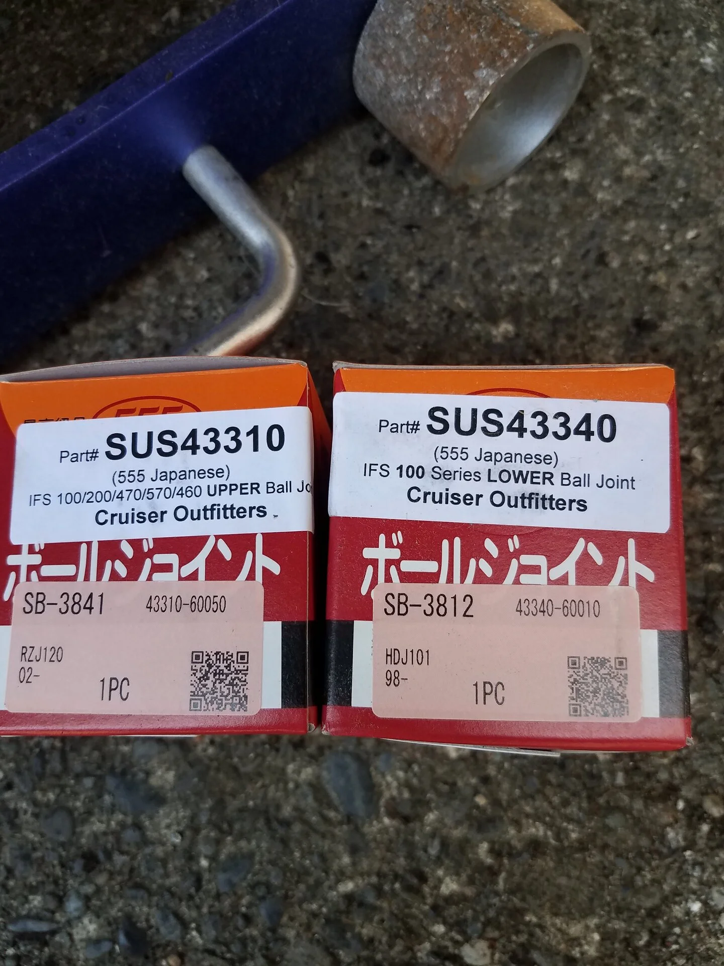

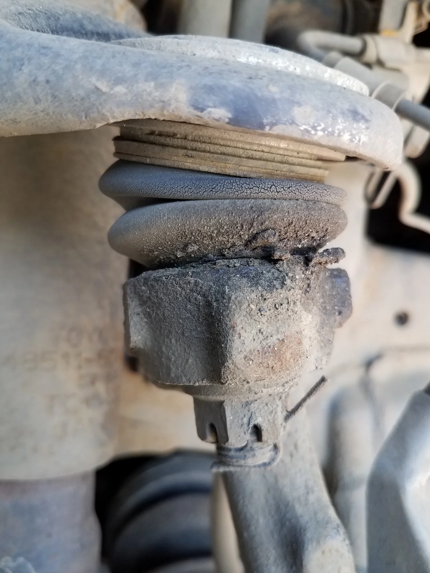

Did a few things this past weekend. Tie rod inner/outer, ball joint upper/lower from Cruiser Outfitters, and front shocks from Toyota. OReillys ball joint press kit barely worked, but enough to get it done in the driveway. 246,000 miles. Needed to buy two bigger wrenches and a pipe wrench for the tie rods, I didn't have anything bigger than 22mm but I do now. And a strap wrench to hold the shock body to loosen and tighten top nut. Alignment tomorrow. Ride significantly improved.

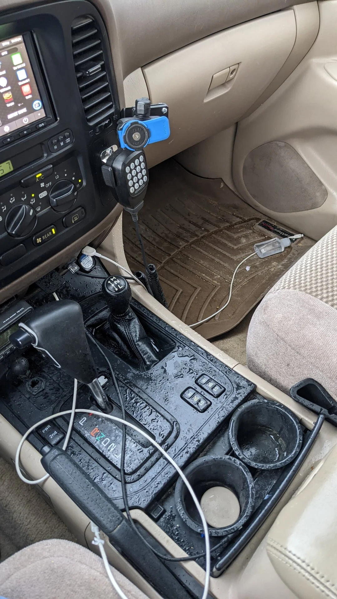

I resealed the sunroof with Eternabond RV roof tape after noticing a couple of drips of water falling from the rearview mirror.
A few weeks later I jumped in the 100 after a extremely heavy down pour only to discover this!
Water streaming down from the front of the headliner. Yep, the transfer shift boot is holding water. Time to pull the headliner and sit inside with a sprinkler on the roof. My sunroof sealing is still perfect. I fear it's a windshield frame issue...
